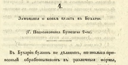

I found another interesting article in 1842. It's called: "Notes on forged wootz steel in Bukhara". The author - Colonel of the Russian army - Butenev. The author writes that according to his information wootz in Bukhara Khanate unknown how to smelt. But of imported wootz - made blades. Wootz brought to Bukhara (according to him) from Persia.

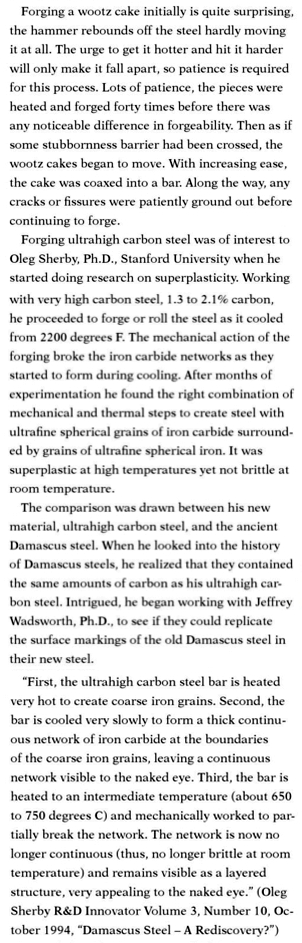

I am in general agreement with you Ariel. I just pointed out that crucible steel production and the production of blades with this material might have continued in very small quantities and on a non-industrial basis. Not just Rajput Rajas used and collected these objects, as I mentioned, and not finding any published ones from the Rajput royal collections does not mean they didn't exist . Again, just looking at Sikh craftsmen and their ability to maintain their craft into the 21st century suggests that somewhere on some scale however small, the production of wootz and wootz blades continued until relatively late.
Regarding the skill vanishing, my understanding is that the skill and knowledge required to produce this metal in both India and Central Asia was concentrated in key production hubs, under the patronage of powerful groups. Once that hub was destroyed, or the patronage was removed for whatever reason, be it military, economical, political or fashionable, the concentrated skill was rendered obsolete and the skill dispersed.
So I agree that the need and desire for wootz/bulat/pulad changed, and the concentrated skill just had to move on.
Ann Feuerbach, and Anosov before her documented numerous ways of making crucible steel with more or less pronounced patterns. The type of ore did not seem to matter too much, but cleaner iron ore certainly made the process easier. Dr. Ann found documented evidence of relatively poor material used in crucible furnaces in both India and Central Asia (Uzbekistan and Turkmenistan). Running out of cleaner ore did not mean the ore with more impurities could not be refined further before the crucible process.

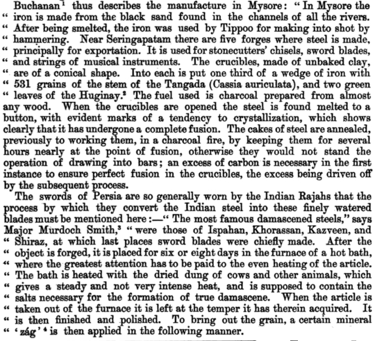

Still remaining intrigued by this topic, I thought it time to revisit Egerton (Illustrated Handbook of Indian Arms", 1880), and found some interesting contemporary observations:
pp.56-59,
"Wootz or Indian steel exported from Cutch to ports on Persian Gulf".
p.57,
"the Indian steel, however, has never equaled the European in toughness and flexibility. It is either too brittle , like the best tempered blades, or soft and easily bent like some of the blades used in Southern India".
(this cited from Walhouse, in the 'Indian Antiquary' 1878)
He notes Wilkinson describing the manufacture of steel,
"...the iron of Hyderabad is said to furnish the best steel exported to Persia"
Further he notes the Persian merchants who frequent the furnaces say that in Persia they have in vain endeavored to imitate the steel formed from it. It is found at Konasanundrum and Dimdurti, twenty miles east of Nirmsal and is made from a magnetic iron ore diffused in a sandstone looking gneiss or schist, passing by insensible degrees into hornblende slate.
It is noted that 3/5 of this iron is mixed with 2/5 from the Indore District where ore appears to be a peroxide and that mixing of the two must have some effect on the crystallization producing the beautiful 'water'.
p.58
The name of Arnachellam of Salem as an armourer has been known over the past 50 years in India (remember Egerton wrote in 1880).
The excellent steel of Coimbatore and North Arcot is much used. At Elgundel there is a manufacture of swords, daggers and spearheads of the steel obtained there.
p.59
In Mysore the iron is made from the black sand found in the channels of all the rivers. Near Seringpatam there are FIVE FORGES where steel is made, principally FOR EXPORTATION. It is used for stonecutters chisels and sword blades.
The swords of Persia are so generally worn by Indian rajahs that the process converting Indian steel into these finely watered blades must be mentioned,
and he describes Ispahan, Khorassan, Kazveen and Shiraz as THE LAST PLACES SWORD BLADES chiefly made.
In looking through these references, which I add here as talking points regarding elements of our discussion, I am wondering about some of the notes...for example, the forges in Mysore making steel.......it seems unlikely that wootz would be used for chisels! ? so then was this regular type steel (sword blades as noted) ? or indeed wootz as suggested in the earlier notes.
So we seem to have a substantial industry of steel producing in these regions c. 1870s but how much was actual wootz to me seems unclear.
That the Persians would visit the forges and not be able to imitate the steel suggests perhaps some sort of consistency in the ore? as certainly they would have seen the process being performed.
Jim, I believe that tools and swords etc were made with crucible steel, but not all items made with crucible steel showed watering as in wootz / damascus steel, that had to do with the method of forging, it was a two part process.

Just a quick clarification. As I recall from Ann Feuerbach, Richard Furrer, and other smiths, the watering in wootz, or the dendritic structure, was inherent to the ingot. The structure is primarily due to the cooling rate of the crucible at the time of production. Nothing to do with forging method of the tool or blade.
The annealing at constant low temperature was to make the metal soft enough to work without stressing it. Higher temperature break the dendritic structure and destroy the watery effect.
The salt baths mentioned in that account just etched the blade. Apparently etches work better when the metal is warm, as the heat "opens up the grain" for a better reaction with the etchant . Richard and other smiths on the forum please correct me but there is no way of converting a blade that doesn't have the crystalline dendritic structure to one that does. The process occurs when the metal cools from near-liquid phase to a solid. The Central Asian vs. Indian methods differed in both how the crucible was loaded with material, heated, and cooled.
Jim, the question of how many tools were made from crucible steel bugged me too: http://vikingsword.com/vb/showthread.php?t=20633
Not all crucible steel ended with the crystalline pattern as there was a relatively high failure rate due to poor temperature control.

1) I have already given a historical source, proving that in Persia in the 1840s wootz produced (smelted)
2) I have given the information from historical sources that in the 1840s-1850s years in the Bukhara Khanate and Persia did wootz blades.
That means that it's not about the year 1825. Next question. In 1750, the year was a different life? People live longer? I doubt it. But I think this time (1750) - the peak of wootzsteel production.
I think the problem lies elsewhere. To craftsmanship preserved (for example, the production of blades from wootz) - needs constant demand. Until the 1880s, people from Central Asia buy many swords (blades) in Persia. After the Russian conquered Central Asia, the market disappeared.

Emanual, my understanding is that crucible steel, if properly forged, could show a watered pattern, and the fact that not all crucible steel showed a watered pattern was due to the forging process not being done properly. You can not seperate the two things, just because the steel had the ability to show a watered pattern did not mean every item made from the crucible steel would show a watered pattern, it had to be forged in the right manner or the pattern would not show. The poor temperature control that kept the crucible steel item being forged from showing a watered pattern came during the forging process.
I other words, if just any blacksmith pounded out a blade from a hunk of crucible steel the blade would not show a watered pattern, it took someone with the exact knowledge to forge a blade that showed a watered pattern.
Here is an example that shows the complexity of reproducing the watered pattern using modern steel meant to replicate crucible steel.
Blades Guide to Making Knives, Joe Kertzman, 2012

Great quote! It takes time to learn wootz forging.
Many bladesmiths in Russia ( just an example I know about) have been dealing with wootz issue for more thn 20 years. Despite all the books, all the achievements of modern metallurgy, modern equipment etc, they are still incapable to reproduce Taban or Khorasan patterns that were routinely made by a barefoot Indian or Iranian in a primitive forge. The secrets of wootz ingot were revealed, but the methods of converting it into a blade still remain a mystery.
