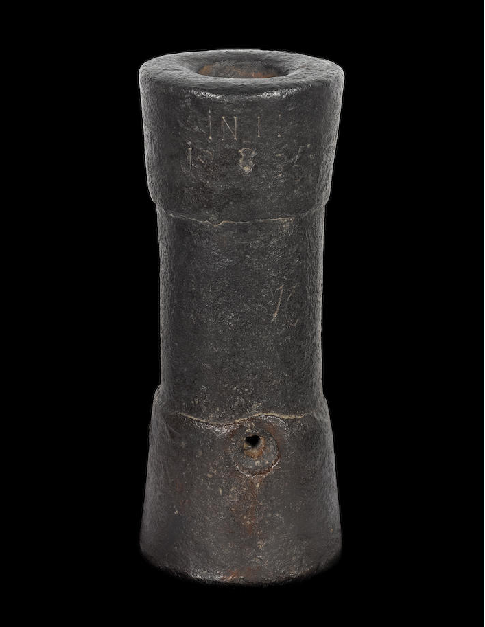

- my highly important historical Passau/Munich barrel dated 1481, with the oldest known fully developed block rear sight, and struck with the earliest known Munich town mark, the Münchner Kindl, according to Erasmus Grasser's design of 1477; underneath a black coat of 17th or 18th c. arsenal lacquer this, like all three of my Passau barrels, retains its original Gothic red lead minium paint! Please note the bell-mouthed muzzle.
http://www.vikingsword.com/vb/showth...highlight=1481
What is most interesting about this and two other historical pieces bearing the same date and still preserved in Passau: together with others (a fourth barrel struck with the date 1481 is preserved in the arsenal of the Fortress Coburg, Northern Bavaria), they were bought by the Passau arsenal in the Fortress Oberhaus, situated high above the city of Passau and never taken, in 1481 when two rivaling candidates, Georg von Hessler and Friedrich Mauerkircher, ran on the Passau prince-archbishopship. In 1482, these haquebuts saw service when parts of the city of Passau lay under heavy fire from the Fortress Oberhaus! And one of them is in my collection 533 years later - imagine!

More close-ups of my 1481 barrel.
This dated piece is an important anchor point for dating barrels of the second half of the 15th c.!

As i like to raise this thread from its depts from now and than, i present this (for me) unknown hand cannon, dated! 1485 (?)
If anyone has better pictures of this piece and its whereabouts i would be greatfull.
Auction description:
A Rare Wrought-Iron Hand-Cannon
Possibly 15th Century
Of waisted cylindrical form reinforced at the muzzle and breech, the former struck with a mark between the date 1485 and inscribed 'INII' above, the latter with recessed touch-hole with remains of lead lining, the mid section inscribed 'Taufers' and numbered '16' (rust patinated overall)
24 cm. high, 4.3 cm. bore
FOOTNOTES
Provenance:
Acquired in Basel, 1960
The inscription presumably refers to Schloss Taufers which is located in the South Tyrol
