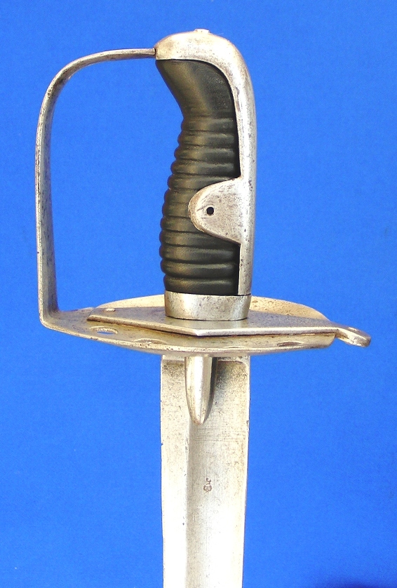

The sword fitted with its new grip, made by myself. Rivet still to replace.

Great work; well done.
Fernando

Thank you Fernando. It's very time consuming making a bespoke grip but very rewarding. This one took me two days to complete.

Hi Ian,
nice job.....what wood did you use ?
Regards David

Beautiful results.
I must confess to be envious of your abilities, I have no idea how to dismount a hilt or replate silver finish...

Thanks very much guys. I may write a illustrated list of instructions when I make my next grip.
David,
The grip was made from beech wood shaped and covered in leather. The grip was made out of two pieces. The tang is marked out on one piece and cut out to the full depth of the tang. The second piece is then glued to it.
Manolo,
Taking this sword apart was fairly easy as the leather buffer/washer was placed between the blade and hilt not just slid over the blade. I cut the old leather buffer away and was then able to push the blade backwards exposing about 2 mm of the tang. The peened over end of the tang can then be filed off allowing you to dis-assemble the sword. Hey presto.

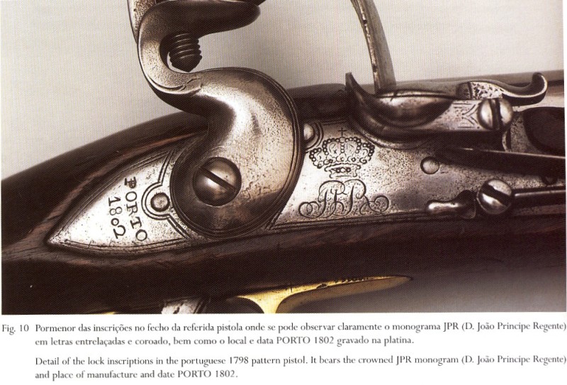

All, re the markings that have been debated, I don't want to complicate matters but Portugal was not the only country to which Britain sent the P1796 heavy sword. Some 2000 P1796 HC swords were sent to Sweden around 1807 and the Swedes adopted the exact pattern as their own M1808 cavalry pallasch* (although after Bernadotte become Crown Prince Charles John in 1810, they remodelled to a more French style of sword).
Ian - very nice grip restoration.
Jim - one of my 1796HC swords is by Thomas Craven who was in business from 1800-1801. Brian Robson was in error when he gave Craven's dates as 1818-20
Richard

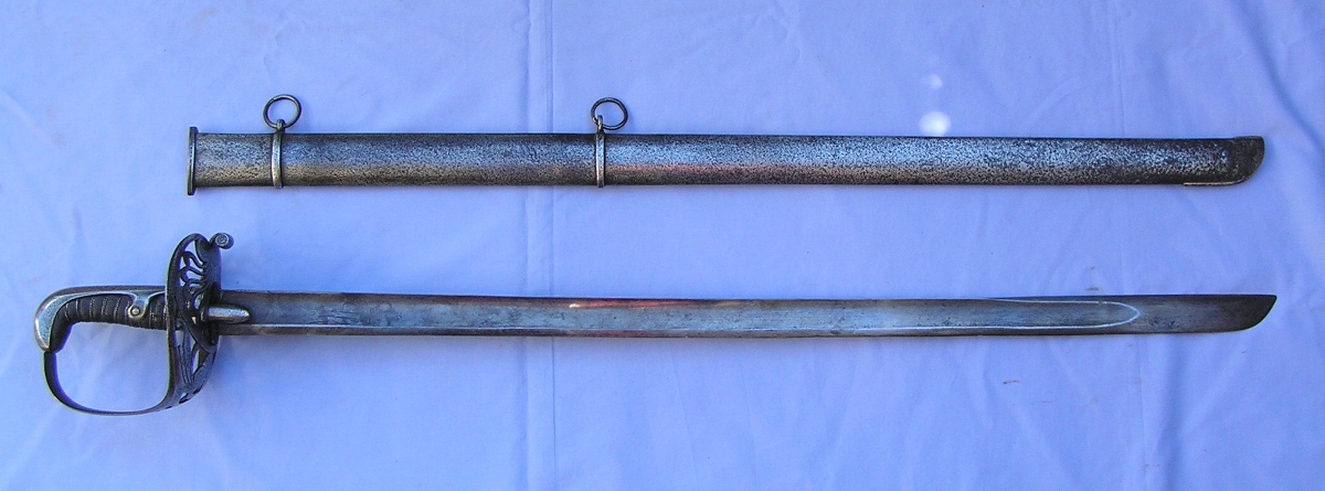

But talking about Portugal, below is a p1796 HC officer's sword which has a "JR" cypher on the blade. I believe this is the cypher used by John of Portugal when Prince Regent from 1799 - 1816 (the cypher became JR IV after he became king). I think sword was used by a British officer in the Portugese army after it was reorganised by Beresford in 1808 at the command of Wellington and that it originally had a GR cypher which had been polished out and re-engraved "JR"
Richard

Thanks for answering my Q, Ian.
But then, if you file off the tang's end. How do you reassemble the grip afterwards, and keep the whole shebang together? Not Krazy-Glue, I hope!

Hello Manolo,
I'm sorry my explanation wasn't very accurate. The end of the tang is not filed off, just the sides of the 'mushroom' created when the tang was originally peened over. See my very basic drawing.

Thanks Richard,
I am not 100% happy with it. When sizing and finishing the wooden part of the grip you have to make the grip slightly smaller to allow for the thickness of the leather covering. I actually made the grip a little too small and so there is a slight gap between the finished grip and the backpiece.
I might make another.
Ian Knight is offline   Reply With Quote

Old 28th January 2010, 07:02 PM   #77
katana
katana's Avatar
Location: Kent
Posts: 2,658
Originally Posted by Ian Knight
Thanks Richard,
Hi Ian ,
could you 'double-up' on the leather covering (if glued to the existing layer)....or would you loose the detail of the grooves ?
Thanks for answering my question ....Is beech the original wood used ....or your own personal preference?
Regards David
Old 28th January 2010, 07:39 PM   #78
Hi Richard,
Originally Posted by Richard
All, re the markings that have been debated, I don't want to complicate matters but Portugal was not the only country to which Britain sent the P1796 heavy sword ...
The assumption that this sword's marks are either Spanish or Portuguese relies on the use of genre ... feminine, in the case. The 2Ŗ for segunda and CŖ for Companhia are undoubtedly the type of initials used on marks in the Peninsula,
Fernando
Old 28th January 2010, 07:43 PM   #79
Ian Knight
Ian Knight's Avatar
Join Date: Dec 2009
Location: East Sussex, England.
Posts: 103
Originally Posted by katana
Hi Ian ,
Regards David
Hello David,
I did think about doubling up the leather but I do think it would spoil the grooves but I suppose if I am not happy with it I could give it a try.
I believe that the wood originally used would either be beech or obeche.
Old 28th January 2010, 08:00 PM   #80
Hi again, Richard,
Richard
Nice sword you got there; with a hilt rather different from the current model, right?
Not trying to correct you, but the right cypher would be the monogram JPR for Joćo Principe Regente.
He was indeed crowned in 1816, but as Joćo VI, not IV. The new cypher would then be JVI ... no more R for regent.
But then if, as you say, your sword was used by a British officer, i don't see the logic in changing the British cypher into a Portuguese one. In such case the sword would have been 'donated' by the British, like thousands of them, and used by Portuguese ... or am i completely blocked
Fernando

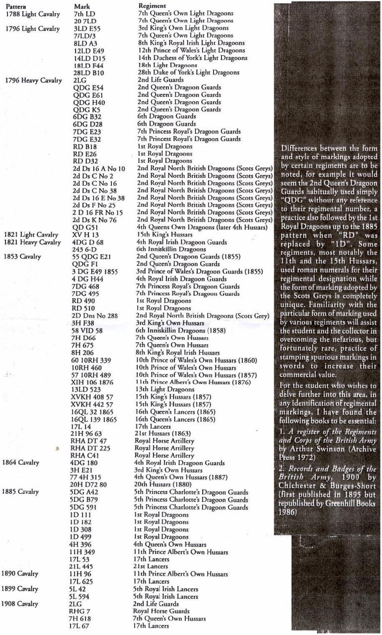

BTW, Norman, Ian, Richard and all.
I am sure you have this listing on British Regimental markings on swords, but just in case .
Fernando

Fernando
Yes I know that listing - I compiled it! It is not comprehensive, just marks I had noted from personal observation
Richard
Fernando
Richard is offline   Reply With Quote
Fernando
Richard
celtan is offline   Reply With Quote
Fernando
Richard
Thanks Fernando/Richard.

Hi Manolo
Well, its an interesting sword, not a British regulation pattern that I've ever come across, so I'm afraid I can't help much (or actually at all!). It looks ceremonial to me, that's about it I'm afraid
Richard
