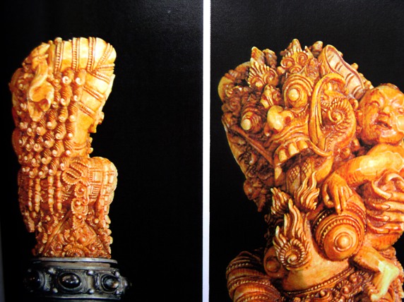

Here's a Nava Sari from Kerner's book.

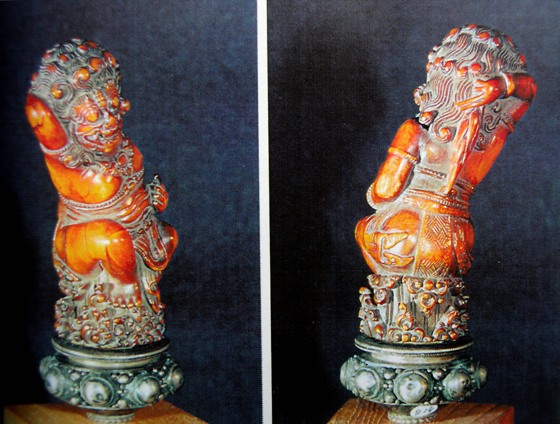

Great pictures BluErf. That first ivory (?) Durga with the balls of fire being emitted from her mouth is just too cool.
I tend to agree that Cedric's Bali example might more likely be Nava Sari. The object held behind the back appears far too stiff to be meant as a vale and looks very much like a stylized grain sheaf. Compare to the obvious fabic material held in Blu's first example.

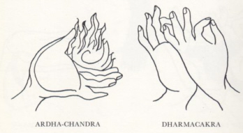

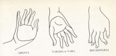

I believe the hand gesture is a represention of this, and the duality is further expressed in the hilt and scabbard of keris.Tim

What you have here in this image is the lingam of Shiva, representing his penis for the most part.

Indeed set in a yoni, showing the double-sexed nature of the deity Durga or Kali in other parts of Asia.Tim

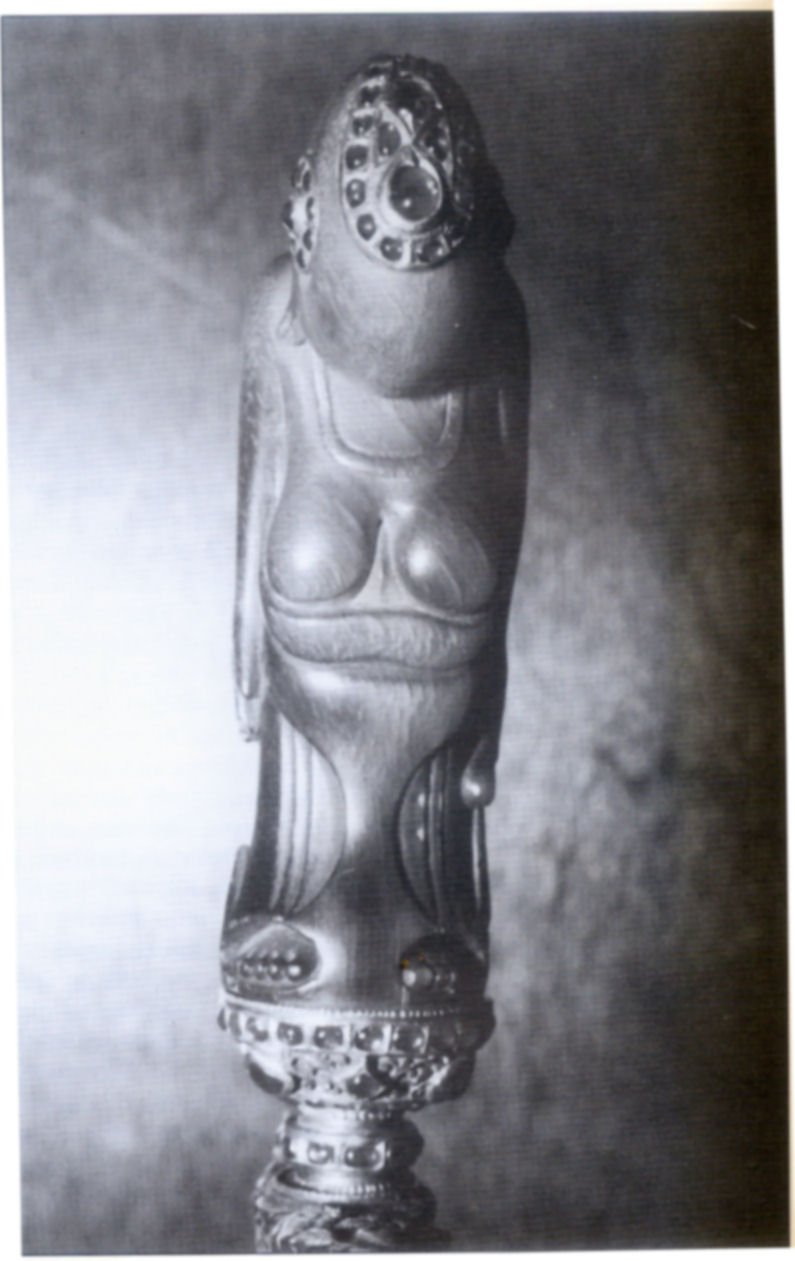

Actually, I must admit I only read about the hilt form being Durga in Kerner's book. Well, I suppose that's another fallacy to be dispelled, and what this forum is for.

marto suwignyo: well, I must admit you entered with lightning and thunders. So...what we were talking about . Should I ask moderators to delete all the posts and should we start discussion from the beginning. Or maybe someone will rescue all of this saying just: "it is traditionally believed that it is Durga"
Thank you for your post because it will let us think about all of this once more

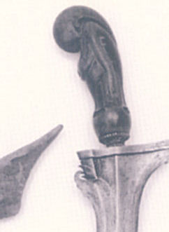

I have seen two examples of this handle form that do not have the hands in the position shown on the handle under discussion. On these other two handles, one has the hands raised to cover the breasts, the other has the arms straight down by the sides, with the fingers extended. It is clear that the hand position for the figure depicted in this handle form , is not a constant. If it is not a constant, how can it be used to support an argument that this handle form represents any specific being, because of the hand position?

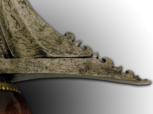

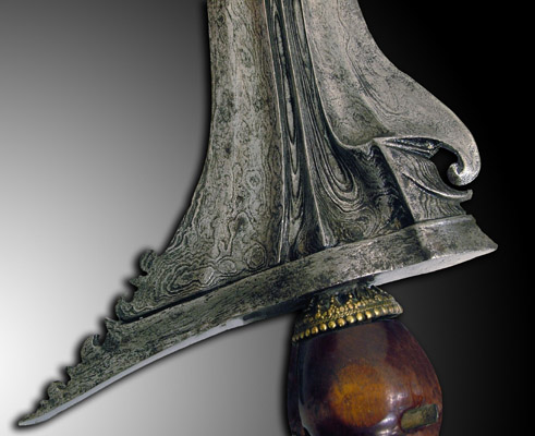

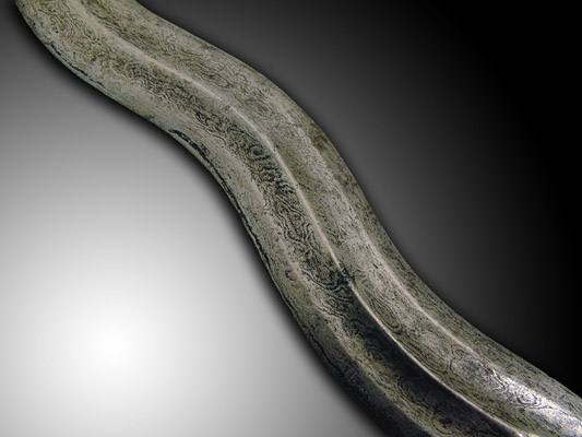

Now let us talk more about this beautiful almost pristine blade . I think this blade was collected fairly early in its existence . I have been told that the quality of this blade rivals those in other very early European collections .

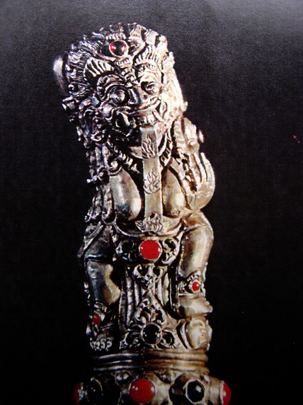

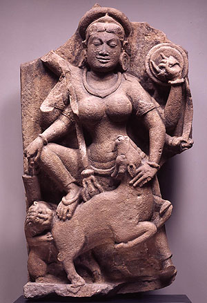

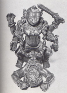

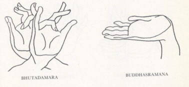

I still wanted to show you the two pictures and "argue" a little bit more about what have been said and stated.
First Kerner is not the only one. Sier Jensen present two keris with Durga hulu
(the pictures attached)
the one with stones is before 1618 (date of collection)
the second one collected 1676.
So according what Marto says it could be earlier than 1525...
And Gaspar de Marval (author of "le monde du kriss") talks also about it and has one.
Not to mention your servitor in my article about keris Handles in Kaos n°1.
Now about the fact that it is Durga or not.
Hinduism in java as always been adapting it self from the India Hinduism mixing it with local believes and ancestor traditions. Now It is also true that al statues of Durga have a different "look" from this handle. cf the very good study about Durga (http://www.asianart.com/articles/durga/index.html).

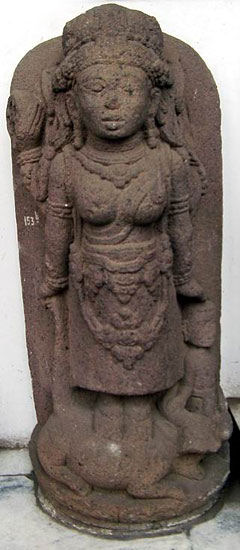

But one statue from the 15th century has only two arms. it come from java east and should be earlier than our handle.
Now if we talk about the veil. Only two goddess have a veil in the Javanese syncretism. Loro Kidul (mostly found in south and East java) and Durga. Nobody will make me believe that it is just a veil to follow Islam rule regarding women (to modern to apply and more over in java). The said goddess wear veil
because they have been stricken by a bad spell or a plague as punishment.

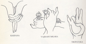

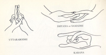

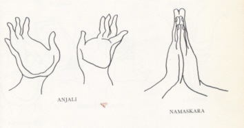

Now about the fingers position. You have two kind of interpretation
first it the Indian Durga image coming from India
illustration n°3
second is the Karana mudra to expel demons and other bad spirits that I have observed on many handles.
illustration n°4

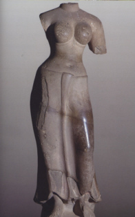

Well done tuancd, this is the only picture I have at home of a Durga statue with two arms, admittedly it is not from Indonesia but the National Museum. Phnom Penh. It is described as Durga, sanctuary 9, northern group, Sambor Prei Kuk, first half of 7th century. Thus illustrating a wide acceptance of a natural representation of Durga in south east Asia at one time. The hand symbol is a fact in Asia

The hand position is still ill defined.
To interpret this hand position as anything would require a giant leap of faith. We still only have possibilities. But let us suppose that it can be interpreted as a definite, religiously symbolic hand position, that in itself would not allow us to state that the figure is a representation of Durga.Apart from which, as I advised earlier, this hand position is not a constant in all handles of this form.
