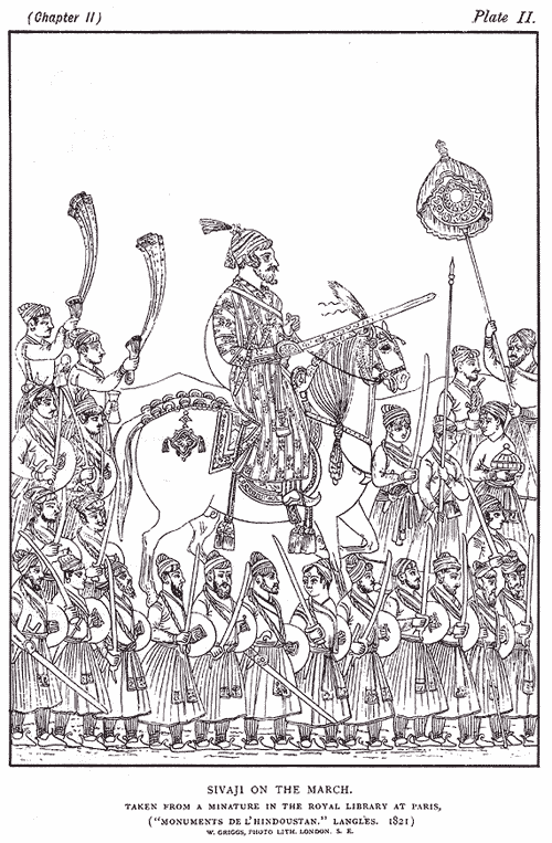

Attached are the images of Shivaji and page from Stone (1934).

Old 4th August 2016, 07:11 PM   #85
Interesting image of 'SIVAJI ON THE MARCH', Jim. Note the few infantry men also armed with a pata, suggesting that this weapon was not exclusive of Cavalry.
Here is a portrait of the man alone, holding a pata; surely the image previously mentioned by Ariel.

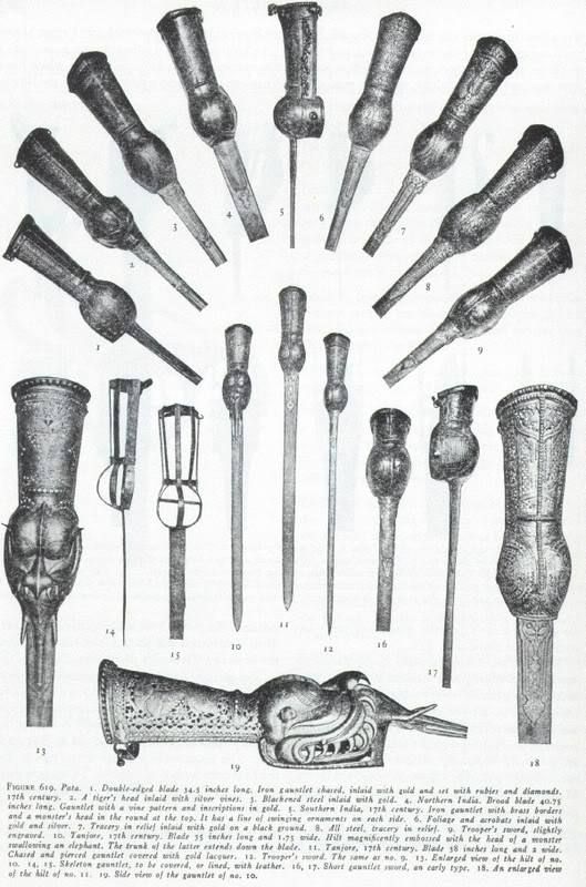

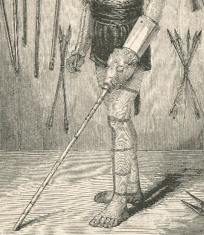

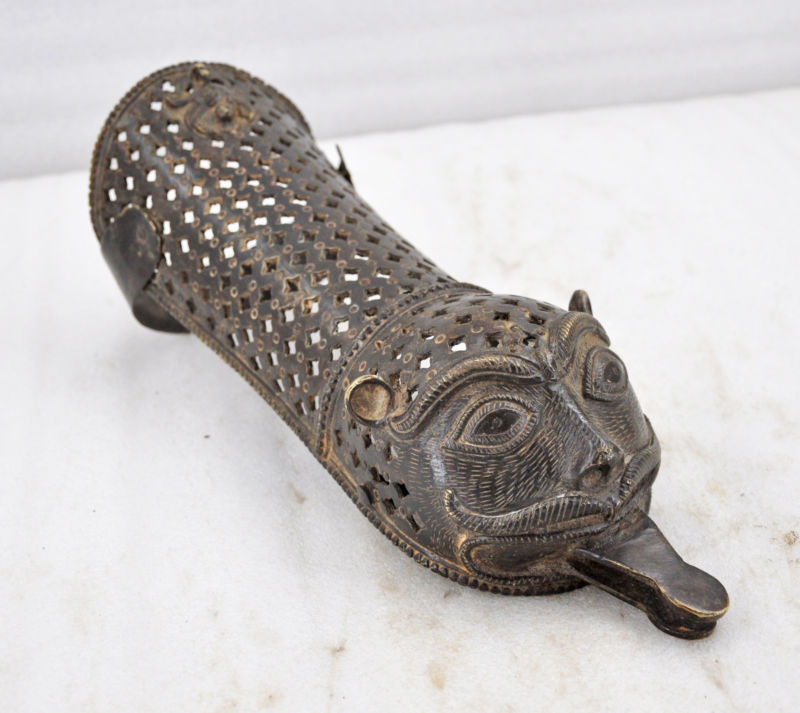

I remembered taking these pictures ...Early forms if I remember rightly...and exploring something of the Ethnographic as one seems to be a training stick version whilst the other looks to be wood carved in the hand/arm-guard. It could be argued that the older or more animalistic shaped the arm and handguard ...The more Zoomorphic ~ the older the weapon...and the more geometric the design the less old the weapon.
Looking at the baseline..for the basics... I illustrate what Wikipedia says viz
Quote"History
Created during the Mughal period, the pata's use in warfare appears to be mostly restricted to the 17th century when the Marathas came into prominence. Ranging in length from 10 to 44 inches, it was considered to be a highly effective weapon for infantrymen against heavily armoured cavalry. Folklore has it that a Maratha soldier would use the dandpatta when encircled, so as to maximize the casualties on the opposition, before he fell. The founder of the Maratha Empire, Emperor Shivaji, was reputedly trained in the art of fighting with pata. One of his generals, Tanaji Malusare, wielded the weapon with both hands during the Battle of Sinhagad, before one of his hands was cut off by the Rajput Udaybhan Singh Rathod".Unquote.
Once again refering to the basic note... From The Caravana collection I Quote"The Patta Sword;
The pata, patta, dand patta or dandpatta is an Indian sword with a gauntlet integrated as a handguard. Basically the sword has a wide and long hilt where the blade is integrated. The use of the term Patta or Patá is possibly linked to Portuguese terminology regarding what the sword resembles – a paw (pata in Portuguese) or a quadruped member.
This is a notable example of a Patta the most characteristic Maratha weapon and exclusively used in the Indian subcontinent. It has a double edged blade, made of steel originating in Europe, which is quite common in high quality Pattas.
The Patta was the most used weapon by Hindu fighting monks. These made battle on foot and could easily decapitate a horseman who attacked them. There were, however, many Mughal noblemen who used them when horse riding, as is possible to observe in miniatures from the 1700s.
Portuguese armies did not get to use the Patta, but they were used by many of the auxiliary Hindu forces which fought as allies to the Portuguese viceroys of India. Although it is the edged weapon with the largest action radius ever made, it is also a hard to handle weapon, which demanded not only physical strength but also prolonged training".Unquote.
From http://www.runjeetsingh.com/cat-2015-winter/14 I note an interesting potential mixture perhaps pointing toward a relationship between the Kattar dagger and the Pata or Dandpata...here...
