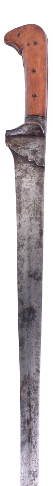

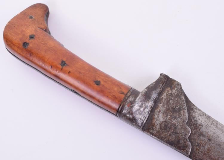

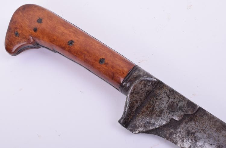

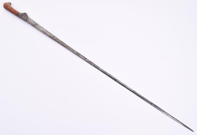

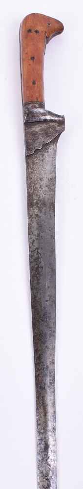

One more of the type, sold recently in the UK. The auction description:
"Unusual Indian Sword, 17th Century, fitted with a European rapier type double edge blade flared towards the hilt, iron flange and tang, two-piece ivory grips with pointed pommel. Blade 33"

Extremely unusual to see this type hilt, faceted bolster in Central Asian/ Khyber/Afghan style with a European rapier blade. By the photos it would seem of course a far more modern fabrication than 17th c., though the blade likely is that.
It seems hilts of this style, even with the anomalous 'tunkou' feature, occur in Southern India in Karnataka and even as far as Tanjore according to what has been shared earlier in this discussion
It does seem that with the volume of European blades arriving with Mahratta traders in these 17th c and earlier times, there were quite a few rapier blades, and many of these were mounted in khanda and patas as well as in cut down use in other weapons.
As far as I have known, there has never been any particular favor toward the narrow rapier blades in the northern, Central Asian regions, so this may be a traditional anomaly in the south.

I agree with Jim that the whole type have most probably a South Indian origin.
Of course, one cannot tell when the "rapier" sword was mounted, but it isn't a modern combination either, judging by the wear and the overall codition.

OTOH, this apparently well-aged hilt seems to be of genuine northern (rather than southern) Indian form including the minute notch at the underside of the gripping area. Thus, I'd be inclined to believe that this piece originates from the Mughal sphere of influence.
Not my area of expertise though, just my 2 rupees...

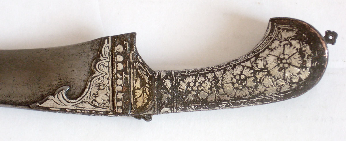

Old 11th May 2017, 08:22 PM   #68
Tatyana Dianova
Posts: 785

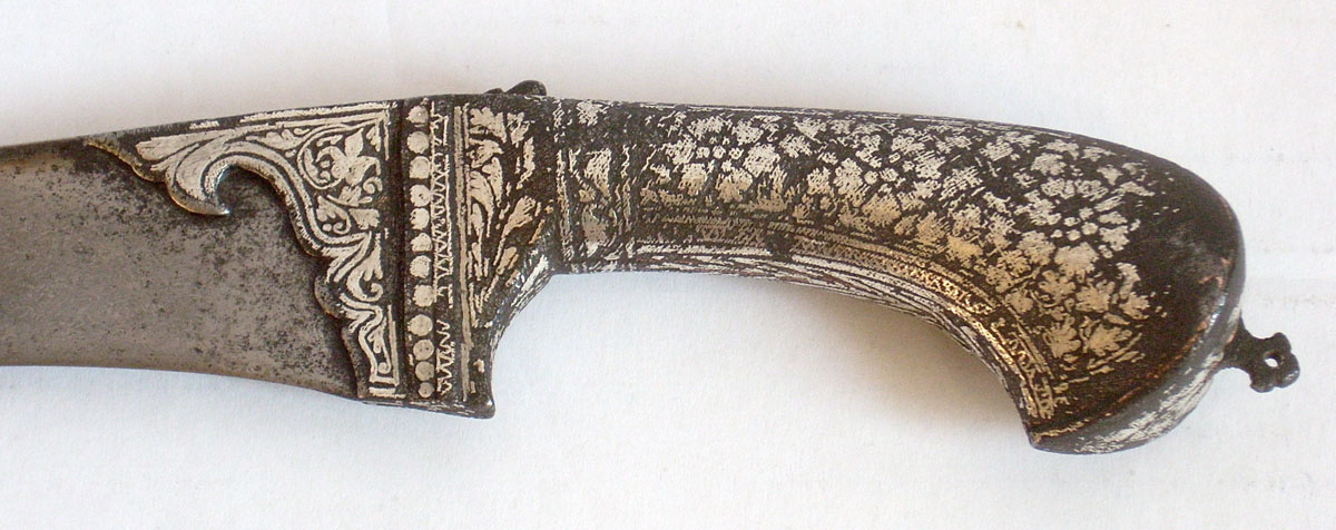

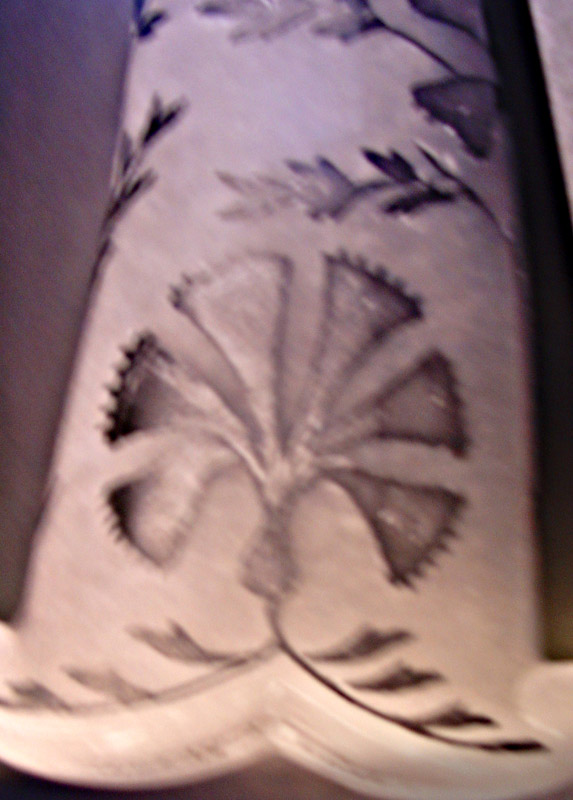

Yes Ibrahiim, you are right about the Deccani origin! I have found an interesting article from a very knowledgeable person on a 18thC Deccani dagger.
“This dagger could easily be Northern, but the decoration definitely hints to the Deccan. Most people tend to think anything with silver, or anything not typically Mughal is Deccani, but this style of decoration definitely veers South.
I have always thought that generally (and I do mean generally, as this cannot be used as a rule of thumb) that Persian influenced Indian work tends to be Mughal and Northern, and pieces that link more to early Ottoman work tend to be Deccani.
On this particular dagger, the style of splayed floral work, with jagged edges is seen quite often on early Deccani work, and even earlier Ottoman textiles and art. The decoration on the dagger is not exactly this kind of work, but the similarities are definitely there. The dagger is cruder in style, so definitely not of the earlier period (but, decoration aside, the dagger form itself is not too early). Also, if you look at the line that runs down the inside handle, and has a squiggly decoration inside. This kind of work, thinly laid onto crude cross-hatching had always been reminiscent of later northern (Punjabi) work, but it also annoyingly kept cropping up on early Ottoman work (some armour, and a few examples of maces). ”

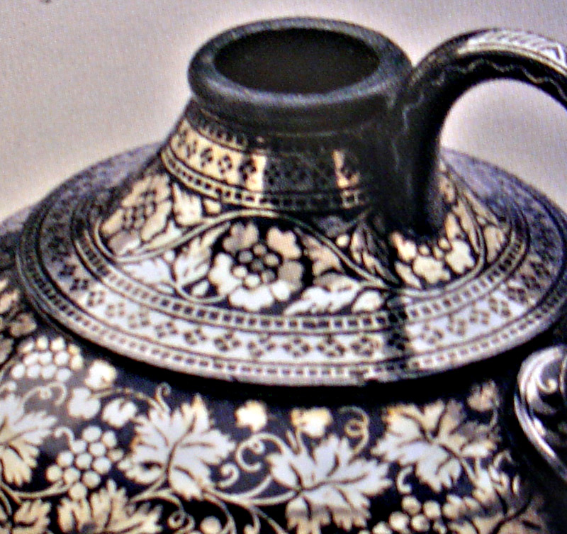

The following pictures illustrate the text above.
"First image is Ottoman, and an almost edible textile of the late 16th/early 17thC. You can clearly see the influences of the later Deccani blazons which decorated all art, but most especially the bidri work. The other 4 images are Deccani, and mostly of the 17thC. Last one is a jade hilt. the rest are bidriware."

This one is Ottoman, the rest are Deccani.

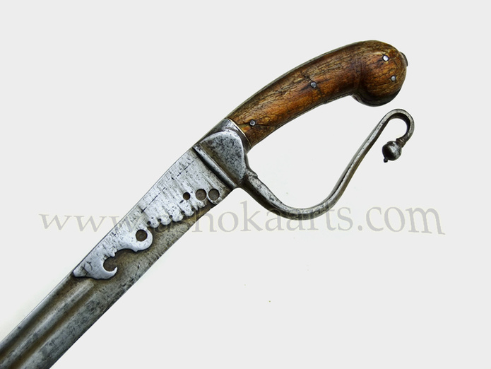

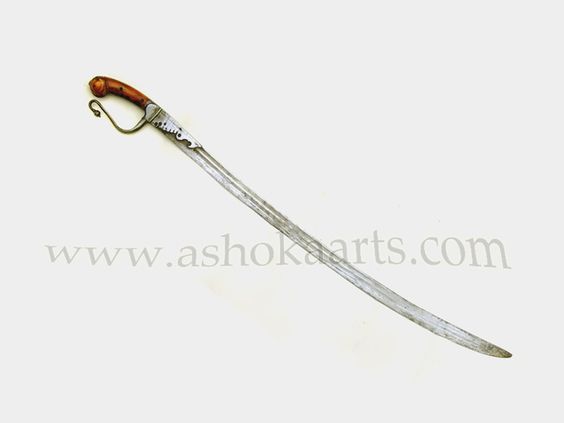

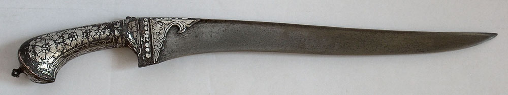

A South Indian project sword shown below comprises a few simple parts viz; Hilt, Knuckleguard, Knuckleguard base, Tunkou and Blade. Taking each part separately I will describe how each item belongs to a South Indian form. For this exercise I omit significant blade detail since it is impossible when trying to close in on a typography of regional description as Indian sword blades migrate all over the spectrum but base my assumptions on the other parts, however, I add a photo showing what I believe could have been the technique in broad terms of using this thin cyclic technique slashing blade behind a Buckler ...The technique is present in South Indian martial arts today.
Thus I describe ~

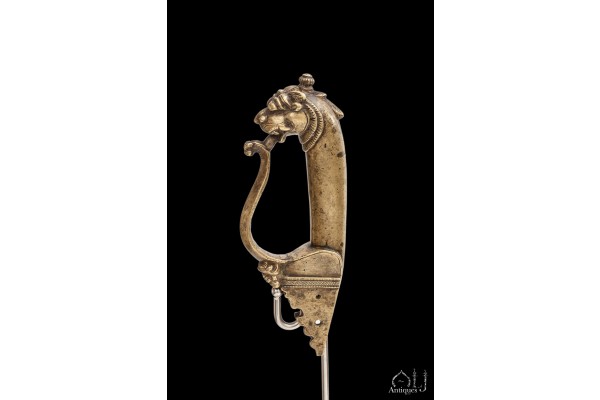

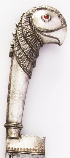

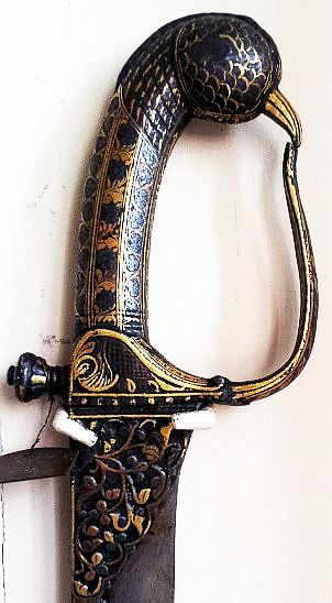

1. Hilt I select a similar hilt from the arsenal of South Indian weapons for comparison; The Pichangeti Dagger... See Picture below. This hilt is unlike Shashka form since it is birdhead or pistol grip form and although Mughal weapons with similar hilts were purchased by Othmanli court buyers the form was never transmitted to Shashka or other swords to the North...and since the Shashka hilt never went the other way....we are looking at a regional Southern Indian form only.
Note that great power can be transmitted through the weighted hilt with a heavy pommel counterbalance to a thin curved blade in the downward strike and naturally the weapon was not effective in the thrust particularly against armour..I assume that great speed was essential and that slashing cuts were the order of the day where moves were enacted around the Buckler style shield underlining the speed factor of this technique.

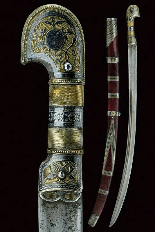

2. Knuckleguard No sword of the Shashka type has one..but that typically the finial being Lotus bud form is Indianwhich means that when sheathed, this weapon sits differently in the scabbard whereas the Shashka embeds right up to its pommel ... The project weapon has a knuckleguard thus sits differently in its scabbard.
3. Knuckleguard and base See below photos showing the elephant zoomorphology WITH ears, teeth and a trunk !! The basic shape may be present in other regions hilt base designs but no other region shows the foundation as an elephant head which would point to this being not only Indian but regional Indian....and certainly not absorbed out of Ottoman Bukharan or Afghan theatres.
4. Tunkou Relations with China were ongoing in many regions of India indicating that the transition of Tunkou to this weapon happened through trade and showing that other southern weapons also may have Tunkou design transfer such as on Kastane etc.
5. Blade showing a simple picture of how flimsy bladed weapons were used ...of this nature... behind a Buckler..
😎 In conclusion; the project sword is neither Pseudo nor Shashka but is a specific South Indian Sword design which evolved solely in Southern India and is unrelated to Afghan, Bukharan, Caucasian, Persian or other miscellaneous Shashka types except distantly by vague and unrelated accidental look alike factors not attributable or traceable to this weapon.

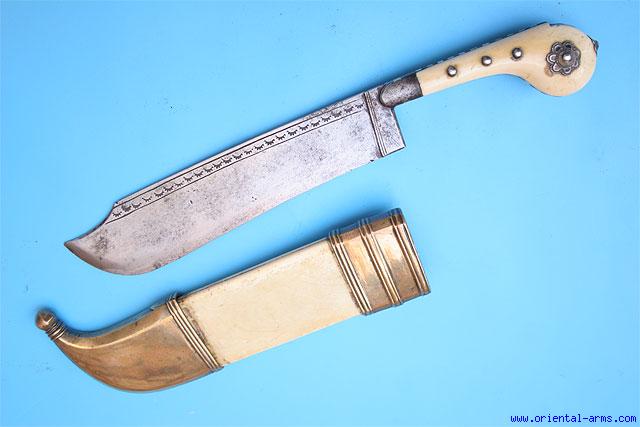

Pictures Below are~
1. Pichangeti showing both the rounded Pistol grip and Birdhead variety of South India.
2. Shashka Form Hilt.
3. A highly ornate gold and black South Indian example showing the zoomorphic elephant head; ears and mouth with trunk (as the knuckleguard) and missing Lotus bud finial.
4. A Project Sword; from Ashok Arts.

7. How the Shashka sits in its scabbard.

And another example that might possibly be related: http://www.vikingsword.com/vb/showthread.php?t=26861
The knuckle guard seems to be unique with (now missing) scales attached to it originally. Were these possibly crafted from brass?
