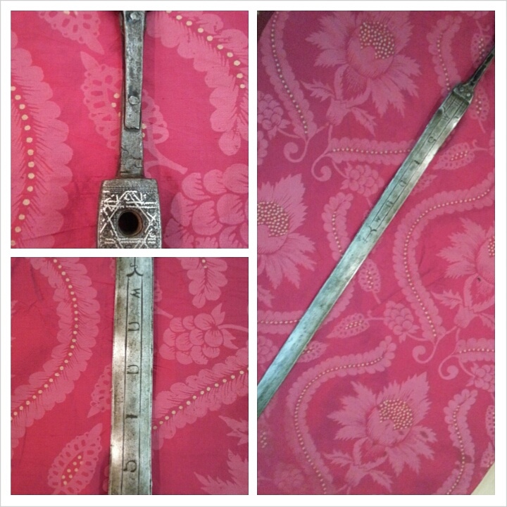

Having seen the most recent pics, I thought that Soares was the obvious answer. Fernando beat me to it :-))))
Pure Western Europe.

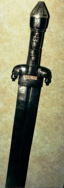

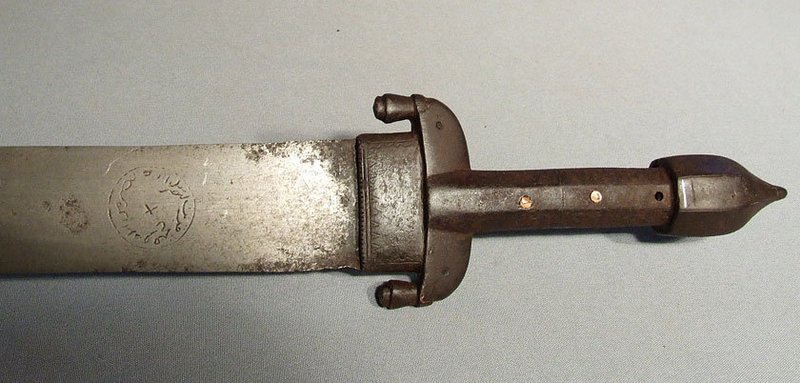

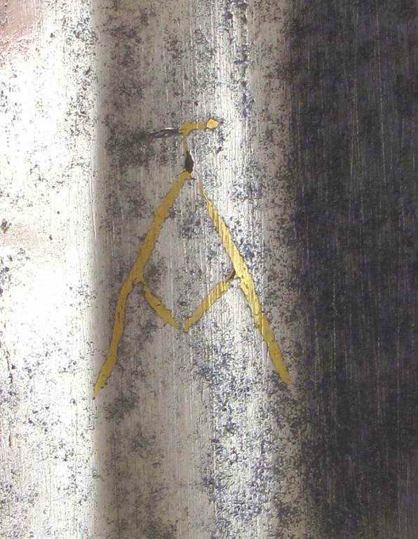

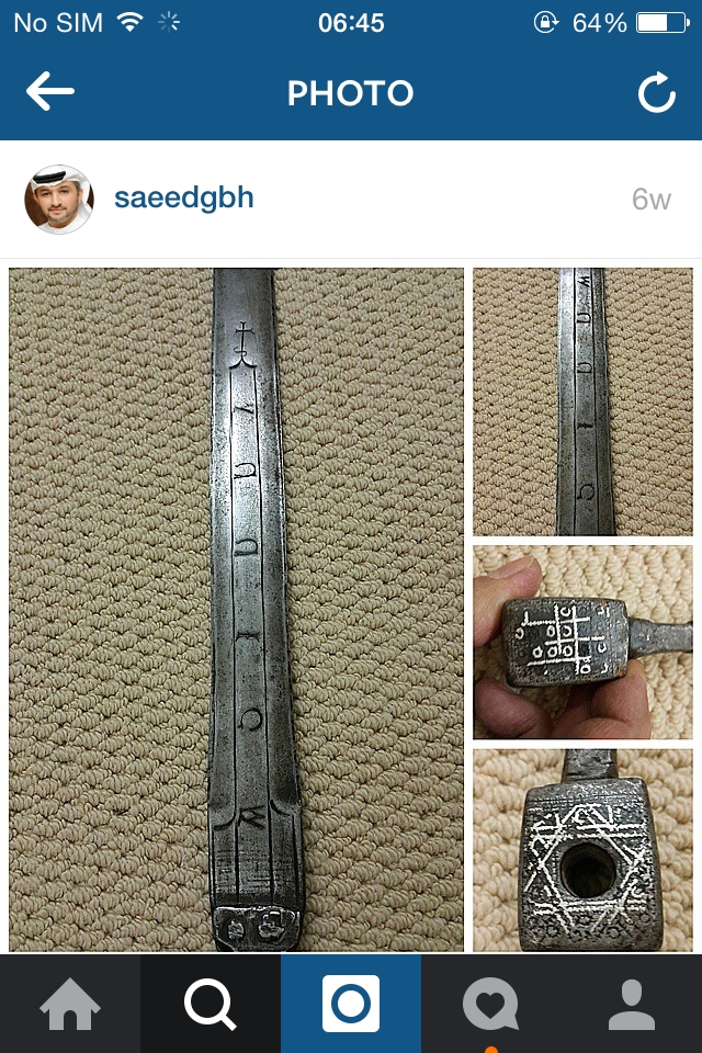

Salaams ariel, Are you referring to the sword at $1? since the SOARES inscription is not the project I am trying to translate?? Observe the Norwegian for the word Svare...which means answer respond or reply... seems like a reasonable solution except its got an S on the end but these inscriptions are rarely accurate...
However, please do look at the letters on #1 and tell me what language in western Europe uses the form that is similar to A 51UU A
Where the two A looking characters are quite different to European A style having a vee or tee shaped crossbar and which is almost identical to OCS.
Where the letter Zayin (similar to a 5 with no top) is a Hebrew Cursive letter...
Where the two letter U forms are also Hebrew. They appear as almost IJ close together...
Finally if you have a better idea or your associate can help by all means lets hear it from that quarter ...
Which European language/western language might this be from? I would be delighted to hear it.

Ibrahiim: Your last post may be on target. While, at one time, the second inscription may have meant something to someone, that meaning seems to have been lost over time and today we are left with an unintelligible mystery. Thanks for your pursuit of many and varied possibilities, even in scripts that are archaic today!
Ariel: Western Europe may well be the source, and I think there is a general consensus that this is a European blade.
Salaams Ian, For sure the blade is European ...I would say Portuguese, Italian or German style like Papenheimer or something similar... but the script...whilst it may mean nothing is taunting since it is so close to some of the varieties like OCS and Hebrew... I just cant match a European alphabet to it... I still think Hebrew may be the answer however I am sure it will turn up some day...
Actually, though it would be nice to crack the code it doesn't really matter since the essence of the idea and the peculiar circumstances of this blade and others like it into and out of the Red Sea Arena are more clearly understood with such examples albeit with much skulduggery attached. Fortunately we have uncovered this practice of hilt switching having shone the bright light (of field research) into that dark corner..

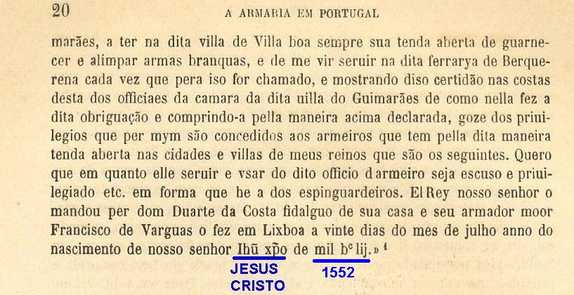

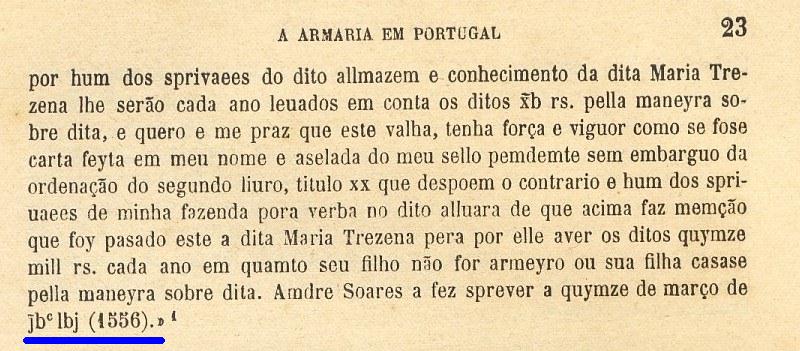

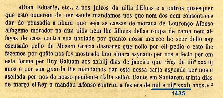

I think i should come back to lettering issue, even if i am in part correcting my previous consideration.
My idea is that, the contents of what i have learnt may be useful for collectors general knowledge.
Having consulted some of my old books in Portuguese armoury (Viterbo 1907-1908), i foccused on the the way the name of Jesus Christ and document dating were practised in the XVI century, when Kings issued letters of previlege to armoury smiths.
I can not type the way these were done, as current keyboards do not have such characters, as also the fonts used by Viterbo printers in 1907 may also be a bit distorced.
This way i show parts in the book where Jesus Christ "initials" are mentioned, as well as a genuine print that comes in a "reformulation of the Rules of the Order of Christ" (ex-Templars), published in 1503.
In both cases the letter H has a place but, above all, it is interesting to know how these symbols may appear in weapons ... and not only.
Also the type of dating is most interesting as, being Roman numeration, is rather different than that used nowadays. I phoned the experts in Torre do Tombo (National Archives) and they told me that, in that early period, Roman numeration had a difftent 'convention' ... which i, for one, was not aware of.
I also upload here a couple examples contained in such letters of previlege so that, if these figures show up in old (Portuguese) swords, won't be a complete surprise.

I asked her if that was an internal practice of the Torre do Tombo (National Archives) and she no; documents are revealed as they original were.
And not only these numbers were used for dating but also to quantify things, as seen, for one, in the vast inventory of the Arsenal of Tanger, taken in 1568, where listed items, like crossbows, helmets, cannons and so, were accounted with such numeration.

Thanks Ian, If I may be a little clearer ...
1. Swords with Latin inscriptions, though there are some which occur on Indian Swords imported from Europe and a classic is at the Wallace as an example and I am sure there will be others around the globe; it is still unusual to find blades in the East with Latin inscriptions particularly in Arabia.( Naturally there will be those swords in the far east that arrived with the voyages of discovery etc but as for Arabia I do not count the odd one or two said to have Andrea Ferrera marks or copied Passau Wolf...etc and it would be quite wrong to attribute the swords shown at thread as being of original and honest construction..
The fact is that swords in Arabia generally have Arabic or Persian or Turkish inscriptions if they are inscribed or a particular mark moon or an incantation to God . The equation East meets West is difficult to engineer. (Trade blades, I believe, are best dealt with separately.)
On the subject of Talisman marks it is even more unlikely (I would say impossible ) as the religious or pre religious markers are so differently based. I think this subject also is in itself divided....since it evolved separately in the East and West....even though vague connections may exist the vast majority of such Talisman concepts are unrelated across the East West divide.
2. There are documents on western calligraphy, short bible forms of script, secret inscriptions, runes, Gothic, Latin, Viking, (The Ulberft sword etc) which make for a study in their own right .. and most are very high level examinations. (Before anyone writes in to complain I am aware that we have a number of members who have the required scientific know how to take on these complex papers but I speak generally!)
Whilst I always advise students to get stuck into these references, I have to admit some are quite heavy going but by all means forum ought to have a go...noting that large portions of the material conclude that much of the Viking/Latin /Germanic inscriptions on blades are undecipherable and some marks were actually secret and known only to the owner of the Sword.
I would hate to advise anyone to study something which is in fact pulverisingly difficult even for a rocket scientist to handle. It is, however, really interesting to see these amazing notes and details as reported on by Fernando and I believe the examination as it stands is a great step forward for Forum ..and library is a better informed place.
Ibrahiim al Balooshi.

To my eyes this hexagonal blade looks like a worn out and modified example of a Spanish cavalry blade 1728 pattern. They produced it in different sizes till the end of 18 century when they switched to the curved blade.
http://perso.wanadoo.es/jjperez222/tropacab_e.htm

In looking at my reference thus staying on Benidictus style script I see the letters again could be interesting ..
M 51 DD M
The Book of Revelation is often referred to as 51... So are we off to a reasonable set of meaningful code?
In suggesting Portuguese origin of blade form at http://www.vikingsword.com/vb/showt...rtuguese+swords it could of course point to another source as actual blade manufacture; Solingen. This would suggest the religious nature of the blade marks as being in line with the reference above at http://www.academia.edu/13386318/TH...ol._10_pp._9-20
Could the DD indicate In Nomini Domini or perhaps Dominus Deus? http://www.academia.edu/13386318/TH....10_pp._9-20and the two outer M shapes be some sort of decorative introduction or brackets?
This weapon is indeed interesting as an Ethnographic example whereby an old blade has been given a mixed cloak namely the Solomon star decoration and the added extension of extra tang and Pommel of an Omani Dancing Sword. The blade appears much older than the Pommel which is from a distinctive 19thC Dancing Sword style. I have shown in a previous post how this is achieved and particularly in the souk workshops of Muttrah where it is common practice. It should be noted that in the case of Omani Dancing Swords a weak point caused by vibration is about half way up the tang...Omani Dancers are made with tang and pommel and blade in one piece and it may be observed that the curved Omani Kattara is not so it has to have a tang extension and pommel added to every weapon...
I digress... however, it is the tang and Pommel which brings the entire weapon to the table from the Ethnographic viewpoint. Decoration to the Pommel is superb following the Solomon style star but I have never seen it before on a Pommel.
By way of a correction it may be seen that the initial and final letters are not the M letter but the old fashioned way of presenting the letter A

The objective is to crack this code A 5 1 D D A Where the A is in Majescule form at both ends of the code.
There may well be a variation in how the reference is applied since 51 could refer to the book of revelations or Psalm 51 . I am looking at the A called The Majescule A which looks to belong to several alphabets and has a peculiar tail at the top left of the letter and a central support leg to the cross piece …
Could this indicate a place... Augsberg possibly.
I recall Michael(RIP) in one of his amazing epic threads discussing the Augsberg Halbard pole arms with the Augsberg letter in Latten style on the blade in the form term being expressed here...of a Majescule A. Could this be indicating that since A is at both ends of the script that it forms a sort of bracket around the biblical term being expressed. Thus underwriting the blessing as having been carried out at Augsberg? Thus so far I have a hypothesis as follows...Benedictus style blessings often focussed on a psalm thus I lean toward that possibility~
At Augsberg Psalm 51(or the book of Revelations) Dominus Deus At Augsberg.

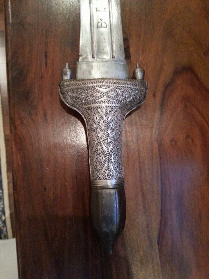

The Ethnographics of this case are huge! Not only is the hilt rare in the case of the other sword See Post 44.....but on The Odd Sword the incredible decorative form on the added pommel illustrating the Solomon style star geometry and Talismanic gridded majic square with Arabic numerals seemingly all 5s …
I have previously described figure 5 geometry as representing Hand of Fatima daughter of The Prophet (pboh) . In addition there is a tang extension although it looks like this part snapped off another sword type...The only weapon it could have come off is The Omani Dancer. The decorative devices are so rare that no one has seen such a decoration before.
I also show how the fixing is made in a previous post to thread See post 23.
Please note that blade and hilt and pommel are made as one with the blade on dancing swords so that in the case of a hilt and or hilt extension
there would be no rivets or brazing together of hilt parts unless the hilt was a replacement of some sort... In this case two parts ...Half a hilt with two rivets shown and a complete Pommel with Tang extension in this case riveted . See pictures below.

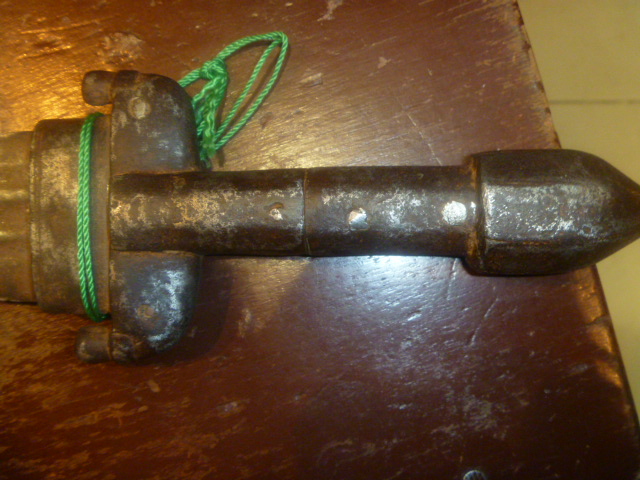

Despite probable modern mounting and assembly, many composite swords offer great opportunities in evaluating the components used, often having their own genuine antiquity. The remounting of old and heirloom blades is actually very common in ethnographic spheres.
In the case of the 'odd' sword posted in the OP of over three years ago, the blade, as well discussed, appears European and with a curious inscription of letters which may be a combination of symbols and letters or perhaps with acrostic value in some degree.
It seems well determined that the blade has had an extension added to move back the cubed pommel to allow for the long grip of the Omani sayf. While these long open hilts became popularized during the al Busayyidi dynasty of Oman in the early 19th c. , it appears that there were many of this form made for ceremonial events. Contemporary to these it would seem that this style hilt appealed to status oriented figures such as merchants and distinguished officials, and they may have had European trade blades (readily available in their entrepots) mounted accordingly.
Although it is believed that this blade on the sword discussed as well as on the second (in sayf Yemani mounts) with 'SVARES' inscription, are from a European source in recent time, this only negates the importance of the possible Portuguese attribution. As far as thier own antiquity as blades of probably 17th c. , they are very worthy of discussion on their own merit. so keying them to Portuguese presence in Oman in these early times need not be a consideration for provenance of the blades.
Returning to the sword of the OP, the character of the pommel is most interesting, and appears to have motif completely uncharacteristic of pommels, despite occasional occurrences on blades.
The 'magic square' (often termed 'buduh' but in Arabic 'wafq') is a device which far predates Islam, but was filtered from China via India into early use in Arabia. As far as recorded use I could only locate the 10th c use as described by Jabir ibn Hayyan (Geber) but I am admittedly not well versed in such matters. The point is that this, as described by Ibrahiim, is most certainly a talismanic device well known on Islamic swords.
The six point star, is not seen in this parlance as Jewish (of course) nor as some rendition of the well known proof mark surround seen on Wilkinson swords c. 1860s.....but as Norman noted earlier, a symbol of strength with two joined triangles. This was used in early times in various cultures but was known in Islam as well.
The cubed pommel is characteristic of the early Omani sayf with long open hilt of the earliest period of the reign of Saiid bin Sultan (1804-1856) and on the 'dance' versions which typically had the aperture in the pommel. This was presumably for a wrist lanyard or festoon, and not typically seen on the more embellished examples for dignitary or status oriented wear.
It would be a most 'odd' incongruence, actually paradox, to have a pommel with Islamic talismanic virtues joined to a European blade carrying what may be Christian invocations. Obviously none of that has yet been determined, but the possibilities are most interesting.
In the blade inscription one of the key elements is the majescule A which is apparently at both ends of the number/letters. Here I would note that these elaborate 'A' characters which look like a M because of the center drop down forming a lozenge in the center, were used in numerous instances besides Augsburg and by various makers in Spain and others.
This suggests that the 'A' is likely a symbolic device in my opinion, but at this point its meaning unknown.
