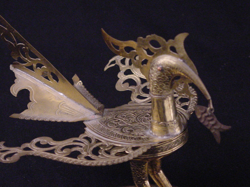

Old 20th June 2018, 05:19 AM   #74
Posts: 4,396
Ron,
I was looking through some old reference books and browsing Levine's Guide to Knives and Their Values, ed. Bud Lang, 5th edition, Krause Publishing:Iola, WI, 2001.
Several foreign knives are included in this encyclopedic book, and I have reproduced below the page that shows some Philippines knives. On p. 488 it shows a "Philippines (Northern Mindanao) Moro Dagger" (number G.8). In the description it refers to an "elaborate bird-head ("sarimanuk") hilt of a silver-copper alloy." It further notes that this knife has a "19th century blade in 20th century mounts." I have enlarged that item and posted it below--the pics are not very good owing to the low quality of the original printing.
The hilt style does seem 20th C. to me, maybe post-WWII, and resembles a style that I think was developed for marketing to tourists. Typically, these knives have elaborate hilts and guards with lots of curls. The copper alloy of the hilt and guard is often repeated in the scabbard, which is usually all metal. These highly decorative knives are fairly common and often have thin, poor quality blades made from sheet steel--wavy blades are found on them, and these have sharply pointed luk that likely indicate the waves have been ground rather than forged.
The ornamentation of these hilts resembles to me the depictions of feathers on the mythical sarimanok that you have referenced, and I wonder if this is where the idea that the hilt represents that creature may have arisen.
This is the only reference to a "sarimanuk hilt" I have been able to find.
Ian.
Old 20th June 2018, 02:59 PM   #75
Posts: 7,218
When i search for "Sarimanok hilt" i find a good number of hits lead me to these very old (10-13 century) gold hilts. I do not believe these swords were kris per se, but this does seem to help establish the symbolic use of the Sarimanok within the culture as hilts and pommels for swords going back centuries ago.
Old 20th June 2018, 05:47 PM   #76
Cool
Hello David,
There seems to be no extant sources corroborating that these hilts really were attributed to the same "mythological beast" originally nor has it been established that there is any continuous line of cultural descent. Arguing that the Maranao figurines are similar enough to the gold hilts to prove any connection seems overly enthusiastic to me to say the least.
Thus, I'm far from convinced that this attribution holds any water! I'll ask Lorenz - maybe he can point us to the origin of this attribution/story...
Old 20th June 2018, 05:58 PM   #77
Thanks, Ian!
I'm not aware of a single antique example of this (hilt) type. Chances are that this is a modern invention by Marawi craftsmen (most likely post-WW2 as you suggest) which received a well-selling attribution...
