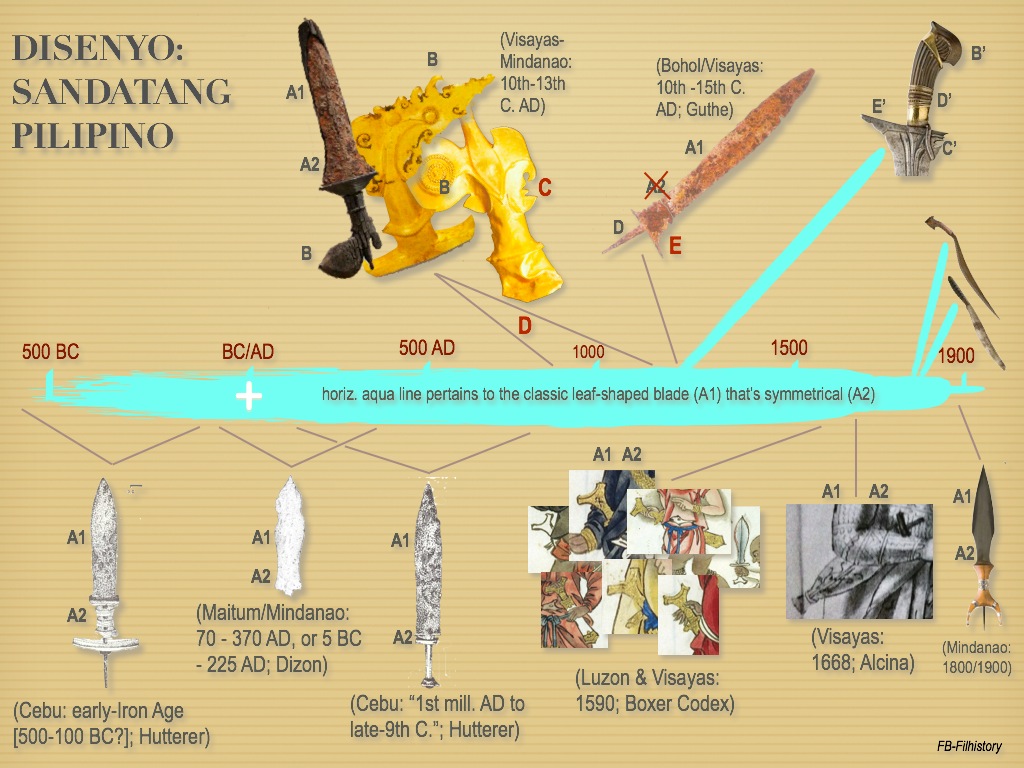

I'm presenting below a rehash of my earlier visuals. And this will enable me to outline more clearly my position. But lemme say at the outset that I'm not emotionally attached to this position
In fact if my theory (or anybody else's theory) can be demolished soon, then I think we will all agree that that's progress. That is, the whole point of the discussion is to merely find the 'best fit' in the data vs. the interpretation.
But first we have to agree on what defines a Moro kris. For me and simplistically speaking, a kris to be a Moro kris has to have the ffg.: (a) an assymetrical blade; (b) a ganya, i.e., the guard; and (c) that whole 'elephant trunk' assembly with the gaping 'mouth'.
I think it's reasonable to add a 4th one: a greneng, i.e., the blade trap, as I know of no Moro kris that doesn't have this. And let's add a 5th and final one: the tang has to be non-circular, otherwise it won't be an effective slashing weapon.
Thus the five items above would be the 'must have'. And the rest would merely be 'nice to have'.
Using the above criteria, obviously the Bohol kalis is not a kris. Bec. though it satisfies four of the criteria, yet there's no "c". But I think all of us agreed already that the said kalis is not a kris.
Yet still, for me that kalis is a key piece in the puzzle. And that's because the said kalis, planted the seeds of what will become the Moro kris. And so we now turn to the plate below.
First the easy part -- the lower half of the plate pertains to what we already saw before: the leaf-shaped assymetrical double-blade over time and space was the classic form, both in our islands and abroad (Indonesia, Malaysia, Cambodia, Thailand, etc.).
And I've made the thickness of the aqua horizontal line thinner as one reached the 19th century. What I'm implying there is that the volume of blades produced with that design declined, as more assymetrical and larger blades grabbed the limelight over the last 300 years or so.
Now on the upper half of the plate --
The group of three hilts/blade should actually be on the lower half of the plate. But I just ran out of space. Anyway, it's good to also place that bunch up on top, because together with the Bohol kalis, we can see the seeds of what will aggregate to become a Moro kris:
(1) the 'elephant trunk & mouth' ['C'] on the northern Mindanao gold hilt is for me a key evidence, that the Moro kris must have been homegrown -- and as a side note, the round thing on the other side of the hilt is reminiscent of some Moro kampilan hilts, as well as other Indonesian hilt forms;
(2) then the blade assymetry on the Bohol kalis ['A2' crossed out] is yet another baby step;
(3) still on the Bohol kalis, the guard/ganya ['E'], and its greneng [also 'E'] would be further proofs; and
(4) finally, the square or rectangular tang ['D'], starting with the 10th to 13th century pieces would round up the picture.
In summary, since all these big ticket items can be found on archeological weapons artifacts in our country, then it is reasonable to conclude that most of the Moro kris' features are homegrown (the '70%', if we are to pick a number from the air).
As for the 30% (the finer features of the kris, which can't be found on ancient Phil. kalises), that to me is just icing on the cake And I can attribute those to Java as the source of the design elements (and this is not to belittle Java in any way of course).
Pls. correct me if I'm wrong. But my impression is that you are focusing on the 30% as proof that the Moro kris was not homegrown. But wouldn't that be a case of the tail wagging the dog?
But as I mentioned, I'd also like to try and destroy my own theory, if only to find out what's a more plausible scenario. Hence, while we all await with bated breath and with great anticipation Alan's book, can you please comment on the following?
(a) what would be the oldest Javanese artifact or image, wherein we can see something like 'C' in the illustration below (in any weapon), and we are not looking for a whole keris, that is, just that particular design element -- once found, we then compare the age of that, vis-a-vis the 10th to 13th century dating of that gold Mindanao hilt bearing 'C';
(b) what would be the oldest Javanese artifact or image, where there's a ganja preferably with greneng, in an asymmetrical dagger -- again, we will then compare it with the 10th to 15th century Bohol kalis bearing those features; and
(c) finally I've always been intrigued on what's supposed to be the oldest Javanese keris/es, as recovered from an archeological dig; can you please post pics of those? given Java's very rich cultural past, I've always wondered why I can't seem to find pics of those, which I'd really like to compare with ancient Phil. kalises.
In summary, if certain key design elements will be found on earlier Javanese objects (as compared to the Phil. specimens), then I will happily move on and formulate a different hypothesis
PS - My fearless forecast is that in between the Bohol kalis (10th to 15th C. AD) and the present Moro kris form (17th C.?), there ought to be another missing link in which either the leaf-shaped blade would have straightened already, and/or the gandhik would already be there on the opposite side of the greneng, with the gandhik design element most probably coming from Java, together with the janul, bungkur, lambeh gajah, etc.).
BTW, 'B' in the plate refers to the sun-fire-bird motif, which can be traced to the ancient Austronesian religion that venerates those, as the icons of the Upperworld (and the naga or croc or turtle, etc., as the icons of the Underworld). And so we see a coherent picture, of how the archeological items provide evidence of a continous stream from the past to the present forms.

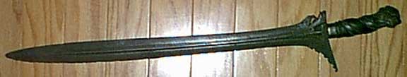

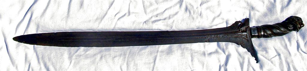

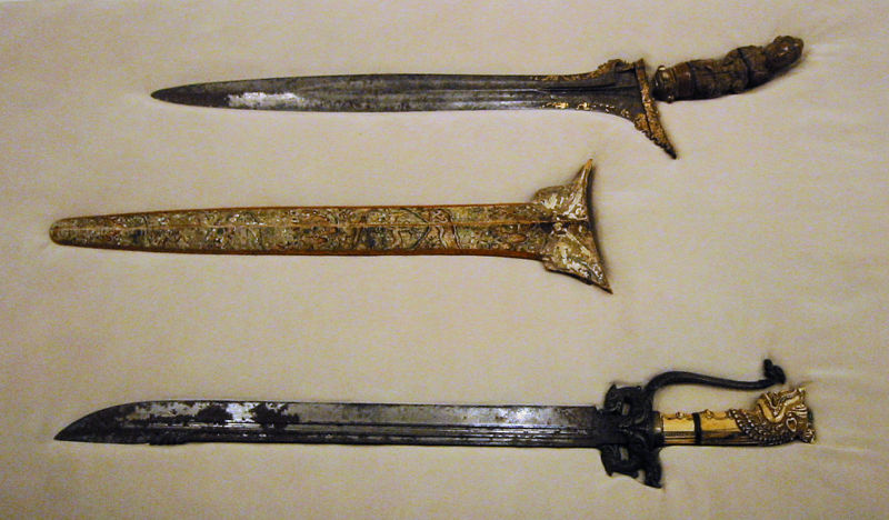

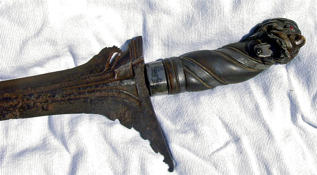

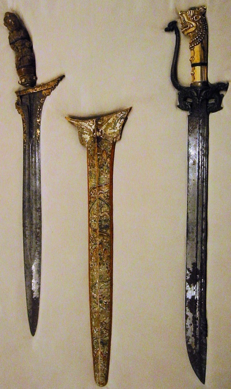

Given said pics posted by Gustav, then all the more I'm led to speculate that Ron's kris must have made by an Indonesian also, with the roundish tang and all ...
Dear Migueldiaz,
regarding the pictures I posted in#43, I would like to pose my opinion, which, of course has not much weight.
The kris without gonjo is the one nearest to the Javanese/Balinese keris. Yet even this kris has features we never would see on Javanese/Balinese keris, regardless of their age.
The kris with gold hilt is a big step towards typical Sulu kris.
Ron's blade in my eyes has a very Mindano like Gandhik area, which even would not fit the features of the more Jav./Bal.-like Sulu Gandhik. Here I really don't understand, why it has to be made from am a smith from present day Indonesia territory - just becouse it has a roundish tang?
[QUOTE=migueldiaz]
These ornamentics/symbols are found at many places in SEAsia, as you do remark by yourself. With the same ease you say this feature is Gandhik with 'elephant trunk & mouth' someone could remark it resembles Greneng. For a key evidence of a theory this likeness is a very week point.
[QUOTE=migueldiaz]
[QUOTE=migueldiaz]
As earlier mentioned, even early Javanese keris forms and pre-keris daggers also have a rectangular tang. It is absolutely nothing unusual&typical only for Philippines.
[QUOTE=migueldiaz]
[QUOTE=migueldiaz]
Here I would like to remark, all on Moro kris looks like a typical Keris-culture-periphery product: the symbolic details from Javanes/Balinese repertoire are taken and repeated in a increasingly ornamental way ("just icing on the cake"), with time progressing in features more and more typical for this peripheral region and mixing with the specifical ornamentics and symbols of this region. Such development per se is absolutely normal and absolutely typical.
Regarding the object from Bohol, the ancient japanese spearheads would give a more appropriate forefather of kris: you could find there by far more features similar to Moro kris. As I see, there (Bohol-object) is no Gandhik (ricasso) at all, and terms Gonjo (in this case Gonjo Iras) and Greneng would be need to be very stressed to fit the features of this object. It distantly reminds the silhouette of Keris Sepang or perhaps Keris Puthut, yet there simply are no Moro Kris Sepang and Kris Puthut, and no Moro kris at all, which would look like the Bohol object.

Miguel, Gustav has already answered some of what you have presented, but i will also give it a go.
This is good to hear. I also have no emotional attachment here, no horse in this race, so to speak. I am not tied to the present accepted theory of development, but do need to see solid evidence to the contrary before i would change my own opinion.
I can accept all of these except the last. As Gustav has pointed out there are indeed examples of Moro kris with round or rounded tangs. They cannot be ignored and they are not going away.
Perhaps we need to define our terms better, but on the Bohol kalis i not only do not see an "elephant trunk", but also NO gonjo/ganya, NO greneng and NO proper gandik. Please keep in mind that we are looking at this weapon in a very 2-dimensional format, but the blade appears very flat to me. I do not see a gandik by it's Javanese application on this blade.
I would also like to point out that this is the only example of this exact blade form which seems to have surfaced in the Philippines. That seems odd to me for the "seed" of what was to become the prevalent sword of the Moros. Where are the others and all the transitional forms?
I'd say there is little doubt that this gold hilt shows some of the stylistic flourishes that would be added to the Moro kris from the original Javanese design. But the "elephant trunk & mouth" were features well in place in Javanese keris centuries before they appear on "archaic" Moro kris.
The assymetric blade is classic to the area and did not originate in the Philippines. Certainly this ancient form influenced the early development of the Javanese keris as we can more clearly see in the keris buda.
I hate to keep repeating myself, but i do not recognize any greneng nor a gonjo/ganya on the Bohol kalis. A simple widening of the blade at the base is not what defines a gonjo. It is a separte piece that has both width and specific shape. Even when gonjo iras, it is defined by an incised line.
As both Gustav and myself have pointed out, square and rectangular tangs are not the invention of the Philippines. They were used long before the 10th century examples you post.
I am afraid that it is these "finer features" that you refer to here that is what actual make a keris/kris a keris/kris. They are not flourishes, they are the meat of the matter. You seemed locked a the rather superficial, 2-dimensional overall assymetric leaf-shaped blade. Also the blades must be examined in 3-dimensions to truly understand the shape and design of these features.
As i mentioned before, i think we can safely say the the "modern" keris emerged in the Mojopahit period, though elements such as the gonjo and kembang kacang may have developed earlier. Since no known Moro kris with these features seem to have been created until a couple of centuries later and when they do emerge that look almost identical in features to their smaller Javanese/Balinese cousins i have little else to go in as to which preceded and influenced the other. If you can show me a 13th-14th century Moro kris with all these features intact that might be a game changer.

Old 15th September 2012, 02:43 AM   #73
HERE ARE SOME PICTURES OF THE OLD AND UNUSUAL KRIS. IT IS 28 INCHES OVERALL, BLADE IS 22 AND 11/16IN. LONG. 4 AND 15/16 IN WIDE ACROSS TOP. HANDLE IS CARVED OF HORN WITH SILVER FITTINGS. IN THE FORM OF SOME DEAMON OR DIETY WITH TONGUE PROTRUDING. IT SHOWS A LOT OF AGE AND HAD A OLDER BLADE FORM LIKE A MALAYSIAN OR INDONESIAN KERIS. WE HAD A GOOD DISCUSSION ON IT IN THE OLD ARCHIVED FORUMS BUT I COULD FIND NO TRACE OF THE POST.
Old 15th September 2012, 07:17 PM   #74
Posts: 7,284
That's a very cool old kris Barry. I suspect that it is not Moro, but a Malay form. Seem obvious that this one was not made to incorporate asang-asang. If anyone can locate the old thread on this i'd like to read it. That hilt is very, very awesome!

Old 20th September 2012, 06:22 PM   #76
Gustav
Join Date: Jun 2009
Posts: 1,319
Barry, nice examples you posted there. It's now clear that the blade profile ('waisted') used in the Bohol kalis still lives.
Dear Migueldiaz,
this blade shape is not something reserved for Bohol object.
This is the picture of a keris with provenance. It came to Japan at 1620.

Old 21st September 2012, 06:47 AM   #78
migueldiaz
migueldiaz's Avatar
Join Date: Oct 2008
Location: Manila, Phils.
Posts: 1,042
Originally Posted by Gustav
... this blade shape is not something reserved for Bohol object. This is the picture of a keris with provenance. It came to Japan at 1620.
Thanks Gustav, for the pic. And I see that you've been talking about these objects for quite some time now. Nice discussion!
But may I know what the point is? Because at first blush, it appears to me that you are giving me 'ammo' instead That is, these objects were supposedly picked up in Manila (i.e., Philippines) back then, in the early 1600s. Hence, presenting these objects only help me bolster my contention that the 'waisted' kalis blade, just like the Bohol kalis, is an ancient Phil. blade shape (but for sure, there's no exclusivity, as this blade shape is also found in many other cultures) ...
Thus you need to make more explicit your points, please. Thanks again.

the point is, this blade is absolutely clearly Javanese/Balinese and has nothing to do with Philippines. That this blade was aquirred in Philippines is only one possibility, and this possibility is touched only in a wikipedia article. And I must say, I very possibly have read all existing publications about this keris.

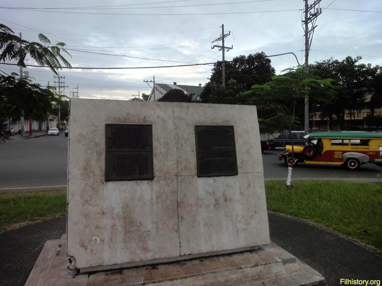

The connection between our neighbor Japan and its samurais vis-a-vis the Philippines, has long been there, even before the Spaniards arrived in the mid-1500s.
Off-hand, I can think of three solid evidences:
1. the Japanese word katana is a common synonym for sword for the ancient Tagalogs, as found for instance in San Buenaventura's 1613 Spanish-Tagalog dictionary; thus the presence of such loan word from the Japanese is sold proof that relations between our two countries had long been there;
2. when the Dutch had a naval battle with the Spaniards off the coast of Manila in 1600, the Spaniard galleon ('San Diego') which the Dutch sank was found later to have lots of tsuba (crossguard of katana) in the relics; I think there were also records that indicate that the Spaniard leader (Morga) hired lots of Japanese samurai mercenaries in that engagement; and
3. when some of the Japanese started converting to Christianity at that time, some of them sought sanctuary in Philppines which has become a Christian country by that time.
One of those refugees was a samurai warlord, which statue is right in the heart of the city of Manila (see pics). The name of this little park is Plaza Dilao (literally, yellow plaza). And here in Manila, we colloquially refer to the Japanese as having yellow skin, even up to now.
So what's my point? It's what I already mentioned in my previous post -- that Christian Manila (where the Japanese had a significant presence then, and even earlier) could have very well been the pick-up point for the quasi-Christian Sendai keris-kris.
