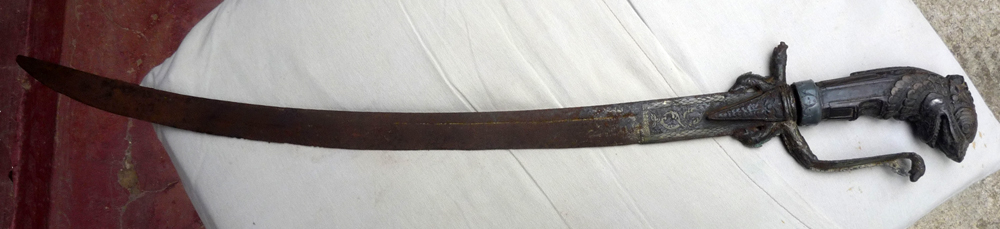

Hello Prasanna,
Thanks for posting that beauty! Any chance to obtain permission to post more pics of this sword (possibly in a seperate thread)?
It looks like the hilt is carved from wood (or horn?) with only a few metal highlights - very nice!
In a tropical climate, this state of preservation would be exceptional for an over 450y old pommel, even considering it being a heirloom piece!

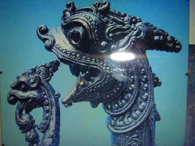

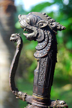

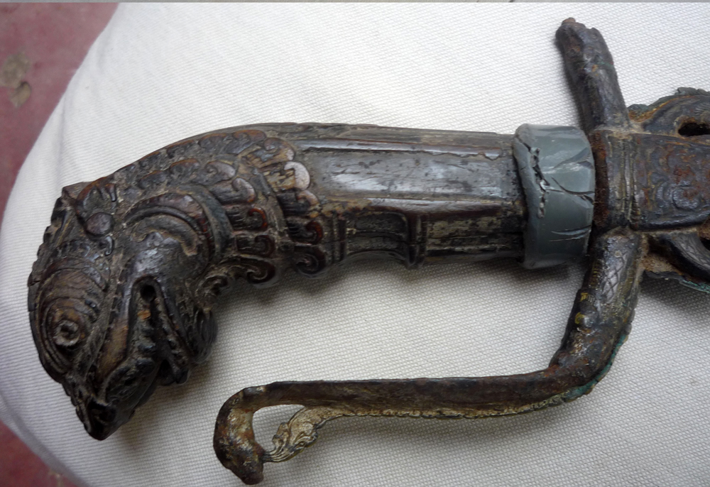

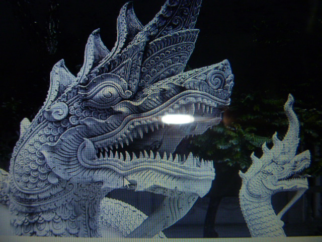

Salaams~ Pictorial note to Library.
See http://www.luxury-thailand-travel.com/makara.html
Pictures below showing;
1. The Kastane Hilt.
2. A Buddhist Temple in Thailand showing " Makara." Please note the neck detail.
Ibrahiim al Balooshi.

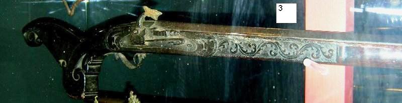

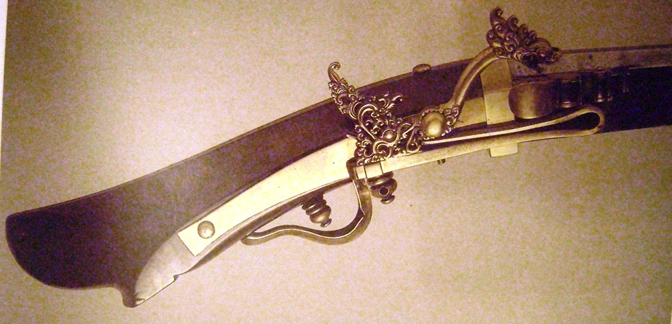

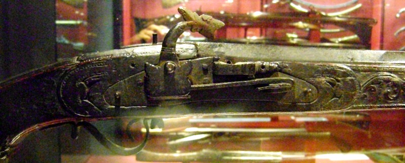

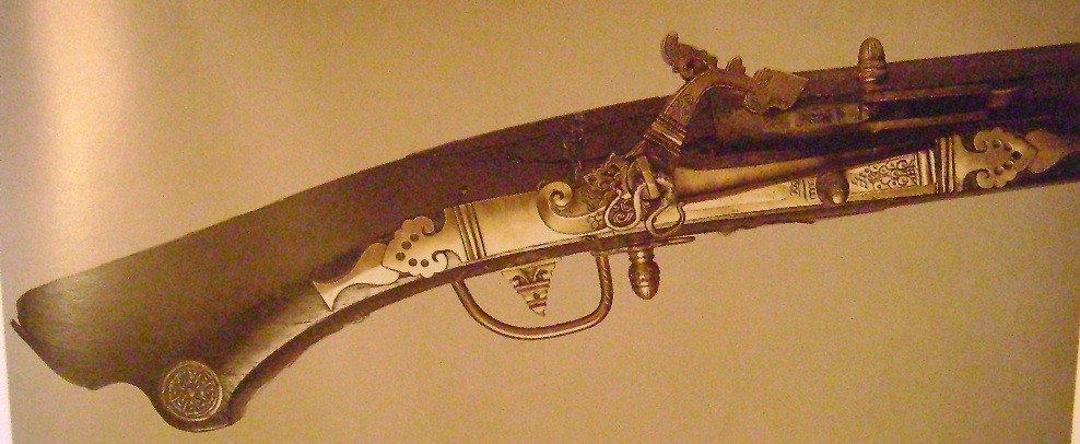

Attached we see pictures of three matchlock muskets ...
The first one a Portuguese-Shingalese example, still made in the XVI century, with a Portuguese barrel. Total length 170 cms.
The second one Shingalese example of great dimensions (195 cms). Dated XVII-XVIII century, it follows in all the model introduced by the Portuguese in 1505.
The third one (sorry the poor pictures) a fine Shingalese example from the XVIII century, with its typical bifurcated butt stock.
(Rainer Daehnhardt collection).

I wanted to point out the stature of Sinhalese arms production at about the time of Portuguese arrival, and it seems that they were already fairly well established and suggestions that perhaps Chinese contact earlier may have been the source for thier production. Clearly the joint results enhanced an already well reputed craftsmanship as far as firearms in some degree.
I dont believe any influence is evident for the kastane from Portuguese or European sources, though I think that there were varying alignments between different kingdoms and them overall.

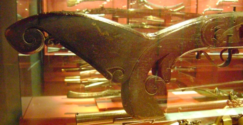

Salaams fernando~ On the face of it (excuse the pun) one would not normally expect to see a design reference similarity on a firearm and a sword~ but there it is (#66 photo 2)...on the lock the jaws and head of a Makara. In this case not breathing other serpents into the pan; but fire.

Kai, I will try to get a set of additional images of the sword with the permission of the owner. Hilt as you say is horn and guards all of steel with brass inlay work. There are many swords surviving specially in Buddhist and Hindu temples that are said to be weapons gifted by King Rajasinghe I post to war victories. very few of these are Kasthana, with most being captured Portuguese swords. But this may indicate the possibility of a piece surviving under protected conditions.

Salaams Prasanna Weerakkody ~ Well if the Bondikula have Makara heads on the locks which are pretty well identical to those on the hilt of the Kastane ... and reflected in the two headed axe earlier as well as every picture of Kastanes so far... does that mean we are searching for this motif (The Makara) and not the Lion ?
Fernando ~ Your excellent references pose a problem, since, it more or less indicates that Portuguese and Sri Lankan workshops were working together to produce weapons and in a definable time slot. In doing so is it not feasible that they also combined decorative techniques as shown by your fine pictures of the guns with Makara locks?
If that is indeed the case we have a pointer to the possible "combined construction" of other weapons including Kastane which is interesting (even if it does mean that we are at full circle in determining more closely the origins of that sword, though, now with a completely balanced set of parameters).
Obviously, since The Portuguese were supported by a large section of the Sri Lankan fighters (coercing mercenaries was a very major part of the Portuguese "modus opperandi" ) it is entirely possible that this craftsmanship liaison could have occurred well prior to their late 17th C dominance. Target range mid to late 16th C perhaps?
Thus we may have a time zone;the mid to late 16th C. and a specific style to search for; Incorporating The Makara Hilt through a liaison between craftsmen; Portuguese and Sri Lankan.

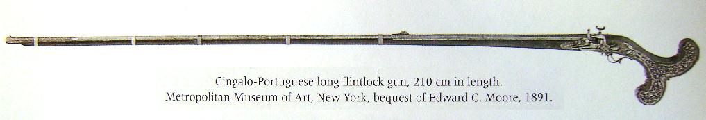

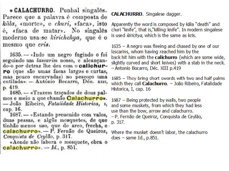

I bet you would know the work of Portuguese Captain João Ribeiro translated as The Historical Fatality of the Island of Ceylon, which memories he sent the King in 1685, where he gives account that Sinhalese war people used following arms;
Short swords of two and half palms (spans) which they called calachurros. The soldiers are Lascarins, some lancers with eighteen palms lances, some others musketeers, being rather sharp shooters; assuming these are not stone (flintlock?) but cord (matchlock?), they have spring as if they were. Others are archers and very good in that. Some bring muskets with eight palm barrels and forty pounds weight, shooting four ounce bullets. However they don't shoot them against their chest but have in the forearm two legs with one côvado (45 cms.)length ... they call these standing muskets ....
The most intriguing of these weapons is what they called calachurros, a term potentialy 'moulded' into portuguese, which i wonder if you Prasanna would familiar with, as to know its actual Sinhalese term and actual weapon model.

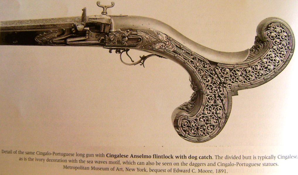

Just for fun a couple pictures of a beautiful Cingalo-Portuguese 'espingardão' (long gun) kept in the Metropolitan museum. Contrary to Jawa and Japan where in principle only matchlock models were copied, Goese and Sinhalese gun smiths also reproduced the so called Anselmo lock.

Salaams Prasanna Weerakkody ~ Thank you for the post. The difficulty I have is multi-facetted (rather like the problem).
The hilt is Makara. It breathes other deities onto the hilt in the proper manner for a Makara. These deities appear to be either Nagas (serpents/snakes) or smaller Makara and as shown by the little face which appears to be the half human half crocodile on the knuckleguard at Fernandos post at #56, once again, only released by Makara (FROM ITS MOUTH) and as seen coming from the Makara mouth at #57 photo 2; not from a Lions mouth.
The tails of the supporting other creatures appears as peacock designs and falls in line with Makara tail design... and which you agree are small Makara. These Makara deities do not emanate from lions mouths.
The Lion motif, on the other hand, can also be seen in the jaws of a Makara on architectural forms. I believe therefor that the Kastane Hilt is a Makara. Rounded or sharp teeth make no difference. It may be down to artistic impression but the form is The Mythological sea monster; Makara not Lion. See #25,39,52,62 65... etc
I use the example of the gun lock and the earlier axe plus the so far illustrated Kastane Hilts to demonstrate my observations.
It therefor transpires that research into the Kastane Makara hilt must be observed during the build up and possibly before the Portuguese position in the late 17th C.

Old 21st October 2012, 05:34 PM   #74
Originally Posted by Prasanna Weerakkody
... Kai, I will try to get a set of additional images of the sword with the permission of the owner....
A picture showing the lower part of the guard will be so much important; to check on the presumed Portuguese influences ... you know, the lower quillons bending in a closed arch towards to the blade .

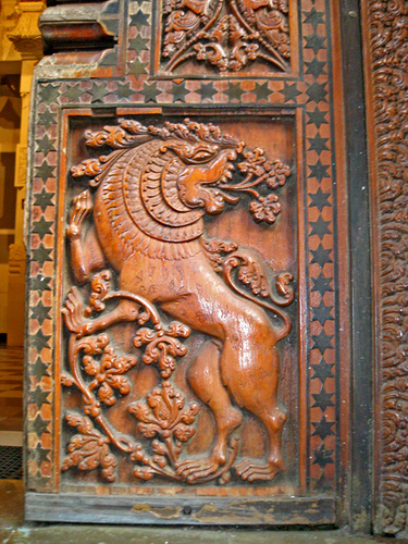

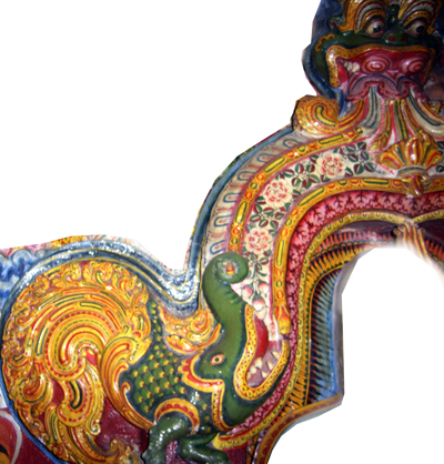

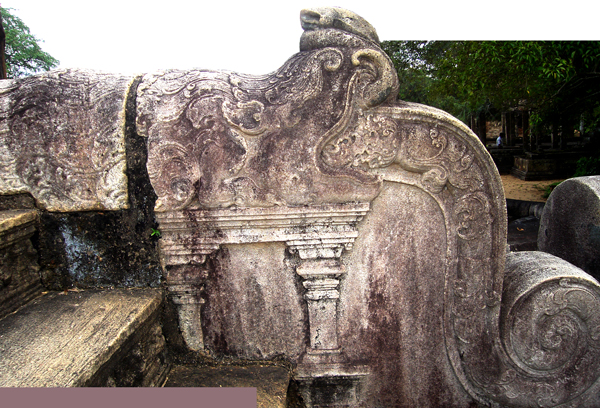

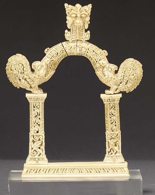

Balooshi, Including two images of Sinhala Lions with floral motifs emerging from the mouth. They are not Makara; as the body clearly is of a Lion not Makara.
Salaams Weerakkody ~ Nice Lions. They are however not breathing Deities or monsters. The stuff coming from their mouths is floral.
Makara breath monsters... Nagas (snakes or serpents) and the half crocodile, half human form variously as seen at almost every Kastane hilt and related picture on this thread. These sub-monster-deity forms include the often portrayed minor Makara sliding down the knuckle guard and onto the finger-ring like quilons and in addition displaying fan tails of the peacock... The Peacock fantail is yet another Makara indicator. (see #56.)
Makara are shown on the gun lock jaws, the axe, and the Kastane.
I put it to you that your Lions are late additions and unrelated to the Kastane Hilt which is of Makara form. In later forms perhaps post 18th Century I imagine artistic impression may have blended the two heads on certain projects though I urge that what we ought to be focusing upon is the original style Kastane hilt ...The Makara.
As a note to Forum I point to http://www.caravanacollection.com/?p...=kastane-sword (look also under Collection)where the author quite neatly describes the hilt as Makara and goes further to state the similarity of the guard with Mediterranean weapons previously not seen on Far Eastern sword styles and puts a 16th C. dateline to the mixture. I tend to agree with much of that.

Balooshi as I have noted in one of my earlier posts, the predominant Makara form in Sinhala art of the period emanates floral rather than animal motifs from its mouth. Including a few example images for reference.
Also the issue is not about the occurrence of Makara forms in the Guards etc. but the primary figure on the pommel Which is commonly accepted as a Lion head. - I cannot recollect seeing any figures portrayed on the Pommel depicted with other figures originating from its mouth except an extended tongue. If you got references to it pl. share.
Prasanna Weerakkody is offline   Reply With Quote
Old 24th October 2012, 09:56 AM   #79
Ibrahiim al Balooshi's Avatar
Posts: 4,408
Salaams Weerakkody, 3 out of 4 of your photos show Makara having spilled out the Kirtimukha monster (itself normally seen, as it is here, on all 3 photos, devouring other monsters) and usually displayed at the top of the archway designs.This has been dealt with in # 57.
The 4th picture which is more difficult to analyze appears as a grey looking Makara rolling out a huge long curled serpent with fiery decoration or waves or other minor monsters engraved on it though it is difficult to deduce.
The floral additions that accompany the emission of deities and monsters in your pictures are secondary to the main theme... The Makara spews up primarily monsters and deities. The floral tributes are as a secondary, less important, added design feature.
If the Lion were the source upon the Kastane Hilt the accompanying main theme on the hilt would be floral... Its not..It is deities and other monsters because the hilt is a Makara design. Any flowery aspect on the Hilt is purely supporting but secondary to the main theme.
The Hilt, The KnuckleGuard, The Quillons and The Cross Guard are of one linked style. The Makara head at the Pommel pumps the half crocodile human "face" onto the mid Knuckleguard and minor Makara onto the Knuckleguard top and base plus Makara and Nagas onto the Quillons and crossguard. The tails illustrated are peacock form. Some secondary, quite flimsy, floral work usually appears on the grip and /or extends down the throat.
Therefor i would advise against separating the pommel decoration from the rest of the Hilt. The theme is the same ... Makara.
Best example ~See # 56.
Makara not Lion.

Dr. Jorge Caravana, a medical surgeon, started collecting antique arms & armour by 1998 and in 2009 he organized an exhibition in the Portuguese city of Évora. An actractive catalogue was then published, composed by the collection and vast texts covering the places touched by the Portuguese, namely an introduction by historian Rui Manuel Loureiro and thematic material like an article on Indian Weaponry Goldsmiths by Nuno Vassalo e Silva, another on Persian swordmakers by Manouchehr Khorasani and even another on Islamic Arms and Armour by Robert Elgood. Eventualy i have acquired one copy and, having posted its reference in the forum, i was required by several members to send them a copy.
http://www.vikingsword.com/vb/showth...light=caravana.
The collection is composed of Oriental items associated with the Portuguese expansion during the discoveries period, a theme adviced by Collector/Historian Rainer Daehnhardt, from whim he acquired his first examples in 1998.
In the case of Ceylon, not much data is referenced and only four examples are present in the collection, being one of them an XVIII century Kastane. The description of this example includes, besides its visual details, the interpretation of its origin as a weapon, not a scholar assumption by Dr. Caravana but one more based on the classics that are published out there, which he promptly mentions below the sword support text; among others, Cameron Stone, from whom apparently he brought the pommel 'monster's head' idea and, from another (Czerny's, Rickets ?), the version of the Kastane origin being connected with European contacts in the XVI century, a presumption rather more doubtful than being an earlier sword, later suffering European (Portuguese) influences. I don't think that Dr. Caravana's third party quotations are more accountable than just that: quotations ... not personal qualified evidence.
Old 24th October 2012, 05:45 PM   #81
Posts: 4,408
Salaams fernando ~Excellent input. The book detail is superb.and your pictures of the gun lock and supporting Kastane photographs have been an inspiration.
Is there any documentation which can be extracted from the publication you mention which may be logged here in the interests of research? This could indeed be supporting evidence on the theory that the Kastane was a Portuguese-Sri Lankan designed sword probably 16th Century with, it seems, a Mediterranean hilt style co-staring with a Makara pommel and incorporating other deitys and monsters on the Knuckle Guard and Quillons etc.

Old 24th October 2012, 07:38 PM   #82
Hi Prasanna
I (re) found something very interesting; wonder if you were already aware of this.
Sebastião Rodolfo Dalgado, a specialist who has previously published a work in Indo-Portuguese Dialect of Celyon, has published in 1919-1921 the Glossario Luso-Asiatico.
BOOK
In page 178 you can read the following, which i (sort of ) translated:

Balooshi -All images I presented (posts 76 and 78)on the Lion and Makara figures are for one purpose- to illustrate
1. Not only Makara figures are portrayed with figures emanating from their mouths.
2. In a SINHALA CONTEXT most Makara figures do emanate foliage (all images included) and is not limited to beasts.
Also I don’t think you can assess the elements purely on regional references. As with the difference in Swords; the Sinhala Motifs have its own sub culture distinct from the regional/ Indian system. All assumptions must be based on this.
Strangely it seems you are UNABLE to see the differences that define the “species” of beast heads that figure on the Kasthana swords. Please check definition in my post #23. for a definition which expands on format given by Ananda Kumaraswami. Your assumption “The Hilt, The KnuckleGuard, The Quillons and The Cross Guard are of one linked style” and your “advise against separating the pommel decoration from the rest of the Hilt” are in Error.
There are three common types of beasts portrayed on them. The only figure that emanates a secondary figure consistently on the Kasthana is the figure that appears at the base of the Knuckle guard. which is almost always a Makara. the figure on the opposite terminus of the cross guard also on occasion extrude a short floral extension. On some instances the terminal figure of the Knuckle guard is portrayed emanating either floral or animal forms. This figure is either of a Serapendiya or Makara design. The Quillons too can be either Serapendiya or Makara. on occasion the figures on the cross guards also consist of Serapendiya heads. It is also important to note that the Serapendiya is also figured with forms appearing from its mouth which seem not to be limited to the Makara. The Lion only appears on the pommel of the hilt and is not proper on any other part except in some weak later period swords that do not follow tradition properly. I cannot recollect seeing any Kasthana with the pommel Lion figure emanating anything from its mouth except for a simple extended tongue (consistent with lion figure in other Sinhala art forms)
Image of a possible deity on a Kasthana occurs infrequently on the outer surface of the Knuckle guard which is still not identified with certainty as yet. Godesses Sri Devi and Patthini are the most likely candidates though it may be just a figure of “Nari-latha” or a figure of a Half woman half plant form. (This is possibly a matter for a separate thread of discussion) There are no cultural elements defined as Nagas in a Sinhala context that can be associated with motifs on the Kasthana. In rare occasions figures of similar deities may be found in the ricasso as well.
Note on images in post #56
The top Kasthana originating from a latter period workshop is highly influenced by British or late Dutch (?) design. it seem to not have too much Sinhala cultural discipline. The pommel figure still carries three ruffs signifying it is a Lion head. The other figures are strange as the faces are modeled as lion heads (similar to most late period degenerate Makara forms) but without the ruffs… they do not show the distinct short proboscis that make a Makara a true Makara.
The lower figure of a Kasthana from an earlier period; for me is my period of interest in Kasthana where the source of its origin, design and real function lie. Here the pommel figure is again clearly a lion of the early period design (not of European influence) with the distinct three ruffs. The terminal figure on the extended knuckle guard is a Serapendiya while the other four figures at the base of the hilt are all Makara.
Fernando,
Always a pleasure to see your interesting posts. -thank you for sharing. In surviving traditional form there is a type of knuckle duster known as “Kala-kiringne” (I am not sure how to spell this proper; it’s a very nasal pronunciation akin to some other words with links to Portuguese descent”) The indirect association of “Kala” with death is sound- as found in “kala-thuwakku” (Cannon), “Kalama” (curses used in war) and “Kala-kiringne”etc.. Kirichchi as you say is a short stabbing dagger similar to a Kris. There is also another short dagger with a two finger grip which is sometimes attributed to Kala-kirichchi as well. I was not confident of its link to a short sword.

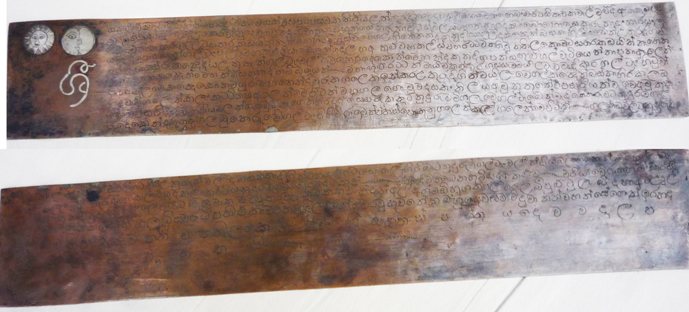

Default Additional Early Kasthana records
The following images were kindly sent to me by Mr. Ajantha Mahanth-arachchi who is a master of a Angam school of Korathotha
This sword is believed to be gifted by King Buwanekabahu VII of Kotte Kingdom (1521-1551) to the family of an ancillary prince(?) named Range’ Bandara. His descendants are still in possession of the Kasthana shown below as well as 2 Patisthana and one “Hella” spears, an ornate kris and a deed of a gift of land written on two sheets of copper issued under the name of the King.
In addition to the references I provided in posts # 62 and #87. this will provide additional evidence to support an earlier date for existence of Kasthana swords to mid 16th Century.
(Images of kasthana and Copper plates included)
Glad to have contributed in some measure to the understanding of the Kasthana. While being far from an expert on swords, my work as an Artist/painter specializing in re-construction of Ancient Sinhala lifestyle with a main focus on Ancient Sinhala warriors I have been involved in the study of Sinhala Art history and weapons and armor for a while. I hope I am more qualified in assessing material with a better footing on Sinhala culture and traditions and Traditional art practices. And hope we could take this discussion to a good conclusion.
My interest in Kasthana is to trace its origins, the sources, evolution and the time frame. and to better define the Kasthana with a understanding of the design elements. hence my perseverance to establish the true identity of the elements of the sword.
As I noted before I do not recollect seeing any Kasthana with pommels identifiable with Makara forms. If there is any specific candidates we should share them and assess them individually to set the record straight.

A magnificent Cingalo-Portuguese powder horn; in principle the best known example produced in Colombo during second half XVI /first half XVII centuries. Probably made for a Cingalese Monarch or someone of high rank. The dragon body with ruby eyes is built with chiseled silver covered by with a thin perforated ivory net. The flask mouth has a human figure, possibly a Portuguese, judging by his dressing. The gunpowder pours by his head, while he is praying; this could be interpreted as he wishes the gunpowder is used for well doing. The lid is a Goruda, which releases the gunpowder by pressing its tail.
A real master piece.
