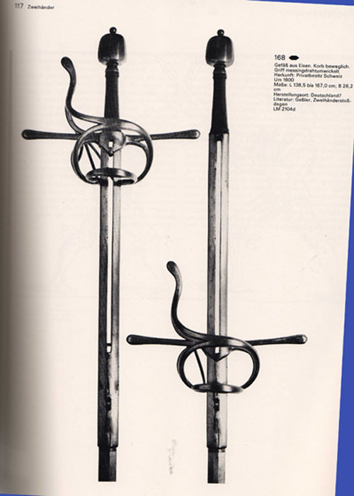

Hi All,
While it isn't a sliding weight, the sliding hilt does change the point of balance. This is from the Landesmuseum.
Jeff

Jeff, don't hold us waiting too long - which Landesmuseum?
There are several in the German speaking countries - so where is it?
BTW thanks very much for being the first to show a sword with a gliding weight
Jens
Jens
Oops Sorry Jens, this is the one in Zurich!
Jeff

Hi Jeff,
Neat sword! I think it's a solution to a different problem, though. There's a book out there (forgot the title) that's a translation of a late-medieval German swordmanship manual.
In that manual, they show the proper way to use a long sword (i.e. hand-and-a-half sword) against a foe in plate armor. Basically, you have to have gloves, on, because you grab the sword half-way up the blade and use the tip as a bayonet/pry-bar to attack the cracks in the armor at extreme close range. I say bayonet rather than short spear, because the the stance reminds me of the way one holds a rifle with for bayonet practice, as do the moves (short stabs and swings, using the pommel and guard in place of the rifle butt).
My suspicion is that this sword was designed with this half-sword grip in mind: Normally, one's finger holds the guard at the base, but at close quarters, you grab the pommel with the other hand, push the guard forward with the lead hand, and use it in a half-sword grip, without sacrificing the guard on the forward hand.
As far as swords with sliding weights, doesn't Stone's Glossary have a picture? I don't have my copy with me, but I have a memory that it does.
Fearn
