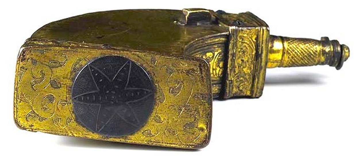

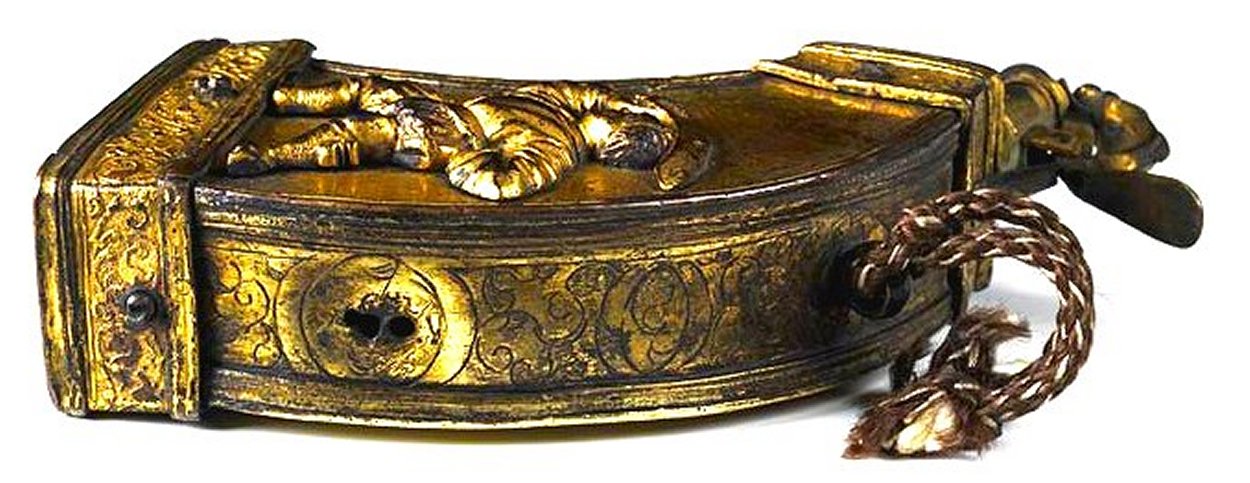

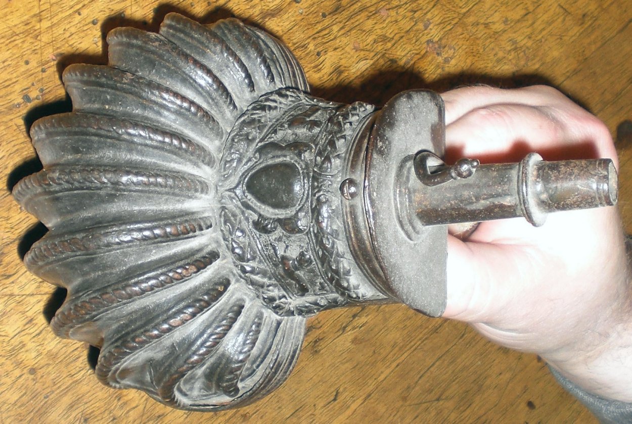

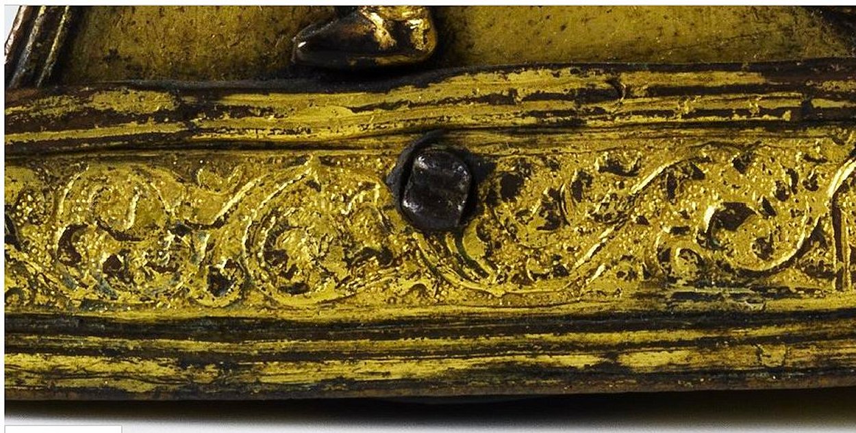

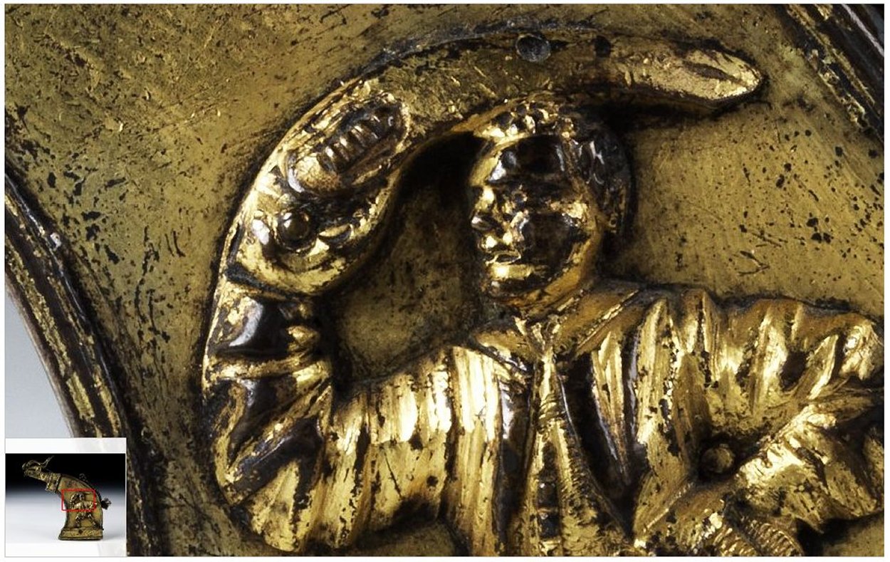

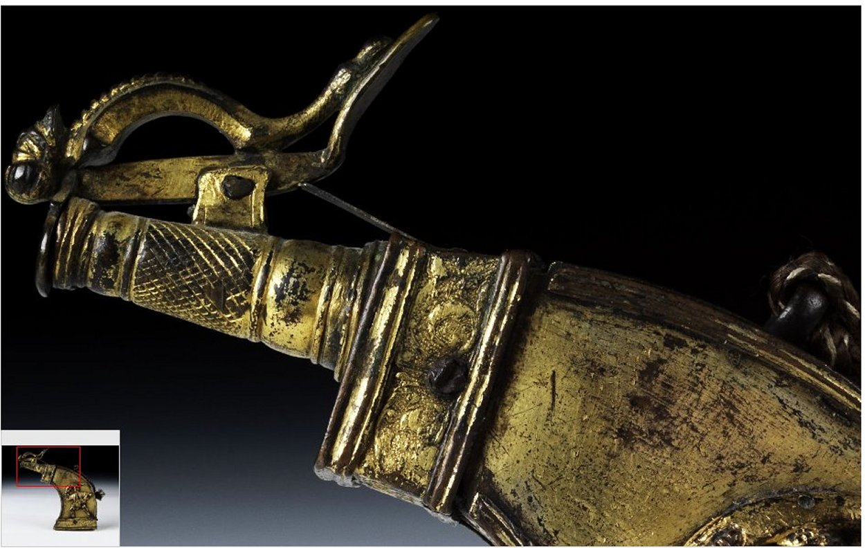

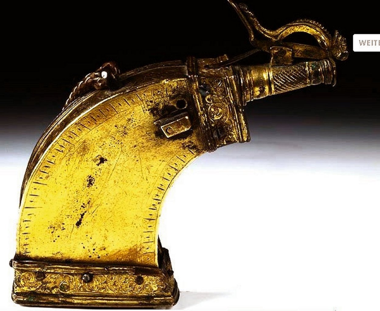

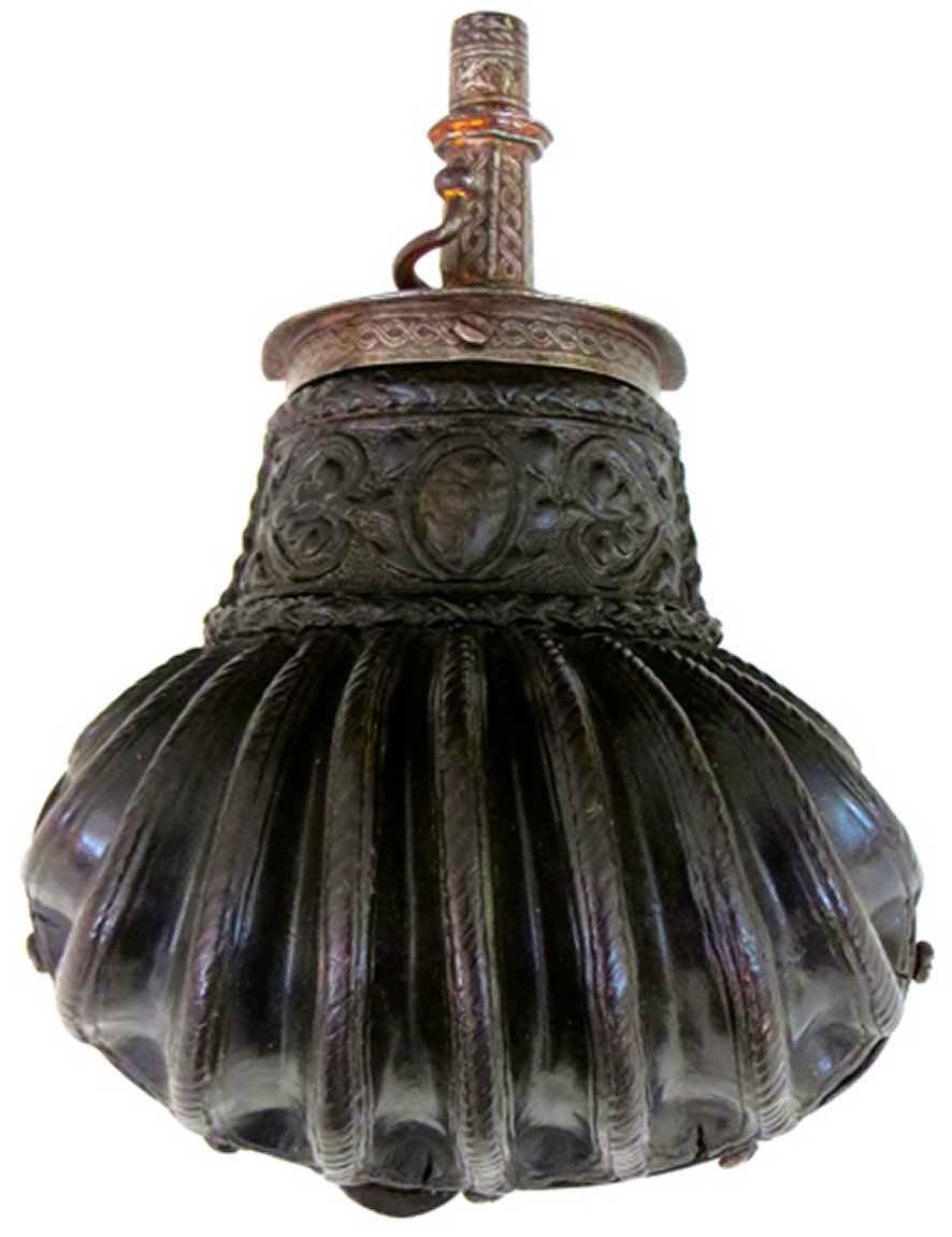

Two more of the Saxon flask with the elaborately pierced and gilt mounts.
And the gilt-mounted Augsburg or Nuremberg flask, its body made of copper-gilt brass throughout.

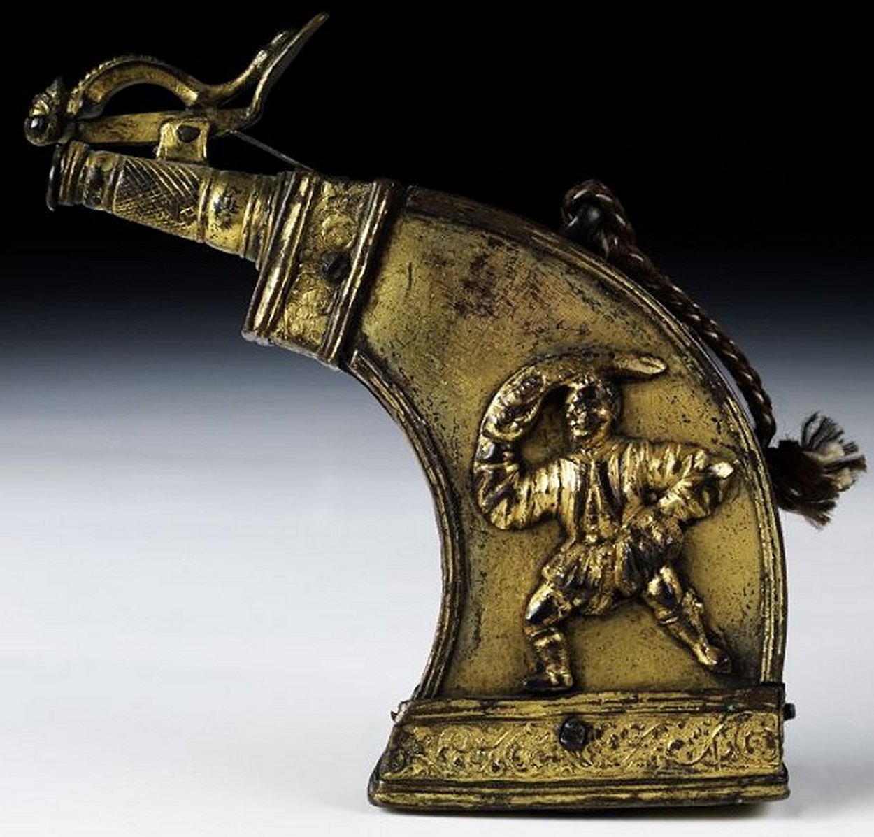

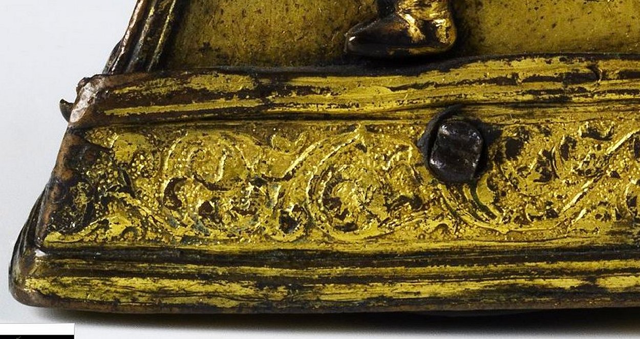

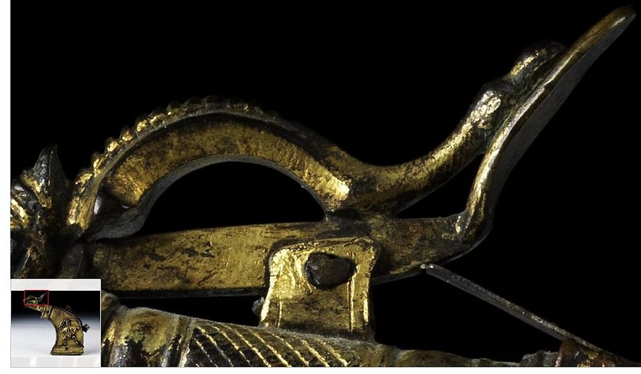

More of this stunning flask in the North Italian manner.
I seems like there is a central ball compartment in the bottom mount.

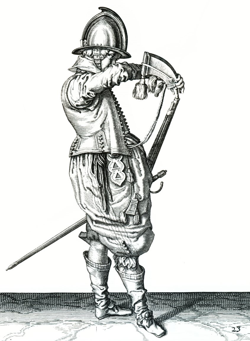

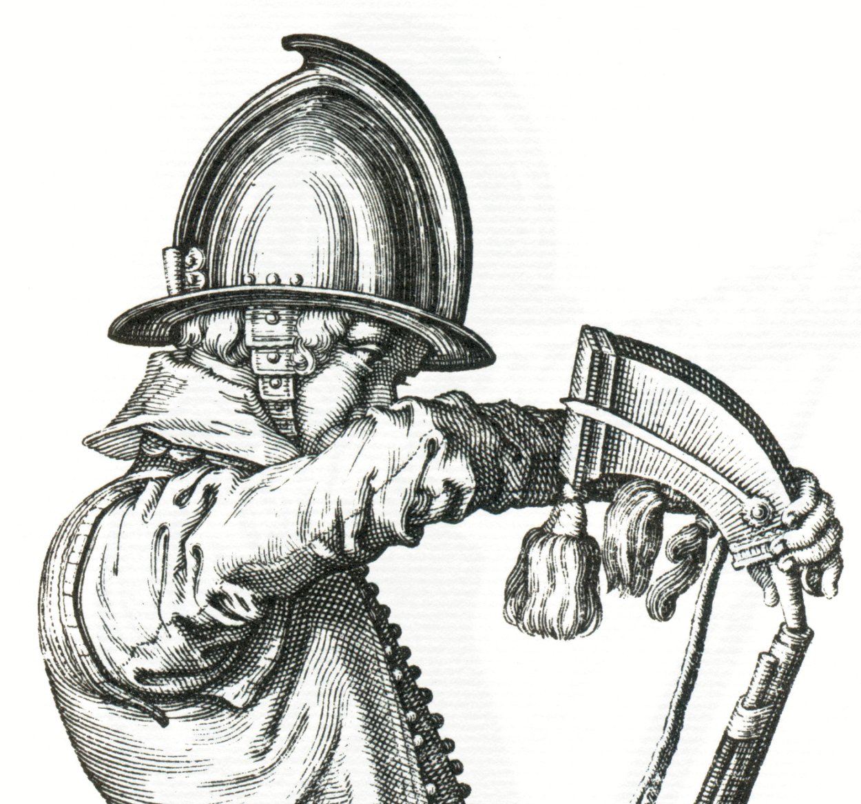

Jacob de Gheyn's caliverman (Schütze) filling a definite portion of powder from his horn (note the frog hook!) into the barrel of his caliver (Schützenrohr), 1608.

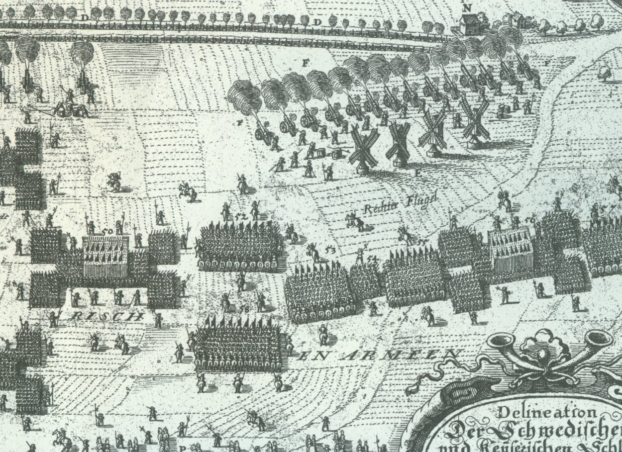

The fighting order at the Battle of Lützen, Nov. 16, 1632, of both the Swedish and Imperial forces.
m

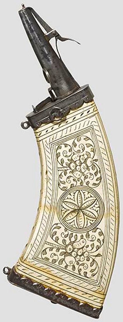

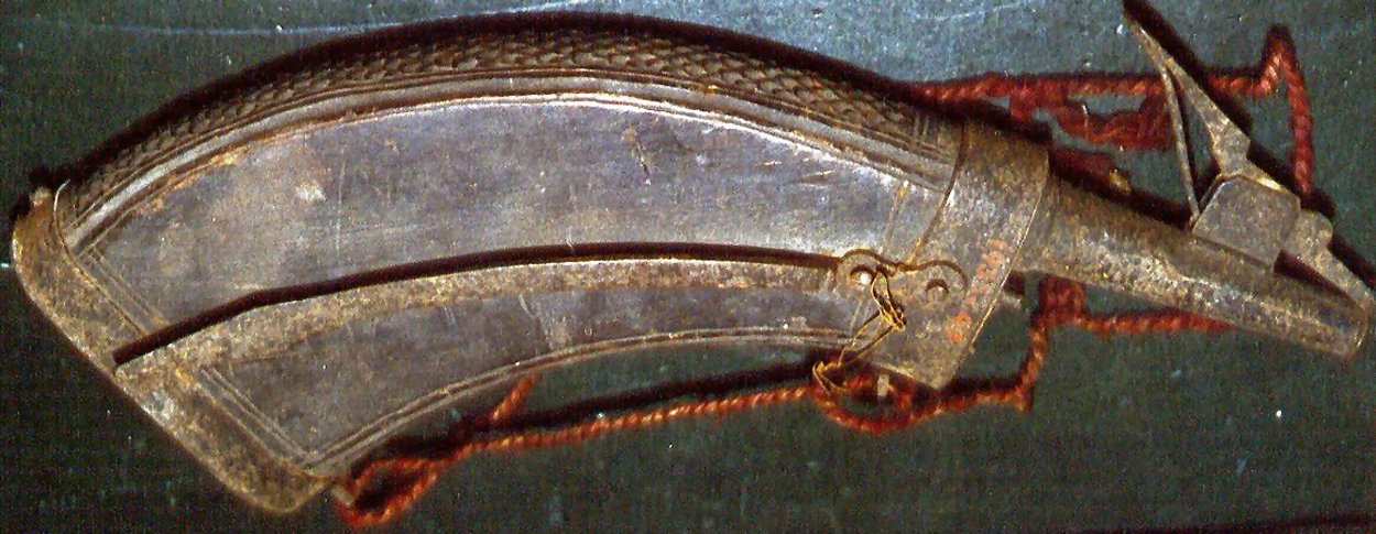

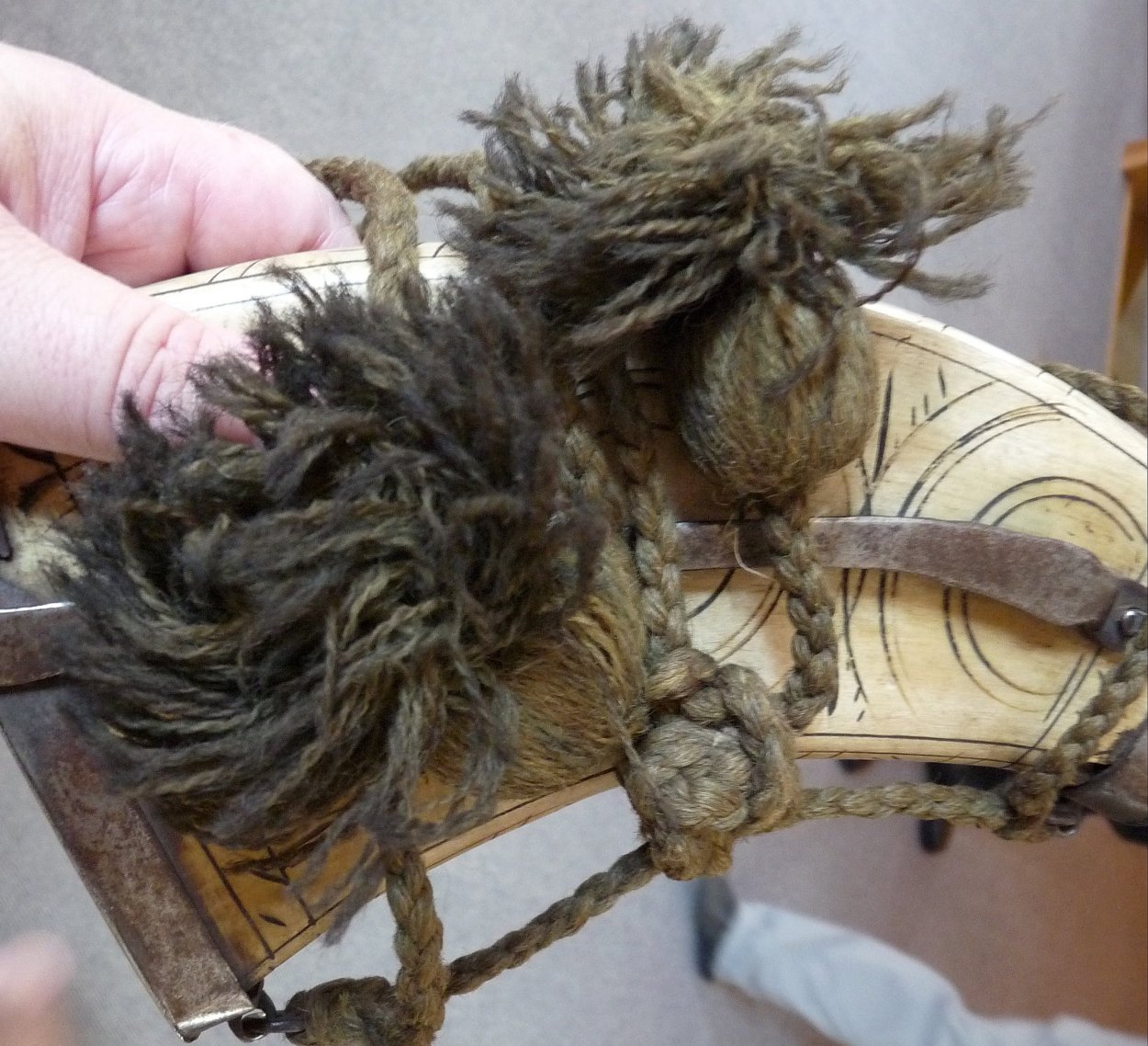

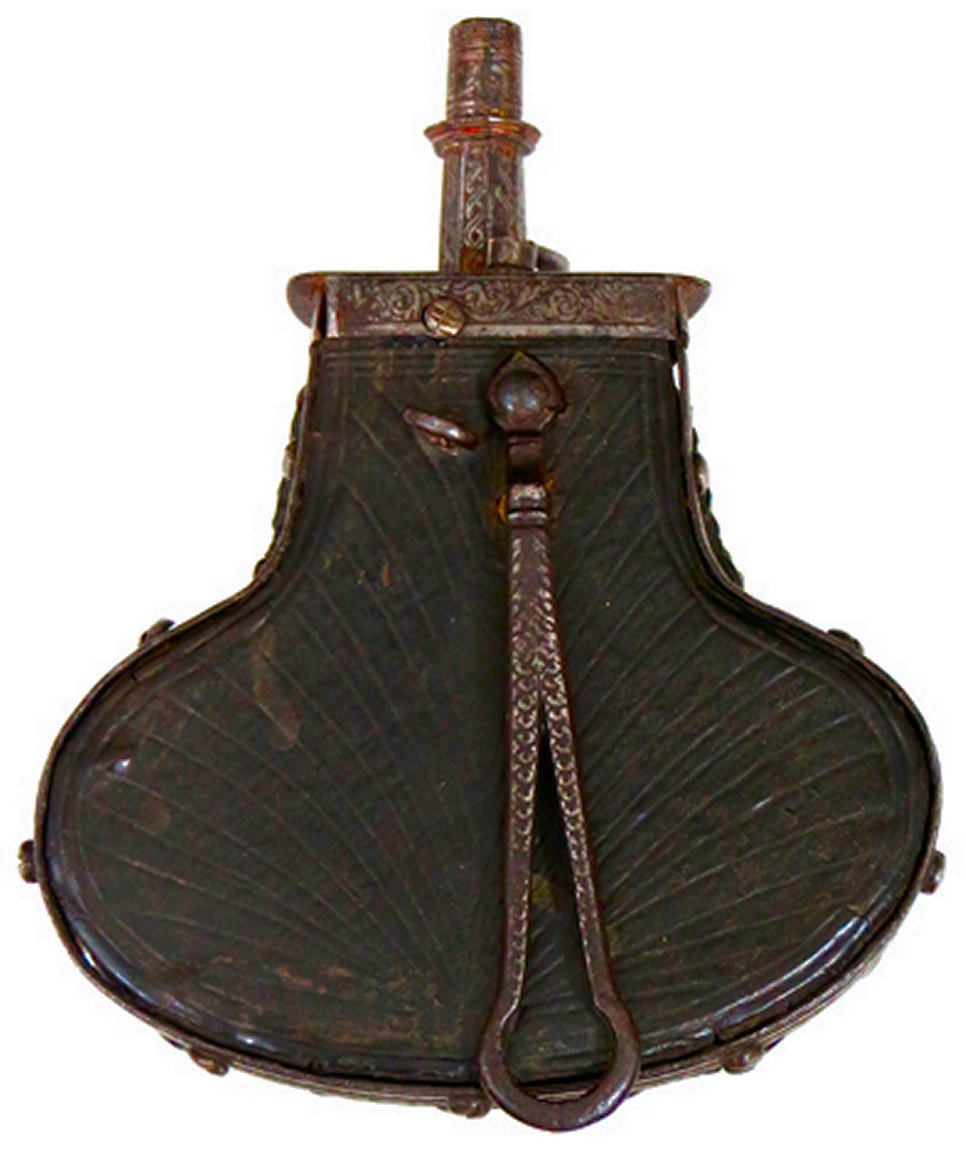

This finely made Nuremberg specimen I photographed at an auction viewing in 2009.
Please also note the close-ups of the original woollen tassels of another caliverman's flask.
m

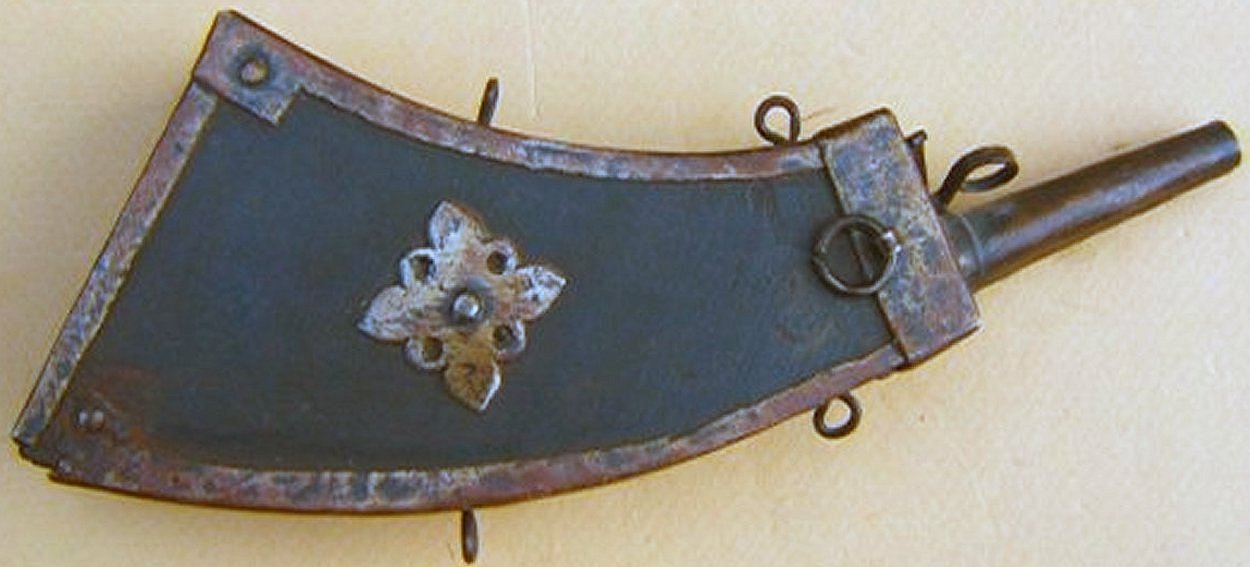

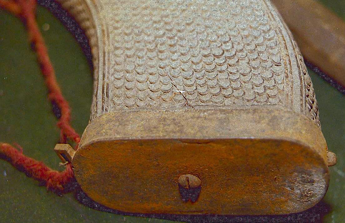

On the right is a caliverman's flask with plain wooden body, ca. 1580-1600, in the reserve collection of the City Museum of Köln (Cologne).
Author's photo, 1987.
For more on trapezoid flasks like those depicted in the photo, please see my thread
http://www.vikingsword.com/vb/showthread.php?t=15724

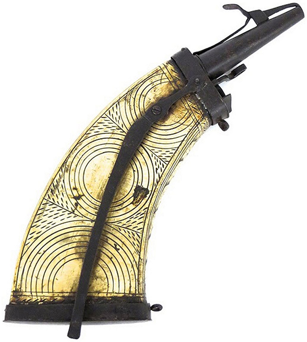

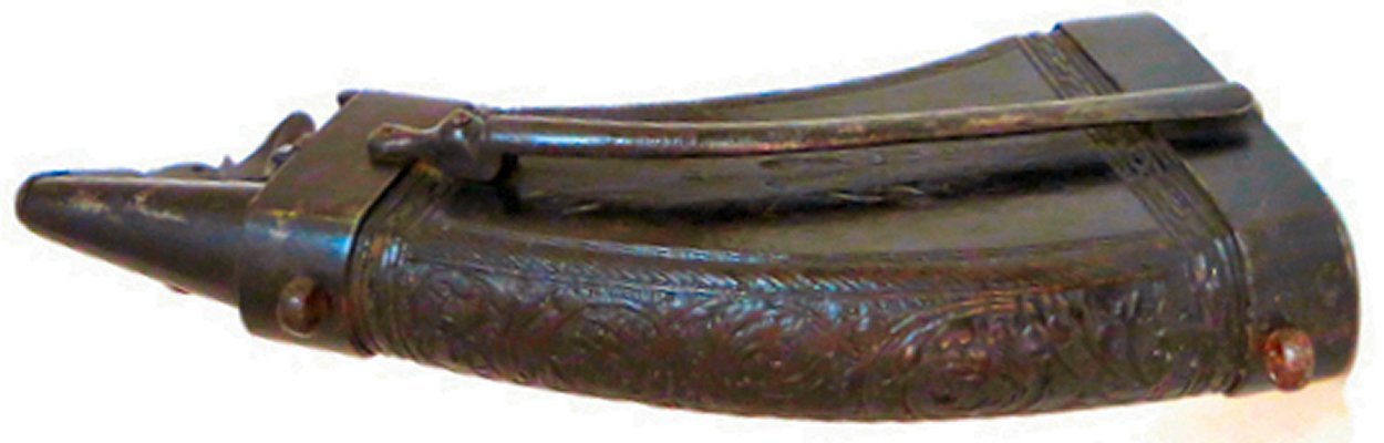

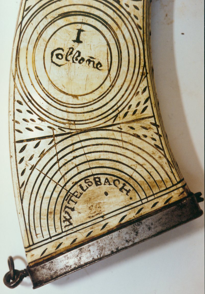

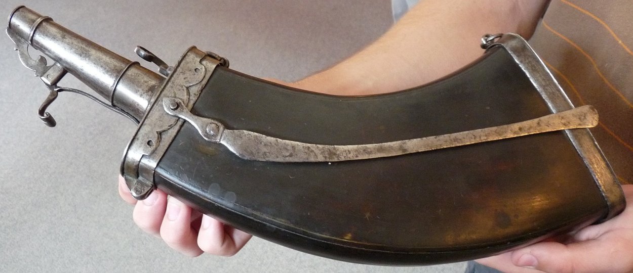

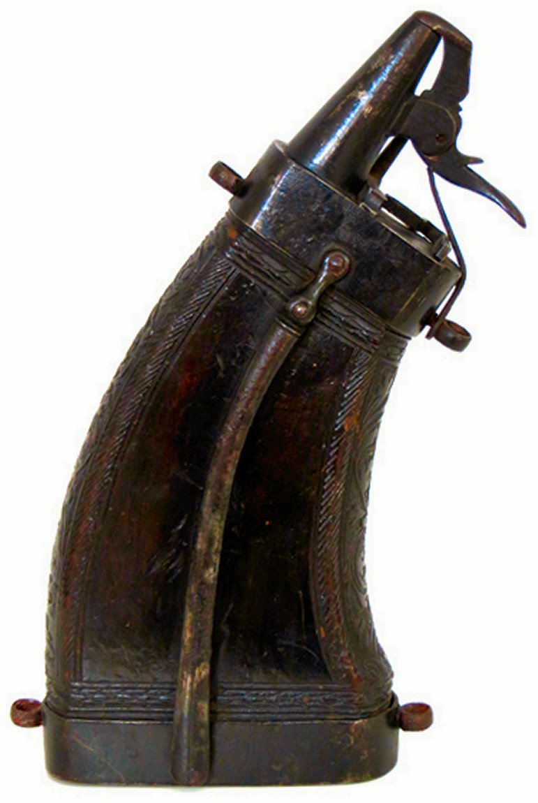

A characteristic Nuremberg made and engraved caliverman's flask of bleached cowhorn, retaining its originally blackened iron mounts and frog hook, the body dated 1607.
Please remember that, contrary to the dealer's assertion, this is NOT a musketeer's flask!
m

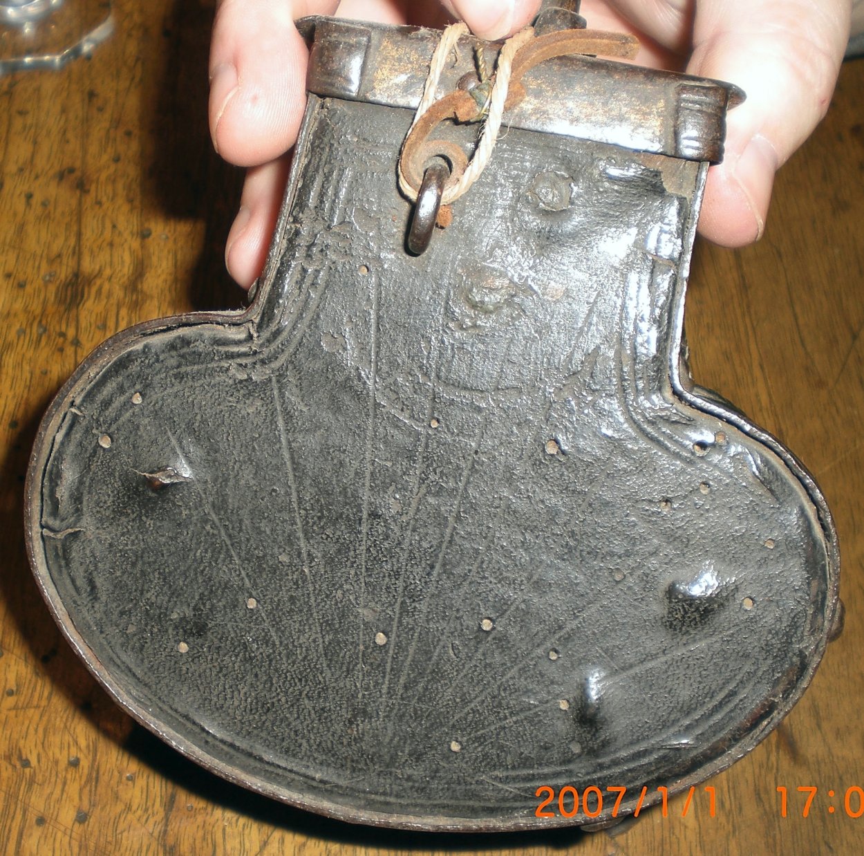

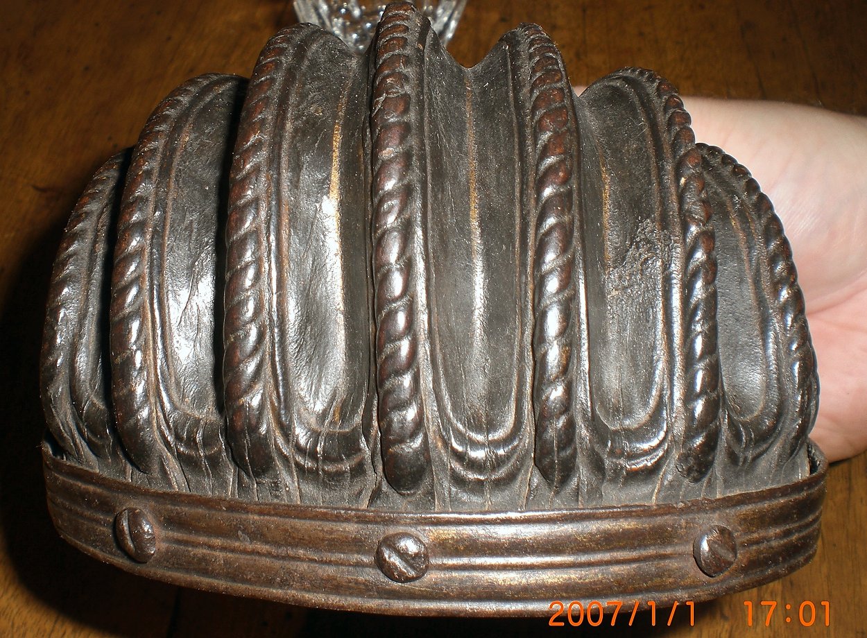

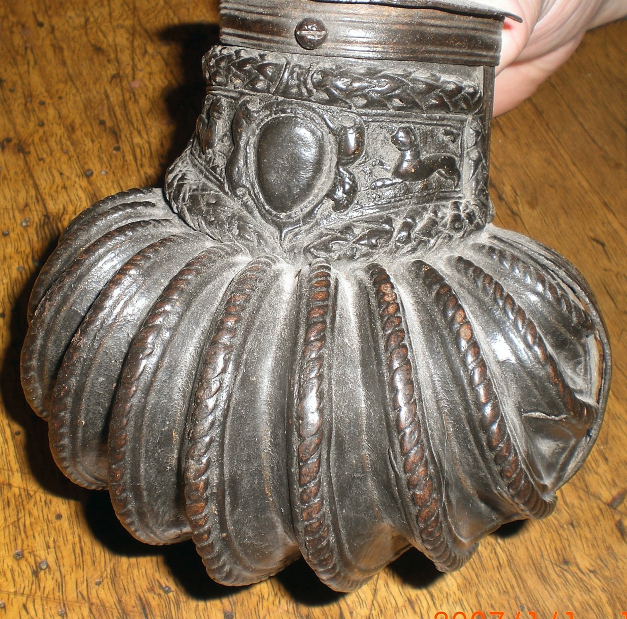

And a fine North Italian cuir bouilli flask decorated with characteristic roped Renaissance ornamentation, iron mounts and reverse belt hook, ca. 1560-70.
The specific overall shape follows that of the contemporary side bags (German: Gürteltaschen) that - in an epoch before ca. 1600 when garments did not yet have integral bags - everybody had to wear on the belt to carry coins but also all the other little things of importance, like written documents etc.

Was the North Italian cuir bouilli flask for presentation purposes or for a (mostlikely) wealthy person?
Their seems to be some remnants of gilding? And does this flask have a (screw) lid on top? I remember from one of your other threads that this was the case with some of these flasks.
Much appreciated as always
Old 10th March 2014, 05:59 PM   #42
Matchlock
Matchlock's Avatar
Join Date: Sep 2008
Posts: 4,310
Hi Marcus,
As the dealer's description does not mention otherwise I assume that what seems to be some gilding actually is a light reflection from the photo session.
Those flasks, like the one in discussion, are indeed characterized by having a number of screws, especially before ca. 1570. The basal plate of the top mount/lid is generally fixed by a transverse screw, as seems to be the case here.

It looks like the back plate is wood, covered with thin leather - is that correct? Is there also a wooden corpus to the front (the balbous) part? From what I read so far, it would seem that the front is leather alone, treated to be hard enough to not need any wooden or otherwise backing (i.e. cuir bouilli or similar).
Thanks,

Alas there is none of these Italian flasks in my collection so I cannot tell with certainty whether there is a wooden back plate underneath the hardened leather.

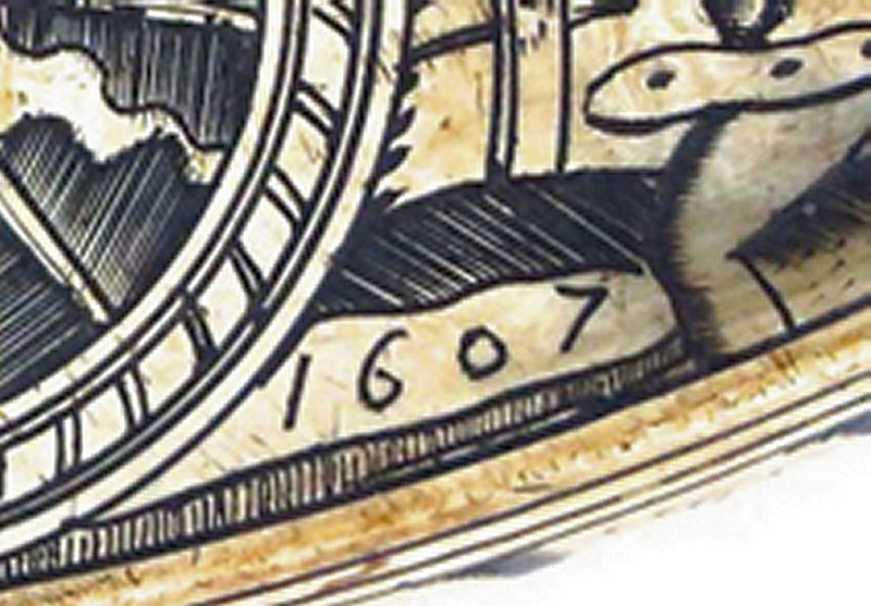

Back to the roots of my thread: flasks for calivermen.
Here is a good sample, and one of the few that were obviously not made and engraved in Nuremberg; the top mount is hinged to fold out for easy refills, which is highly unusual.
It may be French and is dated 1597.
The style of engraving is very similar to that on the flask from post #23, which is attributed to Flanders, and certainly the template was the same in both cases.
m

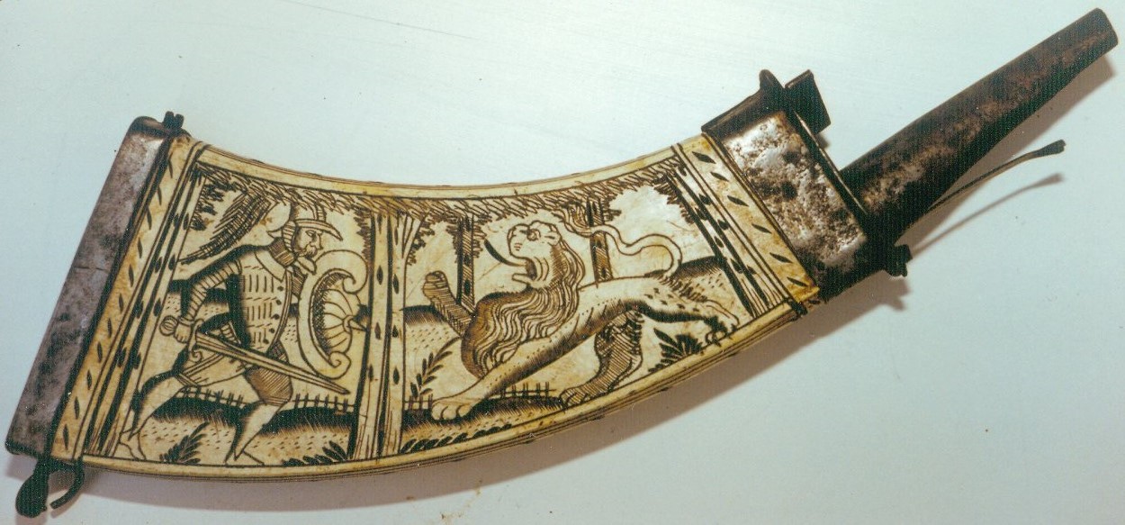

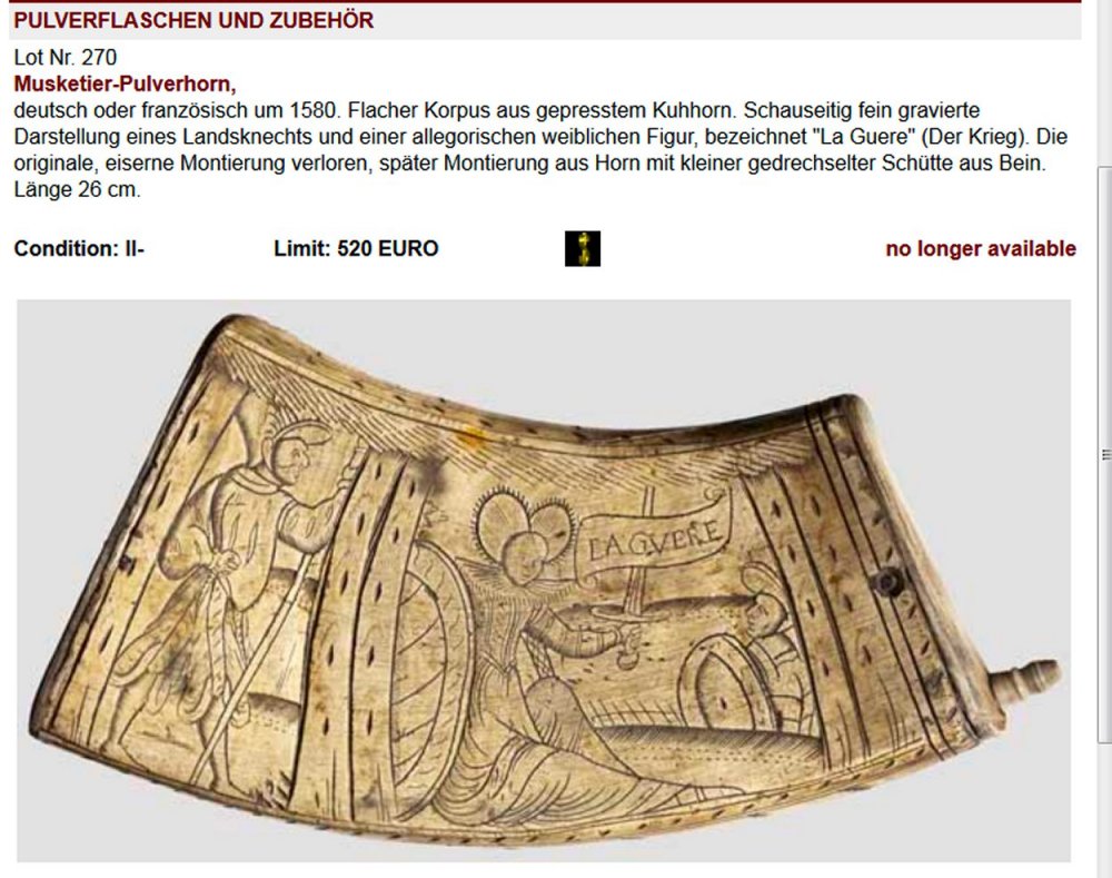

A horn body for a caliverman's flask, French, ca. 1590-1600, the central female figure meant as the impersonation of war and inscribed in Old French La Guere (sic!). the original iron mounts and the reverse frog hook all missing, the nozzle and bottom plate later horn replacements.
The engraving follows the identical pattern as the flask in the previous post.
m

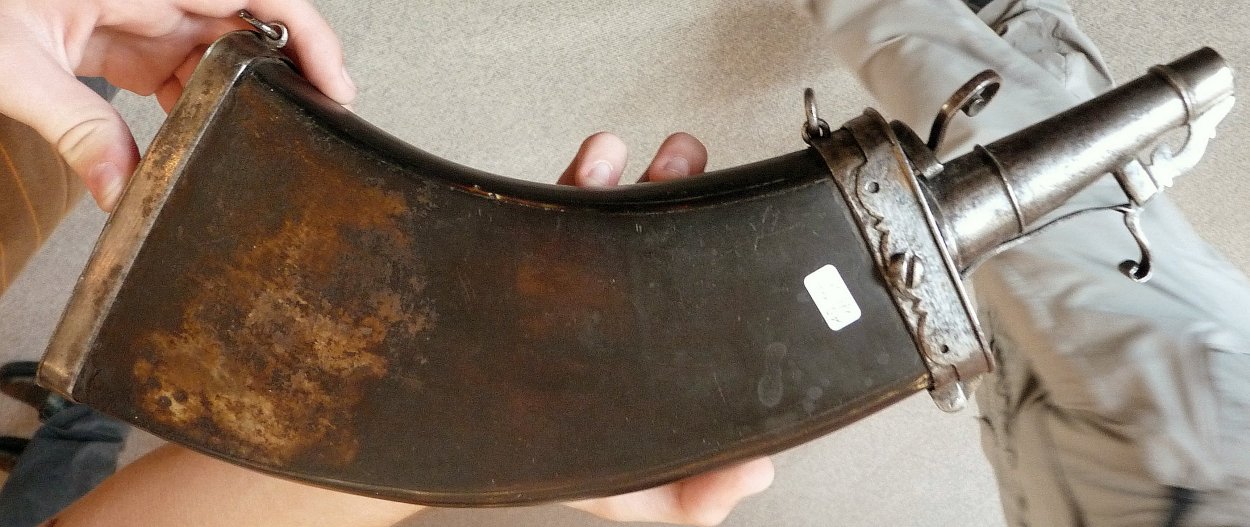

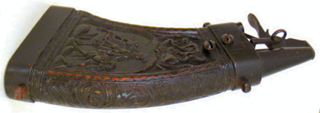

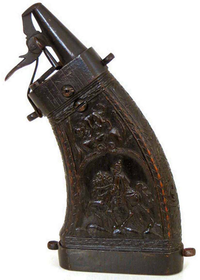

Not a musketeer's flask, as the dealer thought, but that of a caliverman, ca. 1590-1600, in nicely patinated condition, and retaining some bluing on the iron mounts.

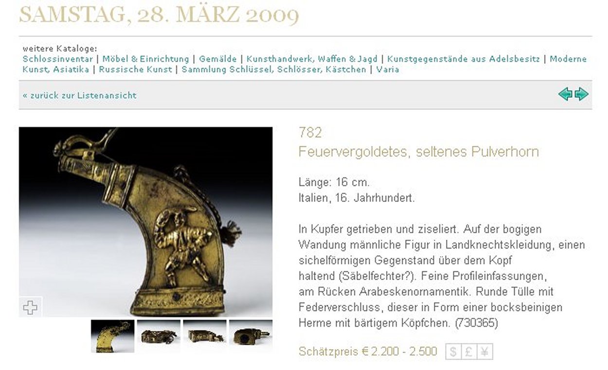

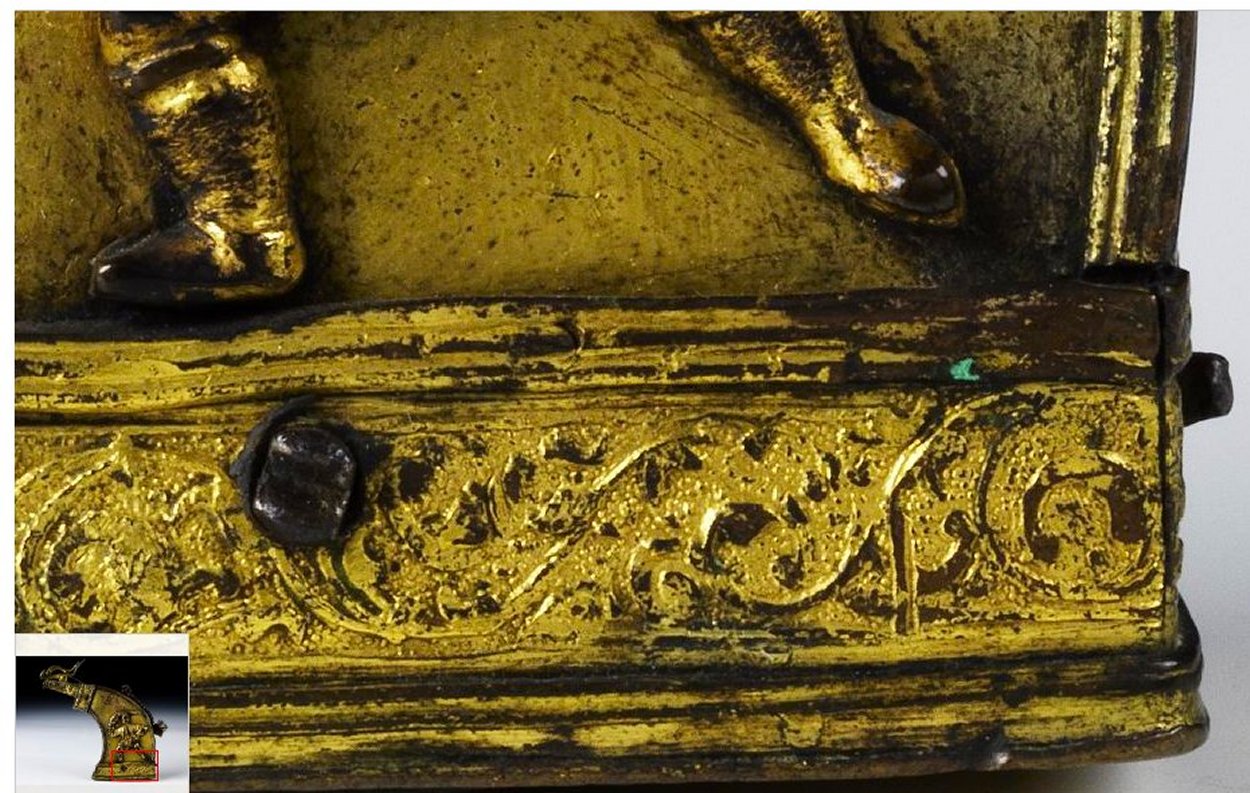

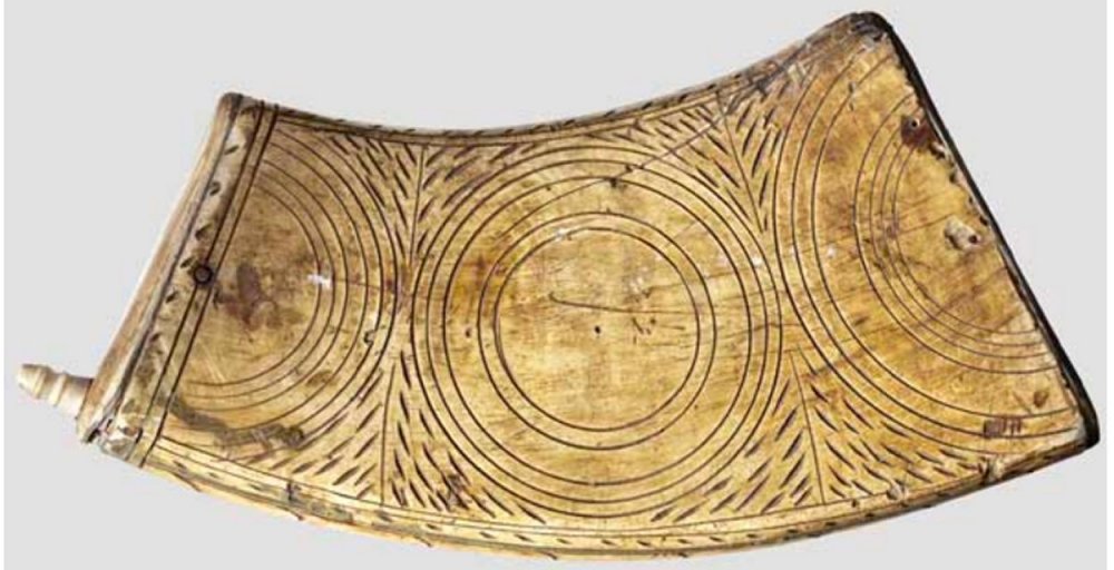

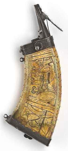

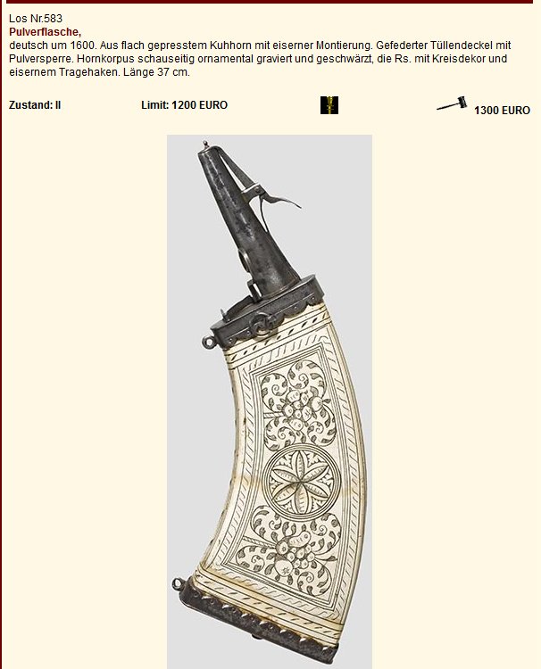

A Nuremberg made and engraved flask of flattened cowhorn, ca. 1600, sold Hermann Historica, Munich, 18 Oct 2006.
This decoration is the well-known intertwined foliage that all Nurembeg workshops used as a pattern.
The blackened mounts finely convey a nice contrast to the white horn body which of course the artist originally intended. This is why a flask from this series with its iron mounts polished bright has lost all its charms.
m

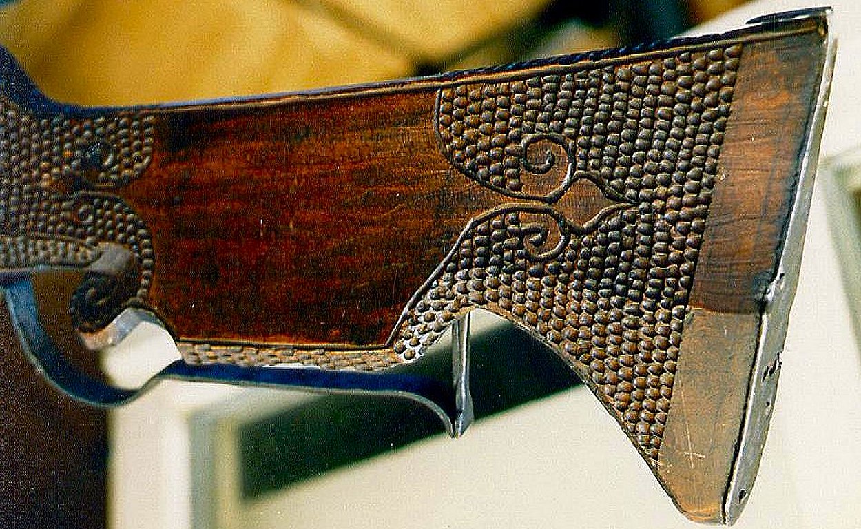

Here is a caliverman's flask I photographed 30 years ago in the reserve collection of the St.-Annen-Museum Lübeck, Lower Saxony, Germany.
The obverse and small sides of the wooden body are profusely carved with scales.
Following the usual formal criteria, a date of 'ca. 1600 to early 17th century' would seem appropriate. However, a 'military' wheellock musket, the lock struck with the Suhl proof mark SVL and the octagonal barrel retaining its original bluing, and the whole gun datable to ca. 1640, features a stock carved in exactly the same manner. It is preserved in the reserve collection of the Gäubodenmuseum of Straubing, Lower Bavaria, and would go perfectly well with the flask stylistically. Thus I am prone to assign the same date to this flask, making it the latest of its kind known to me, from the 'heyday' of the horrible Thirty Years War.
