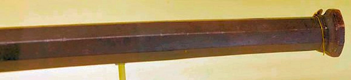

I was leafing through Essenwein, A., QUELLEN ZUR GESCHICHTE DER FEUERWAFFEN, Academische Druck u.v. Graz 1969, Tafel Band, and noticed drawings of some cannons cast by Peter II Mulich of Zwickau. They have rings of undulating flames at various places along the barrel, just like my hackbut. These cannons range in date from 1523 to 1529. This is interesting to me as it indicates a connection between my hackbut and these cannons. I wonder if my hackbut could have been made by Mulich, who may have used the flames as a kind of trademark? If not, were these rings of undulating flames significant somehow to Charles V or to the Holy Roman Empire? What is the connection indicated by these flames? I am posting two images here which I can do under the international doctrine of fair use for educational purposes.

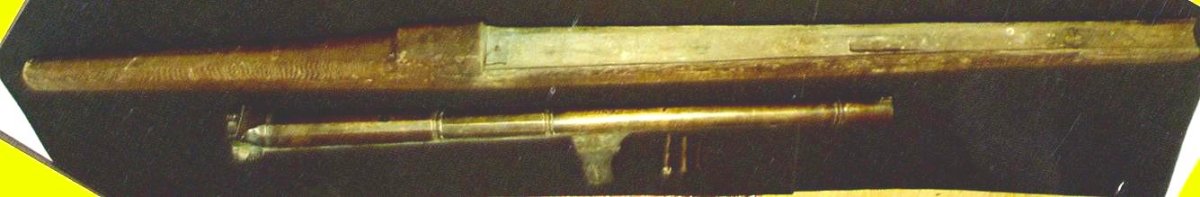

Default Photo of Peter II Mulich's "The Lion" cast in 1523
This photo, found on the web, is dated 1940, at the time this cannon was taken from the Army Museum in Paris and moved to the City Museum in Zwickau. A drawing of this elegant cannon is in the previous post. I'd like to know if this is the only surviving Peter Mulich cannon. I've emailed the museum in Zwickau to ask if they can provide any better photos of this cannon. If anyone has any better photos of this gun, please post them here. There is apparently a photo of this gun in the book "Deutches Bronzegeschützrohre" which I don't have.

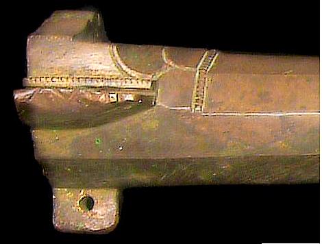

Michael, thanks again for your information. I do think there is something to be said for Peter II Mulich having used the rings of undulating flames as a trademark for his bronze cannons, as each one of the four for which drawings (including the one surviving specimen in bronze) have the same kind of decorative rings. Using decorative rings of evenly-spaced wavy (undulating) flames is I think a bit stronger evidence than just flames per se. Another thing to consider is that Peter II Mulich was indeed from Nuremberg, where his father had always practiced his trade, but he moved to Zwickau at some point in his career, apparently about 1520-23. However these are merely idle ramblings or at most "food for thought, and you are indeed the expert and I am but a slow-learning and somewhat impetuous student.
Two additional features of the "Schellenberg" hackbut may help tell us something. What looks like a proof-mark on the side of the flash pan seems to match some of those shown for Saxony in my 1943-dated two-volume Swedish-language set of Der Stoeckel. However the marks in the book are supposed to be much later than my gun, so who knows?
A final feature to consider which may help identify the maker is the very prominent iron core-pin, or chaplet, which goes through the breech vertically and is exposed most noticeably on top. Chaplets were always used to hold the cores in place while casting cannons in those days. Have you seen such core pins or chaplets in other bronze hackbuts?

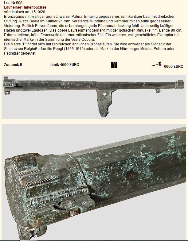

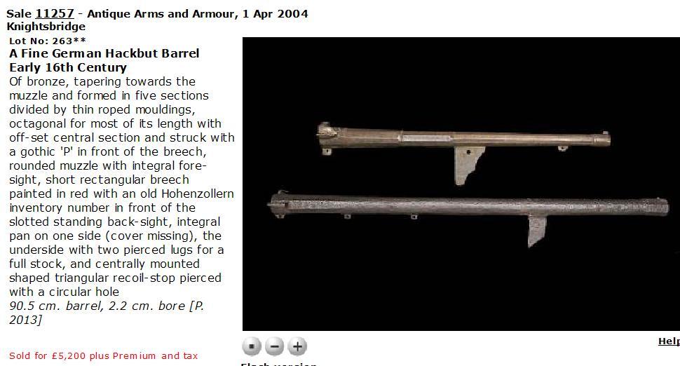

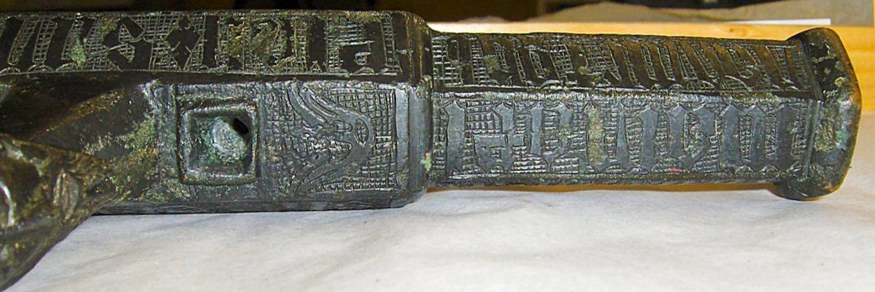

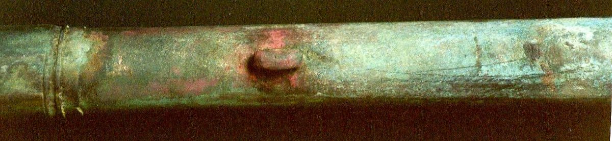

I had my "Ulrich von Schellenberg" hackbut "shot" by an x-ray analyzer today to see what it was made of. I had always thought the metal would be similar to cannons, namely gunmetal, which is approximately 90% copper and 10% tin. Poor innocent, ignorant me! Here's what the analyzer came up with. The very high iron and lead percentages were quite a surprise. I wondered why there would be any aluminum at all, but some other things tested the same day which I know are antique, also showed around 3% aluminum. Go figure!
Test no. and ID:
#10-Bronze Hackbut ca. 1510, presumed to be bronze
Al – 3.62
Si – 7.24
P – 2.08
Ti - .33
Mn - .08
Fe – 17.23
Ni - .04
Cu – 24.68
Zr - .028
Sn – 5.16
Sb – 3.23
Ir – 2.84
Pb – 33.43
cannonmn is offline   Reply With Quote

All I can think of is that the x-ray tester made a mistake. I had the operator shoot the machine at the muzzle of the hackbut to stay well clear of the small iron pieces nearer the breech. He shot several other objects I had, all either iron or steel, and the results on all of those seemed quite reasonable. I'm wondering if he had to change a setting on the machine to get a correct reading for a nonferrous object, and didn't do so? I didn't tell him the hackbut wasn't iron like all the other things. I'll have to ask him during the coming work-week.

Hi John,
This result does not puzzle me at all. Actually it represents what one should expect of early 16th c. bronzes; moreover it pefectly backs up metallurgic analyses of early-16th c. gun bronzes carried out in the 1960's, which I have menioned earlier on this forum. They even found traces of silver and other metallic components.
I think this is due to at least three different facts:
Firstly, raw ore in these ages could not be melted to be as pure as it can be today.
Secondly, all the knowledge on the reliability of bronze the founders then had was based merely on practical experience. I would imagine them them to have deliberately added traces of other sorts of metal because they believed - or had learned - that these additions would make the outcome more durable.
Thirdly, popular superstition played an enormous role in ages past. This means that people believed that certain substances just had to be added to whatever they were about to produce in order to ge a good result. It was magic make believe instead of today's hardheaded science that ruled over everday arts and crafts, including medicine and fireworks. When analyzing 16th-17th firework substances you e.g. find traces of urine - simply because it contained saltpeter - and various earths. People felt that that special mixture would guarantee a great outcome - and it obviously did.
Please also cf.
http://books.google.de/books?id=4Ozo...ronzes&f=false
http://en.wikipedia.org/wiki/Bronze_Age
http://en.wikipedia.org/wiki/Mining_...edieval_Europe
When I had the varnish of one of my Landsknecht arquebus of. ca. 1540 spectroanalyzed in the early 1990's traces of silver and even gold were discovered - in the dark brown lacquer on an almost 500 year-old gun stock!

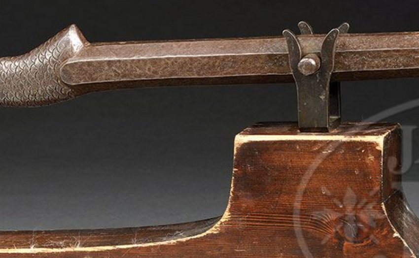

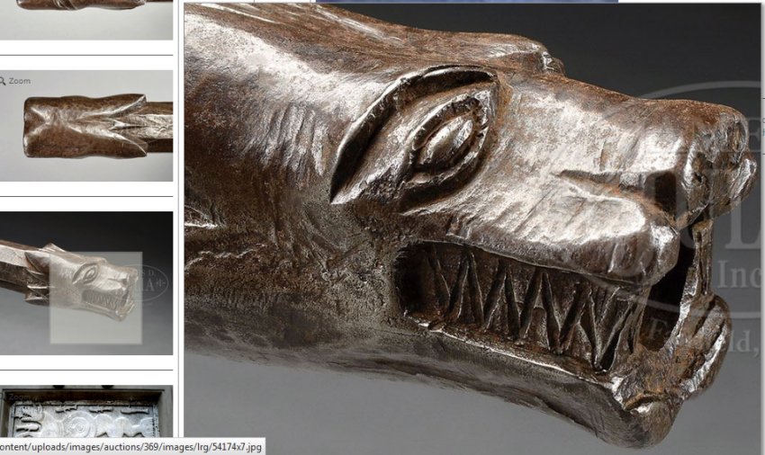

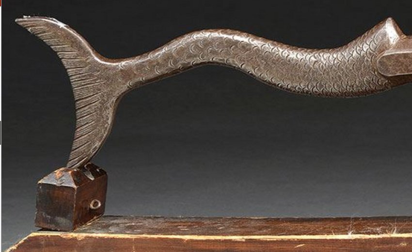

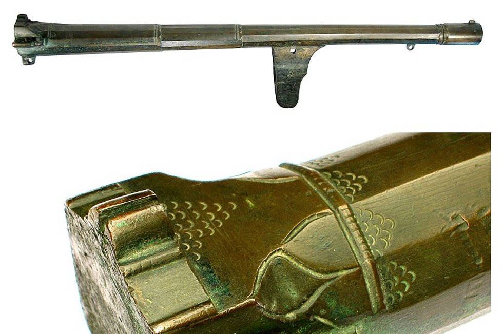

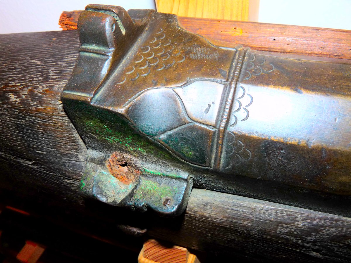

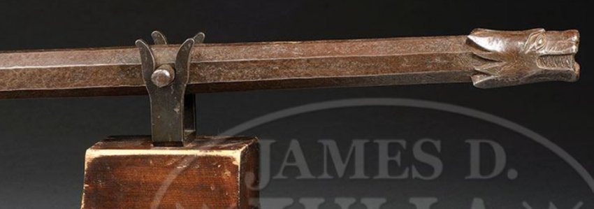

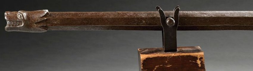

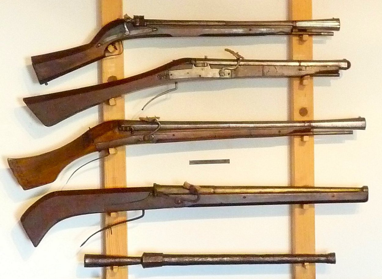

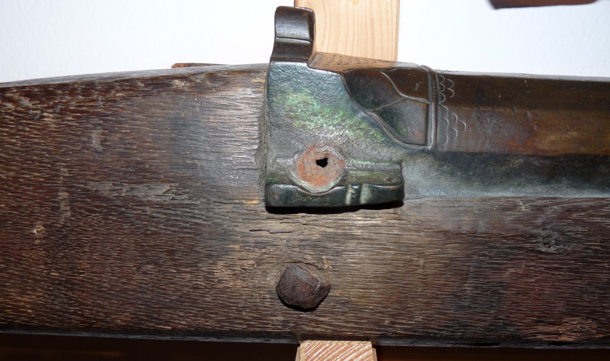

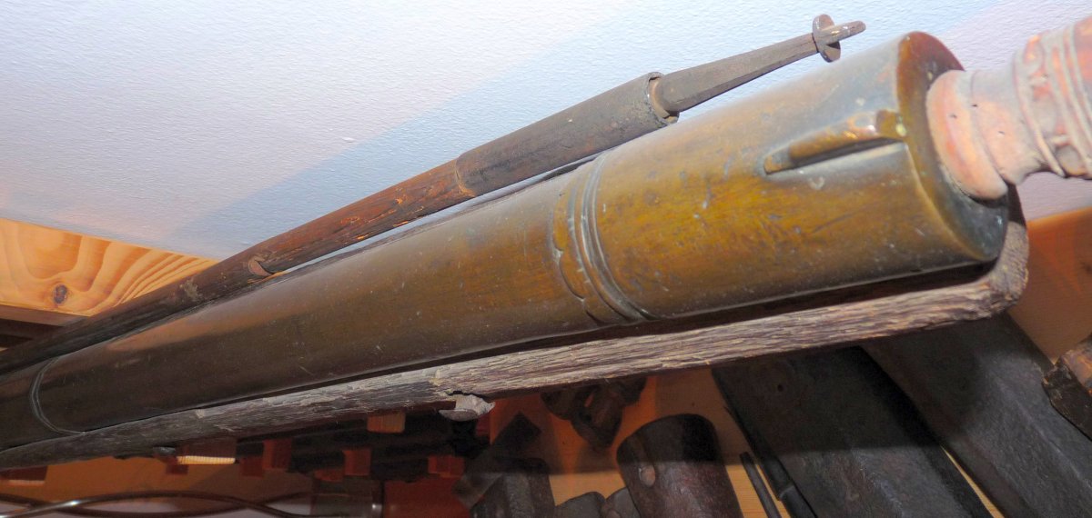

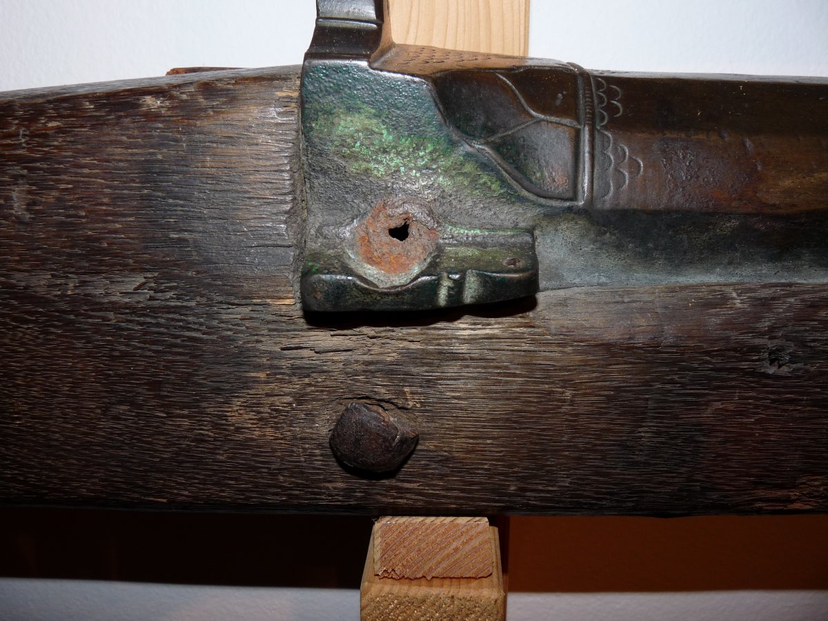

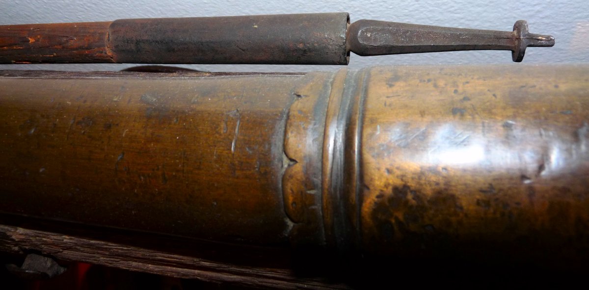

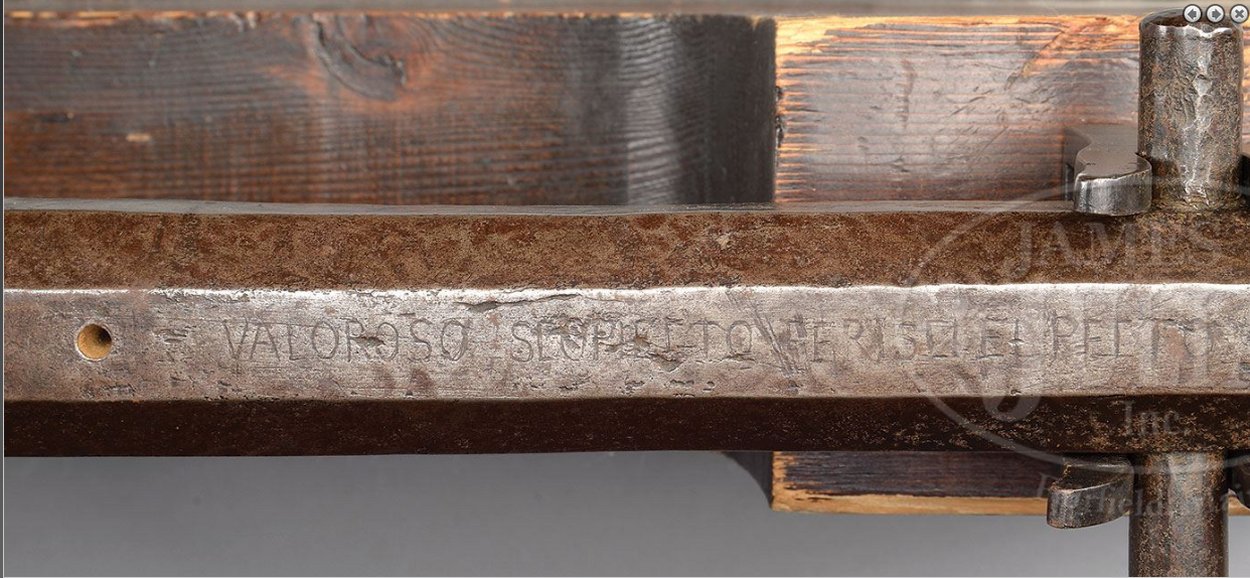

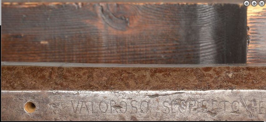

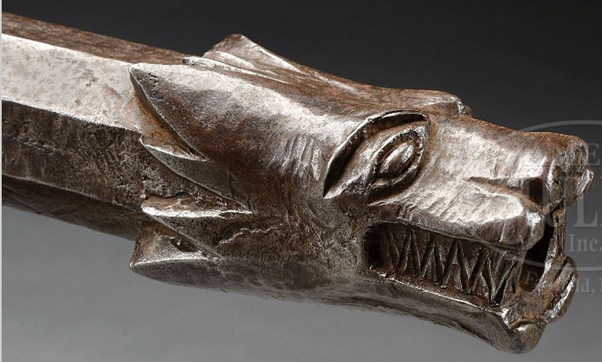

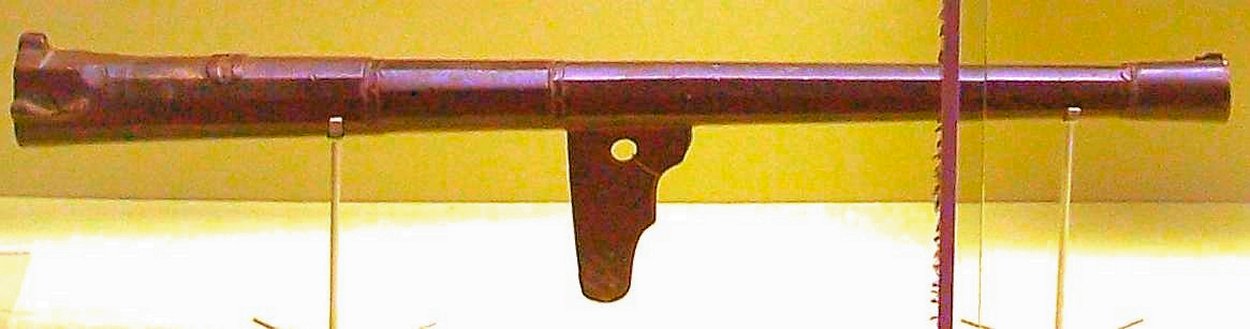

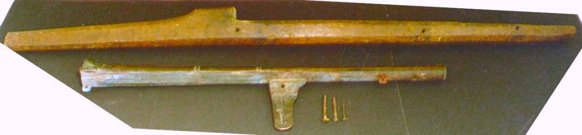

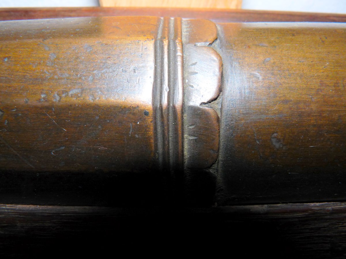

After a couple of years I wish to add some more close-ups uf my huge Nuremberg wallgun (doppelter Dopelhaken) that this thread is about.
What I have not mentioned before: it is preserved complete together with its original wooden ramrod (wormed and repaired in places, rear end incomplete) retaining its blackened threaded iron finial (Setzerkopf) and the original scourer (Laufkrätzer)! The ramrod is seen resting on the left side of the heavy piece; it was broken into three separate parts when I bought it some 25 years ago.
The wooden muzzle plug is old but associated.
The originally swiveling pan cover is missing from the barrel.
The gun and ramrod were claimed by the previous owner to have been deaccessioned by the Princely Collections of Hohenlohe-Langenburg in Franconia in the 1960's. On attending their collections by special appointment I photographed two similar Nuremberg bronze wall pieces the better of which, dated 1525, I posted above in post #6.
m

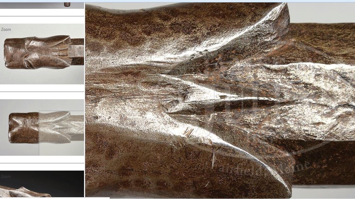

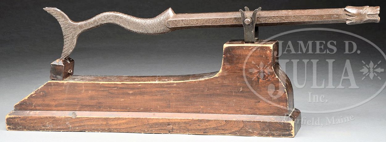

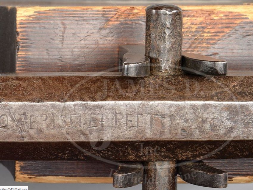

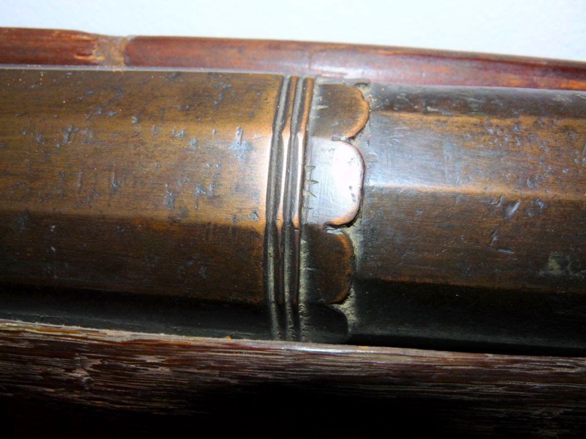

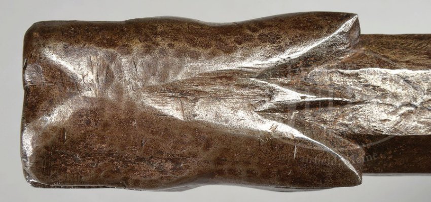

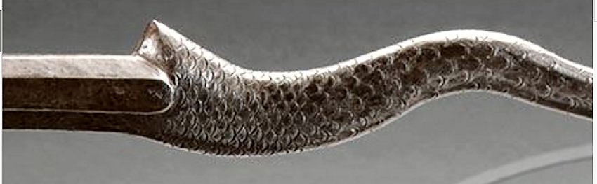

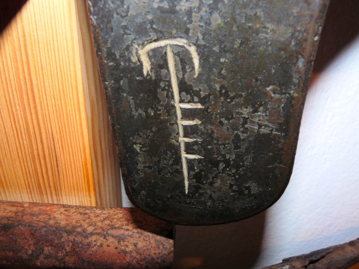

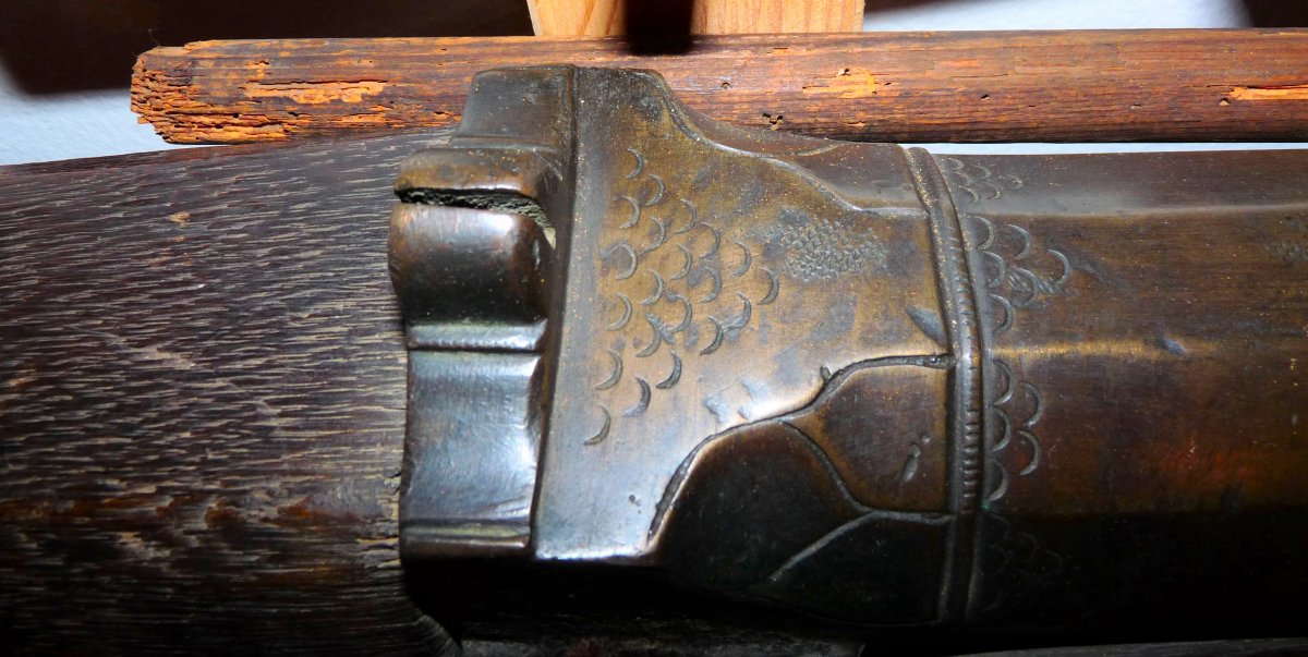

Three more, showing details of the ramrod with its blackened iron finial retaining the original scourer.
m

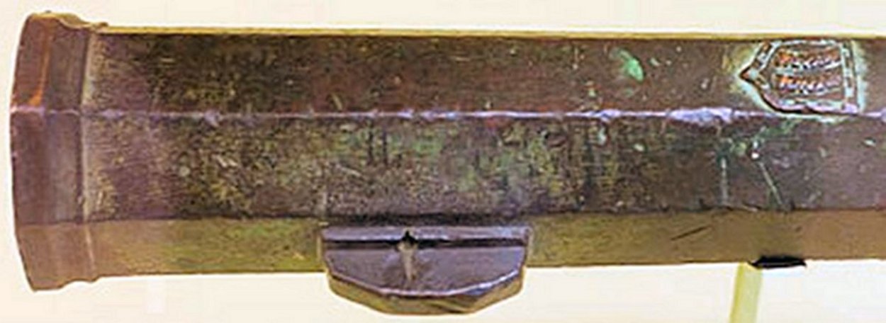

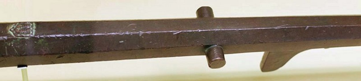

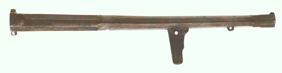

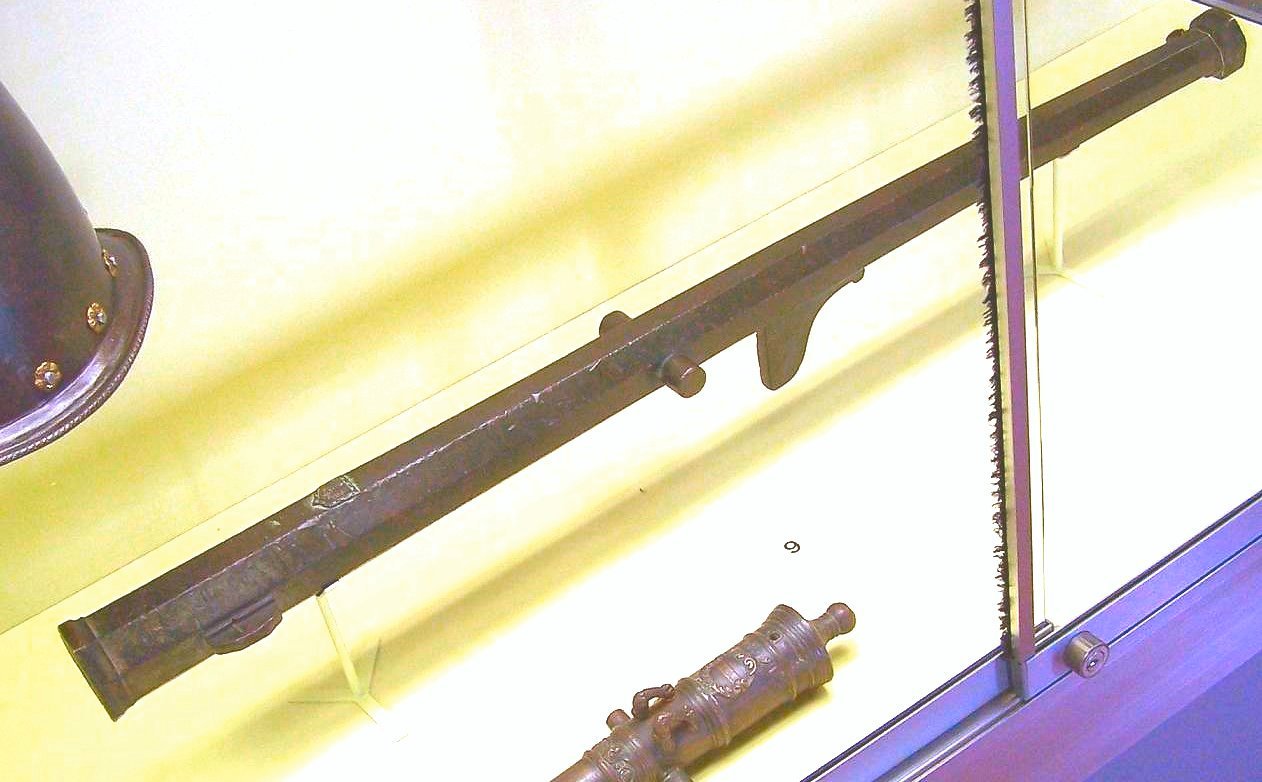

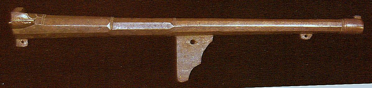

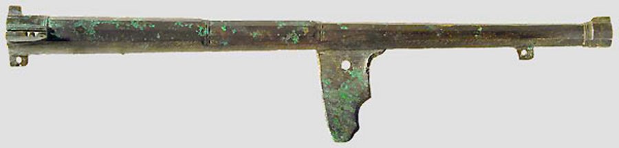

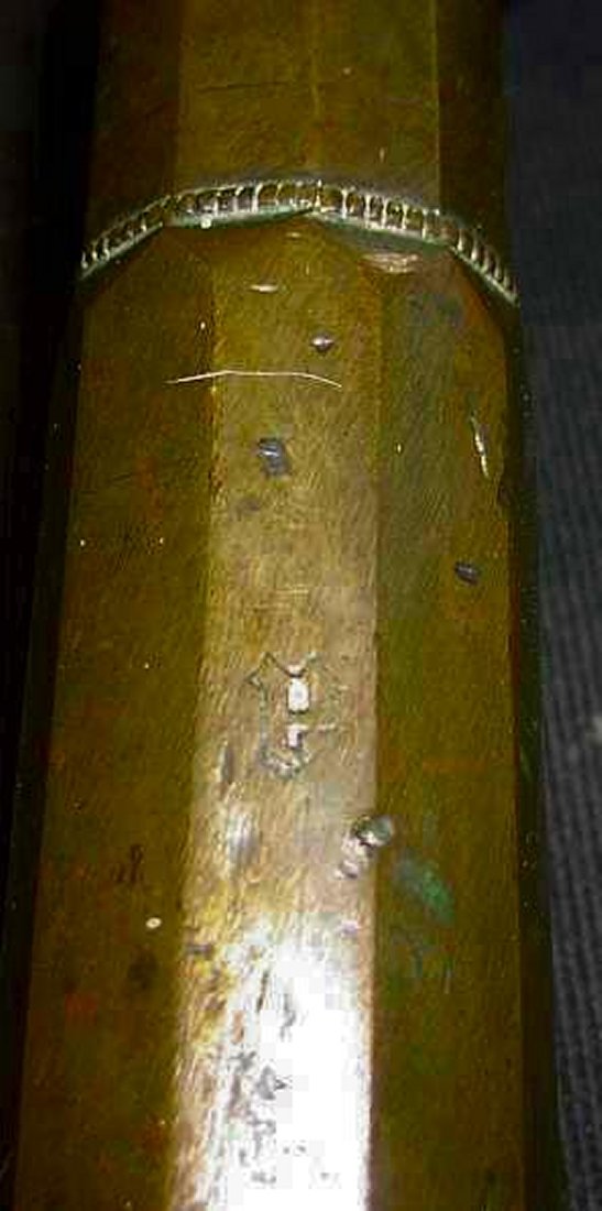

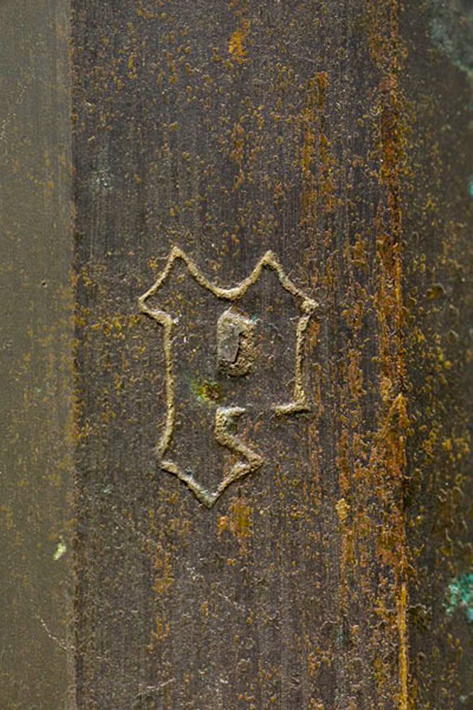

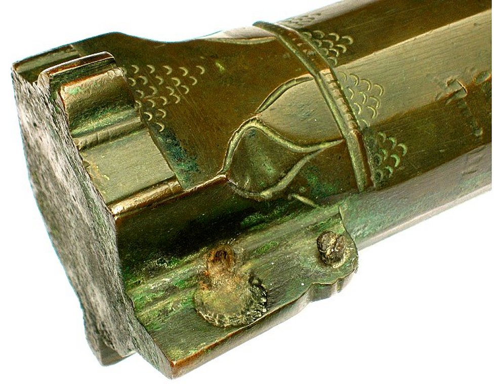

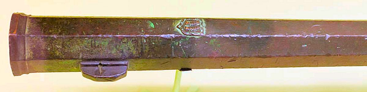

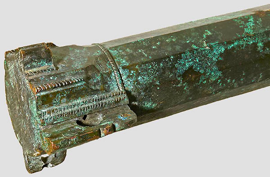

Two similar and contemoprary, but notably smaller Nuremberg barrels of wallguns, the first ca. 1520, the second with its shorter muzzle section ca. 1510-15, both struck with a Gothic minuscule p mark, which, when found on bronze barrels, can be safely attriuted to the Nuremberg founder Sebald Behaim whose name was pronounced Pehaim in his Franconian dialect.
The other prolific Nuremberg bronze foundry, that of Endres Pegnitzer, can be safely ruled out for marked barrels as he is known to have signed his barrels EPGM, for Endres Pegnitzer Goss Mich (Endres Pegnitzer founded me), the letters characteristically cast in high relief within a coat-of-arms.
In safe conclusion this means that for barrels unsigned and unmarked, either foundry of Behaim/Pehaim or Pegintzer may be held accountable while when a bronze/brass barrel is struck with a minuscule p mark, it should be attributed to the Behaim/Pehaim workshop.
Attached at bottom is a very fine but unsigned and unmarked Nuremberg wallgun barrel of ca. 1520-25, preserved retaining an unusually charming emerald green patina.
m

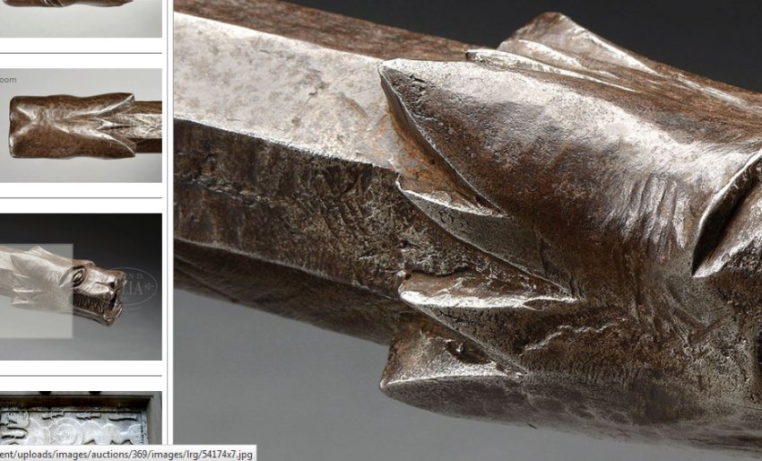

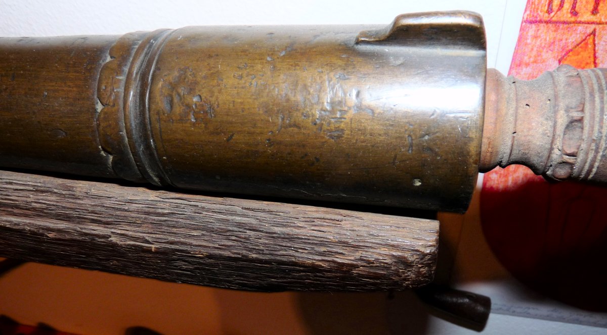

One more close-up of the rear section; as on most early-16th c. bronze barrels, the originally swiveling pan cover is missing while the riveted pin is preserved.

Another, similiar early-16th c. Nuremberg wallgun bronze/brass barrel is preserved in the George F. Harding collection, in The Art Institute of Chicago.
It seems from the photo that the pan has been removed from the right-hand side of the breech.
m

I found a other bronze hackbut like yours. Sold trough Sotheby's but i can't find it anywhere.
Old 18th December 2013, 08:21 PM   #49
Matchlock
Matchlock's Avatar
Join Date: Sep 2008
Posts: 4,310
I recall this one; it was mounted on the present 'carriage' in the 19th c., the Nuremberg barrel ca. 1515-20 but heavily overcleaned.
It cannot match my unique piece in any way.
m

Yes, Marcus,
I'm extremely proud to say that this indeed is my piece!
I ordered many extra images right before the auction from Tom Del Mar and then bought it, together with the unique combined matchlock and flintlock MONTECUCCOLI musket including its original long folding bayonet from the Stauffenberg collection in Franconia/Bavaria, where it was since it was made in 1666! This makes me only the second owner of the Montecuccoli piece after 350 years - imagine!!! Both pieces are in fine, virtualy 'untouched' and patinated condition. The Montecuccoli musket M 1666 is the one with the pierced butt in the second and third images attached.
The catalog description of the short brass-alloy barrel arquebus with the earliest kind of pre-petronel cherrywood full stock (German krummer Landsknechtkolben) was completely misreading the facts that the barrel is of Maximilian Landsknecht type, most probably cast in Maximilian I's foundry of Mühlau near Innsbruck in about 1495-1500 and struck with a characteristic Late-Gothic founder's mark, The gun obviously was restocked during the South German peasant wars (Bauernkriege) of 1525, and the primitive snap-tinderlock of that Early-Renaissance period was, obsolete by long then, 'modernized' in the High-Baroque period, when everything was badly needed that would still fire: at the end of the Thirty Years War, the 1640's, by re-using an older matchlock mechanism of ca. 1580-1600. I associated an original long tiller trigger to the gun and put it on my wall. Done!
I will post these two guns in separate threads when I can take good images in spring!
Till then, the images attached will have to do.

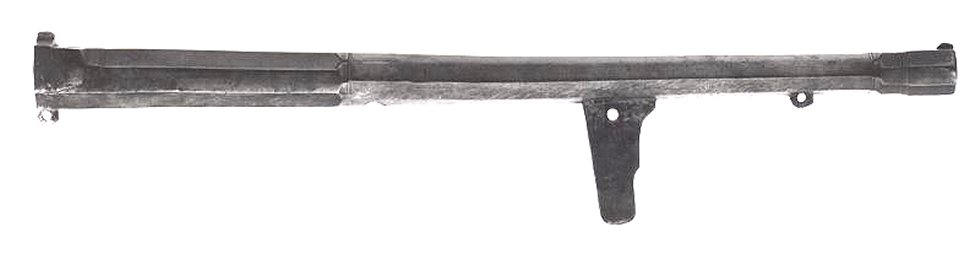

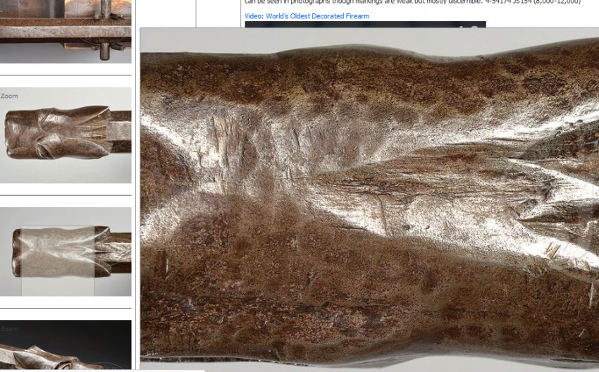

Another, similar and simultaneous, Nuremberg copper alloy/bronze hackbut barrel, ca. 1515-20, is preserved in the collection at Grandson castle, Switzerland.
The pan is an inapt later addition.
For both temporary and stylistic comparison, I attached another, earlier, ca. 1500-10, of characteristic French make, retaining its original pan that never had a cover (!), fitted with trunnions and cast in high relief with a coat-of-arms, from the same museum.
m

Posts: 4,310

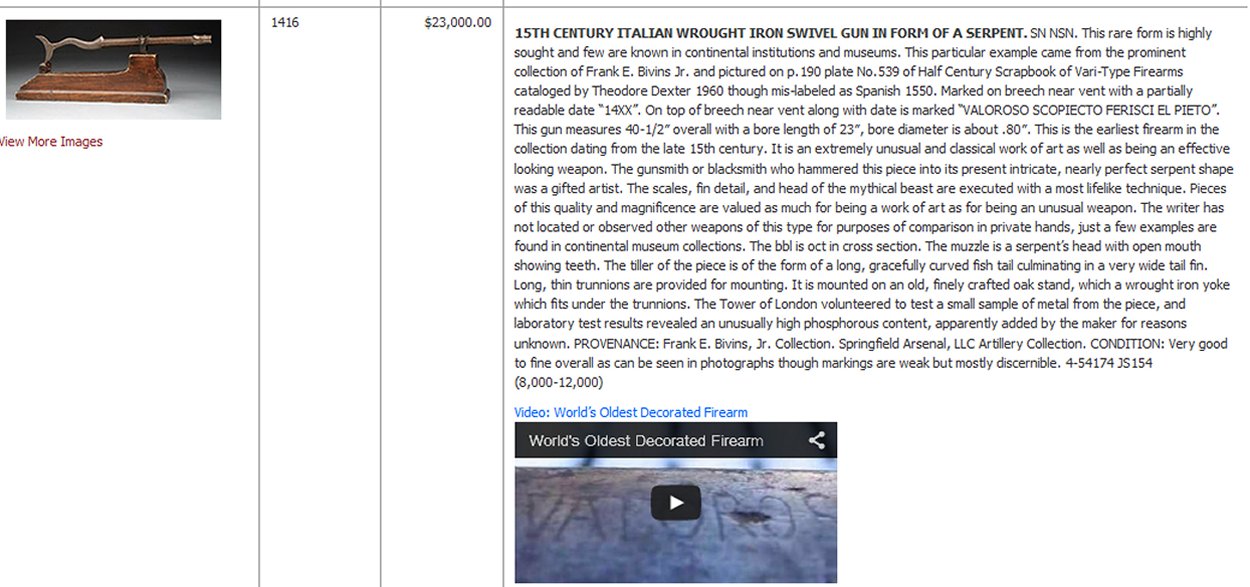

Default Duck Tales: An All American Auction - and The World's Finest Haquebut Barrel
CONGRATULATIONS TO THE RESPECTIVE BUYER (who may have been the same in both cases).

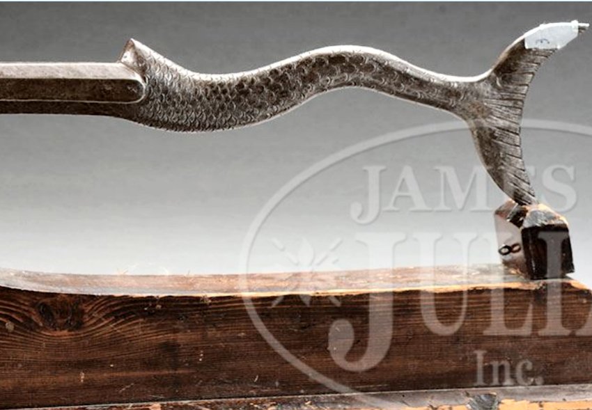

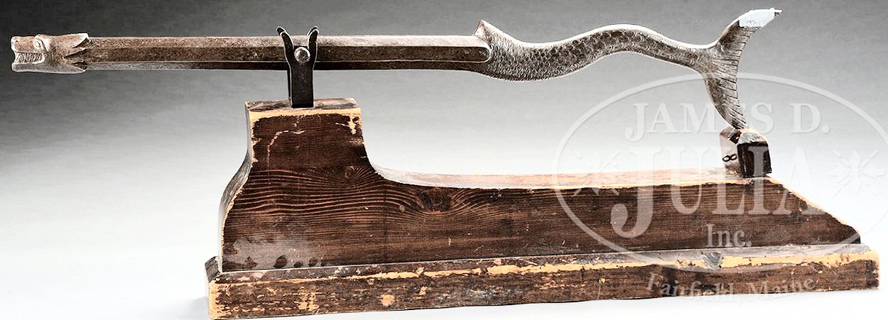

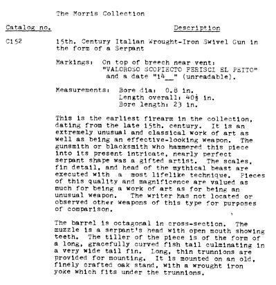

The first item is the most ridiculous and primitive mid 20th c. "Italian" piece made to fool the biggest fool ever.
Compared to that, Goofy's "blunderbusses" are purest gold; they, at least, are funny ...
The second item is the world's finest known Nuremberg cast brass, or "bronze", haquebut barrel, half a millennium old, unmatched, and once ordered by an important person of history:
Ulrich von Schellenberg,
whose extremely fine Katzbalger is preserved in the Vienna Habsburg Armory, at the Kunsthistorisches Museum Wien.
They both fetched the same price, in the land of ... whatsoever.
The consigner, and the auction house, succeeded in generating a truly Freudian slip, misspelling
"hackbutt", for haquebut/hackbut.
On second thought, though, they mave been right ...
The State of Austria could not afford to purchase that singular piece - not now, nor in years in come ...
Tu felix Austria ..?!
A very sad "Good Night",
from a very sad
Michael,
who did his very best to save that barrel
but had to quit,
or commit murder suicide ...
Old 11th October 2014, 03:49 PM   #58
Matchlock
Matchlock's Avatar
Join Date: Sep 2008
Posts: 4,310

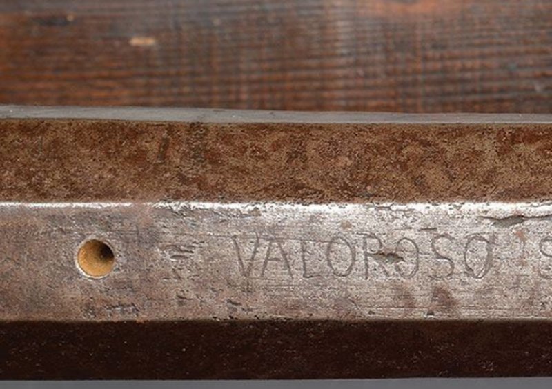

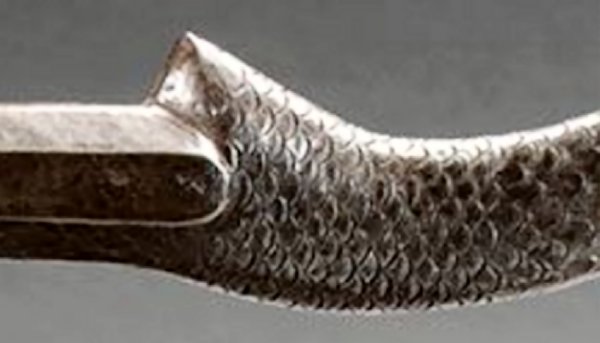

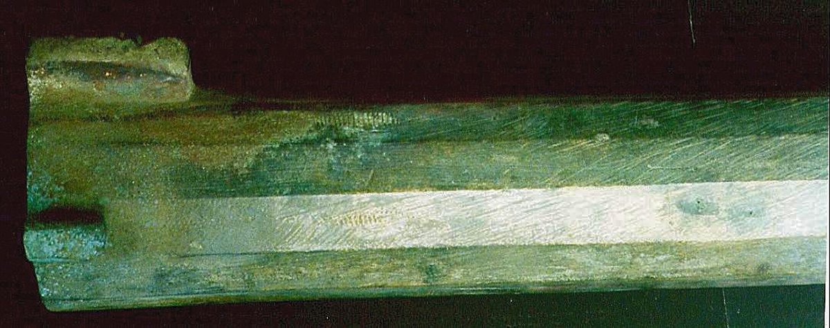

I bet the oldest item in the images is the wooden stand ...
Just look at the crispness of the drilled touch hole - a 15th c. barrel smith would just have punched the hole through the red hot barrel ...
Of course, that would have left a notable mold around the hole which, at the same time, would have held enough priming powder for the igniting iron to set off the load!
All this is so blatantly obvious that it seems just unbelievable.
m
Old 11th October 2014, 04:00 PM   #59
Matchlock
Matchlock's Avatar
Join Date: Sep 2008
Posts: 4,310
Old 11th October 2014, 04:01 PM   #60
Matchlock
Matchlock's Avatar
Join Date: Sep 2008
Posts: 4,310

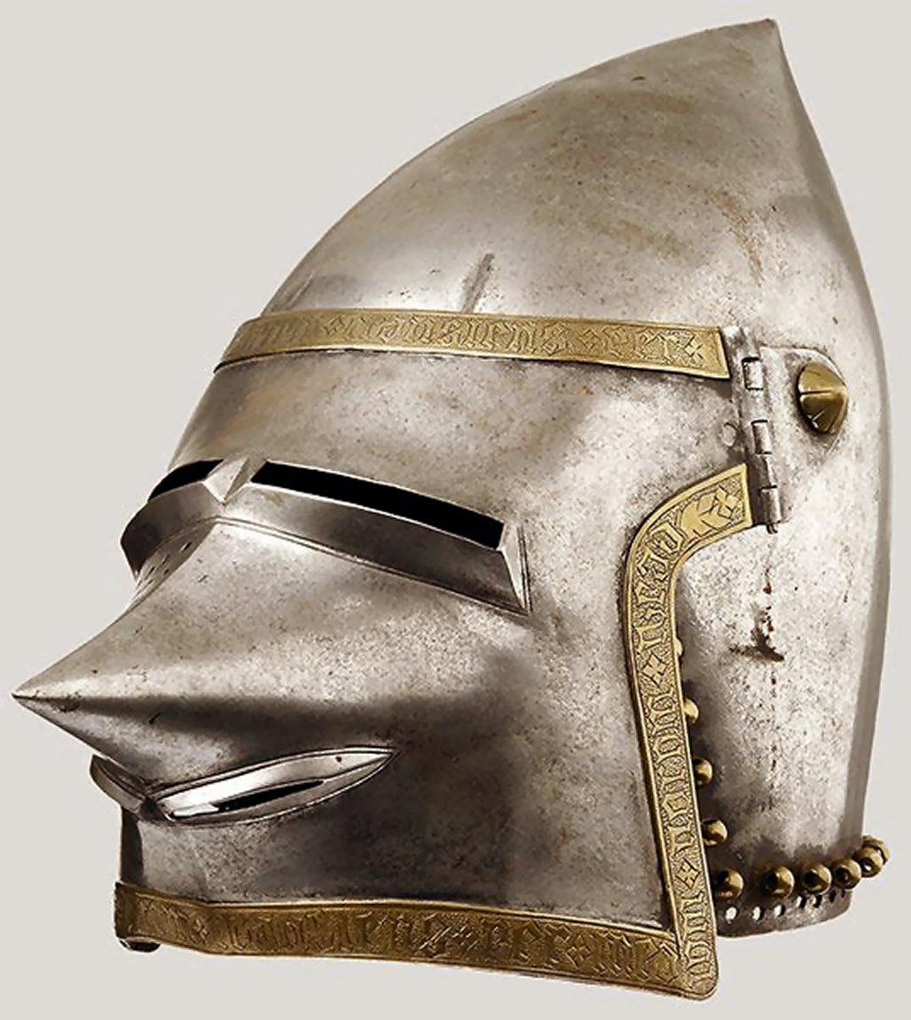

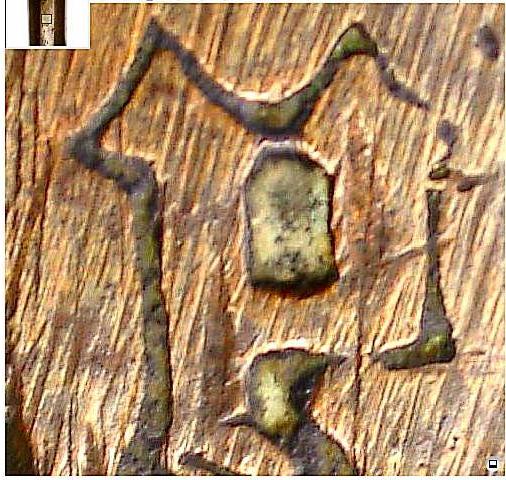

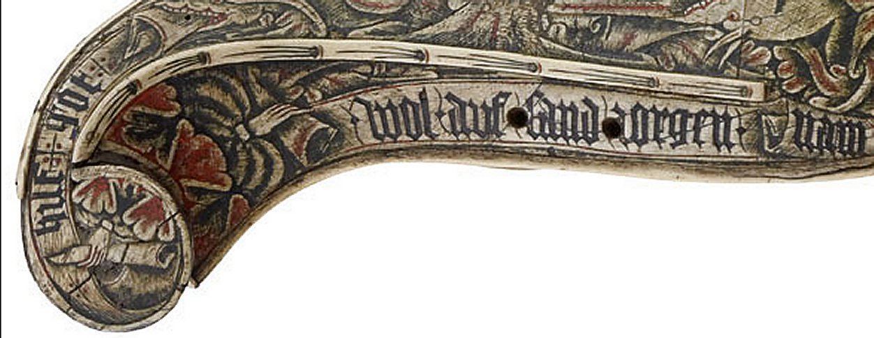

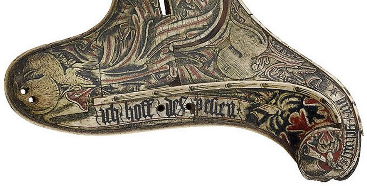

Some samples of authentic Gothic majuscule and minuscule script attached.
Compared to them, the lettering on this barrel, intended to look "antique"; actually, it cannot be termed but the most primitive sham the author has ever come across.
Also note the various dents and scratches, plus the ridiculous "aged" surface condition.
23,000 USD.
Well done.
Have fun, everybody.
Michael Trömner
