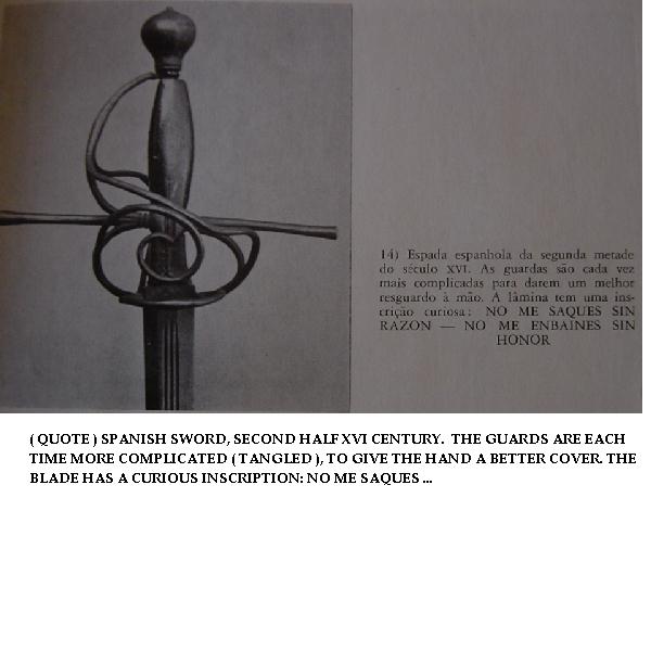

Old 11th June 2005, 09:46 PM   #35
hi midelburg
the miscatalogation of these examples does not end with the sources appointing to the earlier period this motto was engraved on blades. same with the language used, maybe latin came first.
when the spanish conquistadores founded bogota in 1538, their leader gonzalo jimenez de quesada was using a toledo sword with the motto no me saques sin razon ... a code of the followers of el cid ( quoting jose maria vergara y vergara in fundacion de bogota ).
el cid lived on 1043-1099. if this were a true story, contradicts the prior assumption that the motto was originated on the templars oath, as this order was founded later.
the missing link prevails

Old 12th June 2005, 04:29 PM   #37
hi Rivkin
i am no specialist either.
but maybe things are not just black and white.
on one hand we can read that the order's rules did not allow for any kind of decorations on their swords. but they were men at arms, a military order, meant to use their weapons, eventually in the name of christ. and boy, they intensively did.assuming the motto as such was not developed by the order, its basic concept wouln't look so unfit in their cruzader cavalry codes.
it's true they had to give away their possessions ... but it doesn't seem they ever wanted it to. in the beginning, they were named "poor knights" assuming they lived personally as beggars, but suddenly the order appeared dealling with imense fortunes ... specially silver. they practised banking and put up the letter of credit. when they were banned, their real estate was transferred to another order, but they managed to go around and get it back.
as for the slasher pope idea, it depends on the period and on the pope. alexander VI ( borgia ) for example, used poison to knock his victims, our famous motto wouldn't suit the poison flask situation.
