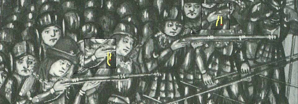

it seems that we can see the matchcords which is hanging on the fingers:

Honestly, I do not believe that the items you encircled are actual lengths of matchcord. If you look at the sources I posted at the beginning, on top of this thread, you will notice that 15th and early 16th c. matchcords were much thicker than these seem to be.

Hallo, dear Michael.Thanks for answear. May be You are right, but the image is too arbitrary, imprecise and sketchy. So everything is possible ...

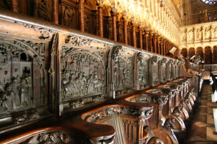

I think that these pictures was drawn later than 1492 year. We can see the inscription "ALHAMA" on the tower. It means that we see siege of Alham(b)ra at these pictury. The siege of Alham(b)ra was in 1492 year. So, I think that these picture was drawn between 1492 and 1500 years.
Spiridonov is offline   Reply With Quote
Old 16th November 2010, 04:09 PM   #43
The late gothic carvings in the low choir of the Toledo cathedral were made by the artist Rodrigo Alemán between 1495-1498. The main scene does in fact represent the conquest of Granada (El Alhambra) by the Catholic Kings.
Old 16th November 2010, 04:21 PM   #44
Lower tier of choir stalls in the Coro, which were carved by Rodrigo Alemán in 1495 and feature 54 historical scenes from the conquest of Granada in remarkable detail. Each seat shows the defeat of a village.

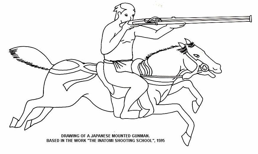

Speaking of early gun sights and aiming positions.
... probably some of these are already known

Thank you, 'Nando,
I was aware of these and I am convinced that in Europe, too, sights were used from the point they arose (ca. 1460-70). The only remaining question is what their worth actually was, as the insides of the barrels were quite rough and not yet rifled.

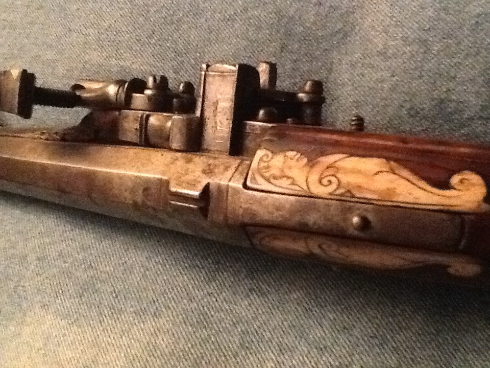

Hi Michael,
Thank you for the interesting posts and detailed pictures.

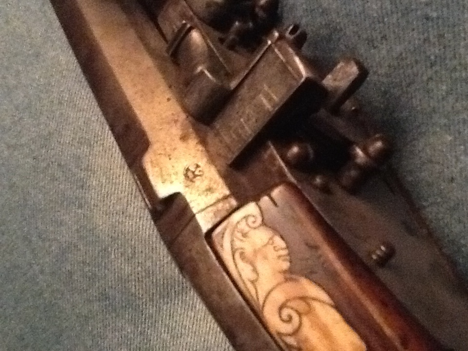

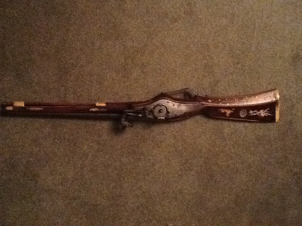

I was particularly intrigued by the discussion in regards to the sights on early firearms, and it brought to mind the back-sight on a 16th century wheelock carbine that I obtained years ago. The carbine is 32" long and comprised of an 18.5" barrel, with a sight that sits at the base of the barrel. I believe the carbine is possibly French or German dating to 1580 - 1600. The piece exhibits the wear and tear of long and hard usage, and has undergone some repairs and restoration to the stock. I often wonder what good a sight on such a gun would have provided. See the attached pictures...
Paul
