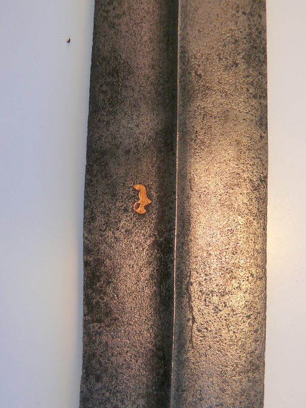

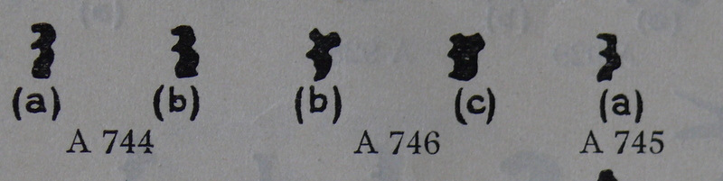

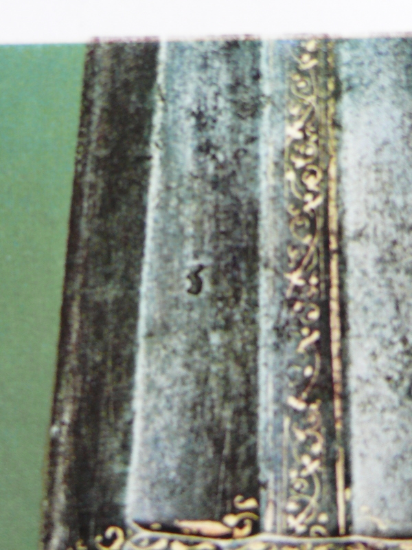

Hi Michael,
what a beautiful and extremely rare range do you have, absolutely amazing, that is what I still miss in my collection!....
re: Emelia blade marks
I have added a few pictures. Boccia 199 200, wallace A744 745 746 , sword end 15thC

Thank you so much, Cornelis,
These marks add greatly to the documentation of my Brescian harquebus!

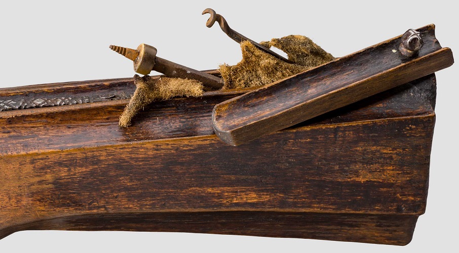

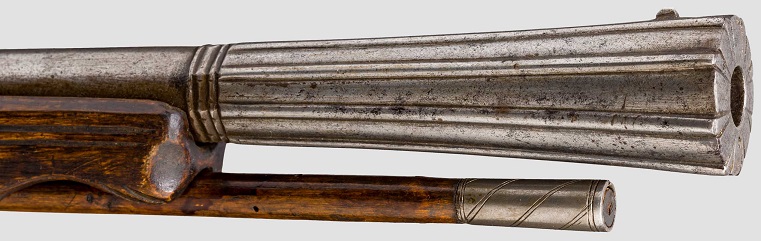

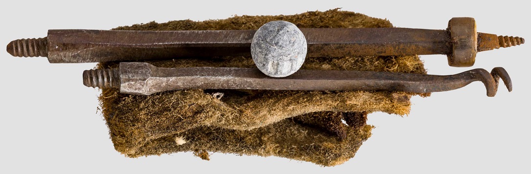

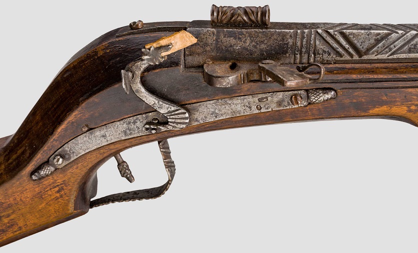

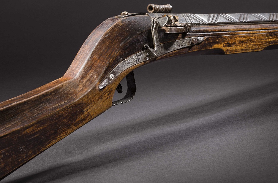

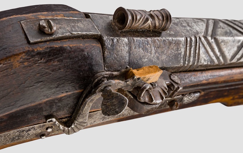

The following photos were taken by Herman Historica, when this snap matchlock came up for sale, in November, 2017.
These pictures are attached for posterity and in memory of our good friend and teacher, Michael Tromner.

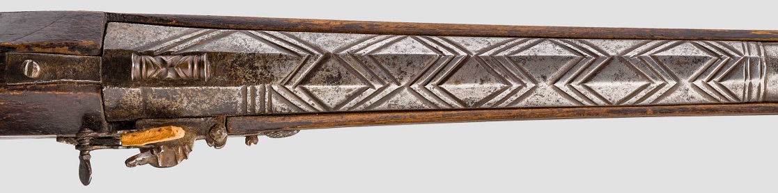

The rest;
Old 11th November 2017, 10:30 AM   #44
Excelent pictures; excelent gun ... and an excelent tribute, Richard .

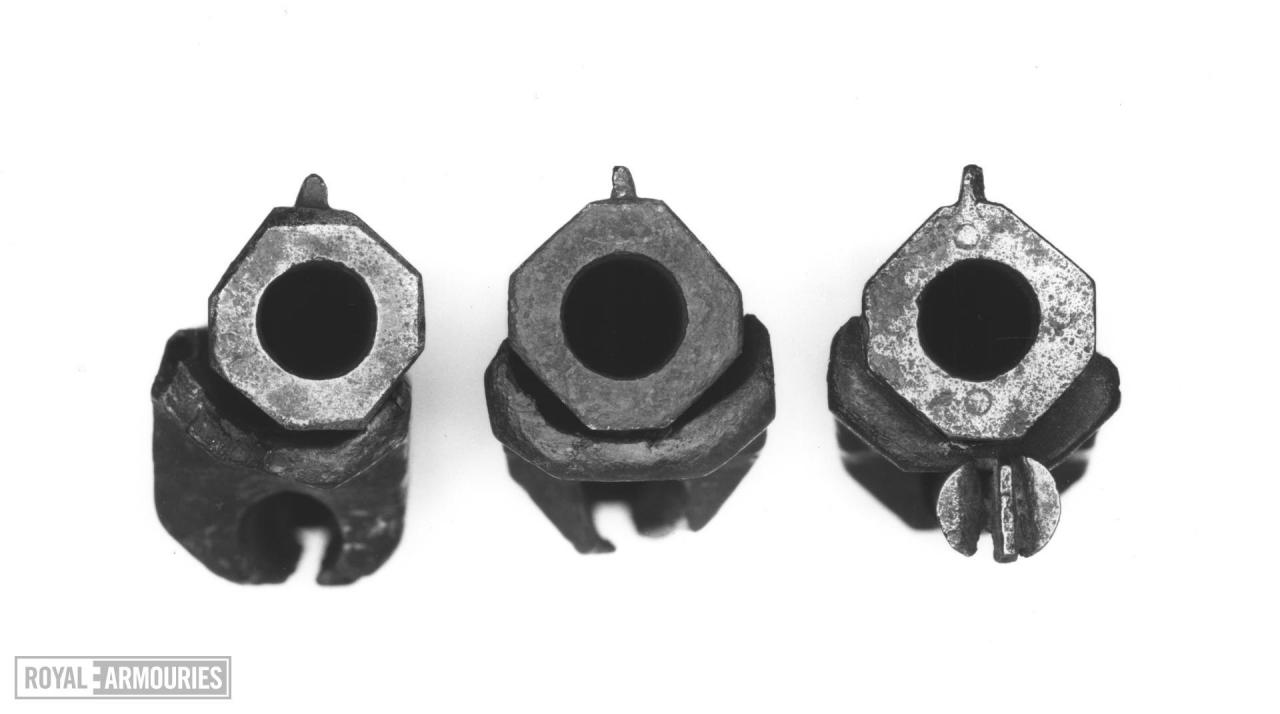

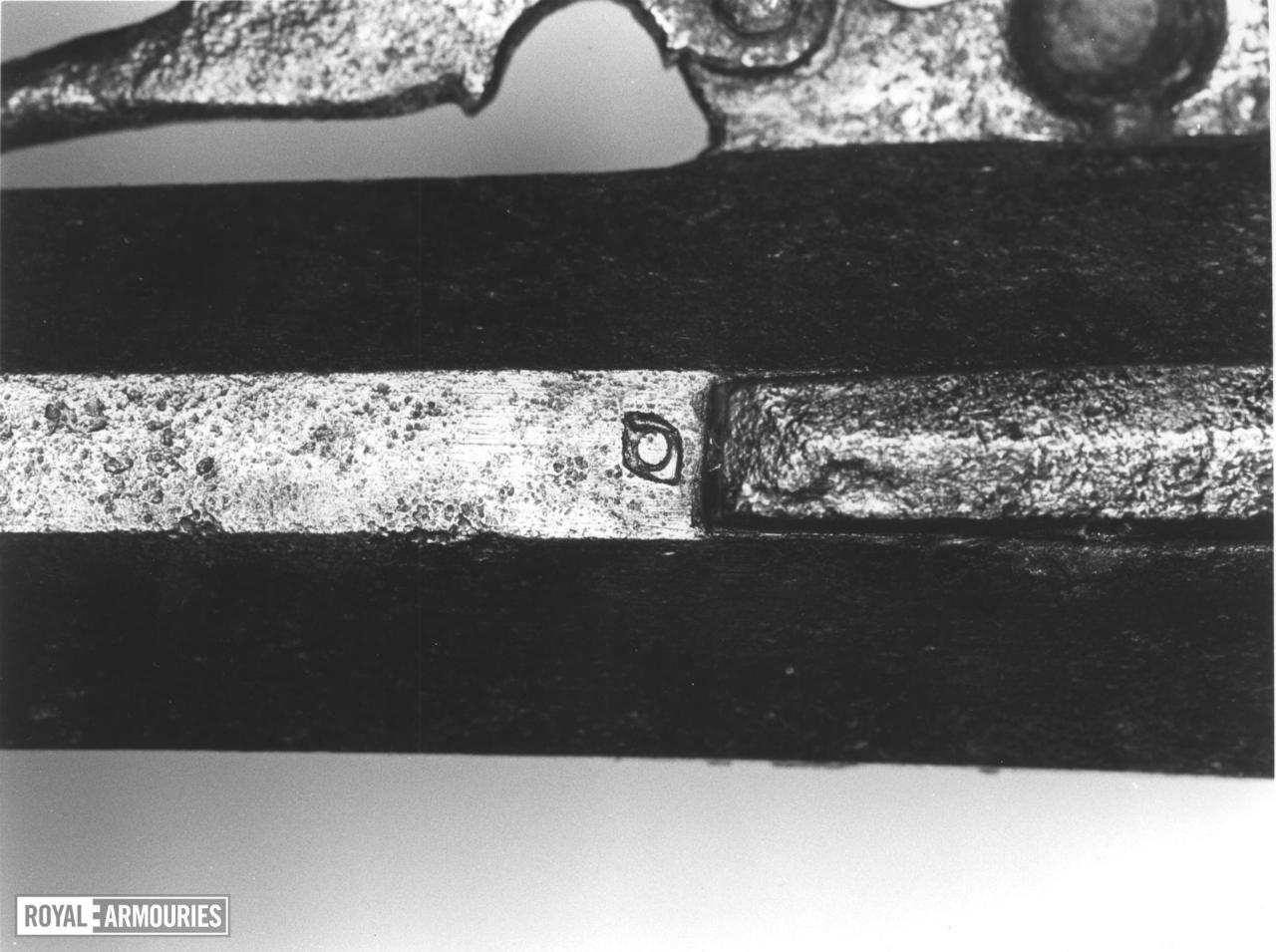

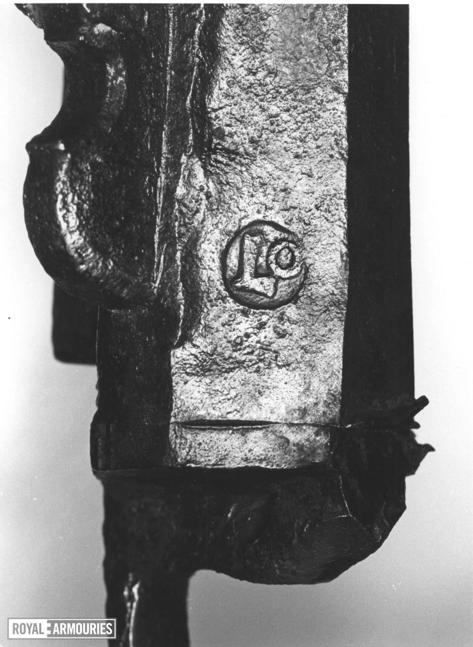

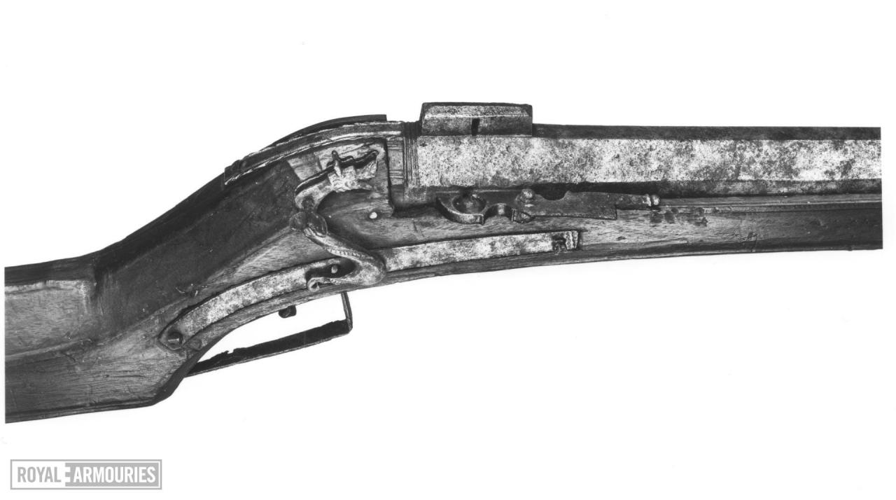

By chance i found these at the Royal armouries website and thought it well to show them and lift this thread up, once more to be enjoyed.
All pictures in this post are copyrighted by the Royal Armoury and are not to be distributed without their consent.
