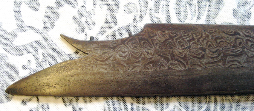

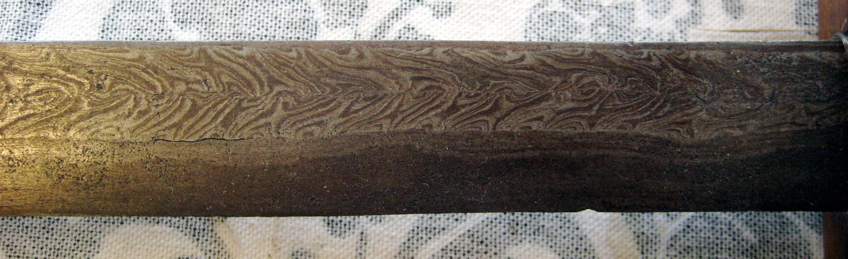

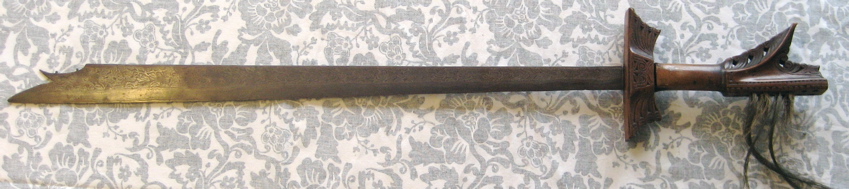

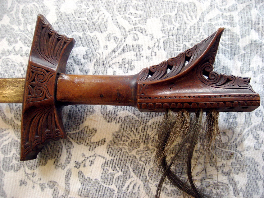

Here is a bonus reference btw, a kampilan with twist core.

Thanks Michael, what a nice piece. Not often that one sees twistcore on a kampilan let alone a Moro piece.

Incredible piece with that double twistcore and dark hardened etch Michael! This certain is a top piece.
The pommel style is also one of my favorites.
