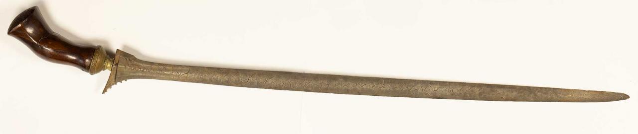

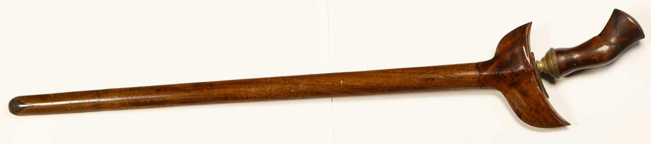

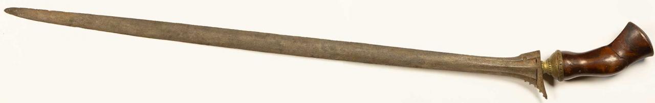

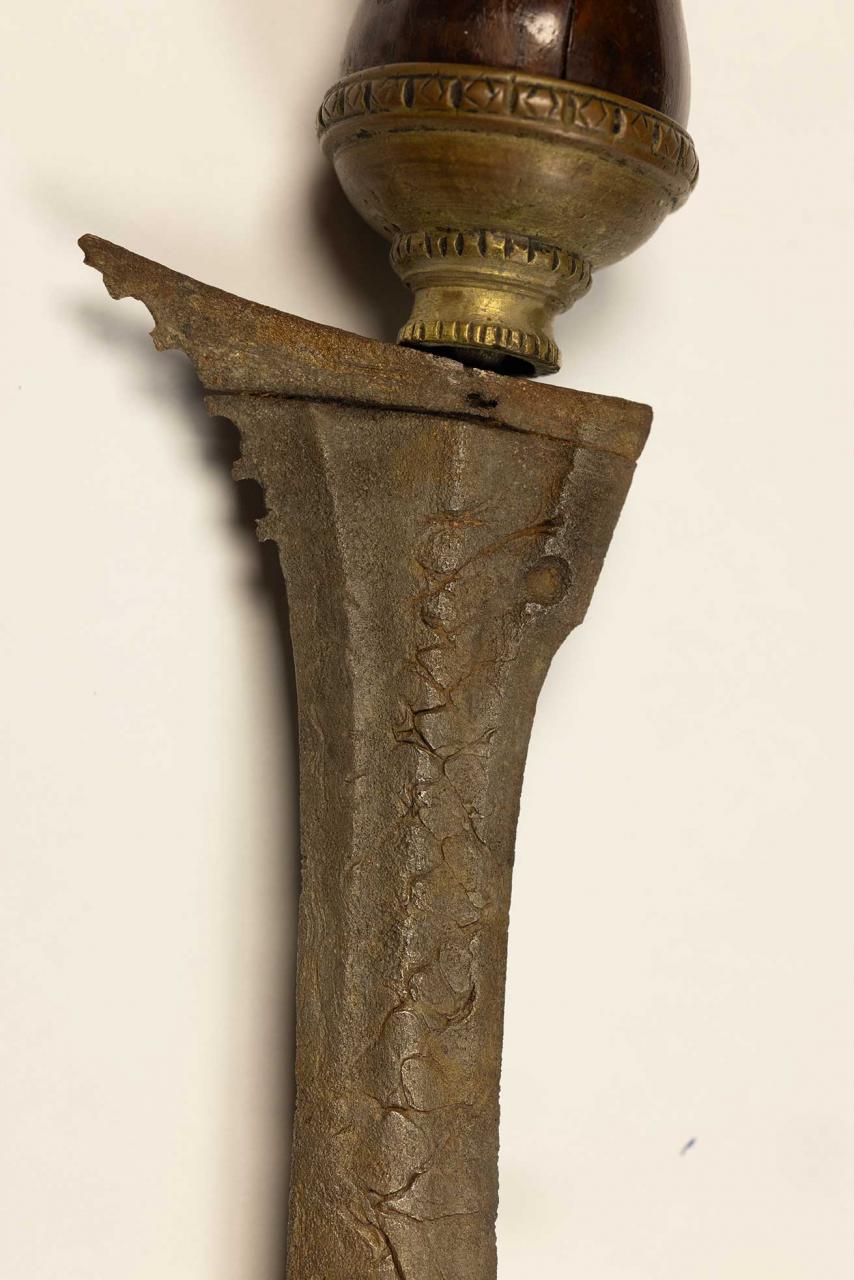

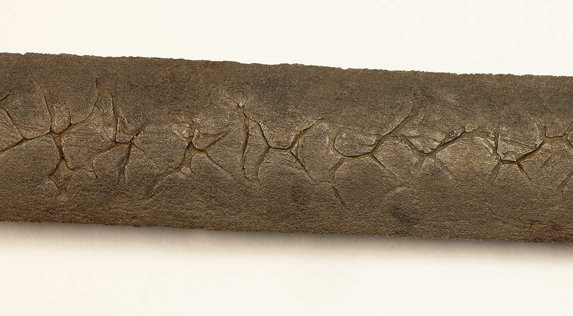

Hi Alan,
Now would this blade be pamor or a blade that went wrong?
From Peninsular Malaysia perhaps?
Length: 56 cm from Tip to base of Ganja.
Cheers.
