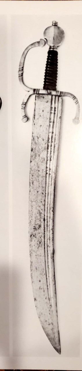

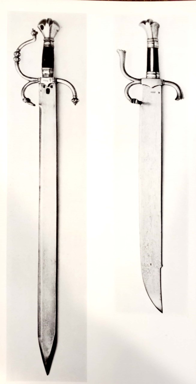

In looking at the possibility of this being a Genoan sword in entirety, I looked at "Armi Bianchi Italiene" (Boccia & Coelho, 1975) and found three 17th c. Italian swords (#543,44, 547) with similar quillon arrangements. While similar they are not necessarily convincing.
The Maghrebi nimcha did evolve from Italian hilt forms it seems, and there are variations of both their prototypes as well as those in North Africa. There are differences in the number of quillons beween Moroccan and Algerian (if I recall Louis-Pierre's paper) not to mention those with guard ring, pitons etc.
If the Genoan character in this region was diminished as reflected by the history of this area as described, especially by the 18th century period which seems to be that of this sword, then why would it be Genoan? The seeds for such influences had widely diffused into these areas as well as into the Caucusus (the 'gurda' sickle marks on Chechen blades).
By 1783, it sounds as if the Ottoman presence and ultimate conquest of this area (and others in Black Sea) was profound thus the presence of a Maghrebi sword in this context and period sounds quite logical.
The similarity to the North Italian (not necessarily Genoan) hilt forms shown is notable, as well as the fuller character is much as seen on many Italian blades of the 17th into 18th c.However, it must be remembered that the earlier import of blades from Italy (often Genoa) into the Maghreb had become such a tradition many blades were simply labeled 'Genoan' even if they weren't.
I remain with the idea that Genoan classification to this sword is not necessarily the case just because the area was once a Genoan trade location, and the find is more likely to have come from Ottoman presence there in events and actions of the 18th c.

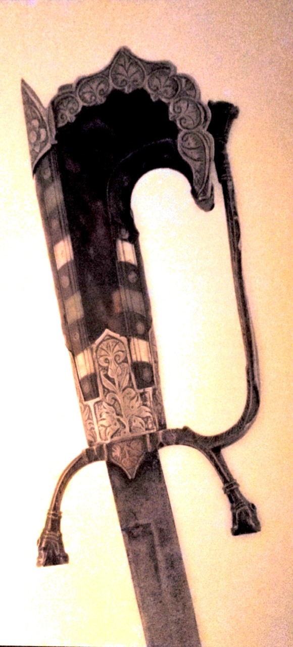

The attached are images of the Italian swords (17th c) and two examples of Maghrebi nimchas. The guard of the sword discussed may have had the 'outer quillon' broken off.

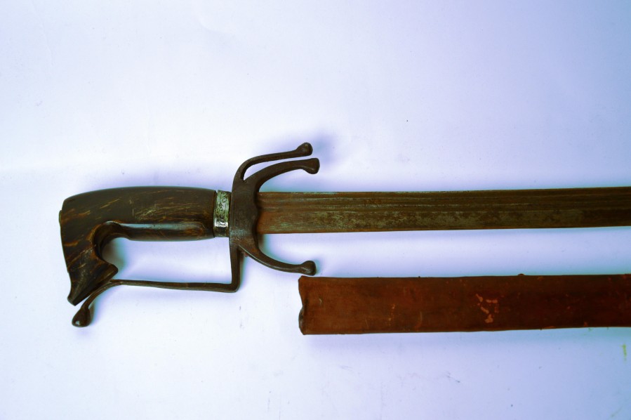

Old 27th May 2019, 10:17 PM   #32

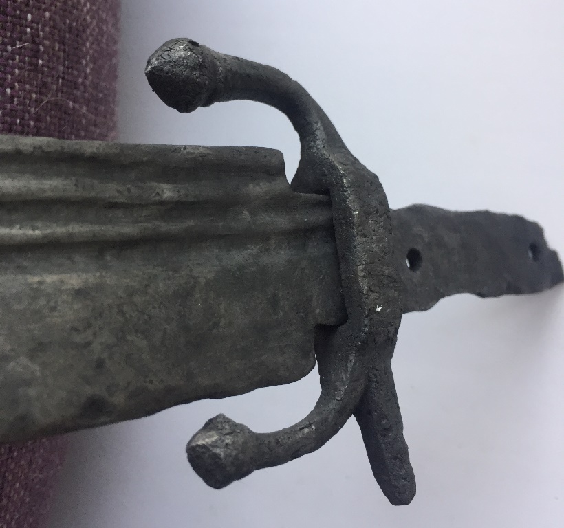

Hi Jim,
While the quillons on this example (and the tang holes in the blade) may not be entirely in line with most 'nimcha' examples, it must be remembered that these Maghreb swords typically used European blades.
Have you seen nimcha tangs? I did.
No holes so far.
But as you said some blades might have been reused and tang holes cannot be excluded.
Remember that trade blades were sold new sometimes if not always.
Agreed.
Disagree, it's the first thing that I looked, no space for another one.

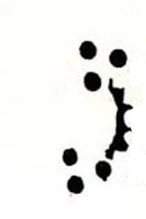

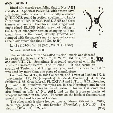

Default Addendum: The Sickle Marks

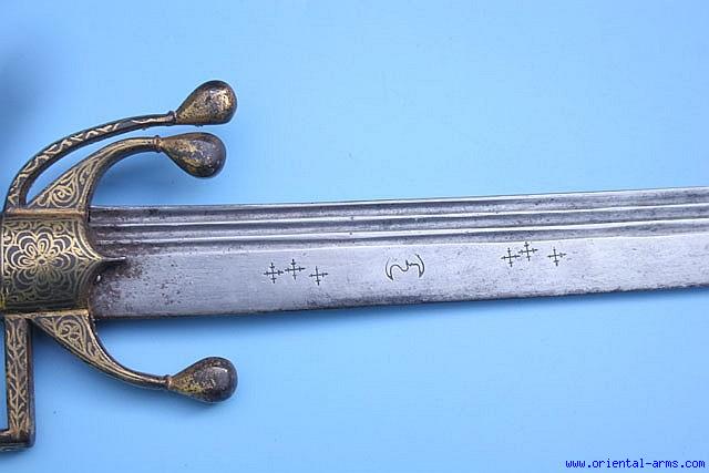

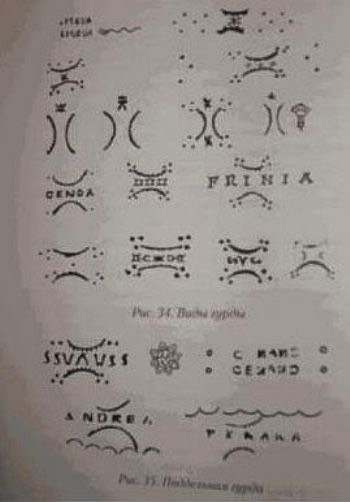

I wanted to add some detail on the markings seen on the sword we are discussing in the previous posts.
This marking, primarily three dots at either end of a typically dentated arc, have usually been associated with Genoa, as many of these were often situated with GENOA with them. Genoa was a key port of course and with sword and edged weapon blades these markings seem to have been applied perhaps in some sort of guild or other type export mark.
Soon, as with many such markings, their presence was considered a mark of quality, and their use expanded to many blade making centers in that regard.
As mentioned earlier, in the Caucusus, the use of this 'sickle' mark was adopted as a quality mark, and the blades with it were called 'gurda' (=good blade).
These markings were used in variation in many North Italian centers(not necessarily Genoa) as well as soon adopted by makers in Styrian centers and of course Solingen. Native artisans copied them in India, Arabia, North Africa and others.

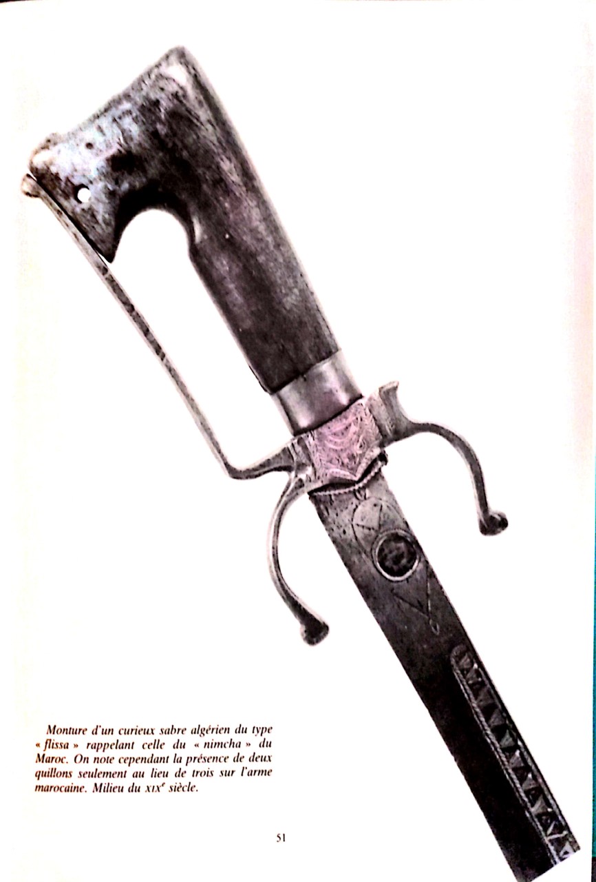

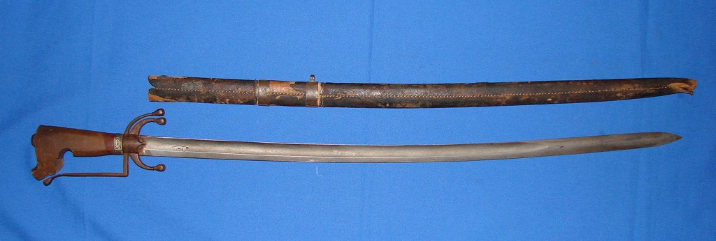

Just for the record, it seemed I had recalled instances of nimcha which indeed had two downturned quillons rather than the three which appear standard on the Moroccan versions.
Apparently in Algeria, there are examples of nimcha hilts with just two quillons downturned, and I found this noted in " Islamic Weapons" Maghrib to Moghul", Anthno Tirri, 2003, p. 42-43, fig. 21A);
"...Algeria produced a version of the Moroccan nimcha but with two basic differences. The Algerian nimcha has only two downturned quillons and the blade is usually a locally produced flyssa style blade".
The illustration I have attached is from "Les Armes Blanches du Monde Islamique" (Alain Jacob, 1985. p.51). ..an Algerian nimcha with two downturned quillons.
Clearly the sword we are examining does not have a flyssa blade, but it does have two quillons, not three.
In Tirri (p.42, op.cit.) the word 'usually' regarding the use of flyssa blades is key. It seems reasonable that in Algerian coastal regions, particularly those involved with Ottoman naval/pirate activity, the blade of a flyssa would not be preferred, but the use of a sturdy European blade would.
Briggs (1965) in his article on European blades in Tuareg weapons also illustrates a nimcha blade (similar fullering), but it appears to have a Moroccan hilt. What is interesting is that Briggs was in Algeria, not Morocco, yet a Moroccan style example was found there. Obviously, there was an interpolation of the two hilt forms in the Maghrebi littoral.
I attached illustration of our sword in discussion for comparison rather than having to keep scrolling back to it.
JUST FOUND ANOTHER(bottom illustration).
From "Arts of the Muslim Knight" ed. B.Mohammed, 2008, p.18
'...from Algeria, Oran, Ottoman period, c. 1720-32'
While these quillons are not of course identical, they do illustrate the proclivity to dual quillons in Algerian hilts of the nimcha style.

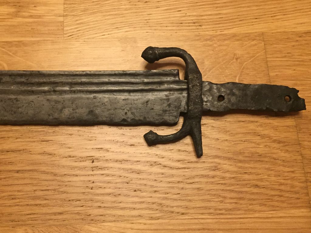

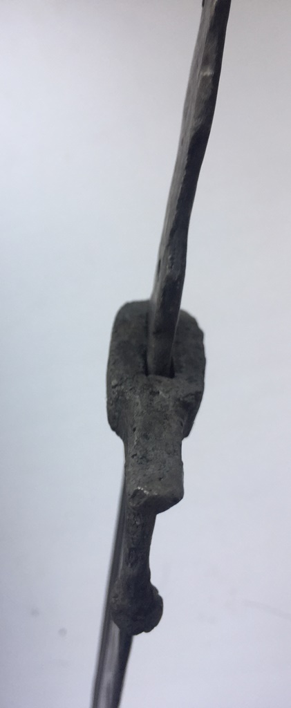

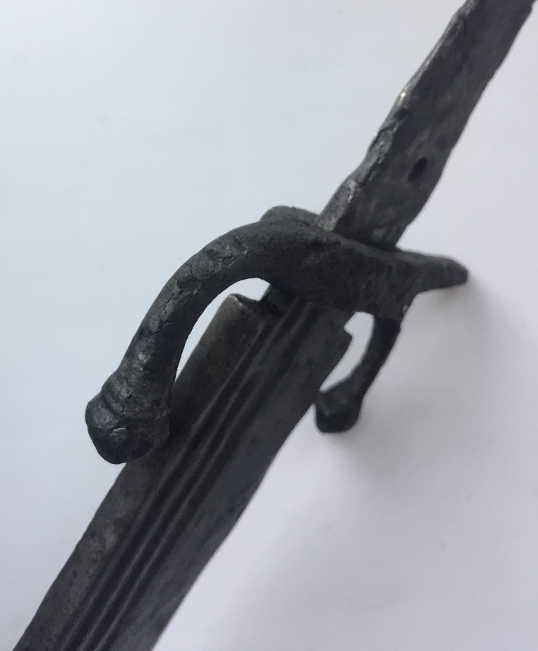

Dear Jim, it seems that you are right and there is a wishful thinking from my part. In any case, I would like to correctly identify this item.
It seems to me that there wasn't a third quillon. Please look at additional pictures.

Thank you Evgeny for the response, and Kubur has noted (#33) that no third quillon presence seems evident. The reason I brought up the dual quillons was to support that such variation did exist in Maghrebi nimcha, and were apparently relegated to Algerian versions (the Moroccan had three quillons).
I well understand wishful thinking in examining and identifying a weapon, but for me truth and correct as possible classification also have their own virtues. Often the investigation of a weapon brings to light wonderful historic aspects of its presence in certain contexts which might not otherwise have been revealed.
The fact that this is probably not a Genoan weapon indigenous to this Black Sea region as it dates long after Genoan colonial presence had dissipated there does not preclude the fact it might still be an Italian blade. However, its means of arriving in the area it was found MAY have been through the conduit of the Ottoman forces with Maghebi weapons in this region in the 18th c.
Even if found to be a weapon which indeed came from these Black Sea regions, the blade still could be North Italian or Styrian, as these centers produced blades well through the 18th c. These same blades which often reached North Africa also went to many foreign ports including East European, Russian, Balkan etc.
Whatever the case, the fact that this sword was found in situ in the location you describe gives it stellar provenance on its own merits.

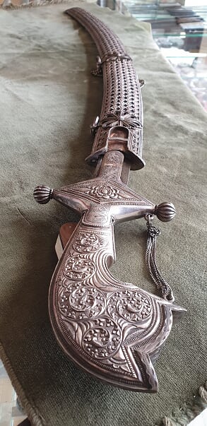

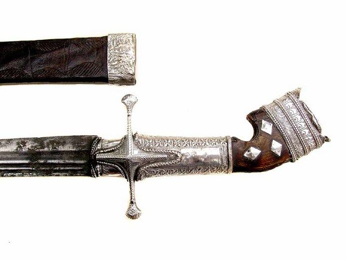

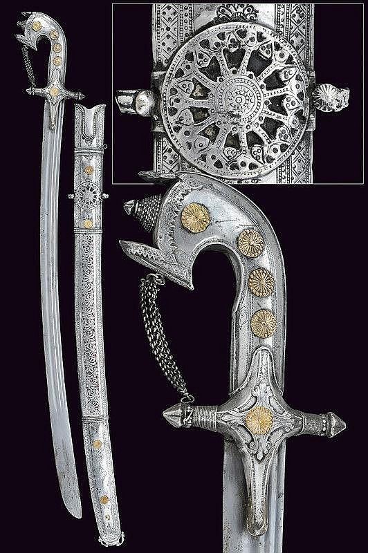

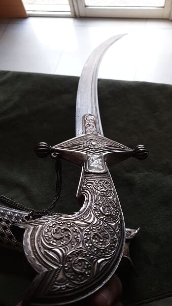

Nimcha.
Thje weapon below with the sunlight from the window on it simply compared with the Butin charts gives the impression that this is a Nimcha and likely from Saudia.
The give away being the silver covered hilt and sharply turned pommel . Interestingly this weapon also has the chain knuckle arrangement and straight crossguard…Finials terminating in vegetal ends. The geometry in the centre of the crossguard suggests an evil eye design.. The blade has a heavy looking backblade and is curved to a point. The 5 silver sworls on the hilt suggest geometric hand of Fatima style.
The example against a jet black background is another KSA version.. and also has a 5 geometric decoration on the hilt in this case circular perhaps coins or coin lookalikes often copied. The weapon with three silver shots on the hilt is Yemeni. The other Nimcha is lengthways and has a black leathered hilt and is a Met Museum item...with a similar rounded rainguard.
