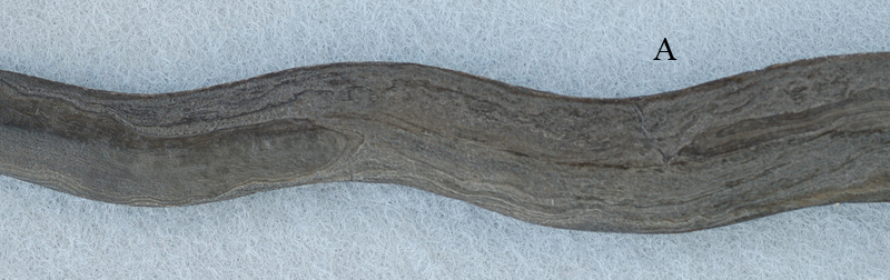

Old 16th August 2009, 02:47 AM   #48
Posts: 7,229

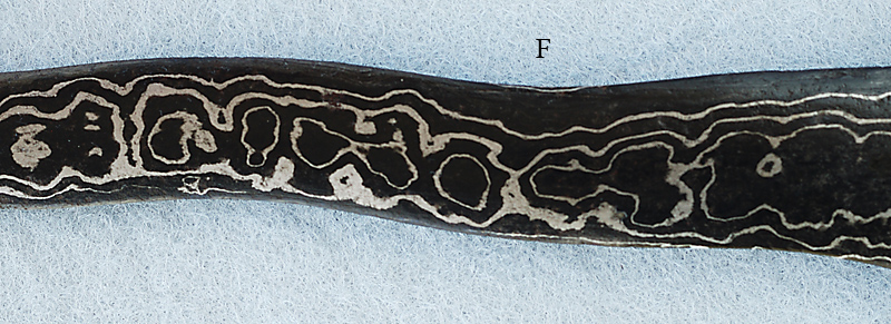

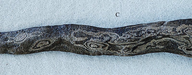

A.--- An old Madura blade, arsenic trioxide, stained about 1965.

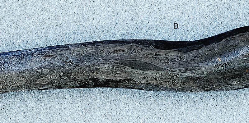

B.--- An old Sumatra blade, stained in about 1960 with sulphur, salt, rice water.
C.--- An old Bali blade, arsenic trioxide, stained about 1962; this blade was extremely corroded and had deteriorated badly prior to the clean and stain.
D.--- An old South Sumatra blade, arsenic trioxide, stained about 1974.

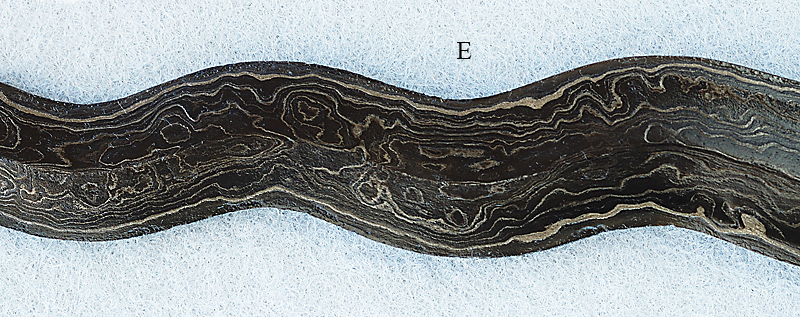

E.--- An old Surakarta blade, arsenic trioxide, stained about 1978; this blade was purchased from an English dealer and is attributed to Wirasukadgo.
F.--- An old Bali/Lombok blade, arsenic trioxide, stained about 1970.

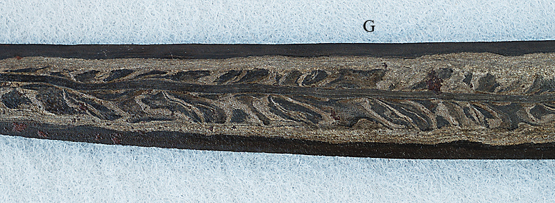

G.--- An old Peninsular Bugis blade, stained with warangan in Jogjakarta in 1972 by Romo Murdo; this was a "quick fix" stain, not a proper clean and stain.

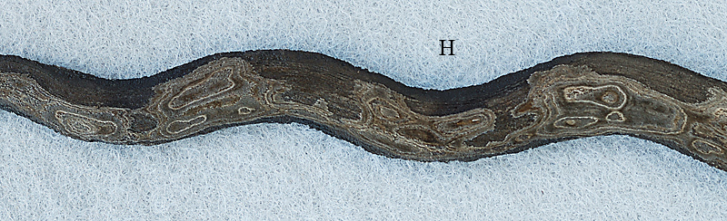

H.--- An old Jawa blade (Senopaten), stained with warangan in Jogjakarta in 1978; this is a standard commercial stain.

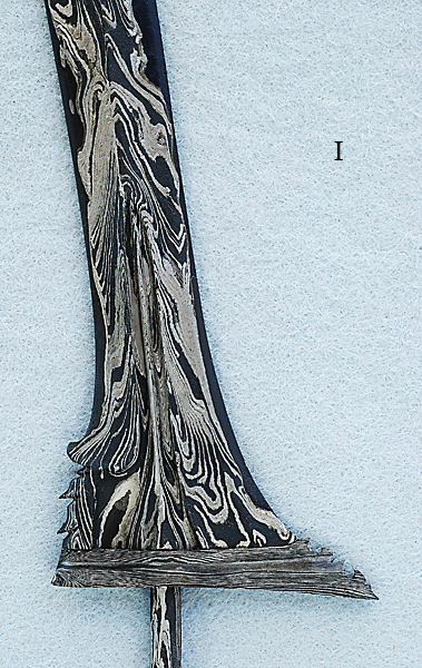

I.--- A keris made by Empu Suparman in 1982 and stained by him using warangan.

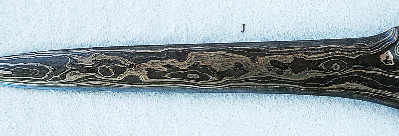

J.--- My first attempt at pamor in a keris blade, made in 1980 before I was taught by Pak Parman, this stain was done with arsenic trioxide.

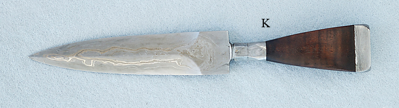

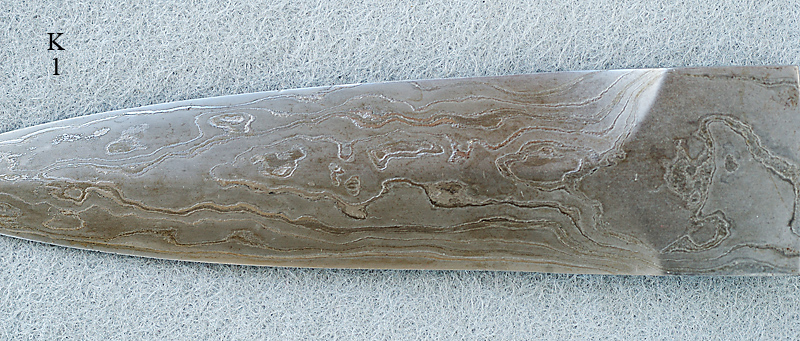

K.--- My first attempt at pamor in a dagger blade, made in 1980, this blade is the same construction as a keris, with a steel core and pamor of nickel and iron on its faces, the blade has not been stained but only etched with dilute hydrochloric acid.
K1.--- Close up of K.

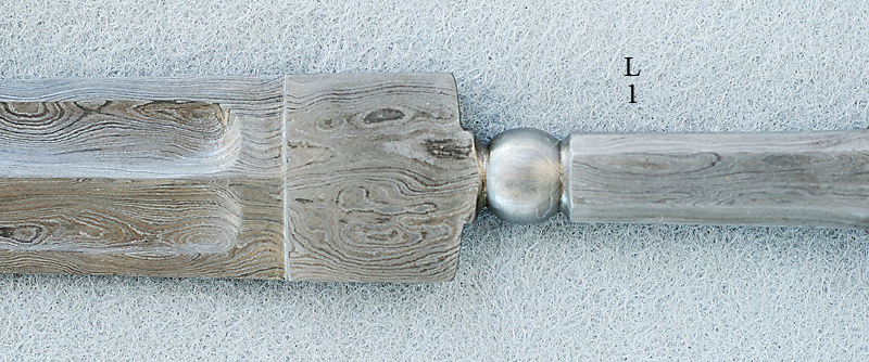

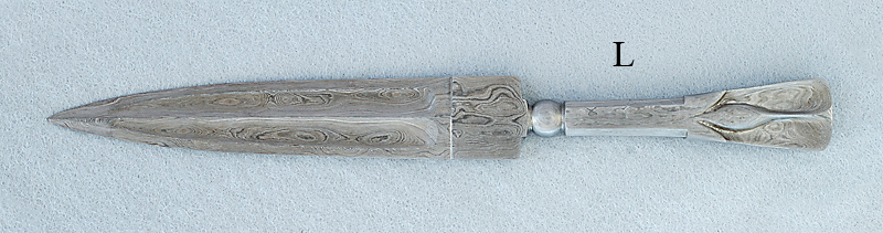

L.--- A dagger of damascus which I made in about 1985, this is made of wrought iron and 01 steel, it was etched with hydrochloric acid, stained with ferric chloride, then washed with white wine vinegar.
L1.--- Close up of L1.

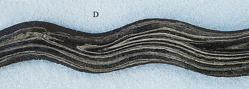

Looks like they've been posted here in a very disordered fashion, guess you'll just have to look for the titles.
Old 16th August 2009, 02:50 AM   #49
Posts: 7,229
I had 14 pics but could only upload 12 at a time, so here are the las two:-
Old 16th August 2009, 04:50 AM   #50
Posts: 7,297
Thank you so much for this presentation Alan.
Just a bit off topic because it is not a keris, but i really like the design of this last blade you posted. Very eloquent.
Old 16th August 2009, 05:59 AM   #51
Posts: 7,229
Thanks David. It is one of the better things I've done.

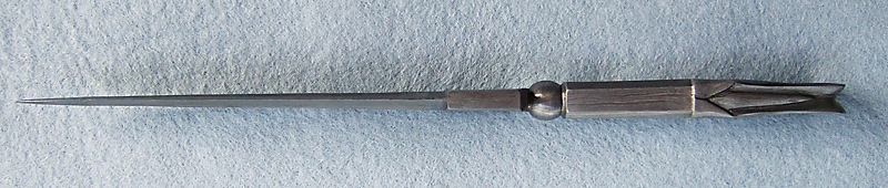

I'm not so sure that this is off-topic, because what we're talking about is blade staining, and I believe that this encompasses more than just keris and arsenic. I've stained many different types of materials, and I've used many different substances to achieve the stains. The wider one's experience the more that experience can contribute towards the achievement of excellence in just one medium.
What I've tried to do with these pics is to show some of the variations that can occur.
Here is a side view of that damascus dagger.

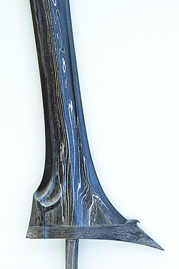

here some more (clearer) pics of the blade recently done. Notice the square peksi, as writen of in other thread. For the ones remembering, that i did promise to post pics... after long search (at my moms house). found it but did not want to show without good clean and wash. Beter late than never.

.....here some more (clearer) pics of the blade recently done. Notice the square peksi, as writen of in other thread. For the ones remembering, that i did promise to post pics... after long search (at my moms house). found it but did not want to show without good clean and wash. Beter late than never.
Yes it's too dark!!. I 'ld try to wash it with a little lemon juice in the water... or a lot of cream soap over my fingers (...if the cream becames yellow...great day!! )
Old 16th August 2009, 02:36 PM   #54
kulbuntet
kulbuntet's Avatar
Join Date: Oct 2008
Location: Amsterdam, Netherlands
Posts: 159
Opinion or fact? And can you underbuild you statment how it should look like... pics please.. from a equal blade with same pamor material! Not technique. Would like to see what you like/mean.
I dont have an equal blade with same pamor material
did you ever wash one like it?
kulbuntet is offline   Reply With Quote
Old 16th August 2009, 02:50 PM   #57
Posts: 7,229
Yes, in the photos this blade looks too dark.
But it may not be.
We do not know what the true colour of the material is:- we can all only work within the limits of the material.
It is not possible to make a Tuban blade look like a Surakarta blade.
Maybe what we see here is the correct colour for this blade.
Look at the examples I have posted:- there is a lot of variation in colour, and this is only a small sample, in reality, blade colours can vary a lot more than this.
Because of the limits of the material we need to be able to classify a blade according to tangguh so that we can recognise when the blade colour is correct.
like it never
...but i washed a lot (sometime a lot of time only for one blade )
Old 16th August 2009, 03:09 PM   #59
kulbuntet
kulbuntet's Avatar
Join Date: Oct 2008
Posts: 159
hmm, oke.
I do share you opinion that some blades have to done of and over again. I is same like handeling people man or woman( one even more difficult than other :-)
especialy when you dont know the blade/ person.... And even iff you get to know how he/she is for person.. stil have to figure out what is good or wrong. like in clothing... but the clothes have to fit..
Iff there are 2 dresses for putting one one woman... you realy like the white neat dress.... but she is size 32 and the dress is size 28.... will it fit?
just try to make a point here.. hope its clear, probaly wont be ...
let say iff i thought it was not good, for this keris.. would not have post it.. would already have washed it back.. no detergent/lime.. just cocowater.. does the job too and neutralise the arsenic still in the blade.
Would hope that you can find a pic on the net or so, to show me what contrast you prefer. Btw some of Alan's blades the besi much darker.. But also diffent background and photo's..some dry some in oil, some newisch, some old pamor... I dont think it's posible to get same results on diffrent blades, with manny diffrent factors, influencing the results. But that also it a opinion... Open for dialogue
regards
But it may not be.
Oke Alan, good comment.. cleary build..how can i be of asistence to give you more info to give you a clear impression of the blade (tanguh). Must i post dry pics?
addon,
this blade is when in oil (not like in pic) almost same colour.
