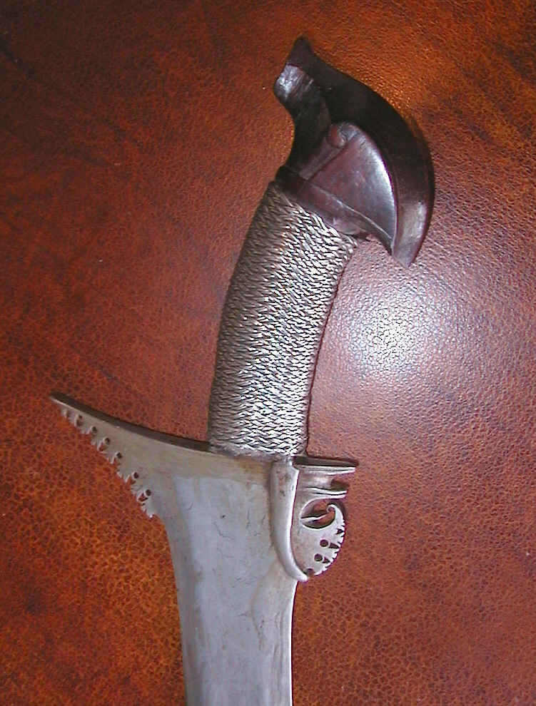

Posts: 6,441
Here is an example of the asang asang tail running up outside of the hilt , notice that it also acts as a tensioning device to keep the silver wire wrap tight .

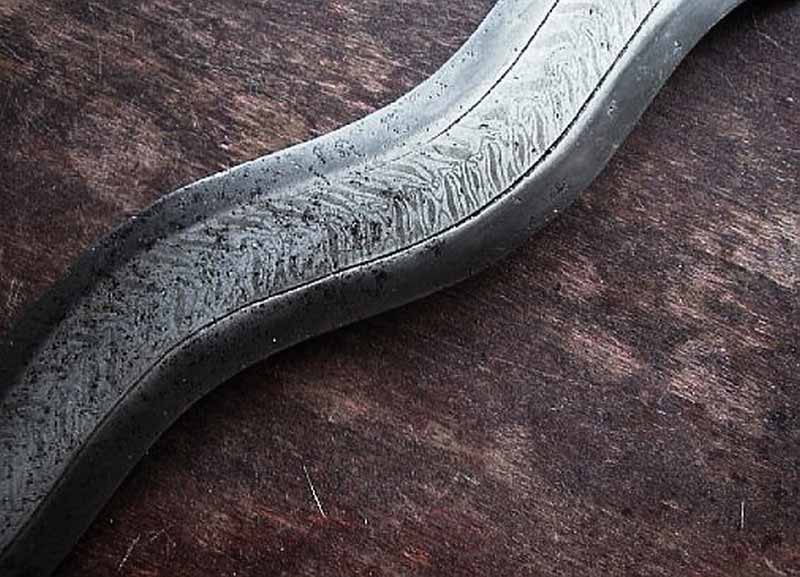

I wanted to comment on the 2nd Keris Moose pictures. It is a really nice sword and I would say there is a good chance that the center section of the blade might have some interesting lamination. These blades are often of sandwhich lamination where you have a central core of laminated, twist core or mechanical damascus steel with high carbon edges. Here is a section of blade from a piece in my collection that also has the diminutive kakatua pommel and the 18th century style blade. The pattern that came out in the central panel is pretty neat.

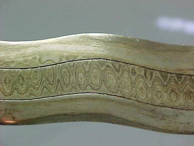

Posts: 6,441
Talking
Here's another example of what may be hidden .
Pardon the poor photography .
