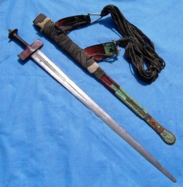

It is very nice I think is a beginning of the 20th century one. If it has as you say a heavy blade it might be European. The Tuareg blade are very thin and flexible.
Do you agree with me that your nice sword is Bali? They had skilled blacksmiths capable to come up with that blade plus their swords are very rare and that would explain why I have never seen one.

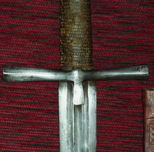

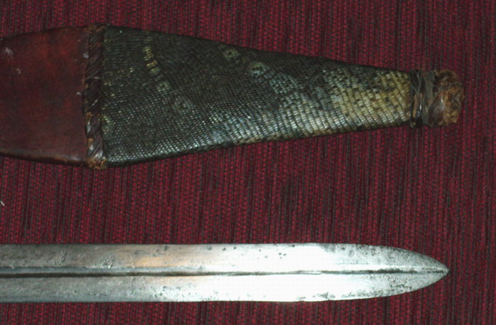

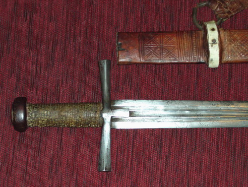

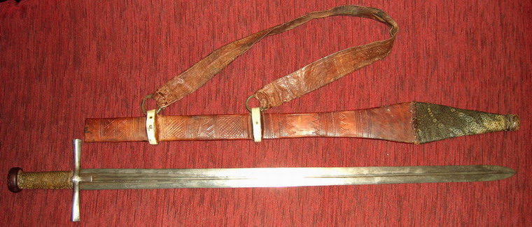

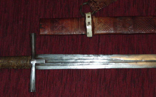

Hi guys, what do you think about this one? blade is european or african?
Old 20th October 2006, 08:31 PM   #35
katana
katana's Avatar
Location: Kent
Posts: 2,658
Flavio nice Kaskara...IMHO the blade looks to be of local manufacture...the grinding marks would have been polished out in a Euro blade.
The fuller running down to the point may suggest the tip of the blade may have been broken off during its life.

Hi katana, the grooves seems to be forged, not grinding. Anyway also to me the blade seems to be of local manufacture. Yes, could be that the blade was shortened.

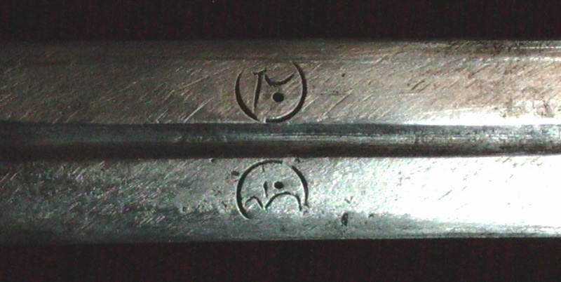

Well what about this then? Two kaskaras (one mine, not pictured) and a Scottish basket hilt with near as dammit identical blades. Engraved decoration so similar I think they must be from the same source. Pictures and a little bit of input over on SFI.
1st posting
ELJay's input
Sorry for the myriad links to see all the pics. Unfortunately I lost the photos of mine in a computer crash, but it really is almost indistinguishable from the other two except for a greater degree of wear.
Anyway, not that I doubt Artzi & ElJay (too much ) but if these are North African made blades, how many did they produce to make it likely I'd see three within as many years? I can accept a Solingen cutler banging out industrial quantities of blades (witness the thousands of very similar JJ Runkel retailed Georgian military blades still around). Was bladesmithing in North Africa similarly grouped into a few large volume producers? I know shallow fullered blades struck with crescent moons are very common but perhaps naively, had imagined that every local smith would have his variant of the stamp.

Sadly I cannot add a kaskara pic as I swapped the last one I had for two more rare Mahdist weapons. My observances have been that the half moons do vary. To me the basket hilt sword does have a European blade. The other indeed looks very similar but I would agree that it is probably made in Africa. I believe it is possible to discern a difference in the steel and the workmanship most obvious at the forte. Being able to handle the sword would be how oppinions were formed with confidence. I could also be wrong .

I have seen a number of German blades made for takobas, kaskaras and gurades mounted with baskethilts. I have been able to trace a couple back to where the two met. They were modern creations from parts. Your blade is a Kaskara blade. The snake is a Persian influence on these weapons, I don't know its significance. I would think it is unlikely that your blade and hilt started their life together.
I think the Oakeshott warning about medieval swords with kaskara features also applies to the modern swords as well.
