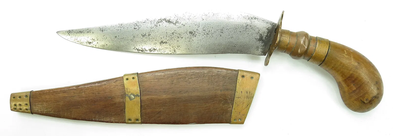

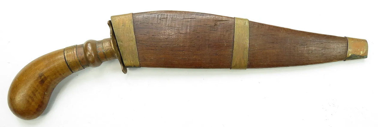

Posts: 4,709

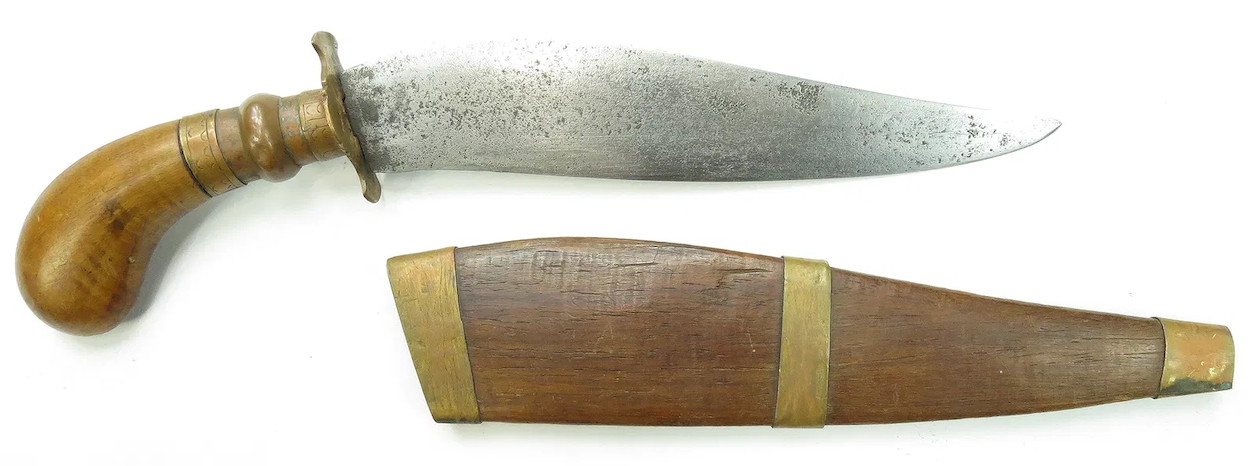

Here's another one with the older style of brass ferrule and guard, similar to others shown in this thread. The blade may be a recycled end portion of a Moro kris. The scabbard appears to be newer than the knife.
Overall length 30 cm (~11.5 in.)

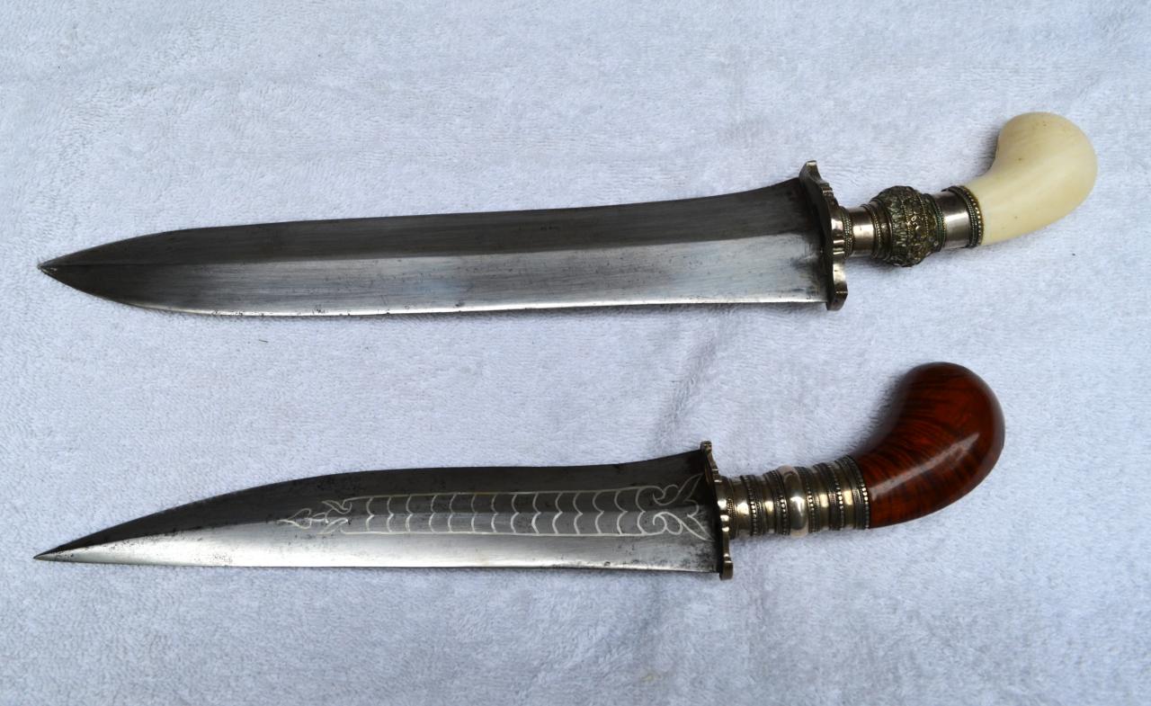

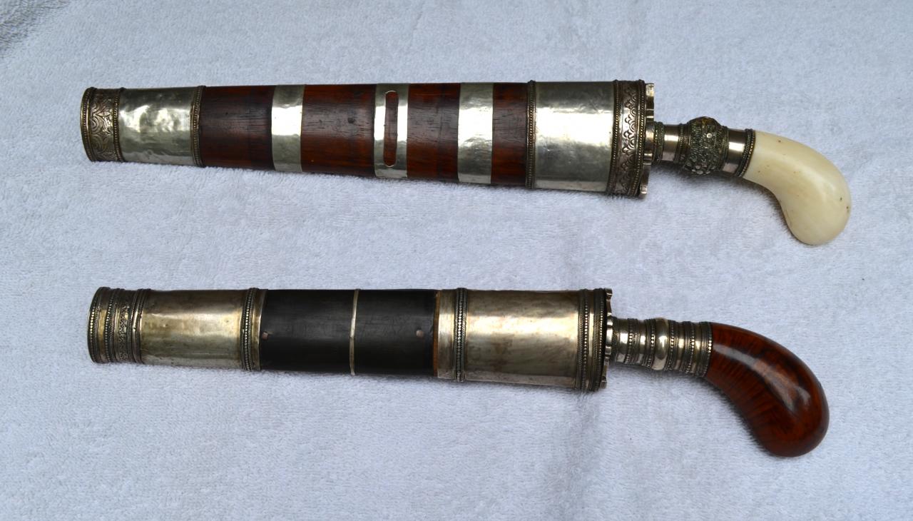

drac2k
Posts: 1,323

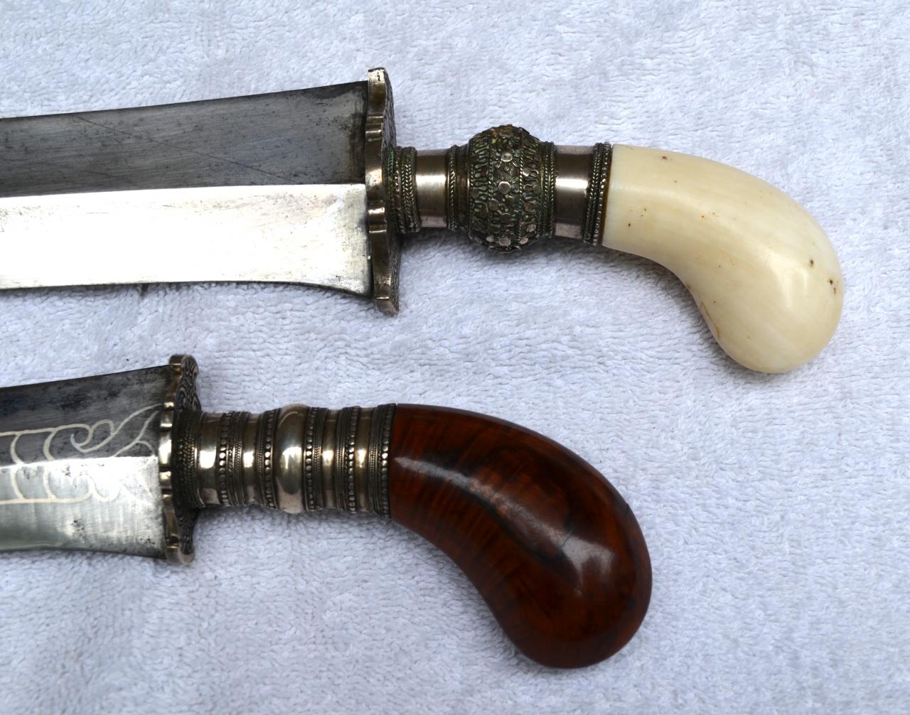

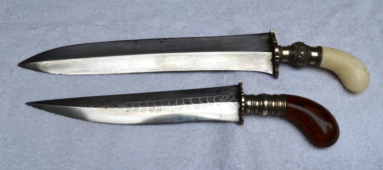

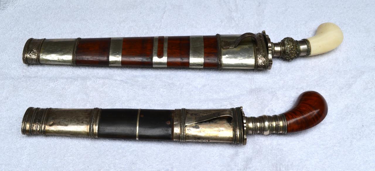

Since everyone was posting punals,I thought I might post a couple of mine.
Old 27th May 2025, 02:15 AM   #34
Posts: 4,709
Hi drac, Very nice gunong in heavy silver mounts. I think these are all 20th C examples, whereas this thread has been focussing on earlier pieces with brass/bronze ferrules and guards.
Old 2nd June 2025, 07:26 PM   #35
drac2k
Posts: 1,323

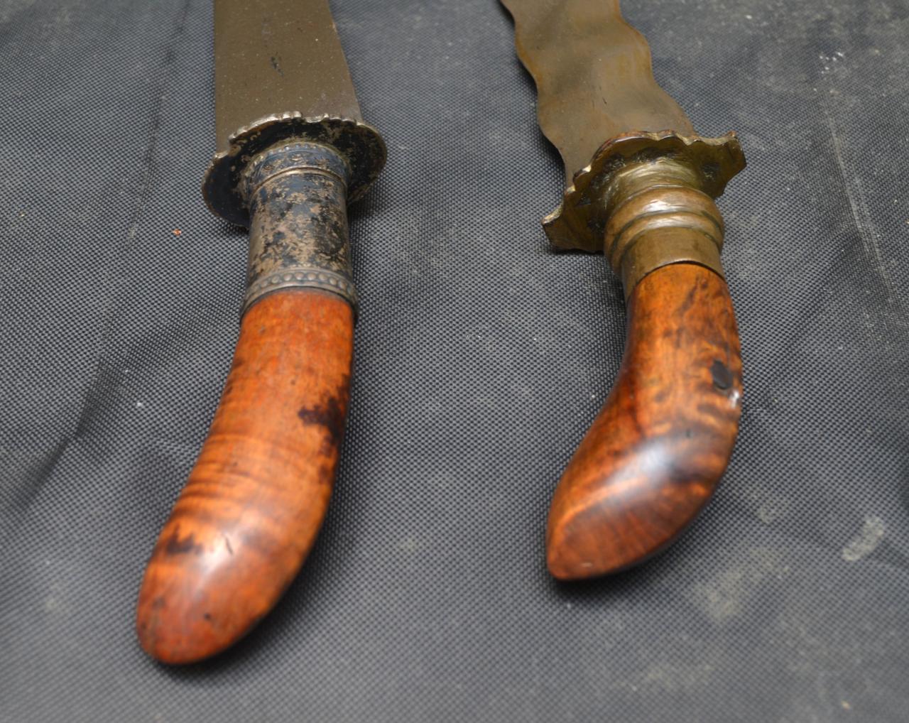

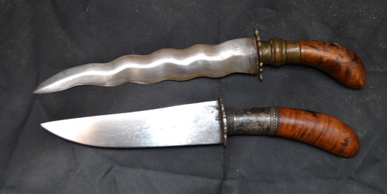

Ooops;who knew that a thread that was titled "Bronze and Brass Punals," meant punals with bronze & brass fittings,lol.I guess my powers of observation haven't diminished(just not improved).
Let me try again
Old 2nd June 2025, 11:53 PM   #36
Posts: 4,709
That's much better.
Those both look older examples. The more elongated, less "globular," pommel on the bottom one looks like an older style, and the top one has a brass/bronze ferrule that fits right in with the styles shown in the earlier part of this thread.
Nice examples. Thanks for sharing them.
