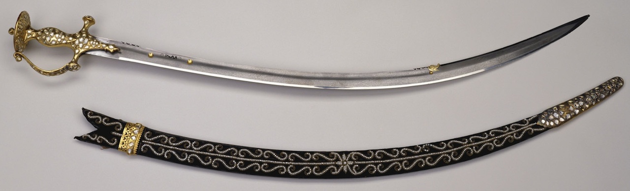

Is there a name for this feature on the spine where the false edge begins ?
Looks like a good no nonsense weapon Tim; fully functional beauty .
Do you mean the part in this interesting example covered in gold and in the shape of a makara ?

Likhari could you please show a close up of the yelman shown in post #32, and of the whole sword if possible?

A sword or talwar with a curved blade and an iron hilt with knuckleguard and circular pommel gilded and inlaid with diamonds and rubies around edge of pommel. The edge section of the blade near the bottom overlaid with gold to represent a makara, a dragon-like mythological creature associated with Hindu iconography. The black velvet covered wooden scabbard embroidered with seed pearls and silver gilt mounts set with diamonds.
Provenance
Presented to King Edward VII, when Prince of Wales, during his tour of India in 1875-76 by Mahendra Singh, Maharaja of Patiala.
