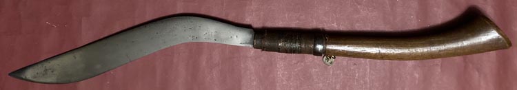

Originally Posted by Interested Party
Sorry for the bad picture. I had lighting issues and was more interested in presenting the text. When I looked at the originals with a jeweler's loop 526 appeared to have a Indonesian or Sumatran style pamor. 528 had a cloudy line down the longitudinal center of the blade with a light towards the cutting edge and a dark side towards the spine. I can't tell if it is a lamination mark or a differential temper.
Thank you all for explaining the ancestry of these weapons. Am I correct in assuming that they occupied similar places in the relative martial traditions as heavy choppers? I would imagine that given proximity these are cultures that had some contact with each other. I have been noticing that posted examples have very little edge damage. Does this mean that there was little blade to blade contact in this martial arts system, i.e. no or few parries, or are surviving examples ones that did not see use?
The small panabas pictured here has quite a bit of edge damage and a bullet wound to boot.

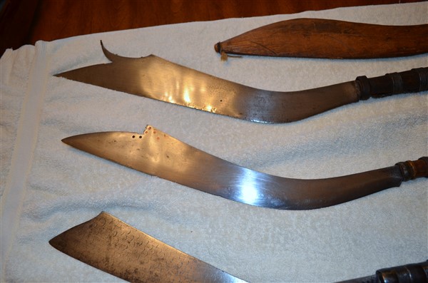

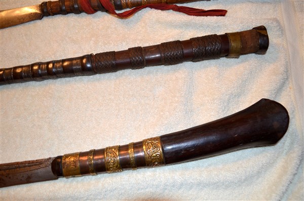

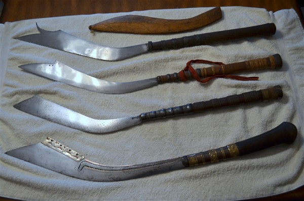

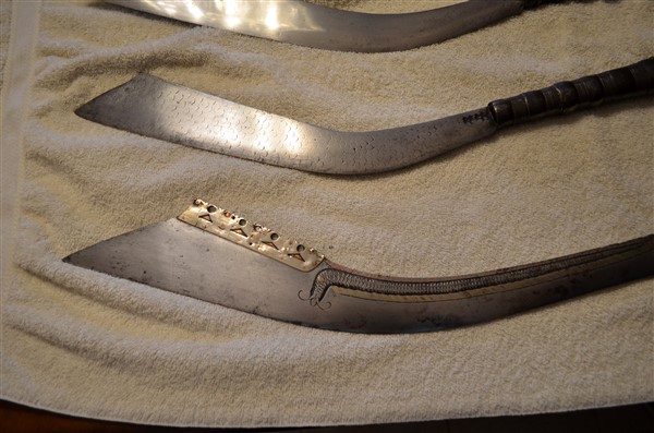

drac2k

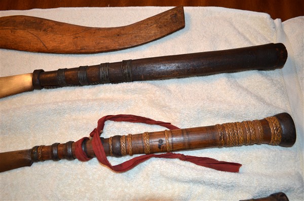

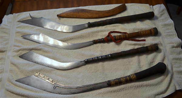

Posts: 1,332
Here are four of my favorite panabas,(panabi ?).
Drac2k, gorgeous Panabas’. First one I’ve seen with a centipede / millipede.
Thanks for sharing.
Old 16th February 2021, 12:24 AM   #35
drac2k
Posts: 1,332
Thank you Kino; I posted it earlier under the title of "Unusual Panabas," which has detailed pictures if you care for a closer look.

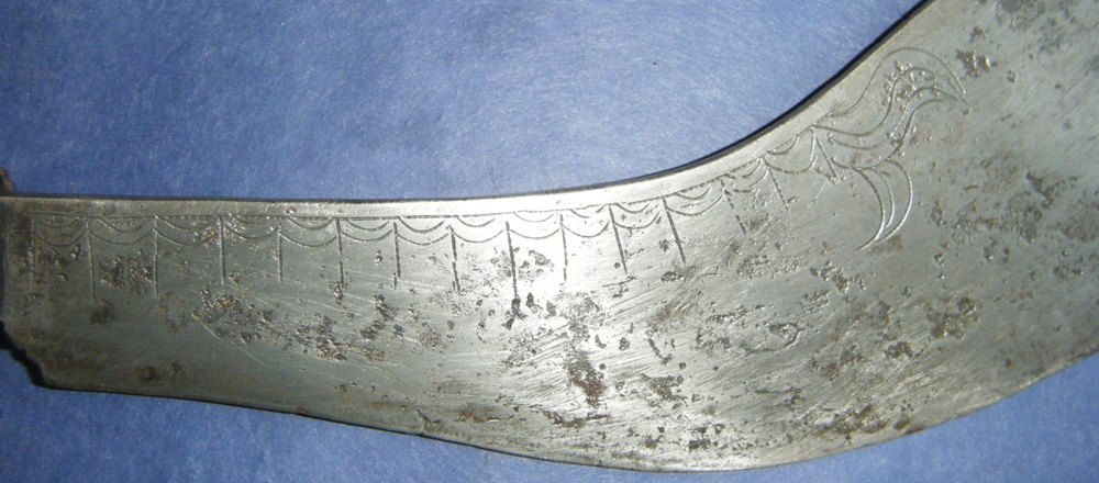

Originally Posted by Ian
Hi Jose,
Nice blade with carving on the end. This is now the third or fourth one of these I have seen, so yours is not alone. Any thoughts about the significance of this style variant?
Ian.
Not as sure but my thoughts are that this belongs not to a datu but to a higher ranking person within a datu's retinue. Thus the reason for the carved end, copper bands, and silver strip on the hilt.
I also wonder if this is a form of fighting panabas for a high ranking warrior under the same datu.

Posts: 7,406
Also Drack2, since the first time you posted your beautiful panabas (which one day you will donate to me, right? ) I found out that the centipede motif is sign of dangerous power and in tattoo form or engraved empowers the person or weapon with it.
Old 16th February 2021, 04:44 AM   #39
drac2k
Posts: 1,332
Okay, it's on the bucklist; now I just have to figure out how I'm going to tell my wife that I will be getting a centipede tattoo to go with my panabas.

Hello IP,
The one on the blue background I've shown in post #16 has a lot of nicks at the edge.

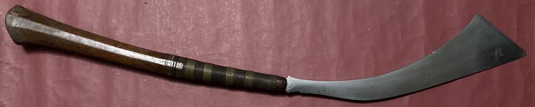

Hello Drac2k,
Stunning panabas, the one with the centipede!

drac2k
Posts: 1,332
Thank you Sajen as I like both of yours as well, especially the shorter one; I looked closely at your panabas in a previous post of yours, and the designs with the segmented body and a stylized mouth also reminded me of a centipede. What do you think?
Hello Drac2k,
Never thought in this direction but with some imagination this could be indeed a stylized centipede.
I too hadn't thought of that, although I have never seen any research of how Maguindanao and Maranao okir would be used for making a centipede. I do think it is a possibility. Among the Igorots like the Kalinga, Tinguian, and possibly the Bontoc, even half a stylized geometric centipede still represents a centipede and it's potent power.

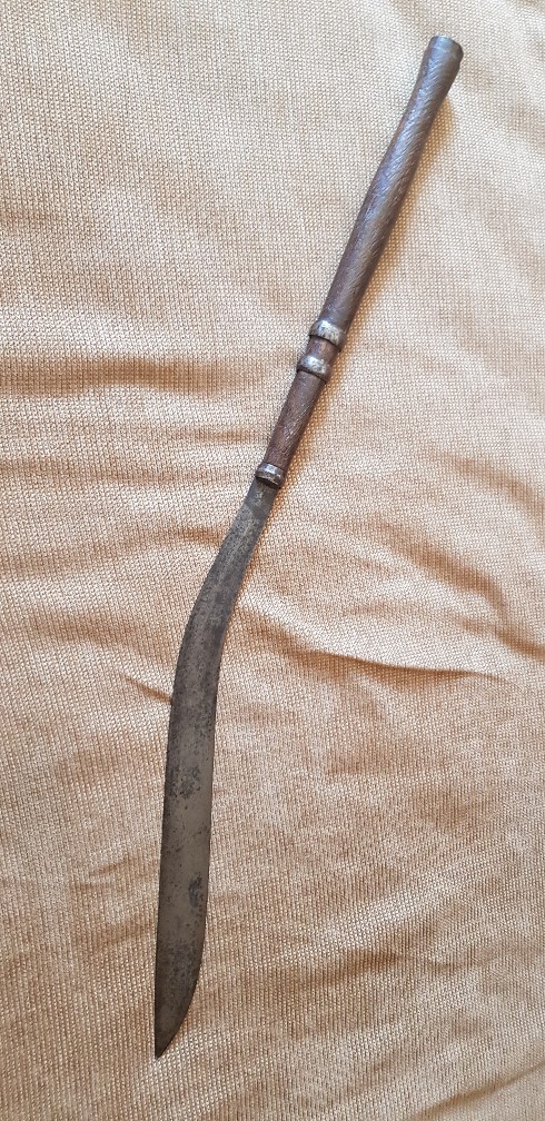

Posts: 755
Another example more ...

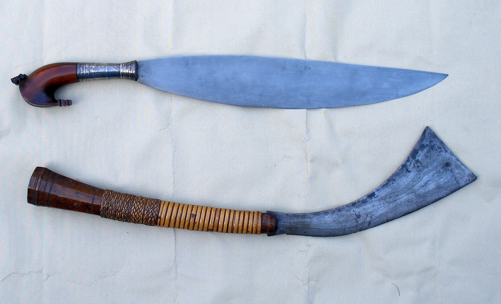

Default Panabi
Decided to a jump in on this and add to the reference photos.
Very nice samples! I've noticed that panabas with short handles and long blades tend to be older. I've seen a couple of references pointing to 1800s as the era by which these short-hilted beasts proliferated- while for early 1900s onwards, the panabas evolved to be more proportionate in terms of hilt : blade measurements.
Nice panabas! I'm inclined to think the two larger ones are about the same age as mine. I've not encountered the small one that much, but I read somewhere else in this forum that it's supposedly an older version. There were reproductions of it that have been sold in Mindanao until the 90s.
