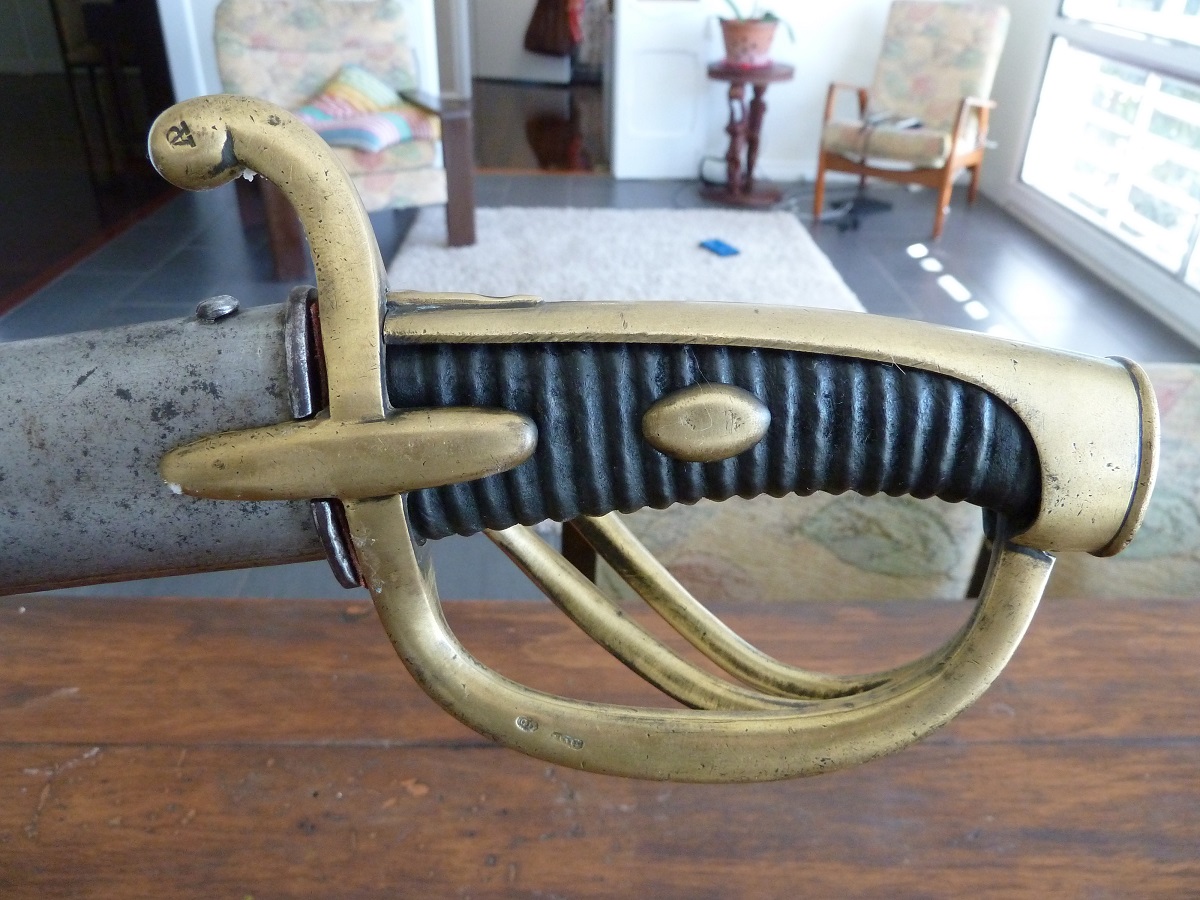

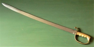

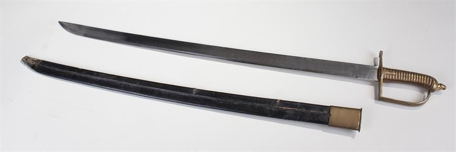

In this Robson reference, it seems these 'briquets' were in use by British artillery in the early 19th century, about the time of the presumed Storr production I have theorized, probably more at the turn of the century.
The type or character of the briquet in British use is illustrated in the painting by Denis Dighton (1813) COMPARING IT TO THE FRENCH BRIQUET OF 1801-03.
What I am wondering is if the 'Spanish pattern hanger' could be incorrectly termed as here my impression is that the briquet (of French form) is the sword described in these proceedings.
The Spanish pattern illustrated in the article linked has a hussar style cavalry hilt similar to the light dragoon sabers of 1780 (pattern) for British cavalry, noting again that the 'Spanish' association was simply for use in the Peninsula.
Or, were there two types? one of briquet form as my example, or the one in the article and multiple examples of its form suggested.

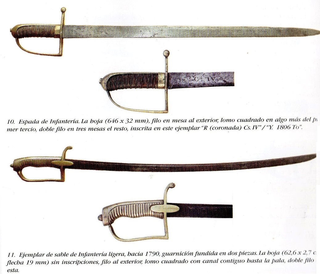

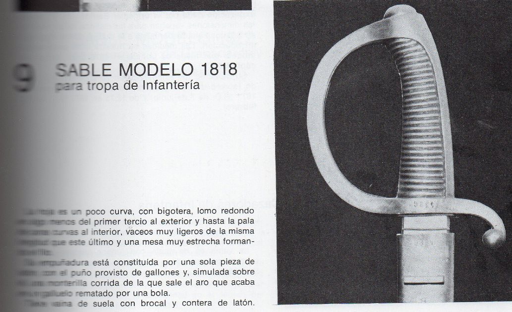

Thanks Jim,
I knew I had seen the illustrations you quoted, but I couldn't find them. Here they are and both show a straight bladed sword with a brass, straight stirrup guard and black grip, not a briquet.

Hi Bryce,
Thank you for these illustrations, which very much show the kind of 'Spanish pattern' you have described and in the article you linked.
Now my quandry is............why did Robson describe the 'briquet' as compared the the French ANIX and ANXI swords, which he was described as short and CURVED?
Further, why did highly reputable authors such as Blair and Wilkinson-Latham show illustrations (Blair's was in a panel of line illustrations); Wilkinson-Latham's was a photo...........while his caption notes there is a marking on the blade which he believes may be 'Trotter', who I think was a cutler of the late 18thc early 19th period.
While the 'Spanish pattern' evidence is profound, and there seems no doubt of course that the artillery men were using it, I am wondering if there is a case for some alternate situation in artillery ranks.

Originally Posted by Bryce
...Apart from the references you cited I haven't found any convincing evidence that these briquets were used by British royal artillery gunners. There is plenty of evidence that they were using the "Spanish" pattern sword, which has a straight blade from around 1800 - 1820...
Speaking of which, during the Peninsular War period (1808-1814) the Spaniards were around with two models resembling the one you linked to, but for infantry; one with a straight blade and the other slightly curved.
Only later they came out with 'short' sabers resembling Briquets, with slightly longer blades; the first one in 1818 and another (similar) in1822; the 1818 later in 1879 ressurected with a slighly different blade.
Despite their hilt being practically a twin of the Sabre Briquet, never a word is written about such 'inspiration'; at least in my Barceló Rubí's work copy.

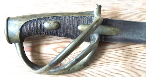

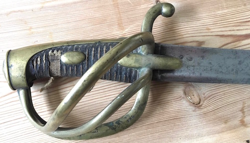

As I presented this briquet hanger in my original post, I only cited my sources, which were of course effectively my words. I have taken to get illustrations of the pages of these references to show how I formed my opinion.
While it is suggested that there is apparently an absence of awareness of this type sword in British context......these sources might at least show my reason for my hypothesis.

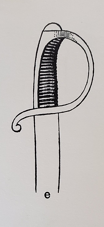

These pages, top to bottom:
1,2,3: "European & American Arms", Claude Blair. N.Y. 1962 pp.96-97
4: "Swords for Sea Service" (2 Vol.) W.E.May & P.G.W. Annis, HMSO, 1970,
p.333
5,6,7: "Swords and Sword Makers of England and Scotland" Richard Bezdek
2003
8: "British Military Swords 1800-to Present Day", 1966, #66
In the volume by Blair, example (e) is shown as a FOOT ARTILLERY GUNNER sword, in the plates of British swords.

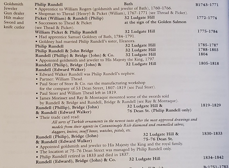

In photo 4, the page from May and Annis (p.333) describes makers of hilts, using the convention of marking their hilts with their initials (c.f. as per example FT= Francis Thurkle)....even if NOT silver.
In photos 5 and 6 are the Bezdek entries concerning Storr, and various partners including his apprenticeship in 1790s with silver workers as well as hilt makers.

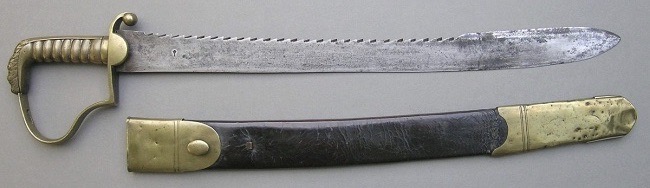

Most compelling was this photo of one of these 'foot artillery gunner' swords taken from John Wilkinson-Latham (1966, example 66) which is noted as c. 1814 (shown here as photo 8). In the text he notes a mark on the blade which he believes is TROTTER (though indecipherable).
Photo 7 shows the page from Bezdek with Thomas Trotter, sword cutler 1814-1820.
So in a reference from 1966, by John Wilkinson-Latham identifies one of these briquets as British foot artillery gunners sword c. 1814-20, and that a mark on the blade even indecipherable he considers Trotter, an established English sword cutler.
Since Blair (1962) has identified this same hilt as foot artillery gunner sword, it would seem that Wilkonson-Latham was in accord.
As Paul Storr was working as a silversmith 1790s onward and took over manufacturing factory in 1807 with Rundell, and was in that setting until 1819, is it possible he may have absorbed the convention of the two initial marking of hilt even of cast brass?
The Wilkinson-Latham example (#66) is identified c. 1814.
Thomas Trotter (if indeed this was the mark) worked 1814-20 as a sword cutler. Which means he was procuring blades in that period, the same time that Storr was running the factory for Rundell.
In these early days of establishing contracts between Board of Ordnance, the varied cutlers and blade makers as well as hilt makers, when the idea of regulation patterns was just in early stages. ...the idea that a pattern of this type does not exist in British context just does not seem likely. We know the 'Spanish' pattern was widely known and used, it is strange that the pattern or type I have known and supported by these authors is deemed non existent.

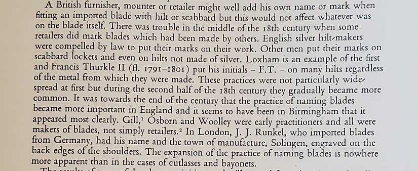

In photo 4 of my previous post I mentioned Francis Thurkle the silver hilt maker, and found an old article showing his initials in a rectangular cartouche like the one on my PS hanger. As noted, Thurkle placed his 'mark' on hilts regardless of metal used, would Storr have followed this convention?
If it was a subcontract in a partnered company?

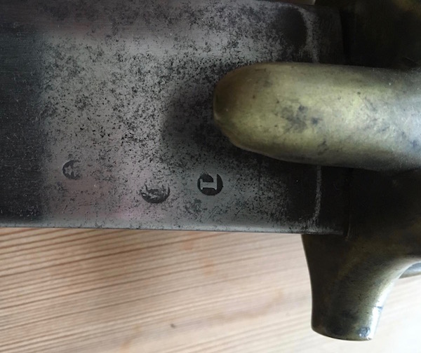

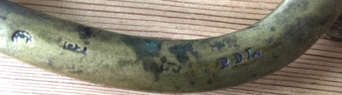

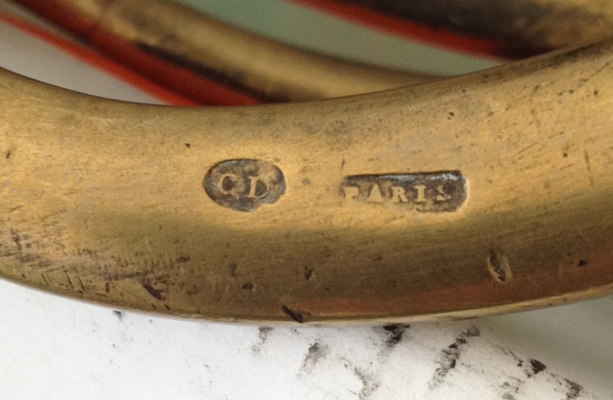

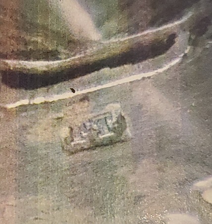

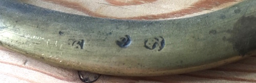

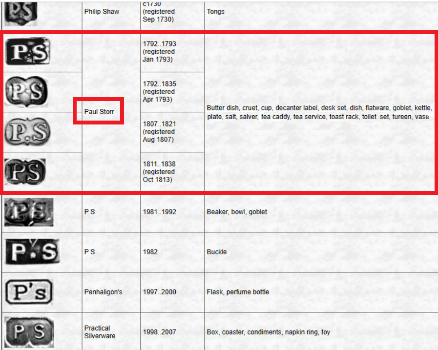

Looks like it will be hard to determine that Paul Storr, on his own senses, went on producing Briquets, unless factual evidence is found out there; not just by association of ideas.
Whether Thurkle made silver (and other metal) hilts, these seems (to me) that were 'one of a kind' examples, not a production in numbers. Then thinking of Storr, a silversmith Guru; to make a (one) sword you need an atelier (workshop); to cast a number of brass hilts for an army contract you need a factory... and a different attitude, i guess.
On the other hand, while joining two (or more) letters in a cartouche of a certain shape may give an idea of a determined silver smith mark, this is a recurrent procedure; their "trick" to distinguish one from the other, is basically the detail within the cartouche form. Even rectangles may be seen "by the dozen"; Storr himself registered a few different ones.

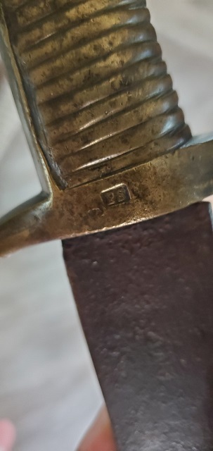

Fernando, thank you! That was exactly what I was looking for, examples of the 'touch mark' of the silversmiths. The rectangular cartouche enclosing the maker's initials just as I showed with the Thurkle example in my previous post was placed to illustrate the convention of doing this with silver smiths and in the time period late 18th into 19th and surely considerably beyond.
As you noted earlier, there is profoundly no way anyone could possibly be aware of all makers marks, touch marks, punzones etc. as there was not as much consistency as one would like to imagine. It has been said that as makers mark stamps wore out or broke, it was not necessarily the case that an exact copy would be the replacement.
In many articles on sword examples such anomalies as flaws in the punches or stamps were strong indicators of authenticity in examining individual swords, just as the case in authenticating mint marks on coins.
With the possibility of a silver smith such as Paul Storr handling a contract of brass hilts for government supply of munitions grade hangers seems heightened by the facts that he was a hilt maker, and he was indeed running a factory for his partner.
My idea has been, this is not a single sword made on a whim by a famed silver smith, but a contract of indeterminate number of munitions grade swords. The suggestions are that this type of hilt or in fact sword did not exist in British other ranks because of the confusing representation (as per Robson, 1996) of the so called Spanish pattern, the 'pioneer' pattern hangers shown in art of 1813,15 for artillery, seem to compellingly sate the case.
However, with the degree of inconsistency in government and ordnance protocol and procurement of the periods from 1780s through the Napoleonic wars, the notion of a singular contract of a number of swords such as this does not seem unreasonable.
The best evidence we have of such a possibility is the examples I have shown from highly reputable arms authors (Blair, 1962 and Wilkinson Latham 1966) which clearly show these brass (French infantry style) briquets as British.

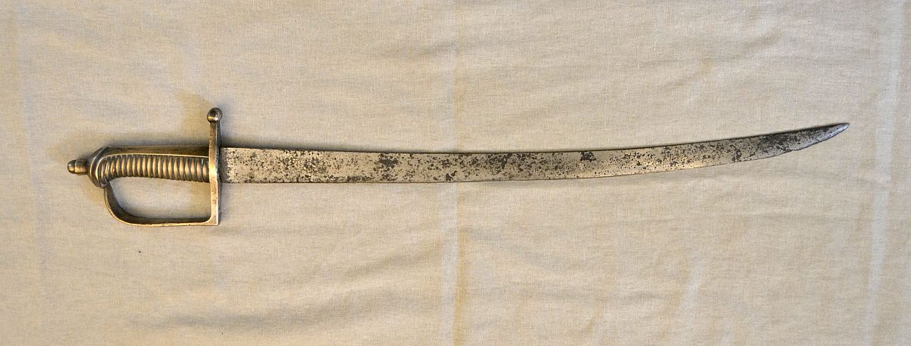

All the briquets shown so far have had D-guards.
Here's one they made earlier:
(1789)
Old 3rd October 2020, 09:32 PM   #44
Posts: 10,866
(1789)
Thanks Wayne, all of which briquets? Who they?
Is this British or French?
Interesting pommel capstan or fixture.

The Google source said French, I've read they used that style hilt up to the French Revolution. I used that photo as I couldn't find a photo of mine which apparently is a Spanish Grenadier version that looks just like it, but appears to have a slightly longer and straighter blade (and it's scabbard).

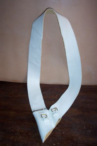

As these had to actually be carried, I also include a photo of the baldric attachment for the scabbards that have a staple rather than a mushroom post to secure them, just to round out the info of this thread.
I found the photo of mine! (below) the odd pommel bit seems to be an extension of the casting to cover an apparently longer tang without extending the grip area. half of it is a threaded cylindrical domed pommel 'keeper'with an end slotted section. It is a bit odd... I note the D-guard one in the baldric photo also has a flat white leather sword knot with a bit of red (tassle/slider?) showing. And the bayonet. Blue uniform? Is it US/UK? Looks a bit like it might be similar to the above artillery photo with the windmills. My scabbard is missing it's chape, has a brass staple on the other side of the throat piece. To complicate matters, the blade has an etched and bordered panel that says 'GRENADIER'. - the French for Grenadier is oddly, 'Grenadier'.
See also https://www.histoire-pour-tous.fr/hi...-francais.html - use google translate to read it in english.

I'm a bit stuck here, in more than 50yrs of playing with sharp and pointy's I have never seen a Continental briquet type sword with British issue marks or British regimental marks. I do not claim by any manner that such an item is not out there but if it is it must be the proverbial hen's teeth. However hen's teeth do exist, e.g. the sword in this post, http://www.vikingsword.com/vb/showth...1796+sergeants was confirmed recently by the Royal Armouries as indeed a 1796 pattern nco's sword and it seems the very few examples they have do not have the scabbard, so a scarce item but a known pattern. Privately raised regiments and militia were outfitted by the raiser/s and of course export/commerce was practiced extensively so maybe this is a possibility although I'm not hopeful. Texts and Museums do get things wrong as we all know and in fact looking into your Briquet I delved into the Royal Armouries collections and found a Briquet, museum no IX.1182, tagged as French but it is in fact Swiss as it is described as having a crowned double A which is the Bern Armoury mark so mistakes are still out there. I have attached images of the British sidearms that I know of with brass stirrup hilts.
My Regards,
Norman.

I just noticed your Briquet has had the quillion terminal removed. I have a French ANXI sabre with the same modification. Made in Klingenthal, poincons J.A. Kranz inspector 1812, F.L.Lobstein reviser 1804/21, J.G.Bick controller 1812/15. Might be something.
My Regards,
Norman.

But, my theory remains that my example which has a rectangular cartouche with the PS initials of Paul Storr (the only maker of the period whose initials correspond) is of a type well known on the Continent (as infantry briquet). The distinct anomaly of a precious metal type 'mark' to a particular maker is British (based on the individual) and only seen in similar context in a similar case (Thurkle).
In these other ranks weapons, notably cast brass examples, this type of stamp or mark in this location on the hilt, does not exist as thus far seen.

The mark in my example is the same as the PS in Paul Storr's registration of 1793. If a contract was issued (as per the protocols of the period by regimental commanders) for a select number of these cheap brass hilt sidearms, why is it not possible that these would not have virtually disappeared in the past two centuries (probably melted down for metal)?
As these were clearly disdained as weapons, not considered collectible by any means nor of stature worthy as trophies etc. what would prevent them being scrapped.
Though Paul Storr was a stellar figure in precious metal art, who would expect his mark in such a pedestrian implement?

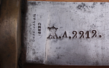

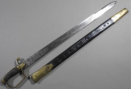

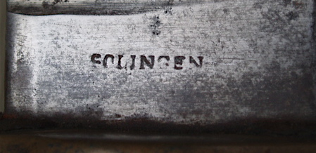

Hi Jim,
The Briquet I have which has the Berne armoury marks was manufactured in Solingen by Gebruder Weyersberg and not sourced from France. I guess they were contracted by the Swiss from Solingen manufactories. I got in touch with the Bernisches Historisches Museum. Quirinus Reichen of the Military Dept supplied me with the details. It is the sword of an infantry orderly 1843 pattern used by Berne and several other Swiss Cantons. The pattern was in use by them for approx 20 years. I erroneously gave the date in a previous post as 1830.
My Regards,
Norman.
P.S. I did have a conversation over 10 years ago with someone at the National Maritime Museum about mistaken identification of some of their items, had a good chat with a lovely lady about shooting the .303 Lee Enfield

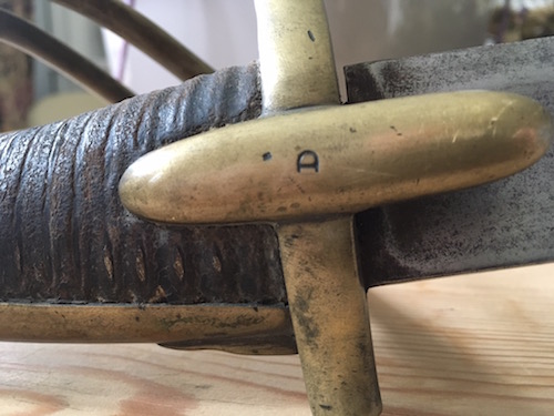

G'day Jim,
Here is another example of a set of initials in a cartouche on a brass hilt. In this case it is on a French ANXI light cavalry sabre.
If Paul Storr who was a silversmith was indeed making brass sword hilts, they would most likely be for private purchase officers' swords, rather than mass produced enlisted men's swords.
Cheers,
