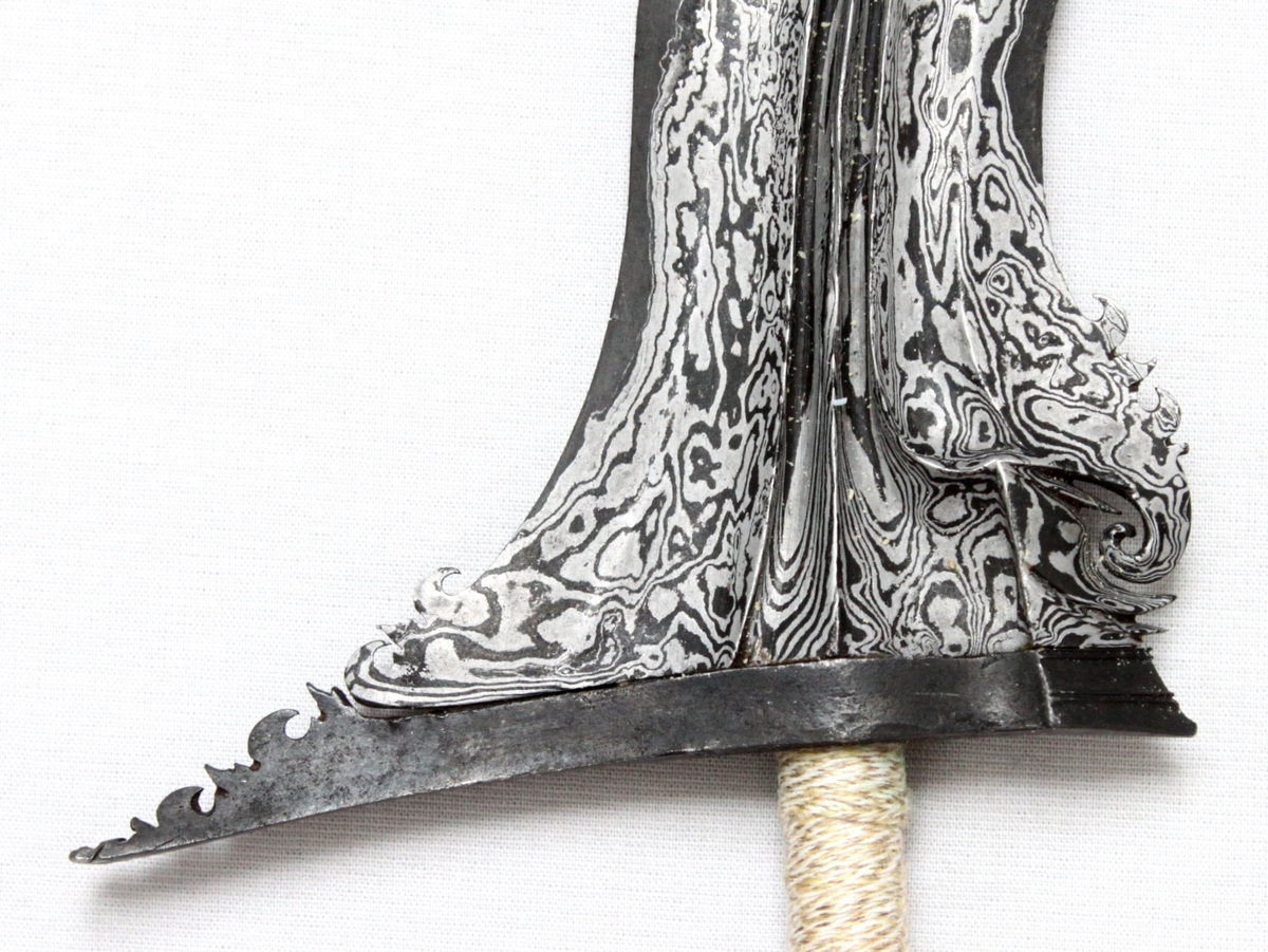

Hello all,
Apologies for not responding in a timely manner - I’ve been too busy to catch up earlier.
Looking at the pics again, it’s well possible that I was far out in the left field, especially with bringing Madura into the discussion: The overview pic seems to be taken at an angle (blade tilted to the right) which results in some distortion; wide-eye lenses (mobile phones) tend to distort images even further. When looking at pics, I try to mentally correct for such distortions - this time I got stuck though.
However, if I go from the pics (especially the close-up of the base of the blade and this photographic representation is all we can go by on this forum), this blumbangan still seems to be very close to square. Whenever I measure from the enlarged close-up, I obtain a ratio of height/width very close to 1 (i.e. square shape), about 1.02 (range 1.075-0.966). [A standing brick would be expected to have a ratio well above 1, a lying brick well below 1.]
Alan, I’m sure, when assessing a keris blade, you go by a mental image (i.e. general impression) of the proportions rather than actual measurements; however, could you narrow down which measurements may be most suited though, please? (E.g. length of the left edge of the blumbangan and possibly shortest connection between upper left corner of blumbangan to centerline of the blade? Or does this connection need to be perpendicular to the ada-ada/janur or even perpendicular to the left edge of the blumbangan?)
It’s my understanding that the proportion of the blumbangan is of quite some importance; at least it is one of the least likely features to change after manufacture.
Greneng resembling this style are seen in keris from early European Kunstkammer collections, too. These may well hark back to Majapahit styles (if not originating from this era which seems less likely for most of these blades). Thus, this ron dha style is not restricted to Surakarta either.
I have absolutely no problems to accept your line of reasoning for the small keris Palembang shown by John in the thread referenced earlier (post #7) - you already mentioned the close relationship to Surakarta style back then (post #23 in the older thread).
With the current example, there seems to be too much conflicting evidence (ron dha, blumbangan, blade shape) to reach a safe conclusion in my very humble opinion. Perhaps you can tell us more about weighting possibly incongruous features, Alan? Thanks in advance!

Yes Kai, you're right, if I look at a blade it is measured against a mental template, initial appraisal is always based on overall impression that takes into account the dominant feeling of the pawakan, and any particular characteristic that is only attributable to a particular classification.
Once you have that you then examine more closely to try to disprove the initial evaluation. If you cannot disprove that initial evaluation, it stands.
Blumbangan is of relative importance but it cannot over-rule everything else.
Blade classification in my terms is "tangguh" in the terms of just about everybody else, I use "classification" because I have yet to meet anybody from a western culture who truly understands all the things that "keris tangguh" expresses to a Javanese ahli keris. Use of the word "classification" simplifies things and brings the whole concept back to something that people who are outside Javanese culture can more or less understand.
Never forget this:- the Solonese tangguh system was initiated for very specific reasons, reasons that I will not go into here, it was not initiated so that keris collectors would have something to talk about. This tangguh system should only be applied to very high quality blades of investment quality. Yes everybody now wants to stick a tangguh onto everything, but that is not really the way things are supposed to work.
When we look very closely at a high quality blade we base our judgement on the impression , some things are measurable, I mean able to measured precisely with verniers, things like the width of a kruwingan, other things are close to impossible to measure accurately, or perhaps can be part measured and then we gauge placement and impression.
The greneng is the maker's signature. Look at the illustrations in KJ.
It is not only the signature of the maker, but also a major indicator of classification. The ron dha used in a Surakarta keris is similar to the ron dha used in a keris that is classifiable as Mojo, but it is not the same.
We need to be pay extremely close attention to detail when we look at quality keris.
Surakarta echoes Mojo, but it is very far from being the same, and within the Surakarta classification there is variation between periods and makers, and vast variation in quality.
To even begin to understand this we need a very great deal of experience. There is no easy way, there is no formula, there is nothing that can be written down as a set of rules. We need to handle one hell of a lot of keris in the presence of and under the guidance of somebody who really does understand.
The judgement of a blade classification is an opinion. Sometimes that opinion will be based on a 99% agreement with indicators, sometimes it will be based on a 51% agreement with indicators, sometimes it will be 50/50.

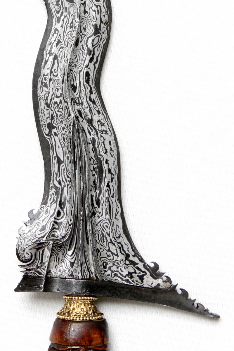

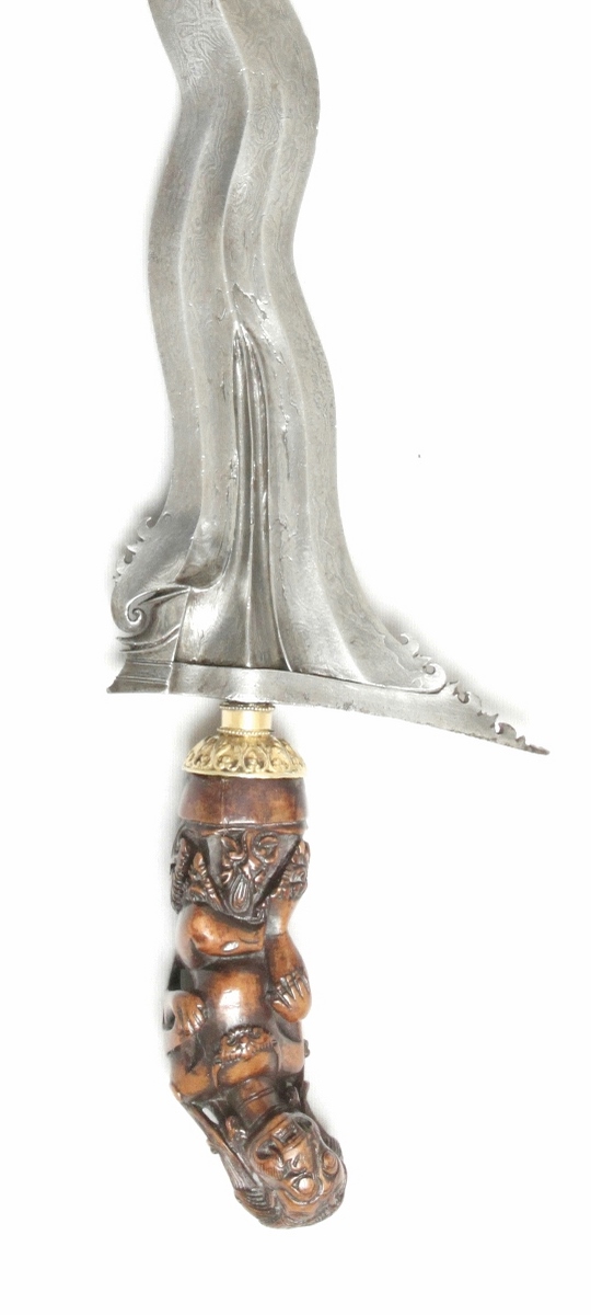

Just for reference, pics of the sorsoran of a blade possibly originating from Banten and dating from the 17th century, before and after the warangan treatment.

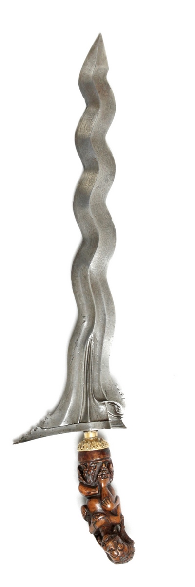

Jean, how good is the provenance on that keris?
How certain are we of the dating?
How certain are we that it is from Banten?
At this point I am not arguing against Banten, but I will say that it appears to tick all the boxes for a Surakarta keris, and it lacks characteristics that we would normally be looking for in a Banten keris.
Would it be possible to do a close-up as near to 90 degrees as possible of the wadidang side greneng, and also straight down onto the top of the gonjo?
Also a full length shot so we can see the pawakan.
Kai, I apologise if you consider that my use of words was too sparing Kai, Frankly I just don't understand what you're getting at or what your question is. But if I was sparing in my use of words, perhaps it was because I had nothing of any great importance to say, so I most gently suggest that you ignore that which you find confusing or objectionable. Just leave my terse comments to sit wherever they might be and languish in loneliness.
Hello Alan,
I said "possibly originating from Banten and dating from the 17th century" because of the large similarities between this blade and the specimens shown in the Krisdik from Jensen and in the Dresden and Copenhagen collections, especially the dapur/ ricikan and the size of the blade.
I will shot more pics but am not sure that they will give more accurate evidence.
My supporting arguments for the Banten or Blambangan origin and estimated age are as follows:
. Unfortunately the blade was shortened and only has 9 or 11 luks against probably 13 originally and measures only 31.5 cm instead of 38-40 cm estimated as the typical blades from Banten. (see pics)
. The dapur and ricikan are extremely similar to the reference blades from Banten/ Blambangan.
. The blade is significantly heavier (thicker and wider) than the standard Surakarta blades including the PB ones.
. The attached hilt is typical of the 17th century pieces from Banten or Blambangan.
. The blade was sheathless as you would expect from a very old piece from an uncommon origin (a Surakarta blade would more probably have a scabbard).

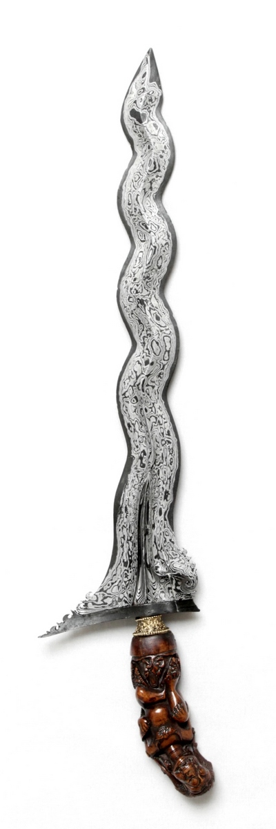

Thanks Jean, but I still need those other shots.
This looks more Banten than your first pics.

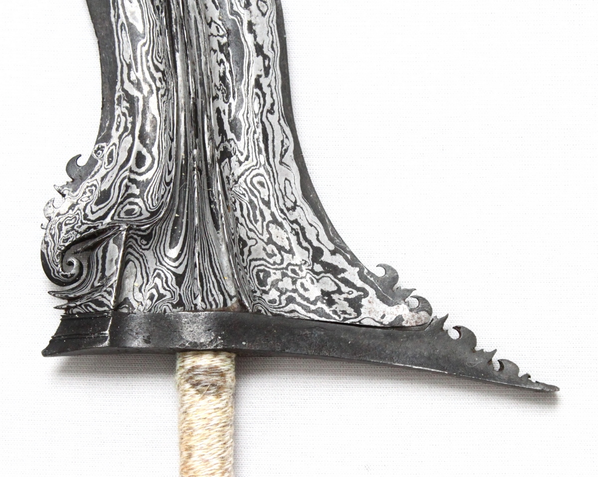

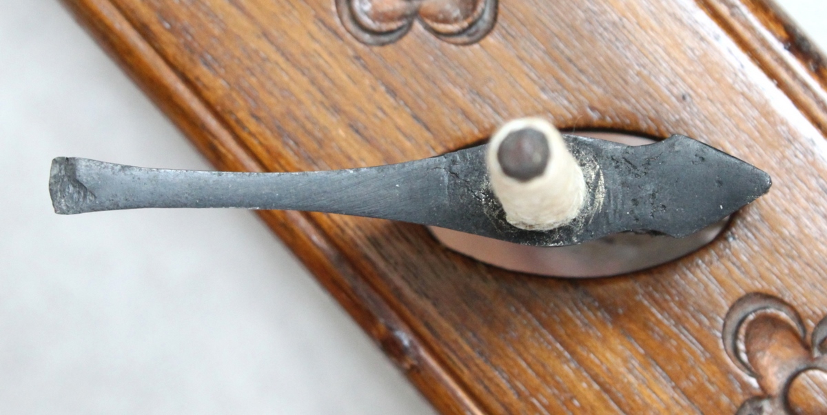

Hello Alan,
I attach the pics as requested and hope that they are adequate.
I would like to add the following indicators which point to a 17th century blade rather than a Surakarta one IMO:
. The blade remains wide to almost the point, the width is still 2.2 cm at the last luk (29 cm from the base of the blade).
. The kembang kacang is very strong.
. The short kruwingan depan & belakang (or long tikel alis & sraweyan) are very typical of these 17th century blades.
. If the blade had originally 13 luks as I would expect, there is no Surakarta dhapur matching with this one (Parungsari and Sengkelat being the closest).
. Last but not least, the thin twin lines on the sirak cecak of the ganja are very typical of these 17th century blades and not (or very rarely) seen on Surakarta blades to my best knowledge.
Old 26th August 2020, 12:04 AM   #45
Posts: 7,263
Thanks Jean, yes, I agree with you, this can be classified as Banten. I think this demonstrates just how difficult it can be to classify from photos. There is so much that cannot be adequately appraised from photos, that it is silly to even try in most cases. I'd still like this in my hand to be absolutely certain, but I can now see sufficient to be reasonably confident that we're not looking at Surakarta.
