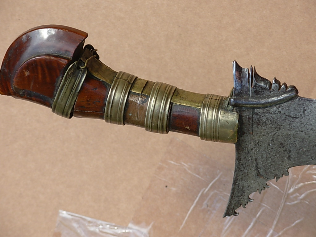

By this pictures (taken from Gustav) you can see, how a kris hilt is constructed in many cases and I think Apolakis kris hilt as well. When the brass bands get broken when you want to dismantle the hilt you need to open the binding and you have a difficult restore object. It can be done but only for experienced persons.
Old 16th February 2020, 10:15 PM   #38
Posts: 7,280
Just a side note, Gustav's Moro hilt looks like it comes from Tawi-Tawi. Their hilts are made in this fashion.
Also Sajen is right - I've done a couple of Tawi-Tawi hilts before and it is a lot of work and time consuming.

Thank you Jose. When there is no compelling reason to dismantle a good fitted kris hilt I never would do it.
The hilt I've shown again with Gustavs pictures missing it's back crest, see picture. How you would classify the complete kris?
