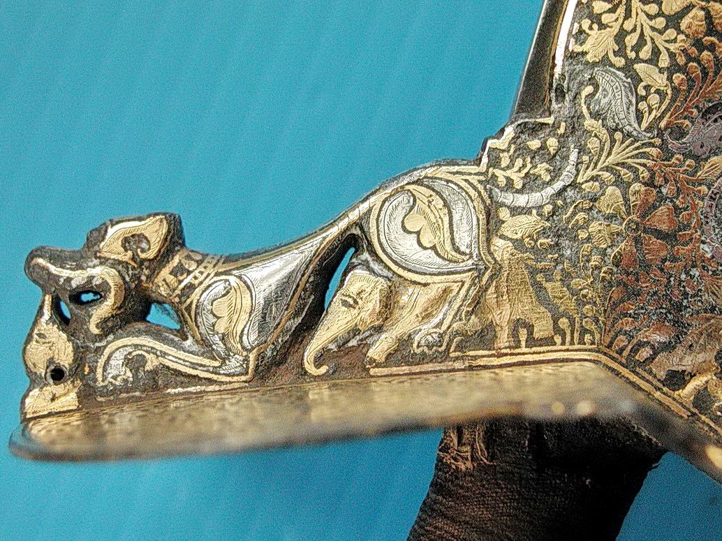

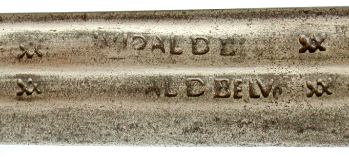

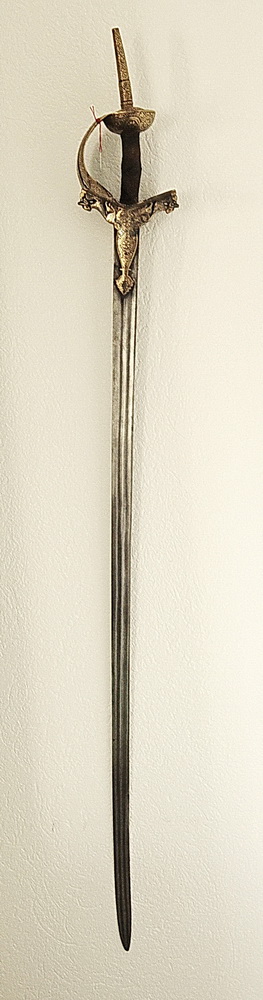

Now that the town of Belluno has been mentioned, I think it would be interesting to show a blade from this town - although the sword is from Deccan 17th century..
The sword is a firangi, meaning wit a foreign blade, and the inscription says XX CIVIDAL D BELUN XX - which means 'The City of Belluno'.

Jens, thank you so much for this entry!!!
This is a magnificent example, and I forgot our discussions on this some years back. This example inscription was the first I had learned of Italian blades being inscribed with specific city, indicating this may have belonged to perhaps a city guard or militia unit, in this case Belluno.
Naturally our reaction is to recall the famed Andrea Ferara, who has been steeped in mystery for literally centuries, is now known to have actually been a working swordsmith in the last quarter of the 16th c.
Belluno was one of the number of well known blade making cities in the Veneto sphere, which seems to extended as far as Milan, Brescia and Ferara (interestingly not the city where either Andrea or his brother Donato worked).
Of note are the 'X's enclosing the wording, an affectation often seen on Solingen blades, and often with the ANDREA FERARA name, known to have been spuriously applied there for blades destined for Scotland.
It is fascinating learning more on these Italian blades, and most interesting to try to determine the aspects of their notable presence as 'firangi' in the swords of India. While we know there was a considerable conduit of German blades into India, less is known on the blades from Italy, which I don't think had as much direct trade with India...….or did they?

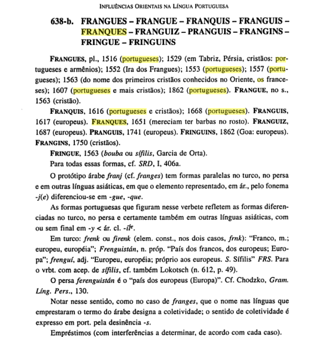

I’m pretty sure “firangi” means Frank or Frankish, Jim. This term is used for Western Europeans since crusader days when muslims did not distinguish much between European nationalities. When I went to a gold shop in an Arabian Gulf soukh 10 years ago to repair a contemporary gold chain, the proprietor gave me a beady eyed look and inquired whether it was “franji” (i.e. Western European, or Swedish in my particular case) gold. In contrast Orthodox or Byzance is called Rûm (as in East Rome or Constantinople) by muslims. So the local Orthodox hospital in Beirut is called Al Roum Hospital. They have used these terms for 1,000 years as far as I know as nations came and went.

Old 24th September 2019, 11:09 PM   #47
Originally Posted by Victrix
... I’m pretty sure “firangi” means Frank or Frankish, Jim. This term is used for Western Europeans since crusader days when muslims did not distinguish much between European nationalities...
So ... in due context, Portuguese were (also ) Firangi.

Thanks very much Victrix, and much agreed, the term had far more relation to the Franks or Frankish, and likely had origins in medieval times when the Franks were producing high quality blades such as the Ulfberth and Ingelrii. These were widely exported, though that was tried to be curbed, and it seems the term entered a good number of languages becoming indirectly a term for 'European' I believe. As always a matter of semantics.
Some years ago I had seen references which thought the term meant 'Portuguese' probably for the predominance of Portuguese colonies and trade in subcontinent and I believe in Sri Lanka.

Default For those fans of ethimology ... and semanthics ?
Portuguese served as the lingua franca in 15th and 16th century Africa and Asia. When the Portuguese began exploring the seas of Africa, the Americas, Asia and Oceania, they tried to communicate with the natives by mixing a version of the lingua franca (influenced by Portuguese) with the local languages. When English and French ships arrived to compete with the Portuguese, the crews sought to learn this truncated Portuguese. Through successive changes over time, the lingua franca, along with the Portuguese vocabulary, has been replaced by the language of the peoples concerned.

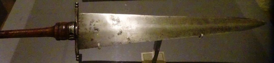

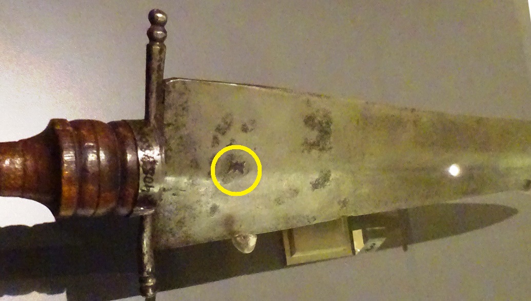

Have i just seen the famous mark in a sturdy XVIII century Spanish plug bayonet ?
Were the Spaniards also fond of replicating the 'ferri di molino' brand ... or has this blade made its way from Veneto to Spain; unlikely, i guess.
(Toledo Army Museum)
