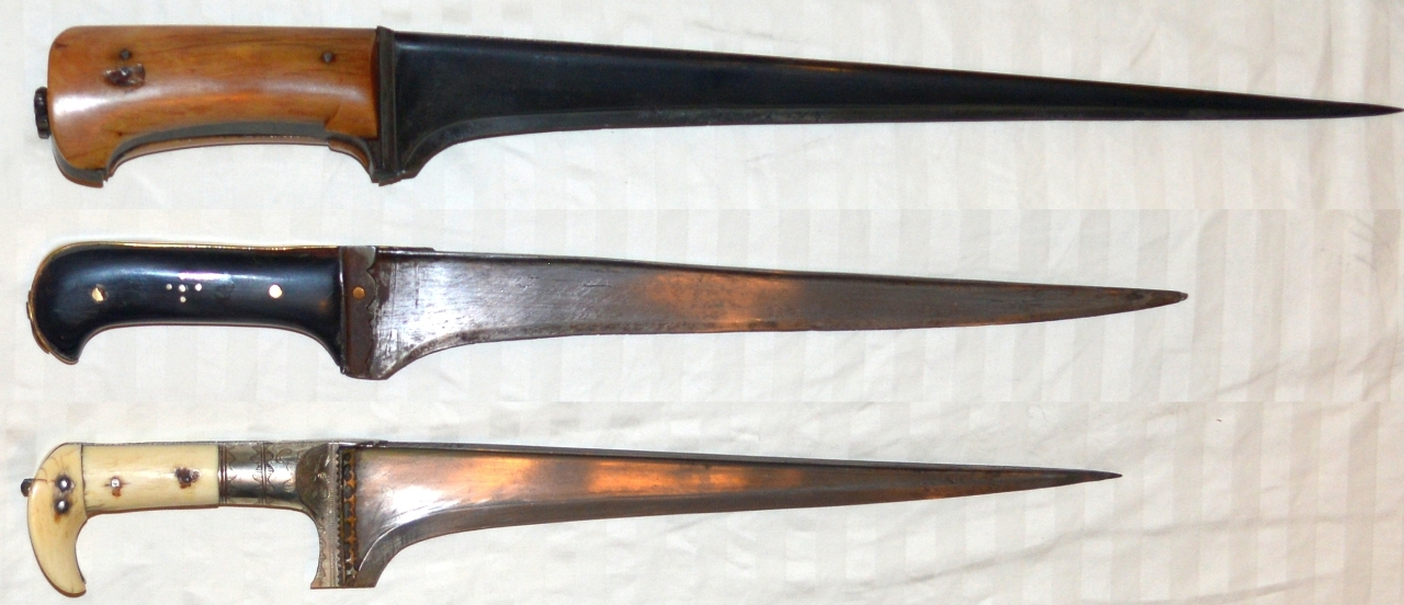

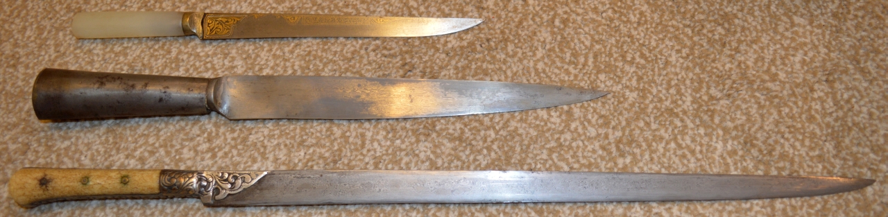

But they are not pesh-kabz, why didnt the makers of these daggers just create more pesh-kabz if they were making peshkabz???? Just because they are similar in some aspects does not make then the same and just because SOME authors made the mistake of thinking that the karud and pesh-kabz are the same why should we?
Why stop here, lets not call a "choora" a choora, or a "kyber knife" a kyber knife...the original makers of these weapons did not call them by these names.
Take the Indian tegha sword, similar to a tulwar but different enough to have its own name, the list goes on, I could show many such examples.
And while we are at it, since you brought up the "kard" dagger many times, just because the karud and the dagger we now call a "kard" both have only one cutting edge does not make them the same either, examples below.
I trust what my eyes see, not what some authors decides is right, they have been wrong before, on many occasions, same with museums, and auction houses etc. We now have online an abundance of images and can see for ourselves which weapons are basically the same and which are different enough to have a separate name.
Look at the examples of karud and kard daggers below...would anyone mistake them for being the same?

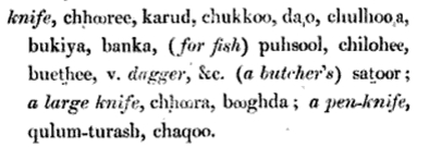

Here is a mention of a "karud" knife, 1825.
Hindoostanee Philology: Comprising a Dictionary, English and Hindoostanee; with a Grammatical Introduction, Volume 1, John Borthwick Gilchrist, Kingsbury, Parbury, and Allen, 1825.

I have already SHOWN why, the images I posted show a straight bladed karud dagger, a pesh-kabz is curved bladed, unless you really believe there is absolutely no difference and they are exactly the same dagger and that the makers of these daggers believed that they were making the same dagger, but then if that were true why bother to make a straight bladed dagger and a curved bladed dagger?
Not to long ago you were the one arguing that certain swords that appeared to be shashka were in fact not actually shashka but just happened to look like shashka.
Now you are arguing that two daggers that look completely different are actually the same...humm....

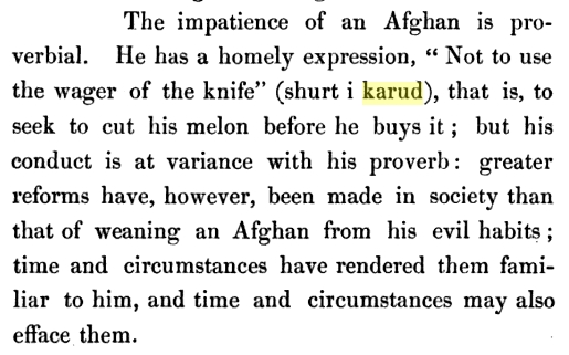

Here is a reference to "karud", 1843
Cabool: A Personal Narrative of a Journey To, and Residence in that City, in the Years 1836, 7, and 8, Sir Alexander Burnes J. Murray, 1843

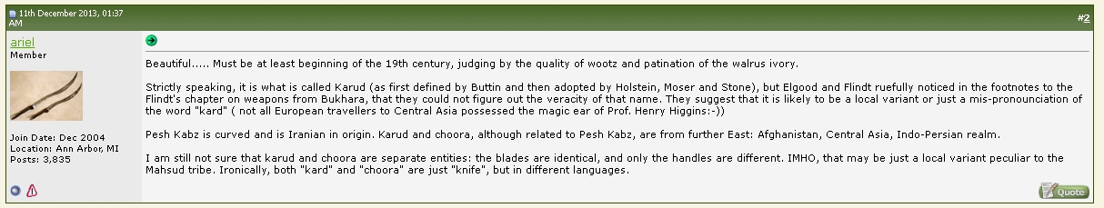

Here is what Ariel had to say on the subject of karud, 2013
