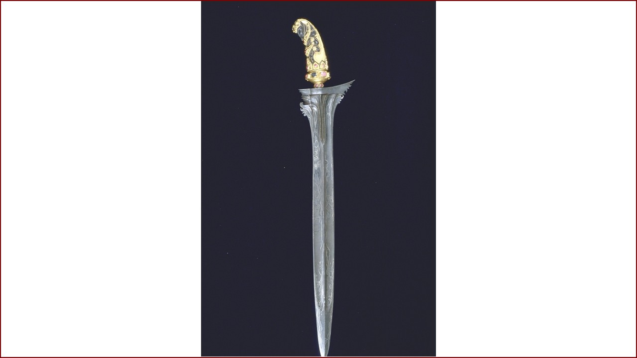

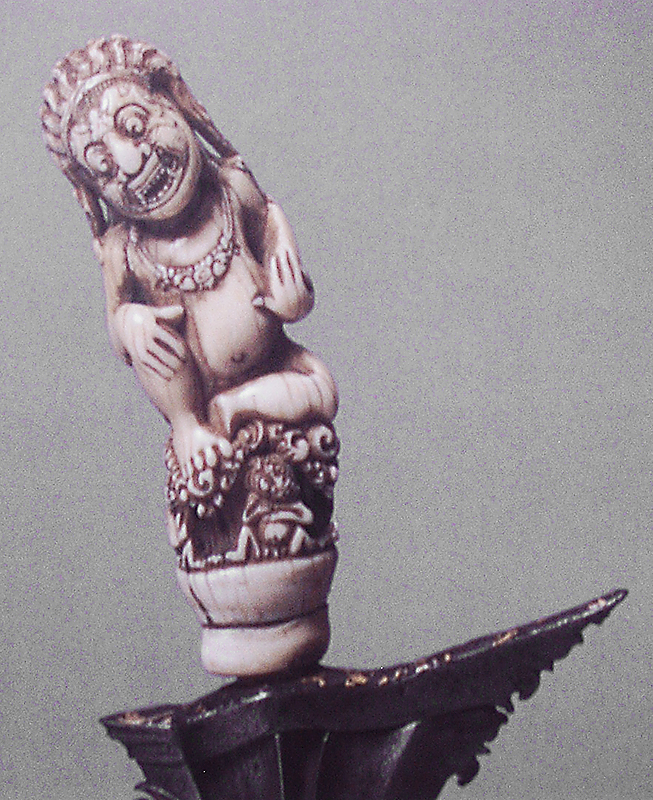

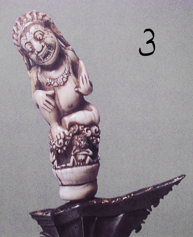

Alan, the ivory hilt I introduced in my last post is quite remote from North Coast Jawa hilts.
It seems to me a little bit reckless to classify every old Keris in European collections with upright Blumbangan as Banten and every old hilt with a demonic figure as North Coast Jawa. It reminds me of Keris experts in Javanese tradition from not so remote past, who classified the same blades from old European collections invariably as Bali - because they didn't fit in their belief system.
Now these Keris, this variation of Greneng, and obviously also the hilt don't fit in your system.
You name this rare form of Greneng "aberrant features found upon keris that were made under Islamic influence" and in #28 you write "These corruptions of form are most definitely not younger forms of keris enhancement. They are clearly, obviously and logically demonstrable corruptions. They do not appear in the Bali keris, and that tells us exactly what they are."
There actually is a quite well published state Keris from South-Bali in Tropenmuseum Amsterdam, Col. Nr. 809-99, which has a Greneng, closely related to the variation I presented in my last posts - "It consists of two identical elements with a Ron Dha in the middle. That element is repeated on Jenggot."
Apart from this I have nothing new to add to #29.

Again, I have no argument with the idea that figural hilts are not limited to North Coast Jawa. I prefer the term "figural" rather than "demonic", or "raksasa" because it sometimes is not possible to determine exactly what the figural representation was intended to represent.
In respect of a particular hilt (sorry, I'm not yet certain which hilt you mean), you tell me that:-

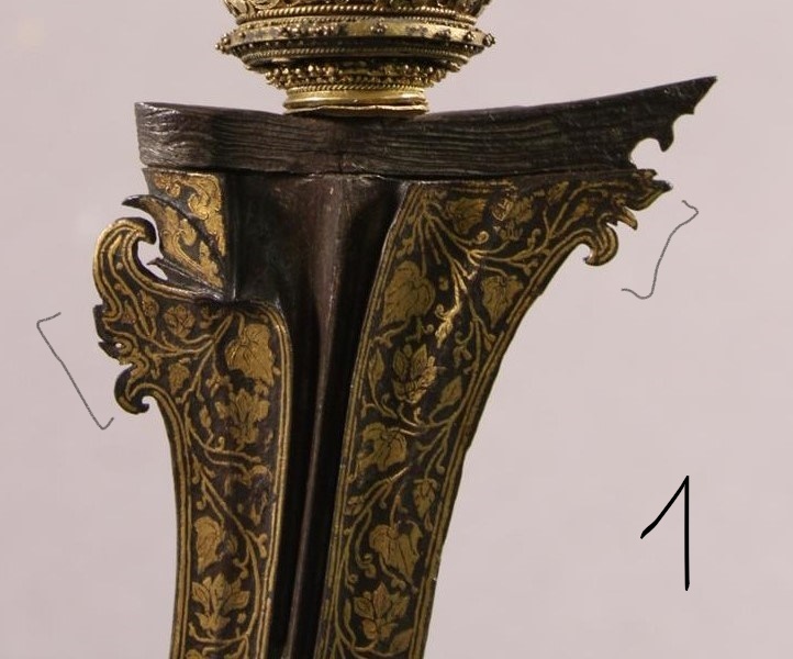

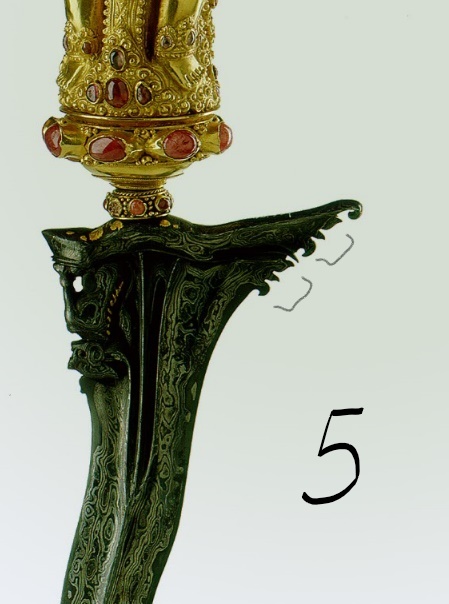

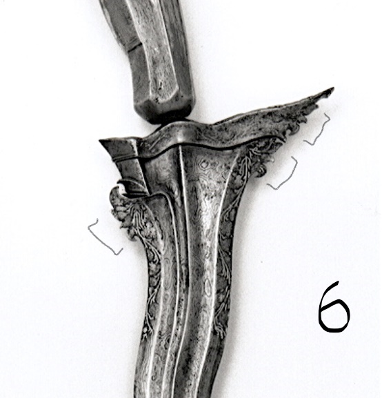

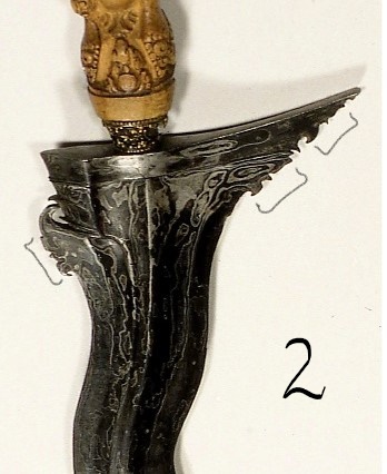

Alan, I feel there is a serious need to recapitulate the development of our discussion (which I value very much). At first - the part concerning Greneng.
In #26 I posted an picture of a pre-17th cent. Keris (1) with replaced Gonjo, with an uncommon variation of Greneng. In #29 I described that Greneng form as "consisting of two identical elements with a Ron Dha in the middle. That element is repeated on Jenggot". I would like to add "identical TRIPARTITE elements".
Your comments on it in #28 regarding it's Greneng in #28 were:
"here we have a very good example of what happened when the keris became profane under Islam."
"The enhancements that occupy the place of the ron dha nunut and jenggot on this blade are very clearly not related in any way to the ron dha of the early Modern Keris within Hindu-Buddhist society."
"I agree that this keris you have shown us is probably older than the first half of the 17th century. This is a North Coast blade, very possibly classifiable as Banten, and it demonstrates very nicely the point that I made in respect characteristics associated with the Hindu-Buddhist belief system, however, those features in this keris have been distorted."
In the same post I mentioned the Keris Dresden Inv. Nr. 2895 (2), with the same variation of Greneng.
Your comments on it and obviously on that Greneng variation are:
"Dresden 2895 can be seen in Jensen's Kris Disk, chapter 3, page 22. This kris has its original gonjo and is an excellent example of the early Modern Keris under Islam. Jensen measured it as 41.8cm, I measured it at 42.4cm. It has a single front sogokan and in respect of the greneng and ron dha, I noted that they were "very confused". In any case Dresden 2895 is a big keris, in the hand it is very similar to a Bali keris.
This confusion in the formation of the ron dha and greneng is not uncommon in keris from this period. We can only guess why this happened, it could have been intention on the part of either the person who ordered the keris, or of the maker, as a movement away from Hindu-Buddhist symbolism, or it could have simply been a lack of knowledge of the true form required. In any case this distortion of the ron dha is not uncommon and Gustav has given us a very good example of it.
These corruptions of form are most definitely not (sic?) younger forms of keris enhancement. They are clearly, obviously and logically demonstrable corruptions. They do not appear in the Bali keris, and that tells us exactly what they are."
In #29 I posted a picture of a part with Greneng visible of Keris from Munich Inv. Nr. Gr. 598 (3)
Your comments in #30 on it and obviously also the previous Keris are:
"However, I do feel that by introducing aberrant features found upon keris that were made under Islamic influence we are wandering away from the barrier that I set myself at the beginning of this discussion. Quite simply I do not want to extend any of my comments into the era of Islamic influence.
The keris that you have introduced to discussion are keris that were made under Islamic influence. They are North Coast Jawa keris, probably classifiable as Banten, and that removes them from any discussion of the keris as a Javanese Hindu-Buddhist artefact. These keris that you have presented and that you wish to discuss have no place in a discussion of the keris within the Javanese Hindu-Buddhist era.
You tell me that these aberrant keris do not fit my hypothesis, but I have not yet published any hypothesis that deals with keris of this type and era. In fact, this perverted corruption of a religious icon does ideally fit into my unpublished work, but I am not at the present time willing or able to take discussion into this era."
In #29 I explained, why I am reluctant to see that variation of Greneng as an "confusion in the formation of the ron dha and greneng":
"regarding the Greneng variation I presented, I don't think it is as simple as "They are clearly, obviously and logically demonstrable corruptions. They do not appear in the Bali keris, and that tells us exactly what they are". This Greneng appears on a very small number of Keris, and they all are older then first half of 17th cent. After that this variation disappears. Speaking of myself, I haven't seen many Keris from Bali, which could be somewhat supportably datable as older then perhaps 18th cent. We have much less reasoned to say on subject older Keris in Bali then we have regarding older Keris in Java - and that isn't much.
This variation of Greneng clearly don't fit in your hypothesis, but I am not sure, if it is a reason enough to deem it as a corruption from Islamic period.
It consists of two identical elements with a Ron Dha in the middle. That element is repeated on Jenggot. Stylistically I don't see any confusion there."
Finally, in #31 I posted a picture of a state Keris from South-Bali, Tropenmuseum Amsterdam, Col. Nr. 809-99 (4), which displays the variation of Greneng which is the subject of our discussion.

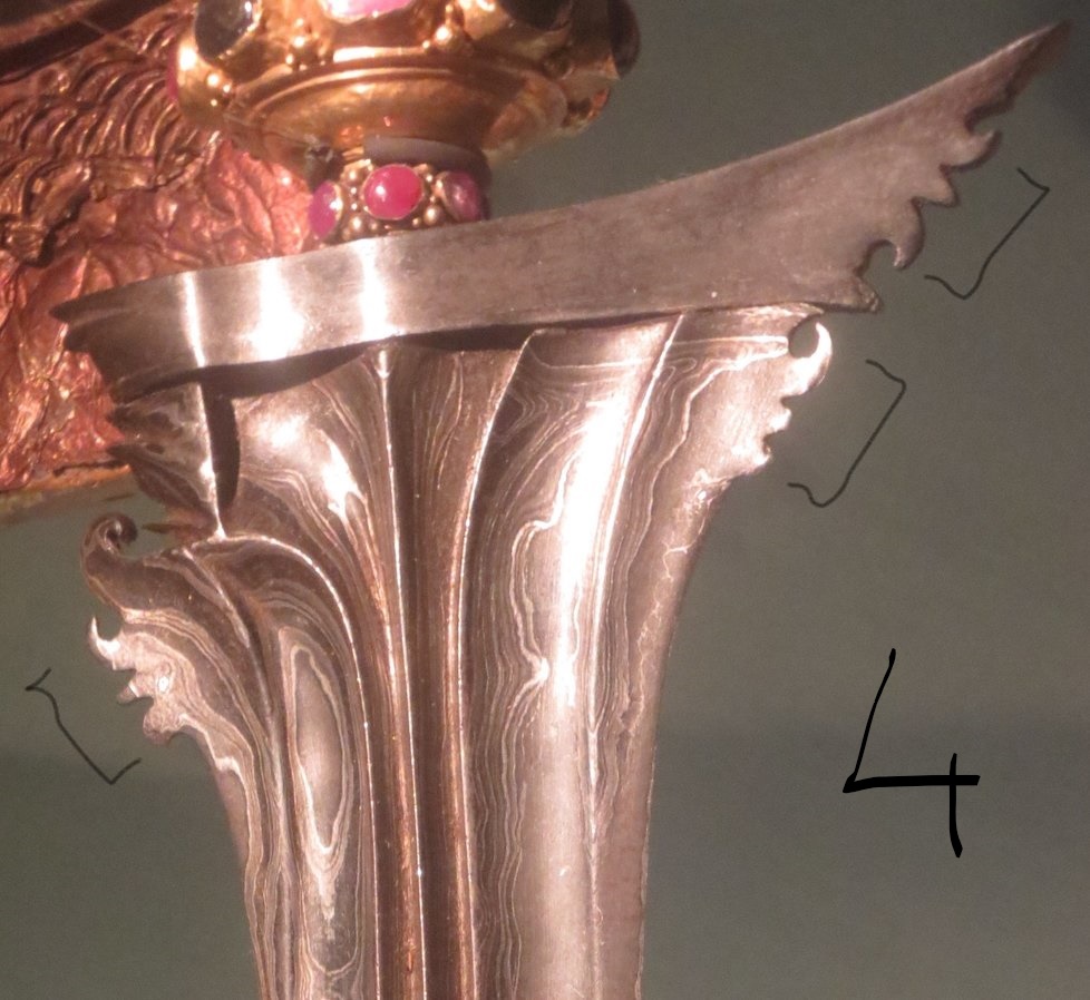

Here below are some questions that you may or may not choose to answer. If you do choose to answer, please provide an answer that is to the point, not an extended quote, and make it a straight answer, not a sliding sideways answer that avoids the thrust of the question. If you cannot answer, or choose not to answer, I'm quite OK with that too, but please advise that you have chosen not to respond.
It would be really nice if you could make your answers concise and pointed. Where possible 'yes', 'no', 'no response', 'don't know' would all be very much appreciated.
My "system" : what is my "system"?
My "hypothesis" : what is my "hypothesis"?
Is the hilt shown as image #3 in your post #33 stylistically North Coast Javanese or not? If it is not stylistically North Coast Javanese, then what area would you associate this style with?
Have I stated that I have never published any hypothesis that relates to the greneng? Yes, I have used the word "greneng", yes, I have discussed the greneng, but have I published any hypothesis that addresses the form of the greneng?
Have I made it clear that the ron dha is to be regarded as only one element of the greneng?
Have I made it clear that the elements of which the greneng is composed do vary?
Are the tri-partite elements that you identify in the greneng, elements of greneng composition that vary from greneng composition which is regarded as the normative model?
Have I limited my hypothesis in respect of elements of the greneng to only the ron dha?
In your opinion, are the 6 keris that you have shown as examples in post #33 all from the period after 1500?
Do you consider the greneng elements indicated in image #4, post #33 to be the same as the greneng elements indicated in the other 5 images included in post #33?

At that point I posted (besides a Greneng on Megantoro) a variation of Greneng on early Keris 1,2 and 3, which consists of two tripartite elements, separated by a Ron Dha, the same element repeated on Jenggot. So a quite extended form compared to your "pure" Greneng.
Your reaction on Keris 1 (with replaced Gonjo) was:
In this keris that you have posted a photo of, we cannot comment on the greneng, because of the replaced gonjo, we can only comment on the ron dha nunut.
Regarding Greneng on Keris 2 your remarks were:
On both Keris:

Because after that I presented pictures of two Keris from Bali, 4 and 5, with that variation of Greneng. Keris 4 is, as you noticed, a younger one, probably at least 200 years younger then other Keris I presented.
Yes, I think Keris 4 has the same variation of Greneng as other five (that's why I posted it), it is the only younger one, it's Greneng is stylistically different.
The Greneng on Keris 5, which is an early one, is almost identical to Greneng on Keris 1 and Keris 6, and clearly the same type as on Keris 2 and 3.
With that I hoped to have proved, that this variation of Greneng, which quite extends beyound the "pure" Greneng you presented beginning with #18, aren't

Gustav has been kindly trying to present an assortment of early examples from European collections, let's say pre-17th century. While some of these blades will have been newly crafted to function as a gift, there also seem to be hints that others had already been in use for some period. For how long will be more than tough to tell much less to verify in most cases...
Most blades may be post-1525 (to follow Alan's suggestion). A few might even be older; I doubt we can expect any surviving in good condition to originate from Gajahmada's time though. Since we know that Mojopahit had been declining for a long time already and Islamic ideas/influences being known/present earlier, too, I don't see any reason to focus on any cut-off date (1525 or whatever): A blade may be older and already exhibit Islamic (or other) non-traditional ideas; another blade may be younger and still true to old traditions [possibly not so different to what we experience in the keris culture since Indonesian independence].
I guess I'm with Gustav in assuming that the oldest surviving figural hilts (i. e. those with intact linggam/yoni symbolism, etc.) are stylistically in line with what we can expect to have adorned keris Mojopahit, too. That these are mainly/always? found on keris from early European collections that might had originated (or been imported) from/via (western/)northern(/easternmost) Java is not a contradiction IMHO (considering that we also see antique hilts with stylistic similarities that are probably later and from Bali.
Regarding the special style of greneng shown by Gustav, I find it very interesting that it consistently occupies the position where one would expect ron dha and ron dha nunut (as well as ron dha at the jenggot); it's also interesting that this feature at the jenggot seems closer to the ron dha nunut than the ron dha. Moreover, this greneng configuration doesn't appear to be a mere corruption since several of the examples do exhibit a clear ron dha on the gonjo (i. e. between the 2 [almost] symmetric tripartite greneng features) - with the possible exception of #3 where this element seems to be rather too short/roundish for a decent ron dha (not positive though since the pic does not show the details clear enough). Since this variant is also found on later keris Bali (with 809-99 from the Tropenmuseum being old enough to exclude any contemporary influence of the pieces from European collections on Balinese pande), one would be inclined to believe that this variant predates 1525. At least that's the usual line of reasoning...
Considering the long period of Mojo decline, it could still be an early corruption, indeed. However, this hypothesis would necessitate additional assumptions to explain its survival on Bali (and apparent absence on late keris Jawa). Thus, it would be great to hear why you are so certain that this feature can't be based on any legit Mojo variant, Alan! Am I missing any stylistic details that militate against this notion? Mind you, I'm not insisting that this is a genuine Mojo variant (nor based on any) - just trying to explore all alternatives that can be supported by extant examples!
