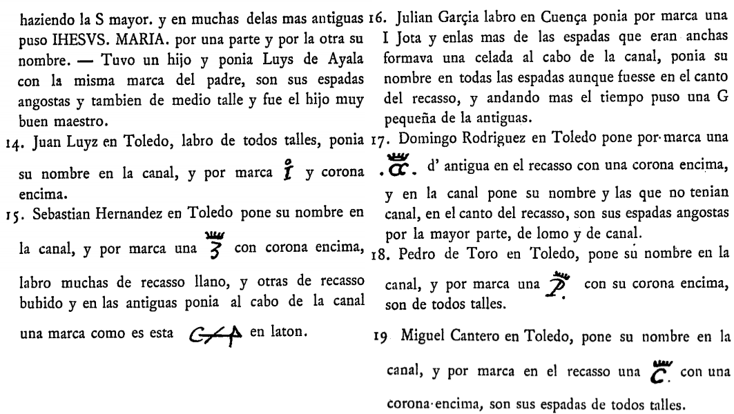

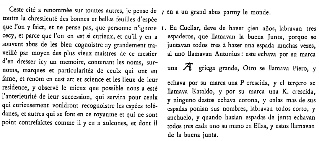

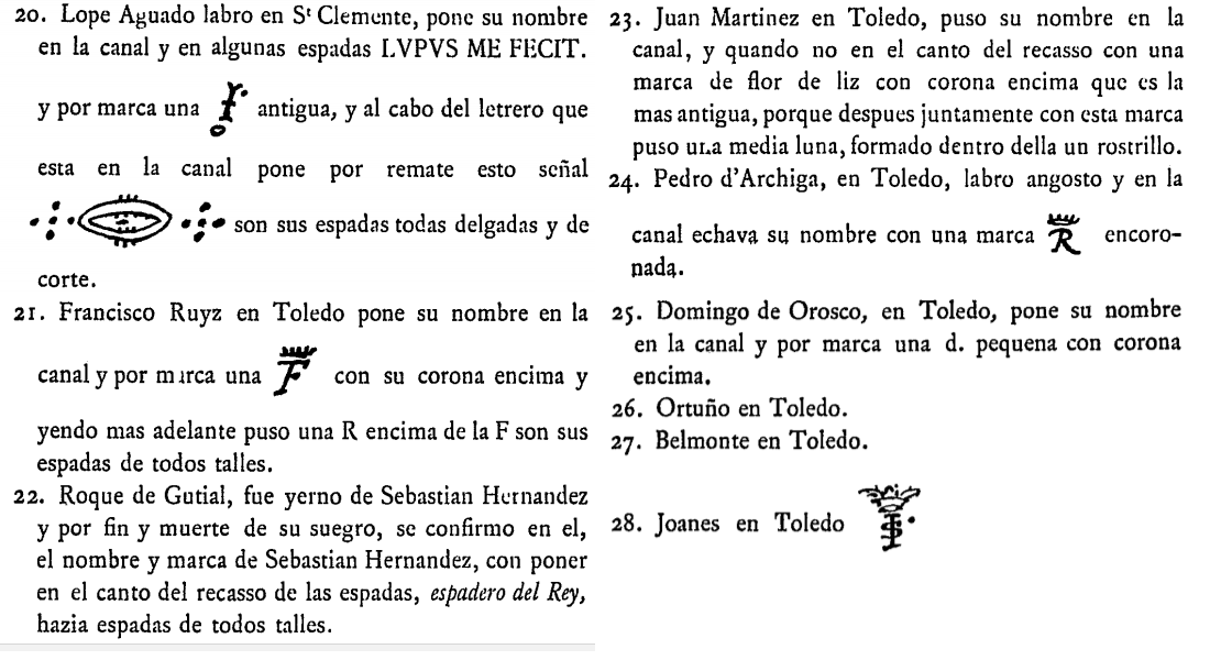

Well Jim, considering this wasn't yet the chekmate on this issue, and asking Jean-Luc for tolerance over hijacking his thread, i would like to introduce the earliest author known to have registered Spanish silver smiths, mostly those working in Toledo, with the great difference that this one was contemporary to the old Masters, as he resourced around the 1600's. Jehan Lhermite was a Flemish Gentilhomme who served Spanish Kings Filipe II and III, having been assigned to their chambers. In his written work called "Le Passetemps", he gives account of places and events he has been through when traveling with the Royalty, and includes a report on sword smiths registered in Toledo (and not only) with a comprehensive description on how they used to shape their blades, like ricasso profile and their average length, something Palomares didn't cover, as well as the marks they used, these maybe not exempted from one or two eventual flaws, even considering he registered them in the period. Interesting to check that he registered (only) one Master who used the Espadero del Rey signature (Sebastian Hernandez), and makes only one mention to the half moon symbol, "forming a rostrillo inside it", as once adopted by (guess who) Juan Martinez.
It took me a couple hours to format this chart in order to make it "uploadable". I hope it is worth ... and not boring.

I would very much like to thank Jean Luc for his forbearance in this continued digression in his thread, as well Fernando for his patience in responding to my inquisitiveness concerning the 'Espadero del Rey' dilemma. While it indeed is a digression topically, this matter on these swordsmiths is indirectly pertinent as related to my suggestion that the nearly indistinguishable mark at the forte on his example might be a degraded 'half moon' which may have been placed along with the rather rugged inscription in the blade.
Fernando, the entry you have placed here is exactly the kind of material I as hoping for, especially as this account was contemporary to the working times of the old swordsmiths. As noted, the problems with Palomares accounts are inherently a result of his having documented most of his material during a time (1772) when nearly all of these makers had long been gone and Toledo's sword making industry had long been in ruin.
This resource is most valuable, and I very much appreciate the time and effort you spent in providing it here, so I thank you sincerely. Even in Spanish, the clearly illustrated marks and accompanying text should be manageable in examining this very important data, which, like all of your entries, are never, ever boring!
