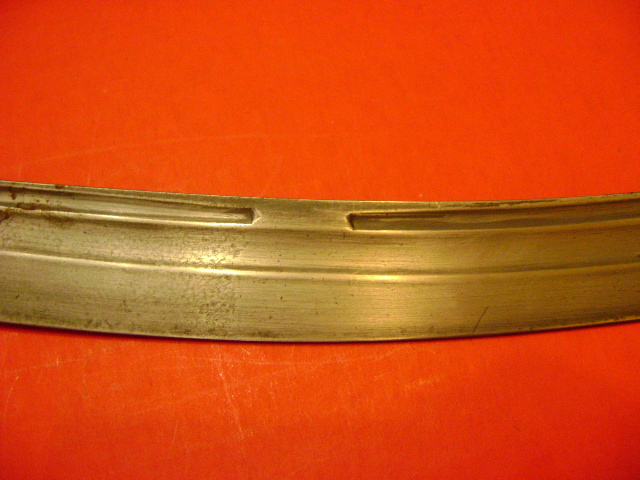

In this case I suppose the only possible explanation for the presence of the "tears" is the sound they make when the dagger is moved.
And that's, in my oppinion, the main reason they are present in some blades as well.

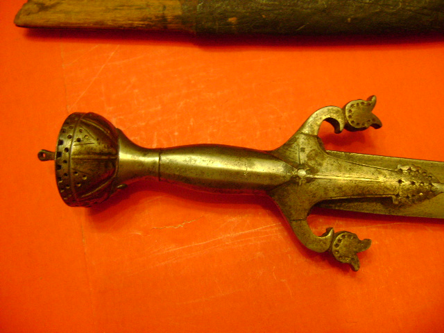

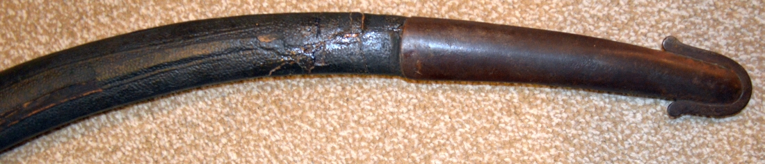

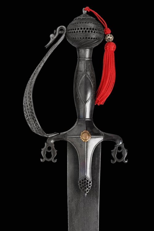

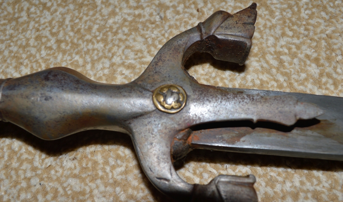

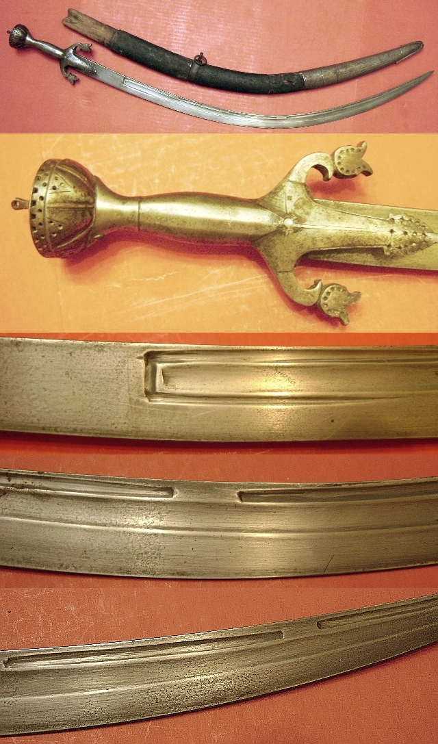

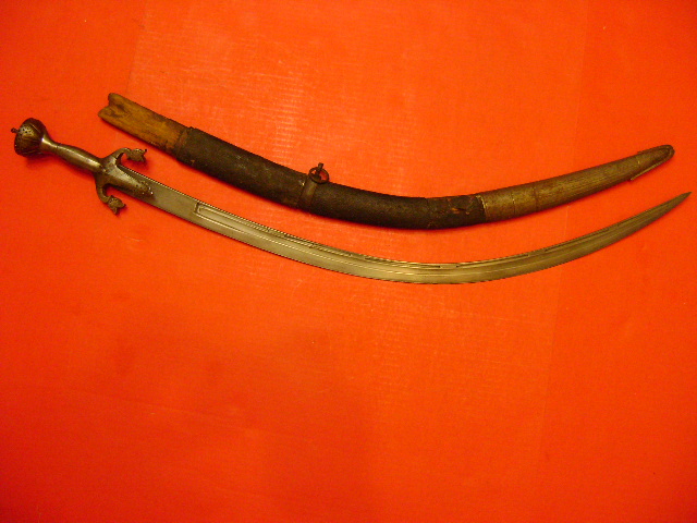

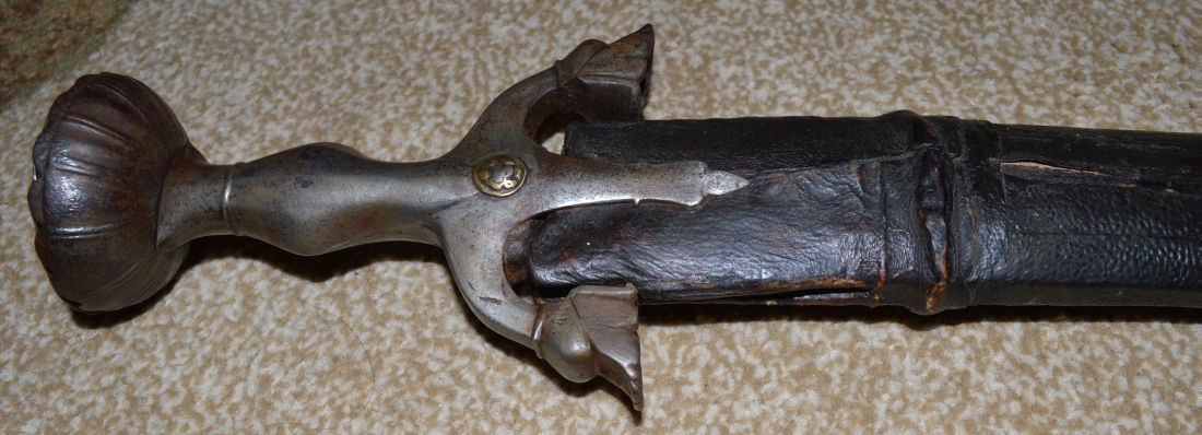

What makes you think the scabbard is "old" as there are no detailed photos of it?!
And where did you see the "old resin?"
I cannot find a single photo showing the joint between the blade and the hilt.
The only photos that show some resin are those of my sword.
See anything that looks remotely new here?

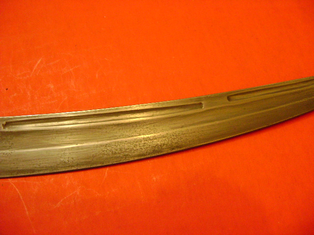

I guess you are right. The scabbard looks old, but I assume leather can be easily aged. Just bake it a little.

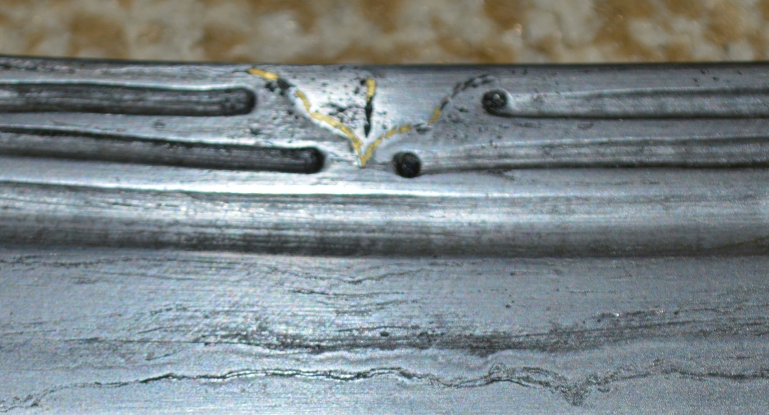

The steel of the hilt also appears to be artificially aged with spots of very recent and active red rust.
I also stand by my conclusion that the blade is a dud. And I explained why.
Try chiseling a straight groove and a curved one and will see what I mean. You basically have to struggle a lot with the chisel if you purportedly want curved grooves like those on the blade. Straight grooves come out naturally.
Moreover, in order to mill the grooves the way they are, the steel of the blade has to be very soft to the point of being iron and that's why I think this blade couldn't stand a single blow without bending.
I would like to hear the opinion of a skilled bladesmith in this matter.

Originally Posted by ariel
It IS old :-)))))))
How old? 20... maybe 40 years old yes, but not more!
It IS old :-)))))))
Yes, old, nothing new about it at all.
Much older, your letting your original suspicion (not a bad thing) keep you from seeing that there is no aspect of this sword and scabbard which shows anything other than extreme age, 19th century at least...in my opinion. The rust is localised to specific areas, not unusual at all. The rivets are worn, no sign of being removed, the resin is obviously old, the brass / gold inserts all along the spine are worn, not intact and new.

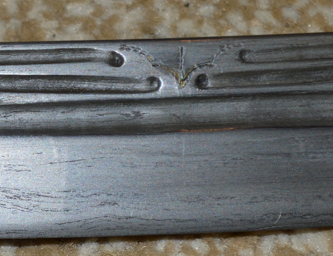

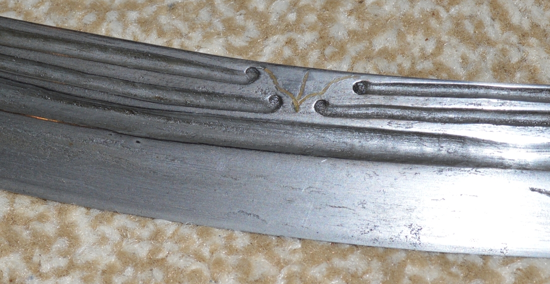

Thank you for the photos!

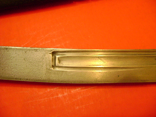

Certainly milled with a ball-tipped end-mill! And this type of tool didn't exist in 19th century for sure! 20 century again for sure!
Those grooves couldn't have been made with a chisel. They start with an ample curvature an with a lesser depth because that's when the linear movement of the mill starts and there is most resistance after the initial starting hole, so there is less control over the tool.
Do yo have this blade? Is it elastic like steel should be, or bends easily?

As Ibrahiim points out, all edges of the grooves appear rounded like after long wear... yet you have the inlays in pretty good condition...
Well... not really... so don't mind this last comment. Just a thought that crossed my mind.

Marius,
Many old Afghan blades have grooves exactly like that.
I am at work now, but will check my collection.
Grooves like that were cut with very hard chisels all over the world. The round mark at the beginning of the groove is just a convenient starting point. I agree that the steadiness of hand was not exemplary, but we are not talking Assadullah here, this is a creation of a simple Afghani blacksmith making simple Afghani swords for simple Afghani slashing. Not exquisite, but perfectly sufficient for butchering a feringhi:-)) Thus, there is no doubt in my mind that Eric is absolutely correct: it is a genuinely old blade, 19 century at the latest.
Of course, leather might be newer: scabbards did not survive very long in the field, Russian army regulations specified exchange of scabbards every 3 years. Professional fakers from India and Georgia routinely present artificially-aged leather scabbards: they do not look 1% as convincing as this one. While it is possible to fake the mastique, I certainly would like to know how to do it: it looks awfully old.
My bottom line: 100% genuine, 100% old.

Your arguments appear to hold well, and I trust you guys are more experienced than me (it would be hard not to).
However, you have seen my arguments and explanations from the mechanical point of view. And unless I have another good explanation on how those grooves were made, I will still be convinced it is a recent fake.
The argument there are many blades with grooves like this is not very valid as
1. maybe there aren't that many
2. maybe all that are, are fakes.
Indians started faking weapons since 19th century.
Anyhow it would be quite boring if we all agree... right?!

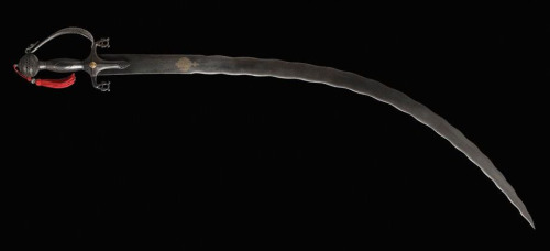

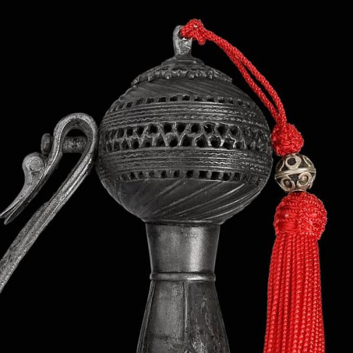

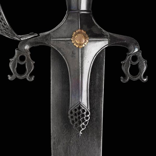

I have a few pictures to compare with the #1 sword...The two swords at the top can be seen sold on https://new.liveauctioneers.com/item...-afghan-swords
In respect of the lower pictures against a black backdrop ~The webpage says at http://honoomasamune.tumblr.com/
Quote" Pulouar Sword
Dated: circa 1676 - 1725
Culture: Indian/Afghan
Medium: steel, gold
Measurements: overall length 97 cm; blade length 83 cm
The Pulouar is an Afghan sword, also used in India, a variant of the Tulwar. It always displays a short guard, curved in the direction of the blade, and a hemispheric pommel without a counter guard. This piece displays a blade in watered steel, curved and with a slight wave in its double edge.
Near the hilt a golden cartouche is desplayed with the following inscription: “Akbar Sha al-Sultan Mirza”. The hilt, also in steel, displays a spherical pommel completely covered in an engraved web motif and geometrical patterns. The hand guard features a delicate swan head on the pommel, also engraved, an inscription with the “Ali”, followed by the sentence “nasr min Allah wa il-fath qrabi.”Unquote.

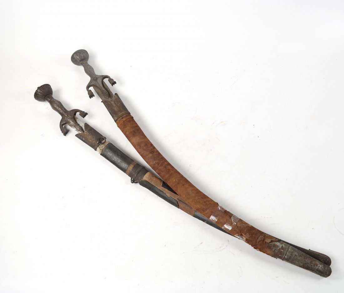

Old 22nd July 2016, 01:08 AM   #49

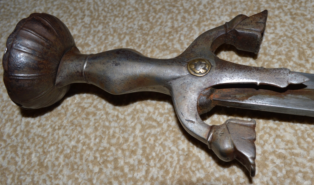

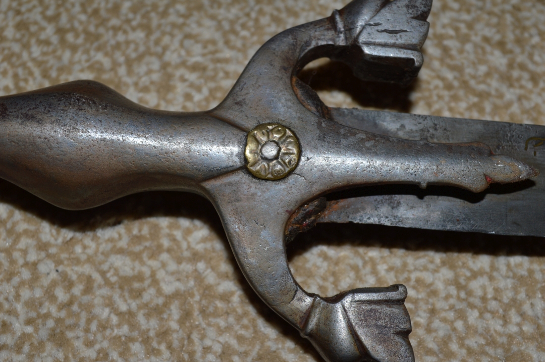

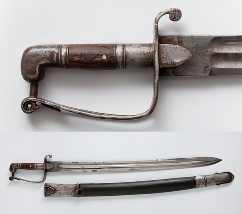

Here is one of my pulouars.
The other one is wootz, but the blade is flat, with no grooves.

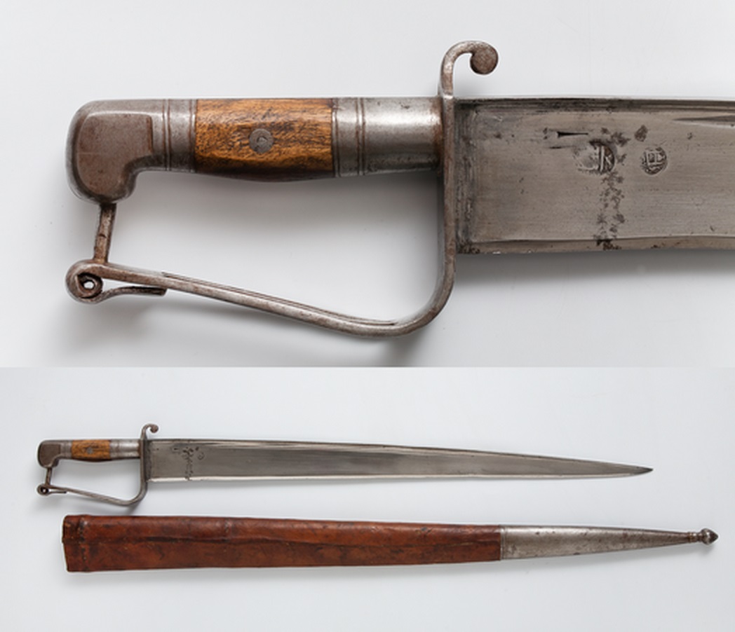

Ariel, this is very close to the one I posted, the same type of radical curve and the cut grooves, thanks to posting it.
Undoubtedly chiseled by hand.
They are straight (more or less) albeit irregular and crudely made. They definitely don't have the curves with very short curvature radius and the drilled holes at the beginning of the groove. Nor they display the obvious variation in depth.
Completely different stuff than the grooves in question. The grooves are not remotely close.
Different sword smiths using different designs and techniques, both similar, you just do not see may pulwars that look like these ones, I am sure there are more out there.

My apologies, my notes on the photo I referred to were incorrect.
What I meant was the photo by John Burke at the signing if the Treaty of Gandamak, 26 May, 1879.
King Mohammed Yaqub Khan seated at center, on his left is Daoud Shah, his commander in chief......and my notation was to the distinct style of his hilt with the open parallel bar knuckleguard, recurved terminal at top.
It is thought that this hilt was possibly a prototype for the military style hilts which were to be produced at the Mashin Khana at Kabul in the early 1890s.
As seen in other photos, this style hilt is also to be found on the traditional Khyber blades, often with the 'Mazir I Sharif' stamp of Mashin Khana.
The heavily channeled European style blade (also pictured) became the more regularly produced model into turn of the century. Later many of the hilts were in brass, but with this distinctive 'bayonet style' hilt.
It seems that these Khyber bladed examples with military style hilts as pictured, may have been for some of the tribal levy's using traditional blades but with these Anglo-Afghan hilts.
The styling of the slotted knuckle guard seems to correspond to some styling on a number of paluoars as well as tulwars from these regions in the Northwest Frontier into Afghanistan.
The theme of the paper discussed the integration of the traditional blades and military style hilts as well as seeking the origins of the design, with the example of similar style in the sword of Daoud Shah in 1879 representing earliest known placement of its form. As I understood the title noting 'regulation Khyber' referred to the development of these military Afghan swords as well as their use with traditional Khyber blades in the tribal contingents .

This is true Jim: Afghanis were trying to mass produce their traditional Khybers at the Mashin Khana and to give them some European look( D guard). The upper one you have shown is an example. At the same time the mass-produced ones started using cheap materiel, - wood, - for the handles and got rid of any artistic elements present at the older handmade one. In a way, it was similar to what happened with Caucasian shashkas: the Russians appropriated it as their regulation weapon and modified it to the point of converting a beautiful native weapon into pretty ugly European-looking saber without the handguard ( the only homage to the original Caucasian inspiration in addition to the imitation of an eared pommel).
But the last one you have shown that was also carried by Yakub Khan has nothing to do with the Khyber: both the handle and the blade are European, and the blades on different examples were of a variety of patterns, none of which had anything to do with the original Khybers. The Yakub Khan's one was in existence well before the establishment of Mashin Khan. Those were just colonial models.
There was no evolution of Khybers : just a short-lived and unsuccessful attempt at mass production. And the purported "final step" of the presumed evolutionary process had nothing to do with the original model. As they say: true, true and unrelated.
