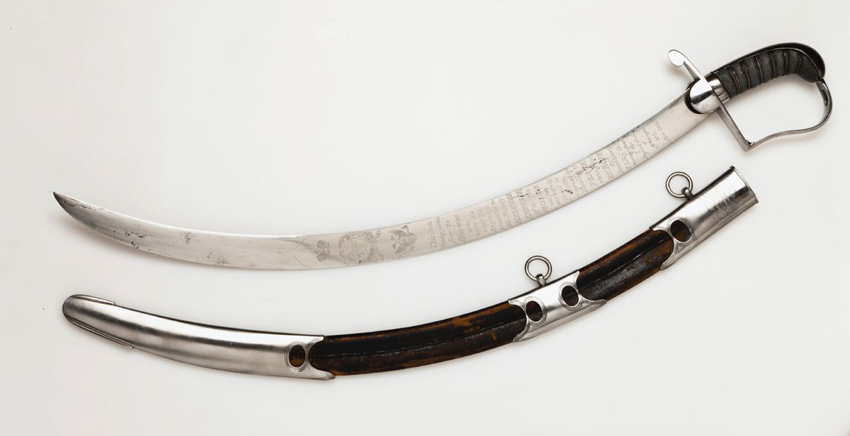

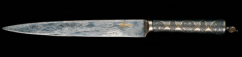

Jahingir’s Meteor Dagger
Given to him by a loyal tax collector, Mughal Emperor Jahangir had a meteorite forged into a pair of swords and this dagger.
Like his Empire, he saw it as a gift from God. The tax collector said that as his men dug from the meteorite, the ground grew hot and the stone was molten; his men had to wait for it to cool before moving it.
Showing below.....James Sowerby was a noted artist and historian of natural science, even hosting his own museum that had meteorites on display. As a gift for Czar Alexander I, Sowerby had the Cape of Good Hope meteorite forged into a gift for the Emperor. It took years for the Czar to receive the sword, and for a time it was lost.
Both exhibits and detail from http://www.ripleys.com/blog/meteorite-swords/

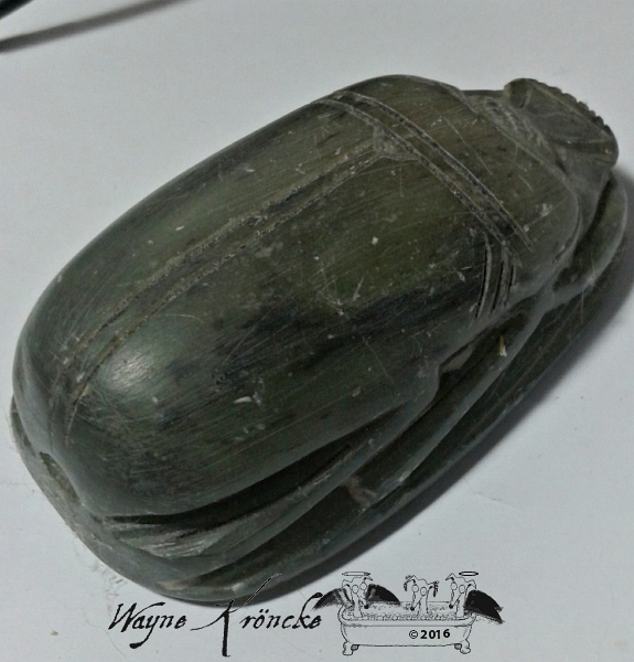

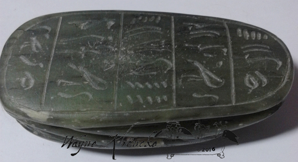

i stole it from the museum in 2021 after the restoration of the royal family, went back in time with the wayback machine that stewey & brian lent me, to 1921, put the dagger in the tomb and returned home.
and here's a picture of the scarab i took from it to prove i'd been there.
(this is a real egyptian scarab that has been in the great pyramid as well as tut's tomb back in the '80s - really )
