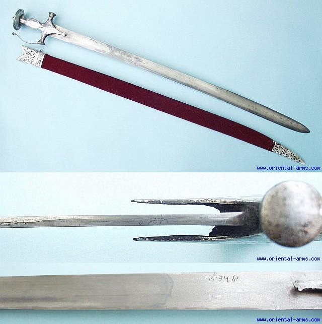

Cousin of the tulwar known as kirach or karach and it is characterized by the slightly down curving blade with the edge on the concave side and the down curving spine with a false edge.
The blade is 32 inches long with 10 inches false edge forged from good Indian Damascus wootz (crystaline) steel, marked with armory marks on both sides as well as on the spine and made in the construction known as scarf welding. Scarf welding was done by welding two ingots of steel in or around the upper third part of the blade, in order to provide the blade with both strength and flexibility. It was a common technique since many centuries and found on both Indian and European quality swords. Here the welding point is clearly seen in the close ups as a darker semicircle.

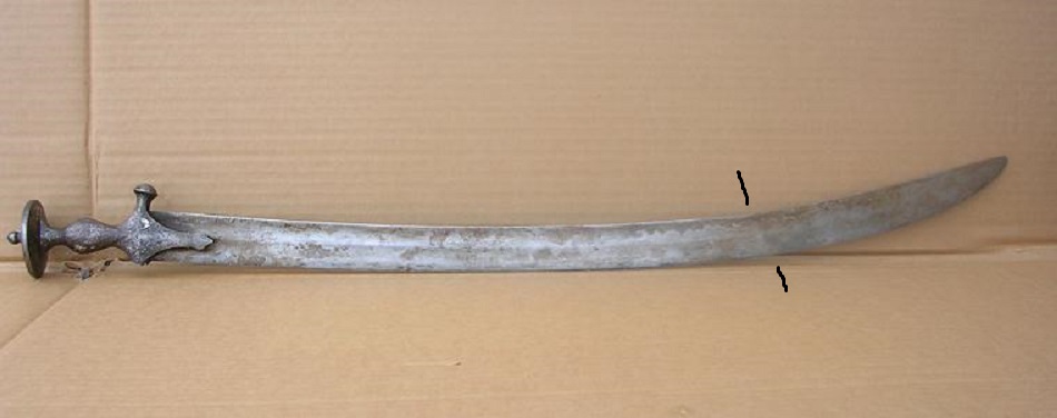

That's what I said at the top of this page.
Eric,
Here is a poor and old photo of the mended blade, the only photo I have at present. This is a very old mend, as all was covered with the same amount of rust.

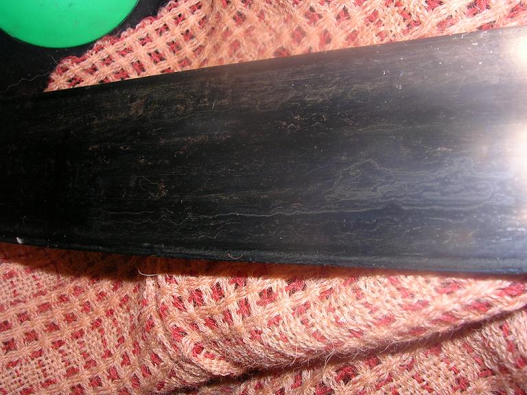

The second picture are of the laminations as they showed after cleaning, but these are Not of the break area.
If you wish a close-up of the break I will oblige in due course.
