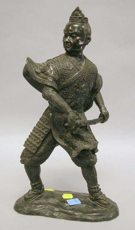

This bronze recently closed at auction .
I almost contacted the 'Dhafia' , but time was short .........

Posts: 4,714
Great little bronze Rick -- did you get it?

Old 18th March 2006, 02:04 PM   #38
Posts: 6,418
Talking
What do I look like ; some kind of dha collector !?!
No , I didn't bid ; I'm not registered with this auction house and I must scrimp and save these days .
I just thought you addicts might want to have a look .
