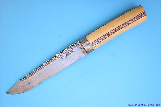

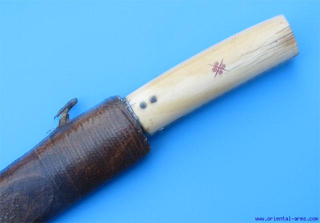

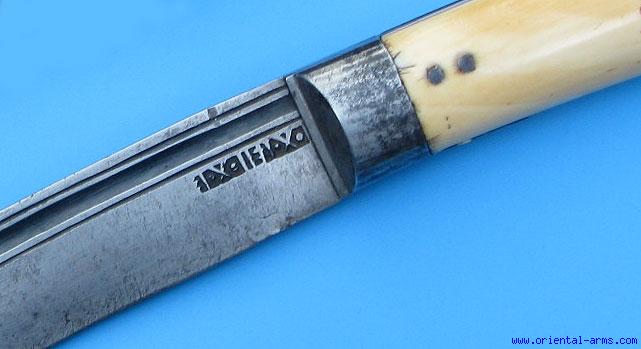

Here are a few more from Oriental-Arms labeled as Afghan or Pakistani.

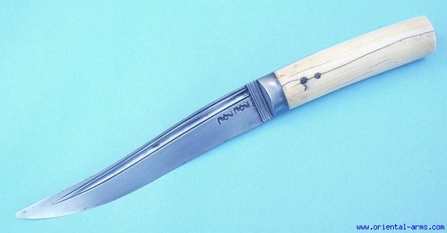

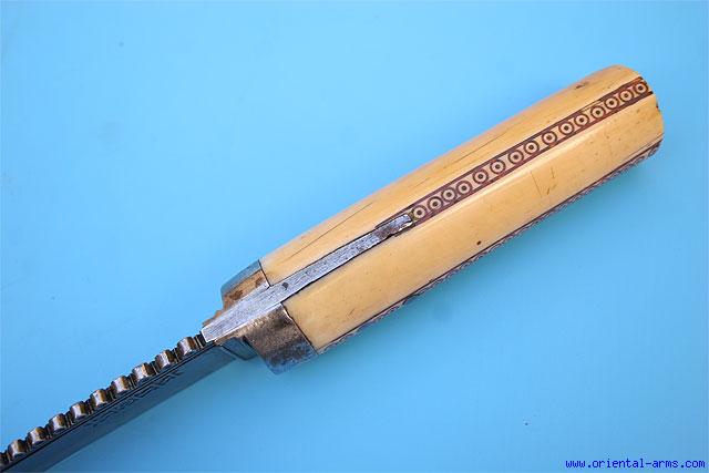

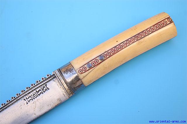

Old 5th November 2014, 08:47 PM   #34
Emanuel
Emanuel's Avatar
Join Date: Jul 2005
Location: Toronto, Canada
Posts: 1,242
Another one...

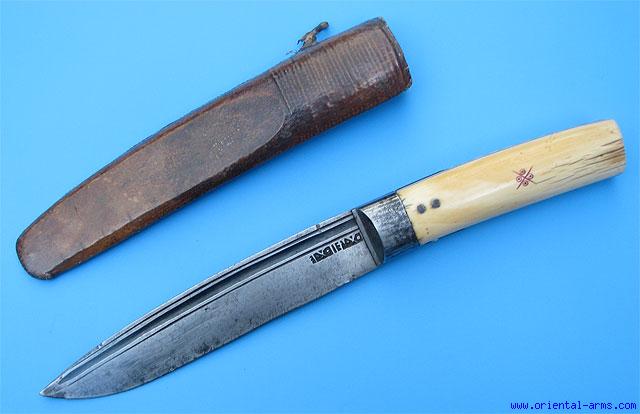

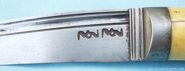

Old 5th November 2014, 08:48 PM   #35
Emanuel
Emanuel's Avatar
Join Date: Jul 2005
Posts: 1,242
And a last one...

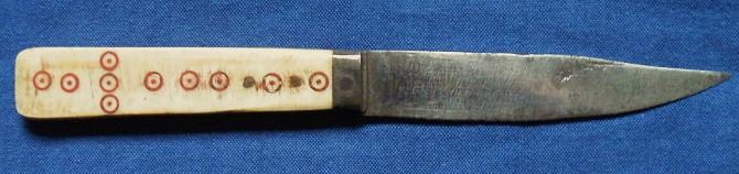

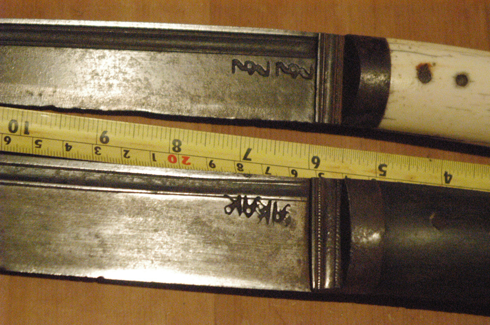

The identification is based purely on research using the British Museum. I'm relying on their archive accuracy but I find it compelling that they have several separate donors for very similar knives giving the same source location.
Copied from other thread.
I posted these a couple of days ago asking for Id help - thanks to everyone that replied. Ariel suggested checking British Museum and a search of the online archive provided the answers.
My view is that these are East African , Malawi / Mozambique / Tanzania area and would even go as far as to say they are Yao tribe origin.
I'm fairly confident of the attribution but for those that have time - please check the Britsh Museum online image archive. Dont think I'm allowed to give a link but :
British Museum home page - Collection online - Knife ivory ( in search box) - tick images only - then search. Scroll through the page and there will be at least 5 or 6 knives very similar to the Ivory one with strong attributions.
Perhaps there needs to be some further discussion about this before confirmation.
For those like me that originally suggested the Asian regions , the Yao tribe built up strong links with slave traders throughout the 19th century eventually converting to Islam around turn of 20th century. This might explain why the knives have influences from both cultures - which caused the difficulties in identification.
The items held by the British museum were mostly gifted in the 1920's and 40's. These were from the estates of persons that were in Africa in a colonial capacity at or around the turn of the century.
Please let me know your thoughts ?

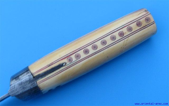

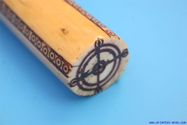

Now here is a cruder form previously discussed on this forum and considered to be Afghan.

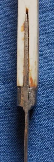

Some thoughts...
Note that the blade is very similar to some short Burmese dha knives in both profile and execution:
- single-edged
- slight droop towards the edge
- well executed fullers on the good example, but flat blade on cruder examples
Note the bolster construction which appears to borrow both from Nepalese khukri bolsters, and from Tibetan knives, with a rivet through the bolster well brushed and hidden.
The tang construction is unique in that the tang maintains the same section as the blade and is not hidden inside the handle, which has a slot to received it. So far, only the crude Afghan knife above features this tang construction. Otherwise the Tibetan knives feature slab/scale handles, while most khukri and Burmese handles have a hole inside to receive a narrower rat-tail tang. Khukri with slab/scale handles appear in WWII with the British pattern MK2.
The circular decorative motif on the handle and sometimes scabbard straps is not a helpful feature in establishing the origin of these knives as it has already been shown many many times on this forum that it is extremely widespread to different cultures around the world.
The stamped markings at the base of the blade are like nothing else. They closely resemble flags or maritime symbols to me. The marks are repeated 2-3 times and look like they were struck by the same punch. This suggests a standardized manufacture to me, not simple village production.
Emanuel

I obviously always thought these NWF, Assam, Burma maybe surrounding regions...
That being Due to there details of manufacture... the only discrepancy being the exposed partial tang, that is historically usually European..
But personally ill accept Malawi etc. for these... as 3 out of 4 are provenanced to separate donors, all of whom only donated items from that region...
Unless or Until someone proves there from the Yao in Burma or some Indian manufacture etc.
Indian manufacture in Africa could make more sense to me?
But until that time I have to go with available apparently provenaced pieces originally from 3 separate collections, unless some one can dig up another pre.ww2 reference or reliable provenance to prove the BM have got 3 accessions incorrectly listed to donors or they are made by Indian smiths in Africa, etc.etc.
When I look at other African Yao stuff I see no similarity... Strangely the Lao Dao from Burma looks closer.
Who can find more evidence... there must be other old collections with these?
Fernando... Are there any Portuguese museum collections of relevance you can access?

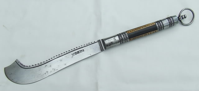

I still have problems to believe that this knives are from Africa, museums are often wrong by descriptions.
Nepal could be a facility, look for example this ram-dao taken from this forum: http://www.allempires.com/forum/foru...TID=29611&PN=3
See special the mark on the blade.

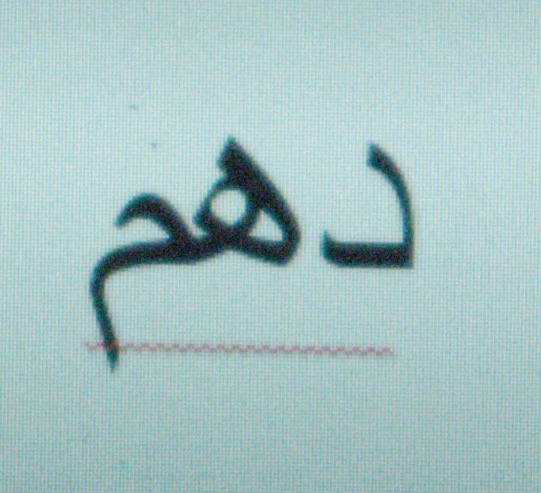

Again open to interpretation but have a look at the pictures below, - the screen capture is Arabic script and the meaning of the word is "Attack" . Is it just me or is there similarity to the stamps on one of the blades ? Even if my translation is wrong it would seem to be Arabic script - maybe someone on the forum knows more ?
As a last thing I showed my knives to an established collector who lives in my village. The majority of this discussion has been about the Ivory one so far but his opinion was that the larger knife might actually be horn handled not wooden. This may well impact again on location of manufacture. Apparently there is a weapons event soon and my friend is going to take them up to show to his colleagues so this might generate more to talk about.

Jampot, I can see why you sy it but if it was Arabic script, many people on the website could read it....
