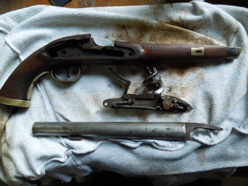

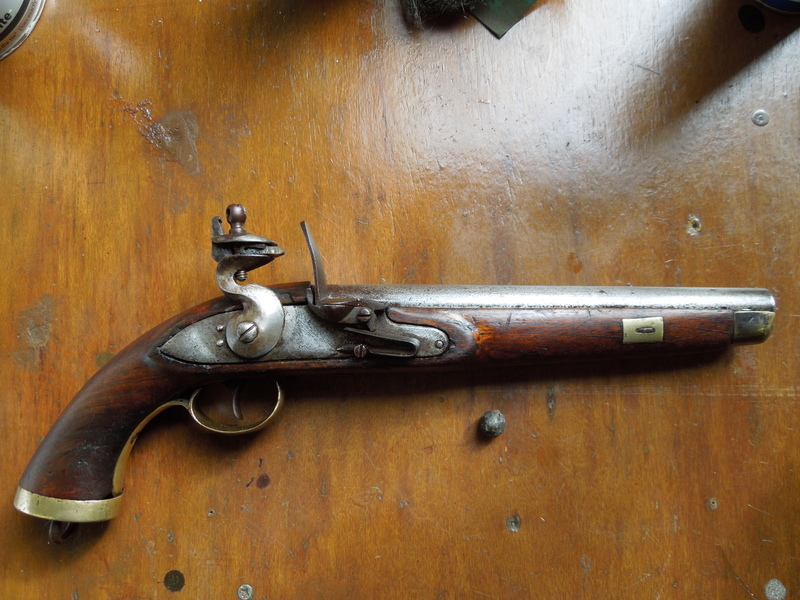

Reasonably the pistol had been sitting loaded for probably well over 100 years, so I figured it's not a danger in the sense that it could explode or just go off. The risk is in me creating a spark while mucking about trying to dislodge the ball.
So first I used a syringe to fill the chamber with water through the fire hole and I kept it topped up for 24 hours. I made an extractor tool - metal strip with right angle and a hole to take a self cutting screw. Then with the barrel full of water I screwed into the ball and on third attempt got the ball out. The ball seemed held by the powder rather than the sides of the barrel.
The powder was caked rock solid and took a lot more work to remove than the ball with some forceful scraping required. I kept the barrel full of water during this as well.

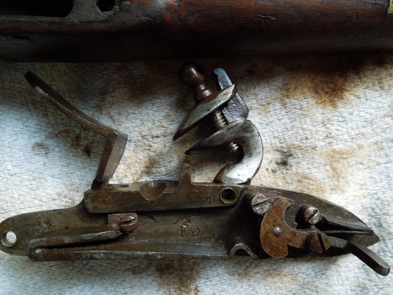

Having a now very wet pistol I decided to dismantle it to dry out and oil. A bonus was finding the ELG mark on the barrel under the wood. I was wondering about that and many thanks Fernando for your explanation of the Leige marks, none of which I knew.
I did not expect to have to unload and dismantle my first flintlock pistol but it's been a good learning experience. Thanks to everyone who contributed advice and suggestions.

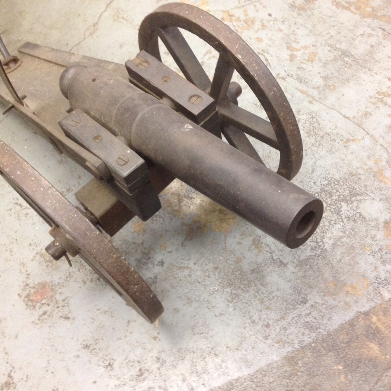

I bought a signal cannon years ago at auction and found it to be loaded. It had a bore of about 7/8" but a rod would not seat to the vent hole, or anywhere near it, for that matter.
After fashioning a wiper from welding rods I went to work. The stuff that came out was amazing. I wish that I photographed it. No projectiles, but, in layers, newspaper, smokeless shotgun powder topped by newspaper followed by some silver colored firecracker powder topped by more newspaper and finally more smokeless shotgun powder topped by--get this-- a large wad of black plastic trash bag!
Things were so tightly compacted that I bent and distorted my rigged up wiper!
Had the nimrod who loaded this cannon been successful in cooking it off, it would have been catastrophic. His ignorance saved him, though, as his first layer was a wad of newspaper that very effectively blocked the vent.

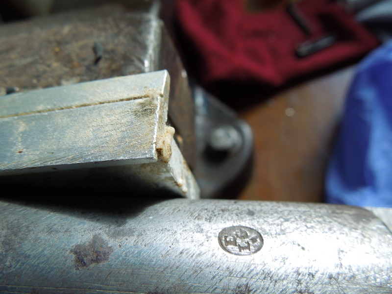

Hi Mark,
Here is a picture of the ELG mark it is located on the side of the barrel underneath the wood. There are no other marks except within the lock as shown but I guess these are inspector marks or indicate the maker of the lock.
From yours and Fernando's comments I think that dates the pistol sometime between 1810 and 1830. No crown and small letters. Is yours a similar mark?
