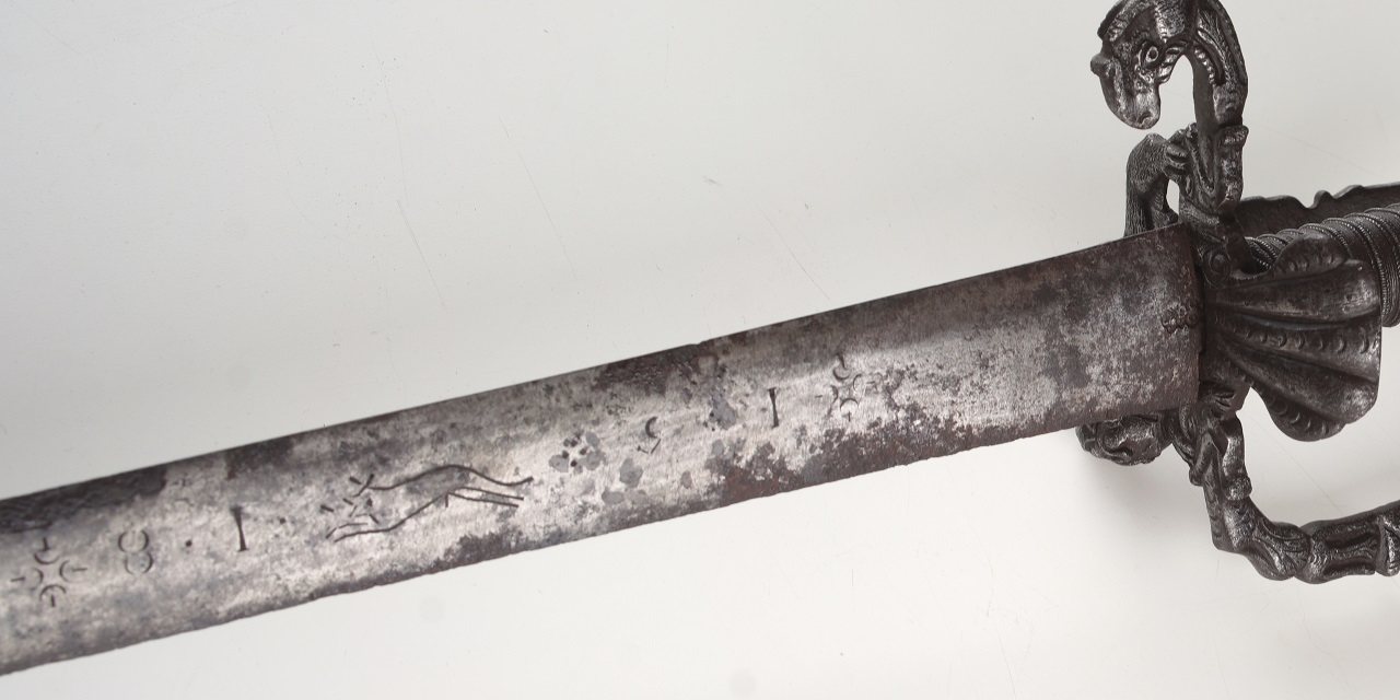

Originally Posted by AHorsa View Post
... But it underlines the good possibility to be Dutch. ...
The Blade, at least, looks Dutch from the two tulips stamp. The more I look, the more tulipy the flowers look.

That´s a pretty interesting point! I did never pay attention to the form of the flower. Just looked at it as a flower pot mark. It indeed looks pretty much like the flower pot is filled with tulips! On the other hand the running wolf mark is mostly attributed to Solingen...
A Photo of the wolf would be nice.

Posts: 399
Of course

Thanks, wolf & Tulips add a conundrum to the enigma.
