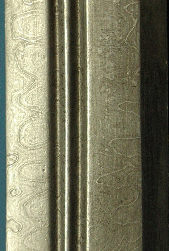

Should these random surface patterns really be referred to as 'Pattern Welded' ?
I see disorganised patterns such as these as a result of plain old layer forging rather than a planned pattern such as bird's eye which is obviously manipulated to produce the desired effect .
Thoughts ?
I'd vote 'yes', because the method of manufacture is the same, and a random pattern is still a pattern. The smith might not have been directing it, but it's there.
Note the horizontal traces in the left blade of post 23 - the smith was doing some manipulation there, although I'm not sure you are referring back to those two blades?
The right hand blade looks like it went through the bird's eye treatment (or something similar), but due to the low number of layers the effect is stylized into something else.

Hi Jeff , yeah those were the two blades I was referring to .
I'd like to see longer samples of each one .
I guess when I think of *pattern* I think of repetition as in Turkish Star or Ribbon , Ladder Pattern , Rose etc .
Something specifically manipulated to achieve an effect .
So any blade forged in layers is in fact Pattern Welded ?

I also thought about this question, Rick.
I tend to vote "yes" - especially since there seems to be no objective cut-off between random and "forced" patterns but rather a broad continuum between the extremes. There also seem to be quite some patterns which were not strictly planned but only slightly coaxed into a direction preferred by the smith.

Old 8th February 2006, 01:47 PM   #59
Jeff Pringle
Jeff Pringle's Avatar
Join Date: Nov 2005
Posts: 189
Verhoeven makes it clear that Fe3C (cementite) is crucial to forming the watering pattern. He also makes it clear that they can only form in the hypereutectoid state.
While it is true that excess cementite only shows up in hypereutectoid steels, I think Verhoeven might be mistaken in saying the cementite is crucial to the pattern.
This blade is 0.79%, measured at a lab -
This blade is somewhat less in carbon, but has not been lab analysed -
The patterns are not due to extra cementite; since they are below the eutectoid point the carbon is all wrapped up in pearlite.
Do the patterns look like sham wootz, or regular, or somewhere in between?
I think the ultimate answer is to get more blades checked at the lab, but we may find the old pattern-based distinctions are as much related to working methods as alloy.
Jeff Pringle is offline   Reply With Quote
Old 8th February 2006, 11:36 PM   #60
Gt Obach
Posts: 116
love those blades... very nice
i like the top one alot... ... were they etched in sulphuric
the bottom one..... the pattern near the spine looks abit sham like... with the straight long lines..
what do others think?
i think we are really are closing in on the true wootz steel... by looking at the traditions, the alloys, patterns and treatments.... i believe its really the big picture that counts.....
-- when i look at Jeff's blades ...by the nouveau wootz definition... i would say they are wootz..
Shangrila: I believe that is a " Kard " and its made of wootz... ... very nice...
I love the close up on the blade.... look at the purple-ish hue of the etch..
-- this is interesting.... has anyone replicated this etch oxide color ???
-- i'm thinking "alum" may have been used in the etch??
