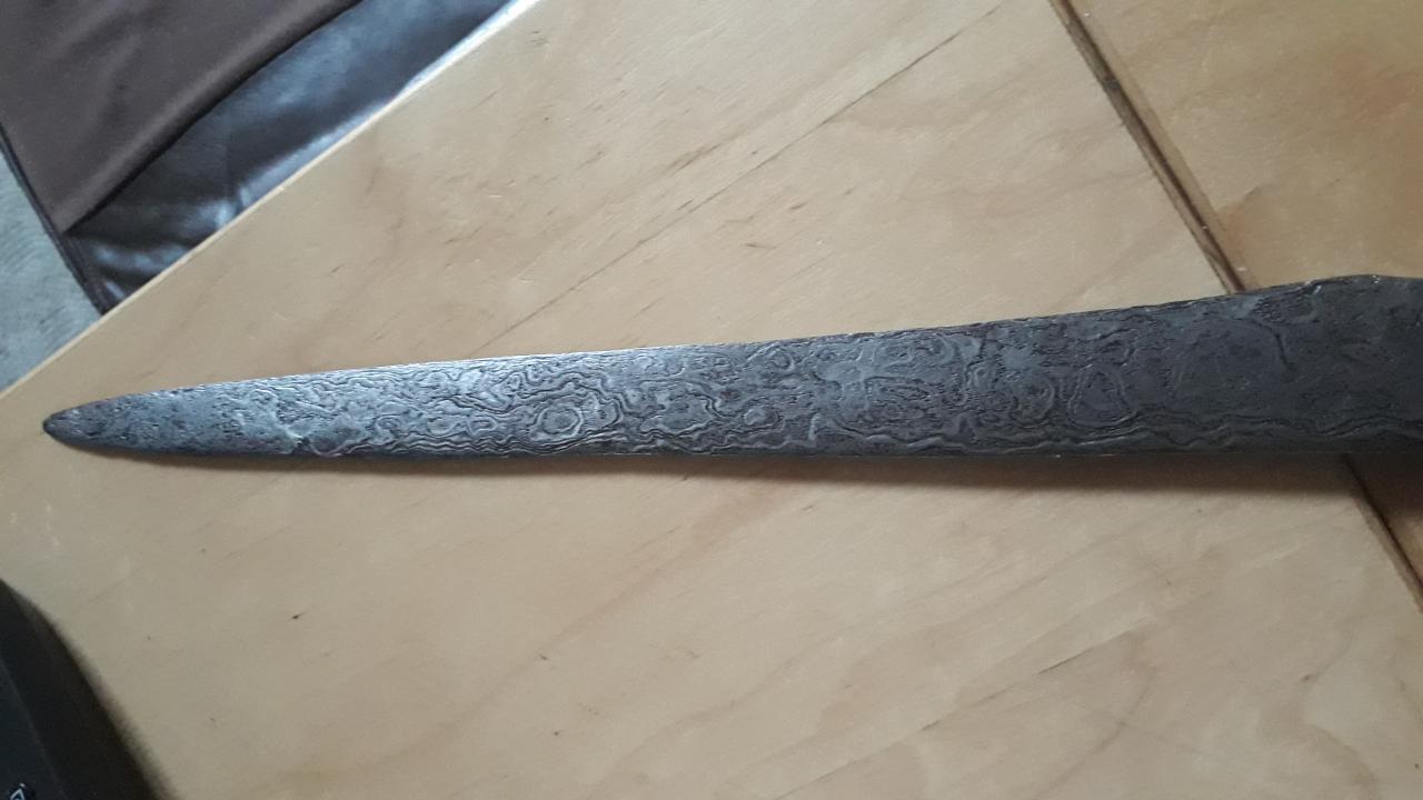

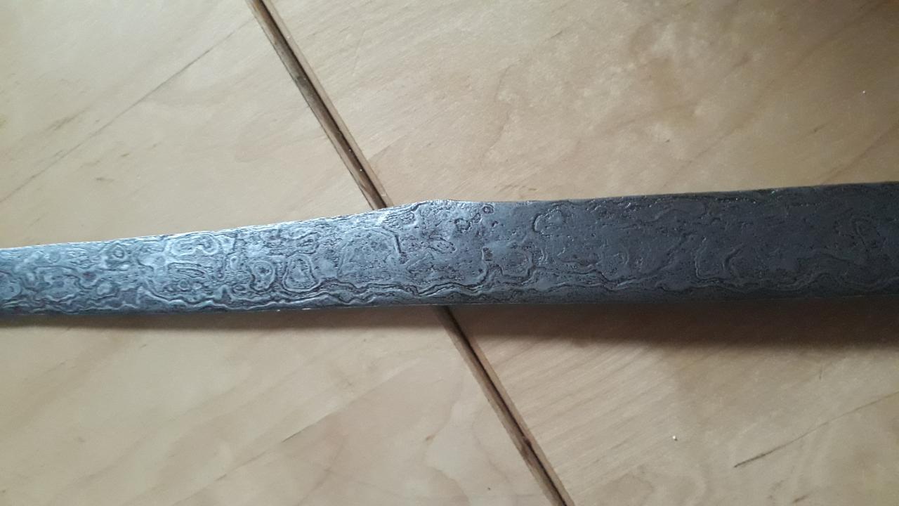

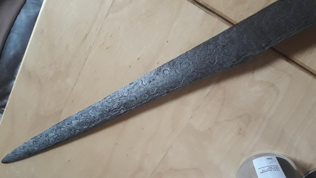

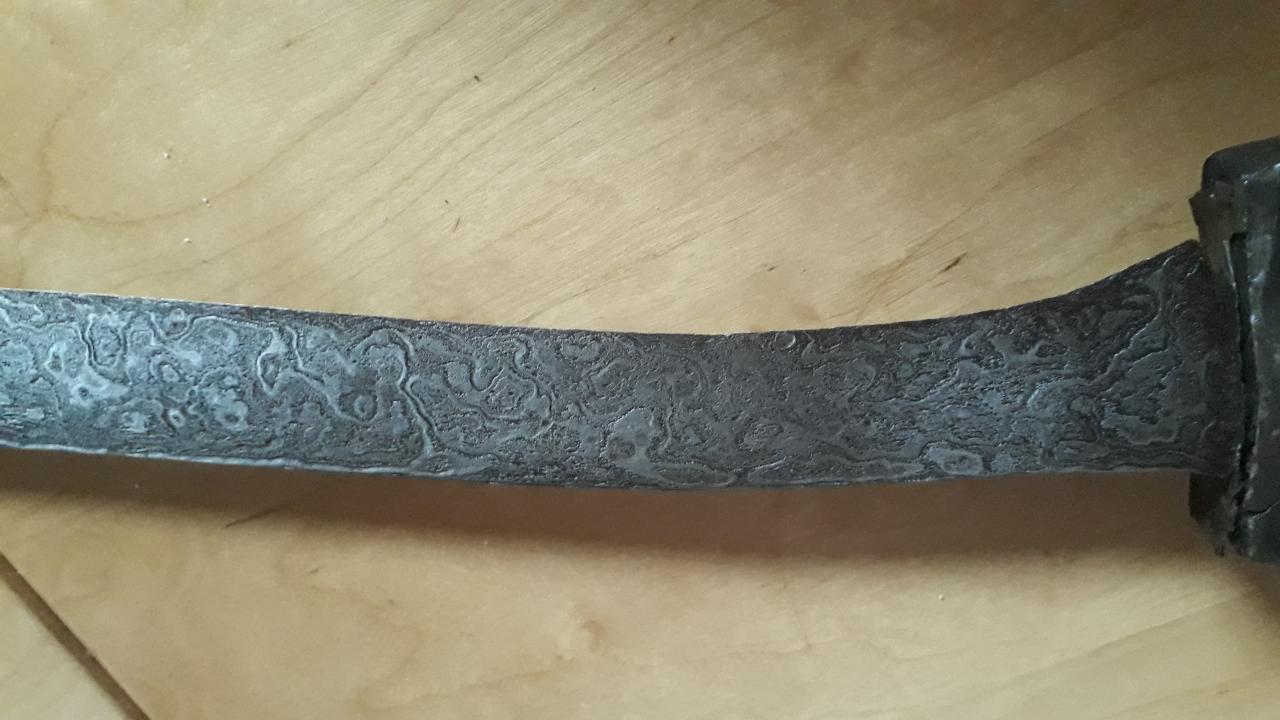

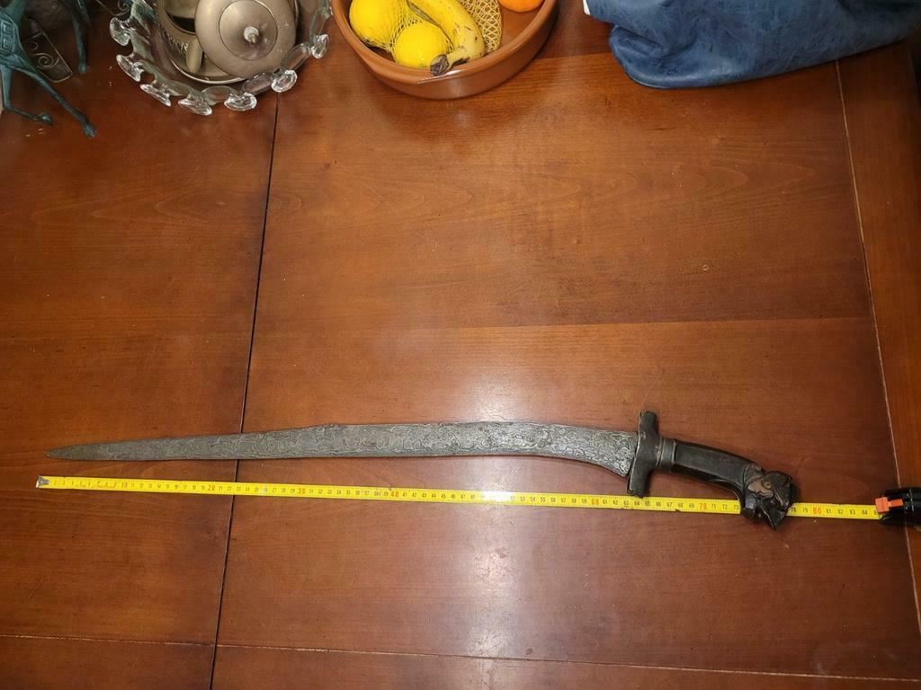

Are pedangs welcome on this thread/board? I have only one blade with pamor so far, and it is perhaps not as fancy as some of the blades on this thread (a bit of damage to the hilt), but I really like handling this little sword. The weight and grip angle makes it feel both choppy and stabby (it brings the point exactly in line with the outstretched arm without hyperextending the wrist, and the forward slant makes it feel somehow "eager" to chop, if that makes sense).
