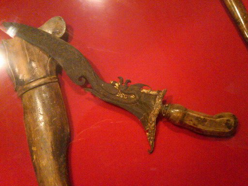

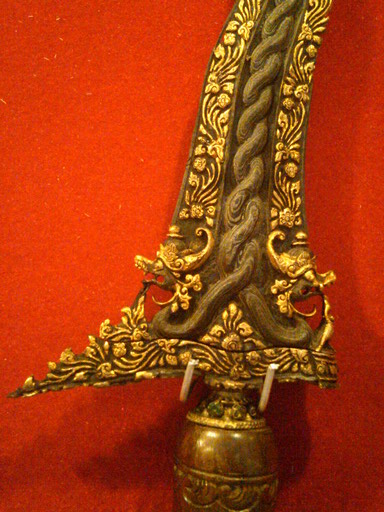

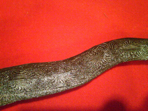

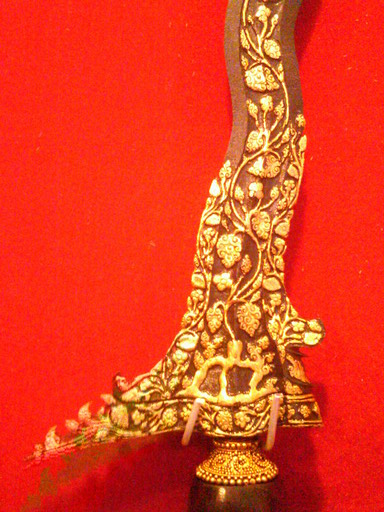

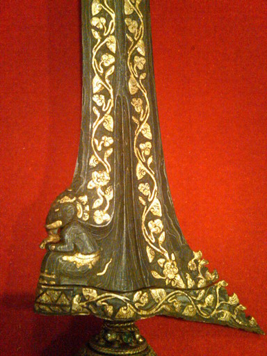

additional pics

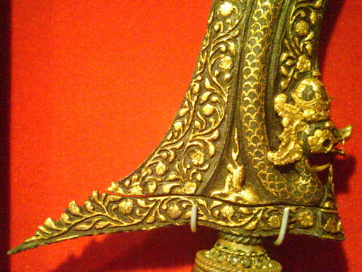

Keris dhapur sapokal
pamor : jala rante
satsujinken is offline   Reply With Quote

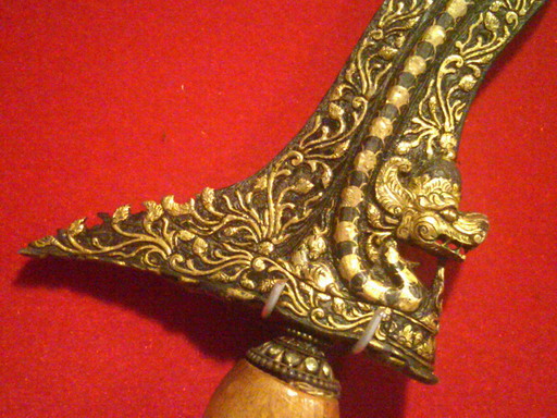

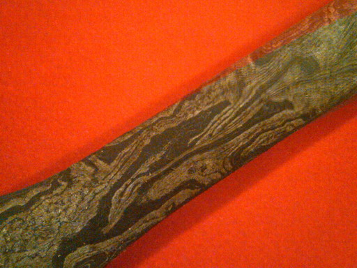

Posts: 199

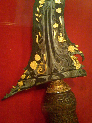

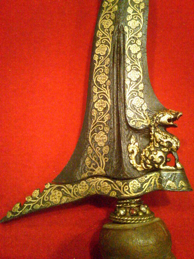

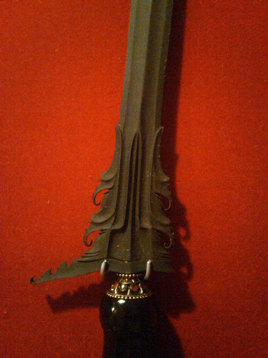

Keris Bethok Sepang
(said to be old, but I doubt it )
Keris luk 7 Sempana Kinjeng
pamor : wulung (no pamor)

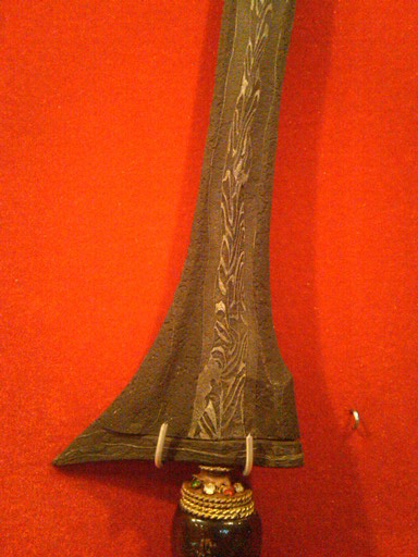

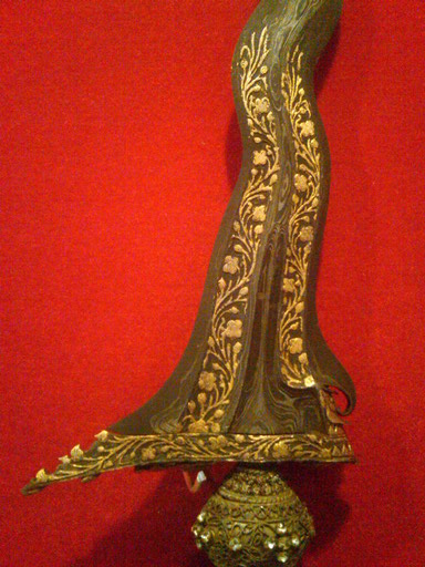

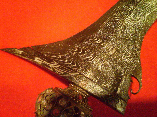

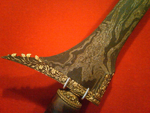

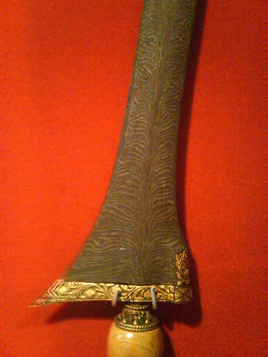

another interesting pamor
keris luk 9 Sempana
pamor : rambut daradah

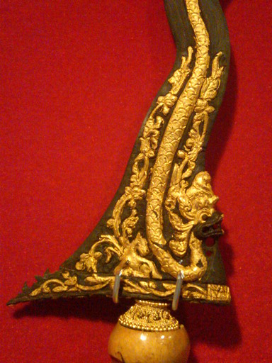

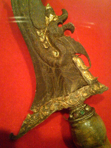

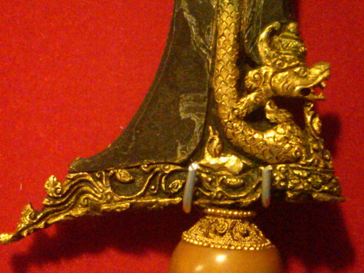

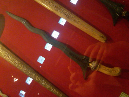

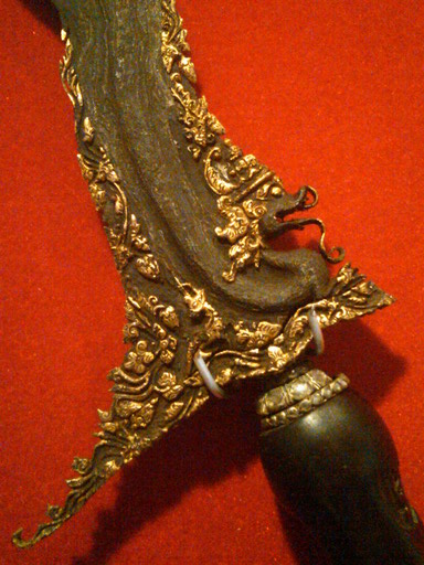

miscellaneous pics

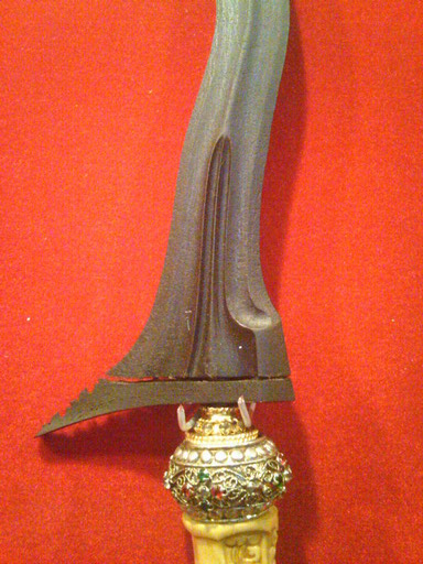

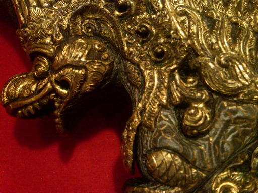

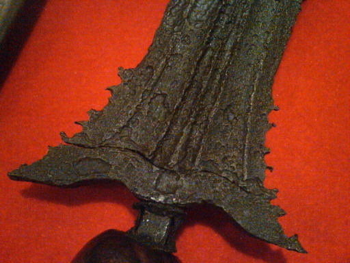

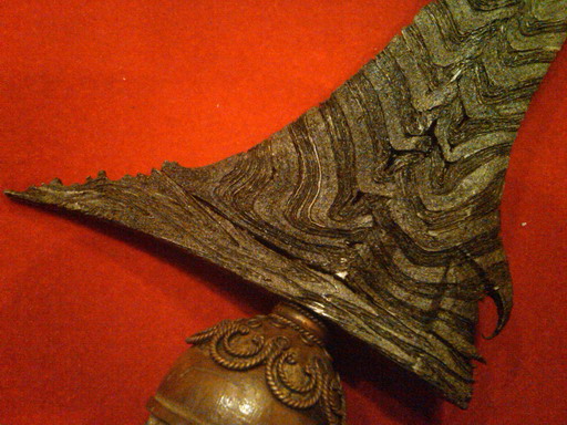

miscellaneous pics again

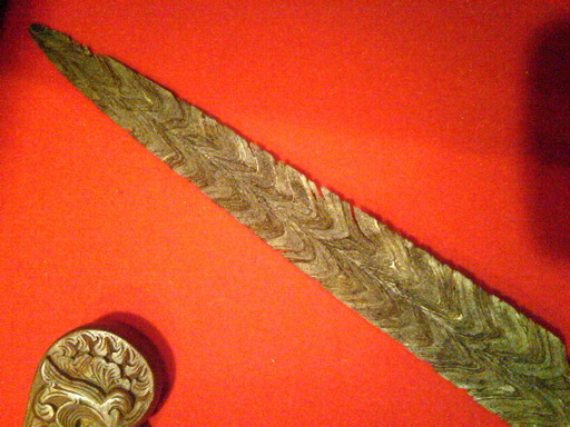

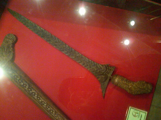

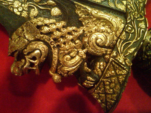

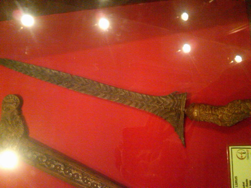

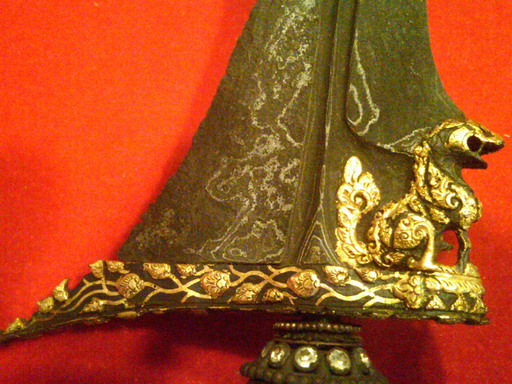

nice pamor

more pics ... sorry if some photos are doubled

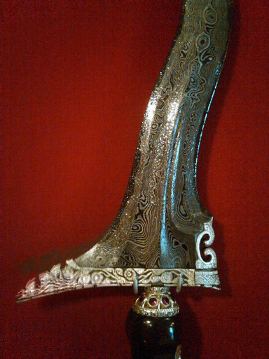

last one I think

well I believe that's all I managed to capture using my phone-cam
I hope you all enjoyed the show as much as I do
and if there's another exhibition nearby, I will surely be glad to document and shared with all of you
thank you, for the appreciation
