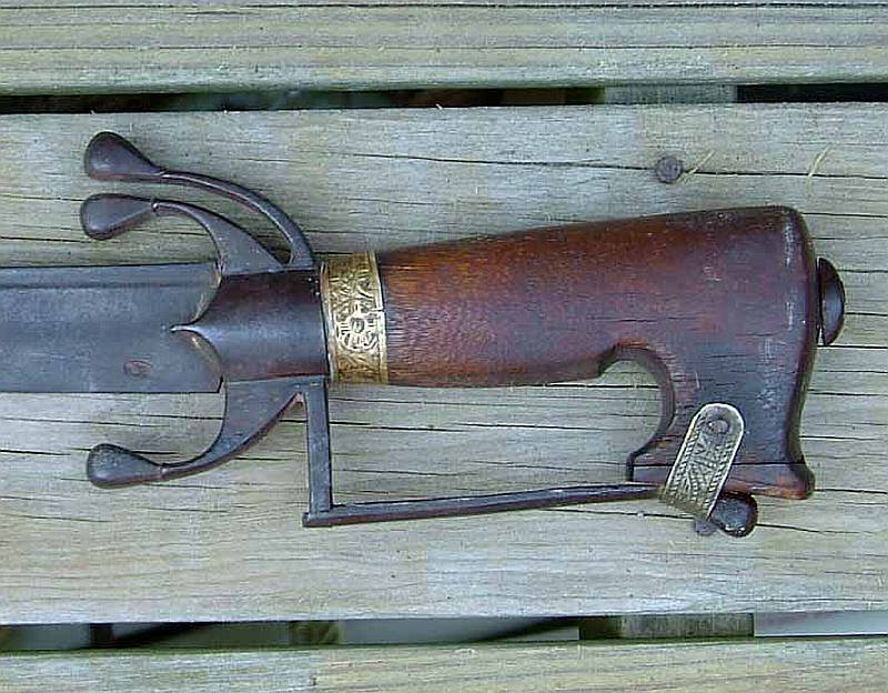

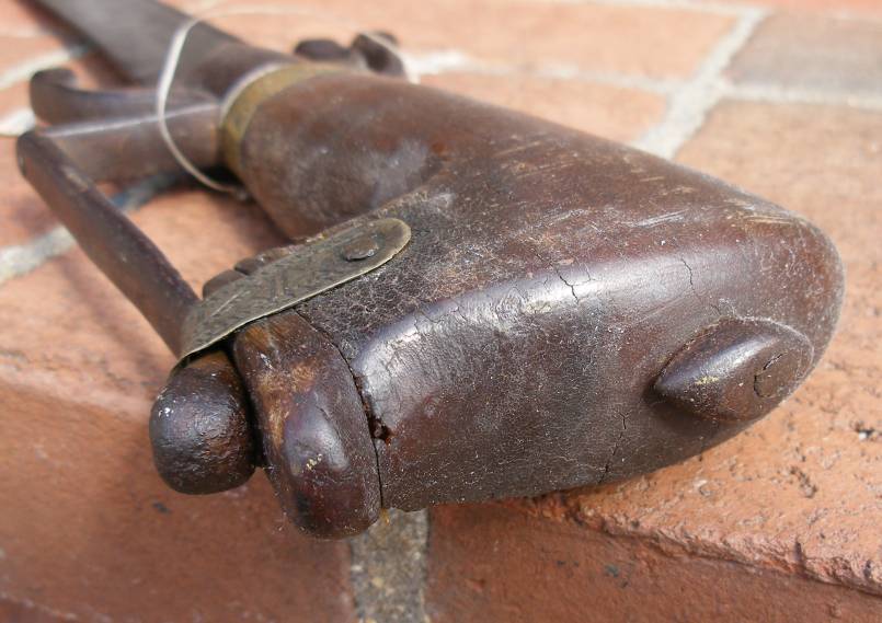

Sorry spiral, there is no visible, photographable end grain. Not with the 16x magnification I have. There are a few small areas, that exhibit side grain like several known examples found here, and on line. Around the edges, there are some bug nips, and chips. The larger ones, have been filled with something. When touched with a hot pin, it smells like burning hair. So whatever it is, it's organic. The surface shows areas similar, to old cracked paint. I found a few photos on line, that were similar. Maybe, I can take it to the zoo, or college.

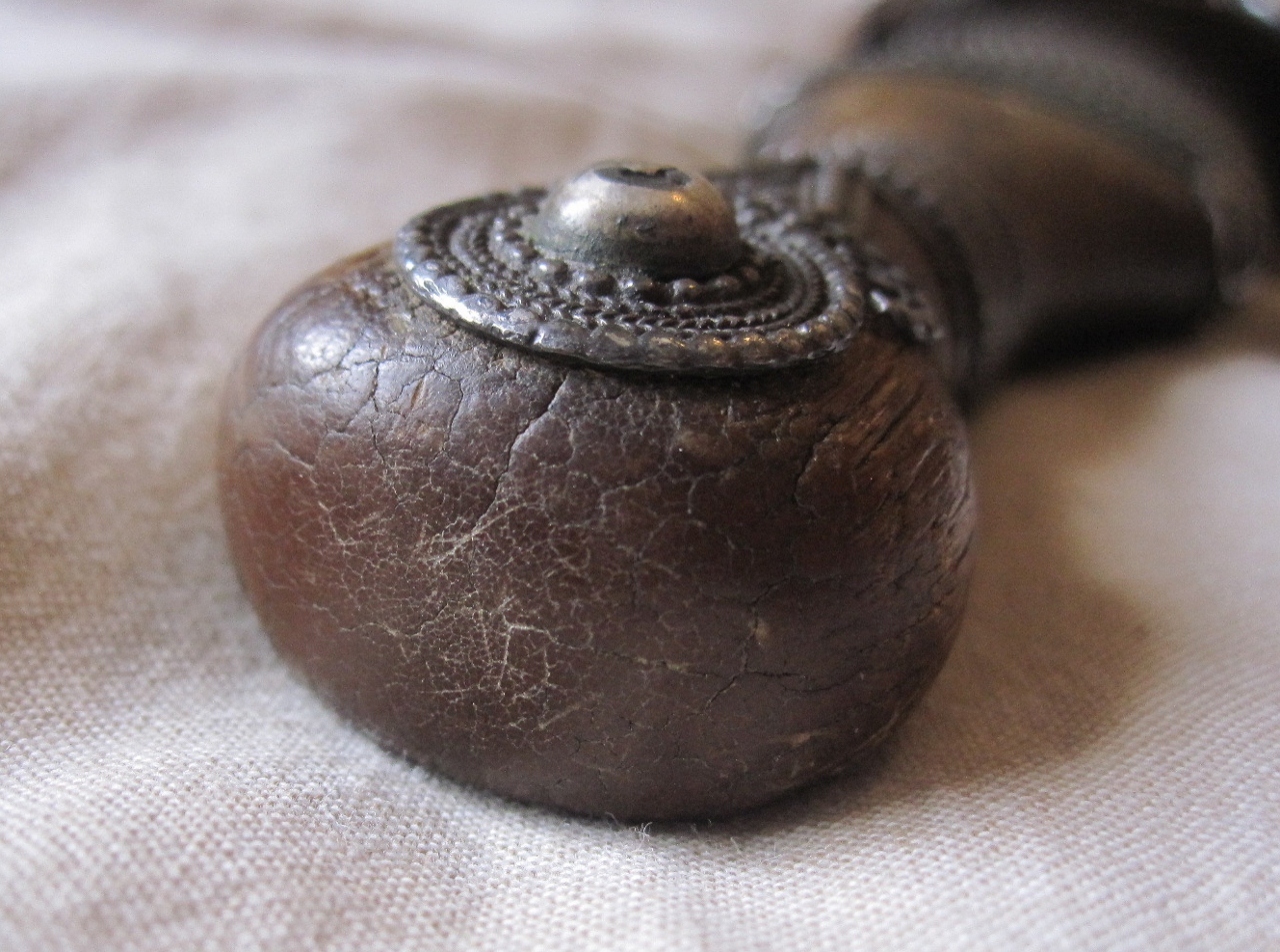

I'd say skip the hot needle test it only damages the item without any confirmation. You'll need a bright light and a good eye basically. The top should be something like the included picture.

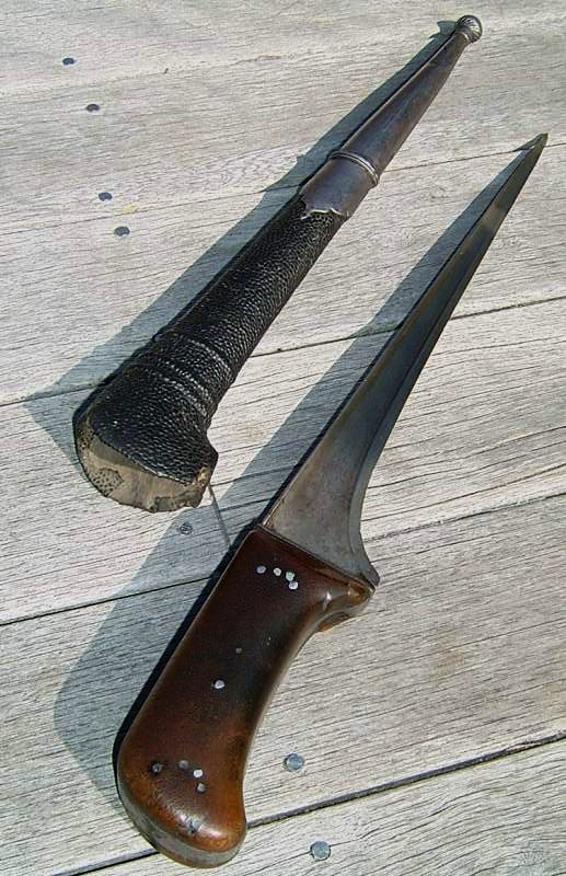

Preach it, Spiral my friend, you speak the truth! Macro shots of the grain - preferably, although not necessarily, a trans-sectional shot - are needed in order to confirm rhinoceros as source species. It's hard to say from the pictures at hand, because the handle in question is both very dark and in very good condition. In general, rhino horn doesn't tend to chip when damaged like bovine horn, but becomes more "thready" with age almost to the point of completely disintegrating on very old pieces.
Color alone is no indicator either. Rhino as well as bovine horn can both come in a wide pallette of colors and hues, from light honey, almost blonde, to pitch black.
*Trenchwarfare* If you could get some close-ups of the pesh hilt, I'd be happy to give you my opinion on the material.

Hi guys. Sorry it took so long to get back. With a 16x loop, and bright sunlight, I finally managed to find a small window of end grain. According to all images I have seen, the hilt of the black Pesh-kabz, is Rhino. There is also a small window of side grain, that looks right. Unable to take decent photos, with my limited equipment, and abilities. The blade does have a visible wootz pattern. Without etching, there is no visible wootz on any other blade. The brown handle on one of the military swords, is unfortunately, wood. But, I believe that it is the original hilt. What is the preferred etching medium? It seems everyone likes something different. And, what is the preferred technique.
