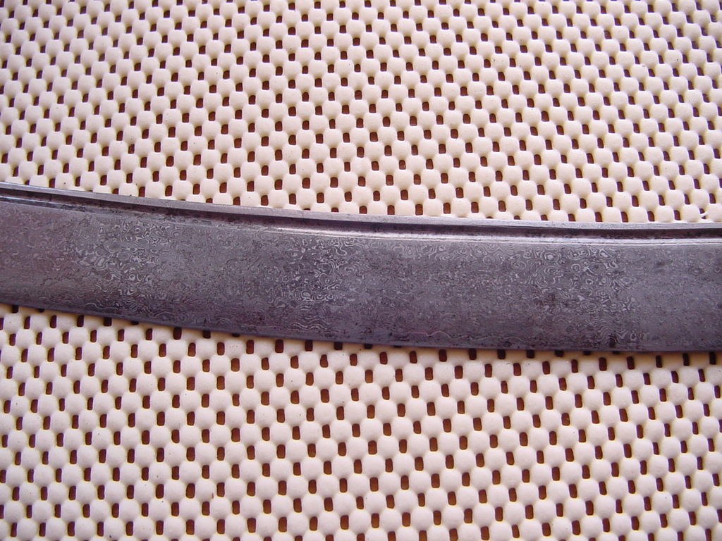

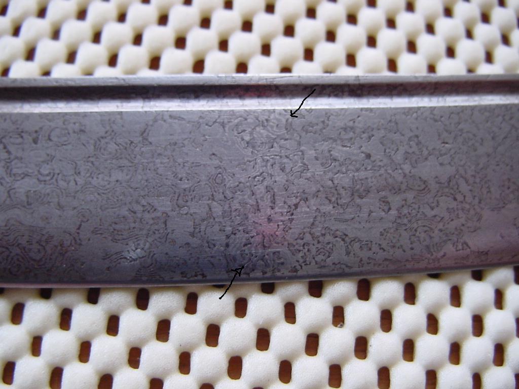

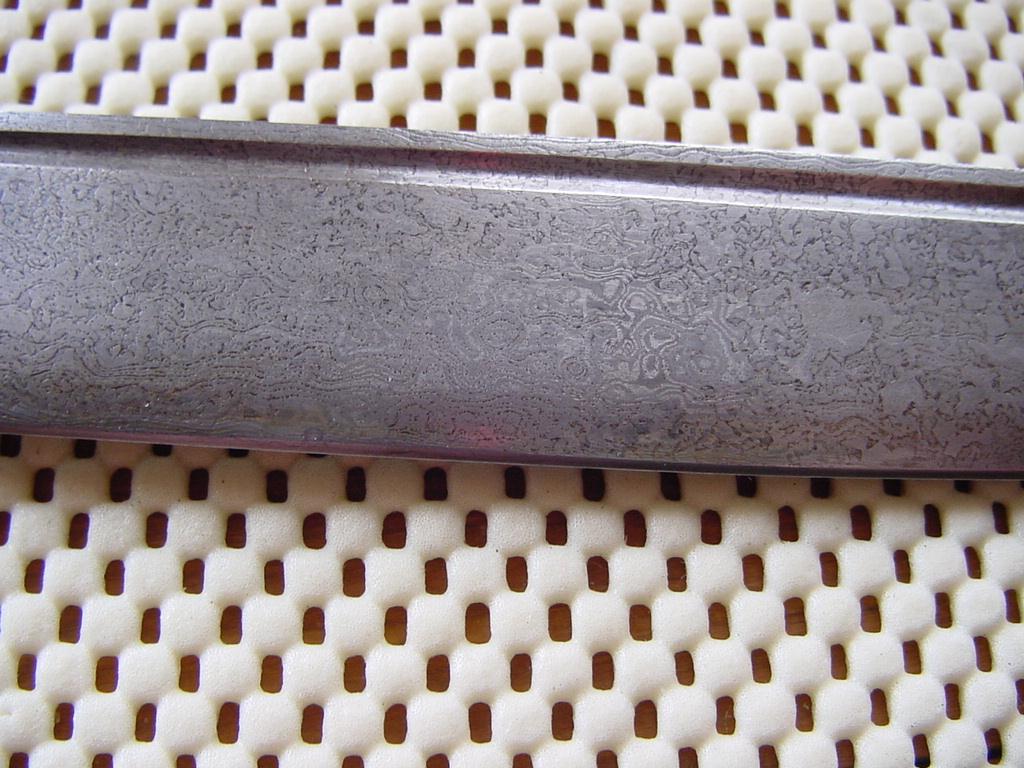

After considerable time using a diamond lap stone on the edge only it now has a curved (rounded) 2 /32 inch bevel that is just at the point of cutting paper easily. I stopped there to avoid future edge blunting by someone with safety concerns. Given you'd rework the blunted edge. Would you go further to blend in the original shape?
After the re-etch there was a fairly defined laddered Kirk effect on one side. the odd side was a little less defined. I marked one of the more noticeable" forced?" patterns the others are not noticeable. Evidently the maker must have meant for the blade to be stained, does that help clarify anything? As Dom said earlier at least this may be used as an example. Steve

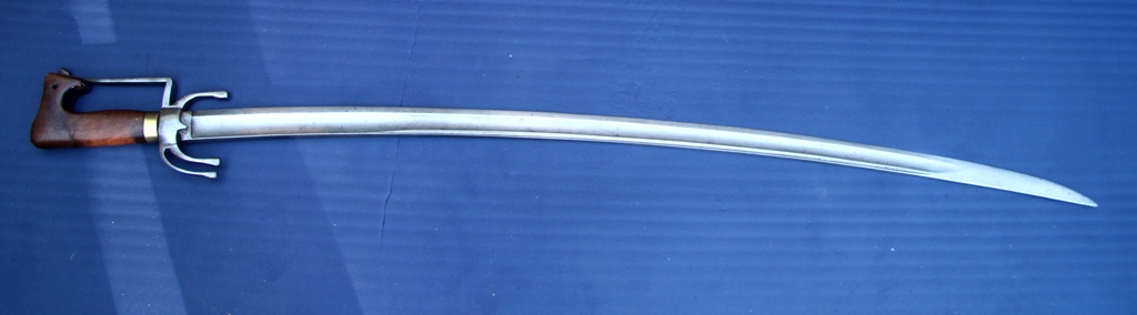

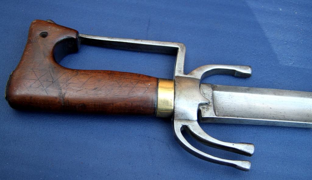

Here a typical one with European blade

I'm sorry, but I just can't see any deliberate attempts at the formation of a 'kirk' pattern on this blade .

Hi, Rick, Your right about the forced patterns. It shows those three spaced patches and once again between the quillions and nearer the blade tip. The central ones are about where the blade arcs. So its likely they are naturally occurring from forging. Thank you all for your information and excellent Nimcha examples. Steve
