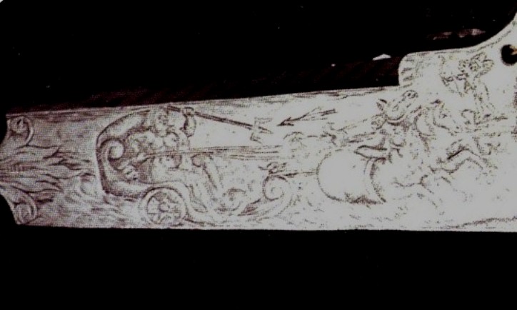

Michael: Thanks so much for the information. Most helpful. Yes, I agree, the lack of overall decoration would suggest military use. Which, in a way, makes the lock even more interesting. Yes, I'm sure there are very few of these around. Thanks, Rick.
Hi Fernando. Yes, now I see the chain. So, it's missing part of it's secondary sear Thank you so much for noticing. Hmmmm. Thanks, Rick.
I don't own this Lock yet. I wanted to get both of your opinions before taking the plunge. Of course, it won't come cheap. I'll have to decide sometime this week. It would sure make a nice addition to the lock collection.
Old 17th August 2011, 06:37 PM   #5
Matchlock
Matchlock's Avatar
Join Date: Sep 2008
Posts: 4,310
Hi Rick,
Due to the losses that Fernando K. correctly pointed out, I think you shouldn't pay too much.

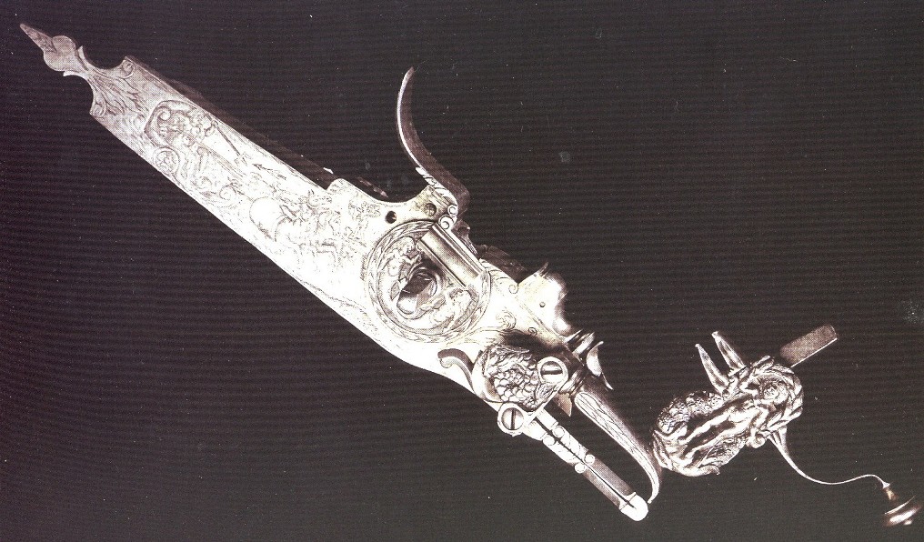

I attached a Suhl/Thuringia made heavy wheellock musket, ca. 1600, mounted with the same type of Italian style mechanism but the usual sort without a reserve dog for the pyrites.
Please note that wheellocks, differring from what Fernando K. said, have dogs and not cocks because they are not cocked and do not strike sparks!
The other gun illustrated in detail is of Nuremberg but Italian style make, ca. 1590, its single dog mechanism quite similar in shape to 'your' lock.
