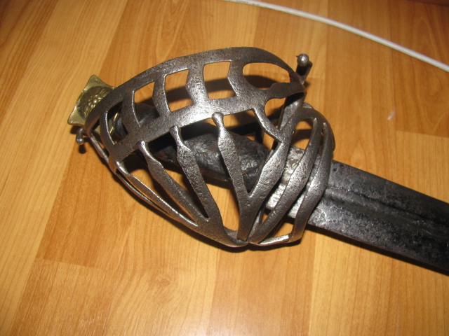

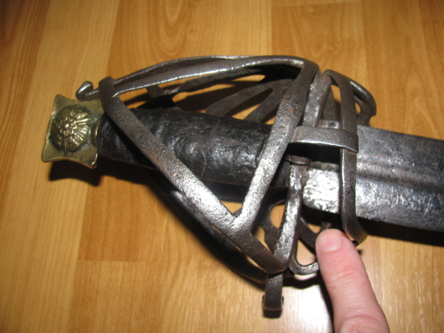

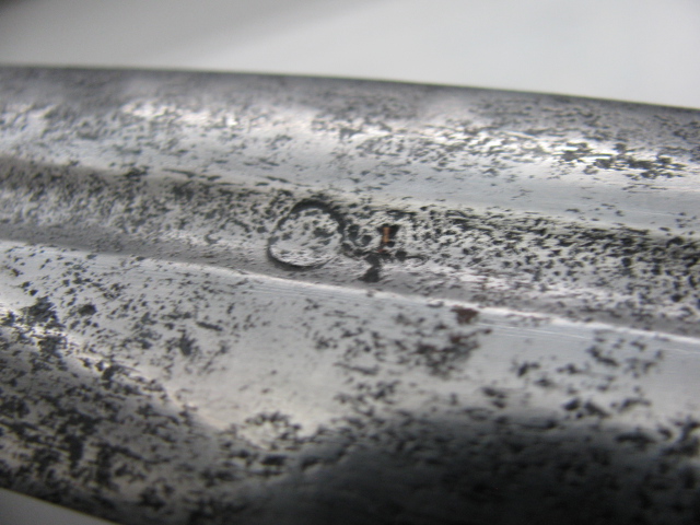

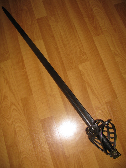

Default 18 th century schiavona

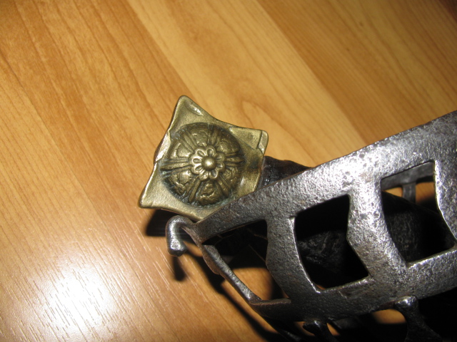

I have Schiavone with unknown characters. Does anyone know what is it?

Old 25th July 2012, 01:39 PM   #35
Maybe upside down ?

Default Unkown master?
Hello Pappa-karlo,
just I saw your niece piece. Quite perfect hilt, nice pommel.
I guess, that the stamped letters are cyrillic.
We can find a sciavona, also younger type (18th century ) with "three ladders" in the Collection Carl Beck. Sursee (Swiss). There is the name "Sava" stamped in cyrillic letters into the hilt (http://www.waffensammlung-beck.ch/waffe67.html). The author Boccia mentions five Sciavone with the lettering "Sava" in cyrillic. It is assumed that this is the name of the master, who built the hilts.
Thus, it could be here to be a master signature
In this case, would Pappa-Karlo's sciavona also a hint that not only o n e master in cyrillic letters signed. Certainly there were no Italians, signed in Cyrillic, but there were craftsmen from abroad. Perhaps these craftsmen came from the Balkans. The rich Venice undoubtedly attracted numerous artisans from abroad and also had the need.
May be someone in the forum who can translate this cyrillic letters?
Very unusually is the plate at the hilt.
I am sorry, I did not found a english term for "Stichblatt" . Never see before. But I've seen other modifications to sciavone. and do not rule out that the plate is mounted original. Thank your very much for showing, Pappa-Karlo!
Enibas is offline   Reply With Quote

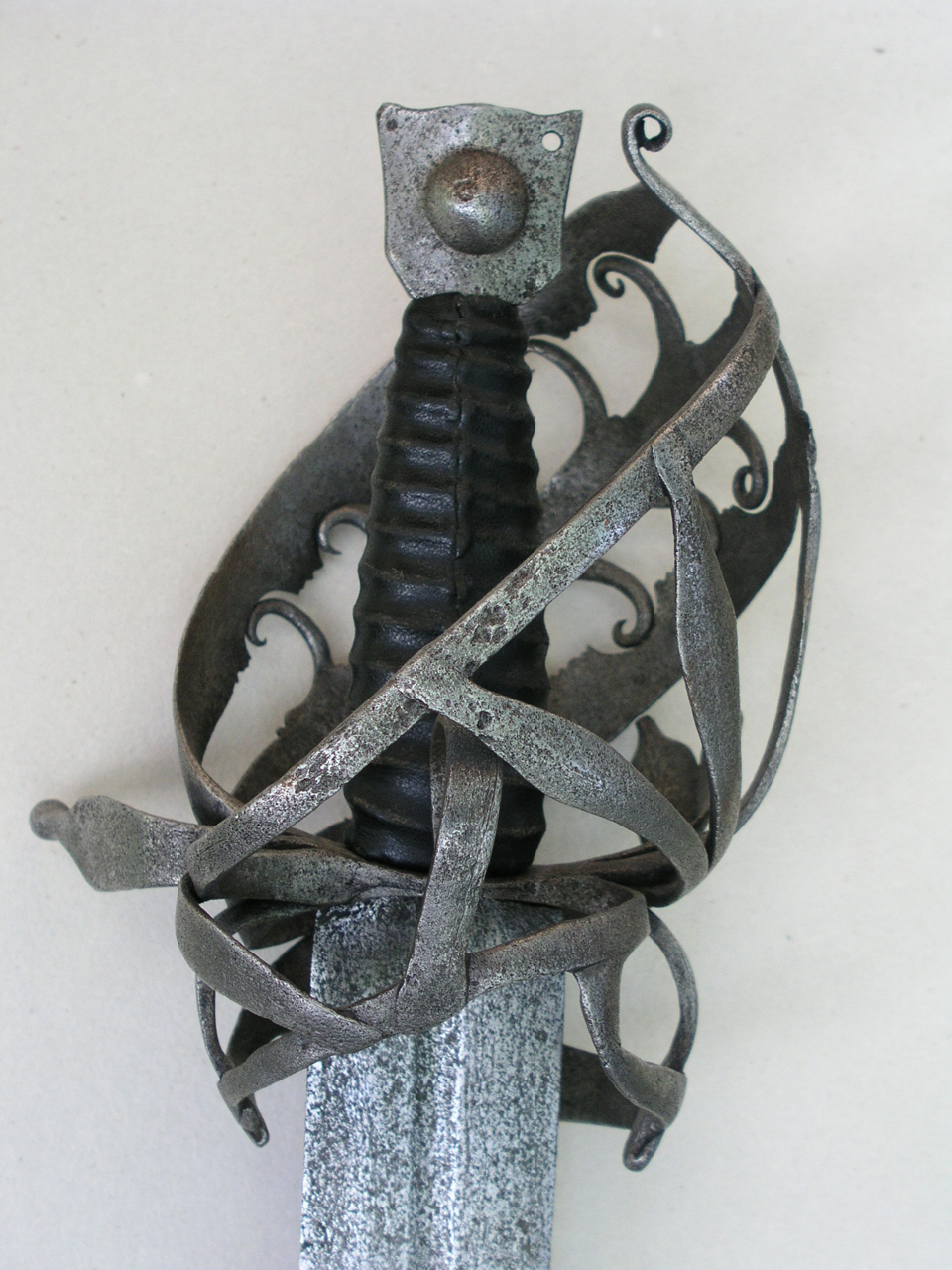

Old 26th July 2012, 12:34 PM   #37
Is this a schiavona variation? Just sold on e-bay for <$250 :-)
Old 26th July 2012, 01:59 PM   #38

Thank you very much for your detailed response. It's very interesting. I think this should be name. I found the Serbian alphabet, but only a couple of letters are similar. Not easy question.

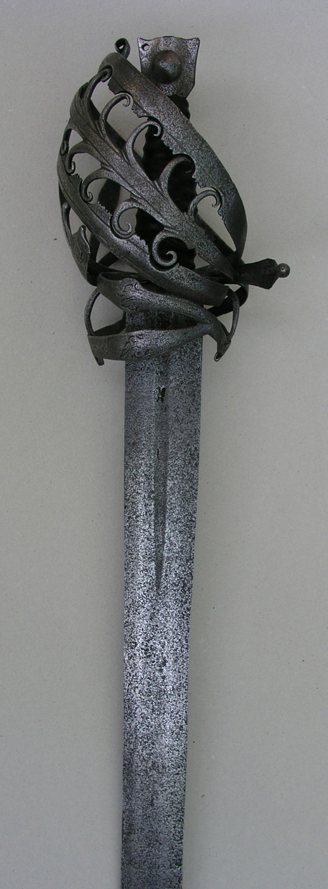

the last exemple from ariel reply is a venetian naval sword called "Fanti del Mar" , it is a nice exemple but composite and a later exemple...
they was used by the venetian infantry troups called like the sword fanti del mar in italian , actually lagunari in Venice ( a modern military section ).
Here one of my differents exemples I had . This one with venetian arsenal mark.

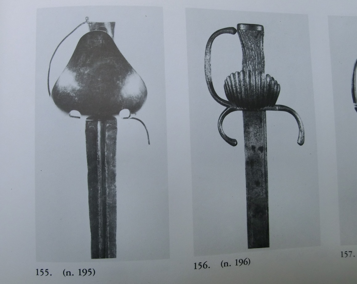

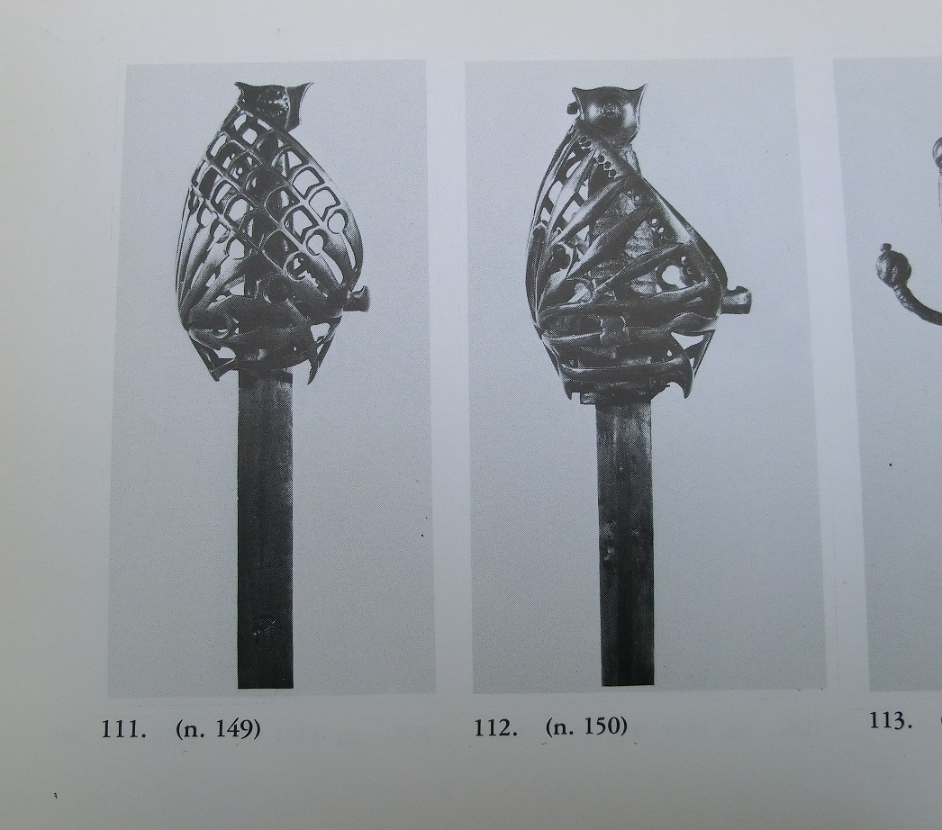

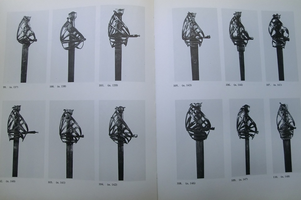

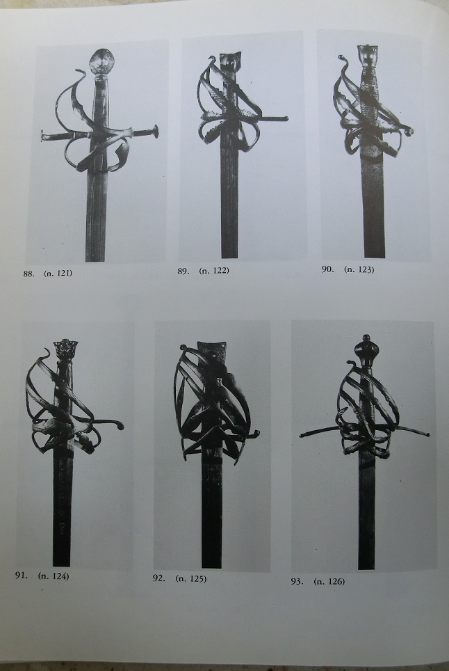

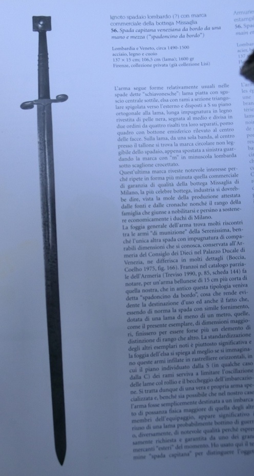

some books exemple of schiavona's , fanti del mar , schiavonesca .
Old 27th July 2012, 06:33 PM   #47
BerberDagger
BerberDagger's Avatar
Join Date: Jan 2007
Posts: 247
others .

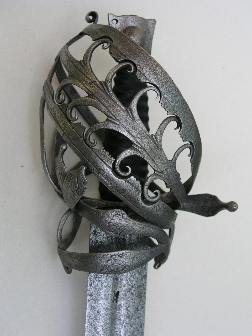

The script on this Austrian mounted Pala has so far eluded translation, maybe you recognise the form? Oh, and welcome to the Forum, the nicest bunch of "eccentrics" you'll ever meet.
Norman.

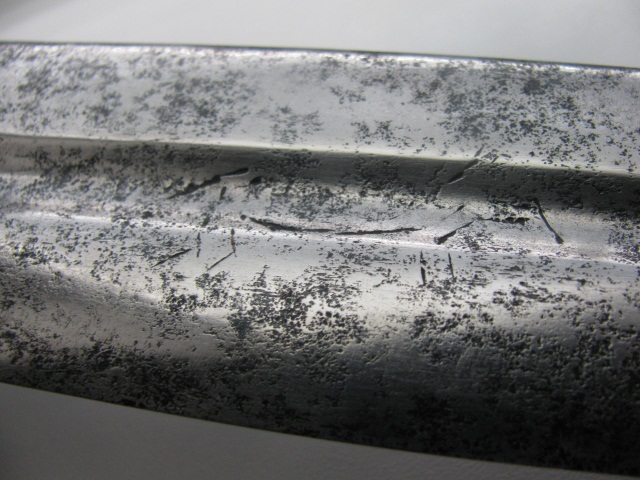

Hello fellow collectors can anyone ID this schiavone maker , date orgin country ? I see a running wolf with rose gold inlay reminance and the orb and cross has the same rose gold inlay. Can anyone shanre any information on this piece? The pommel is very nicely detailed also. Thank you :-)
theswordcollector is offline   Reply With Quote
