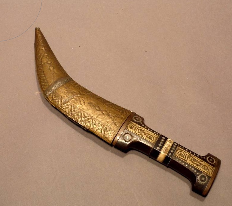

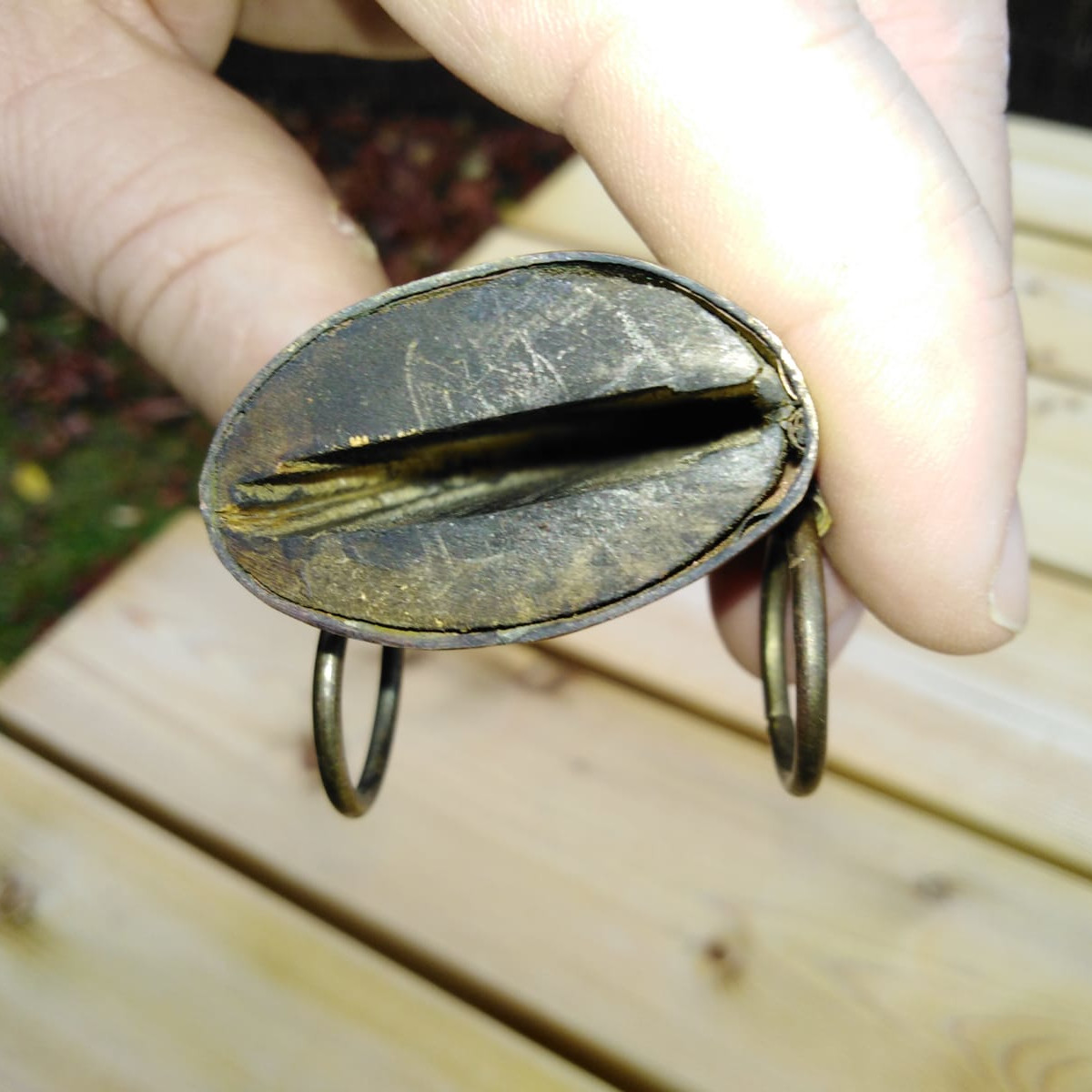

As it happens, I have the example from Artzi's site and Motan's post above.
Two pics to show otherwise unseen features:

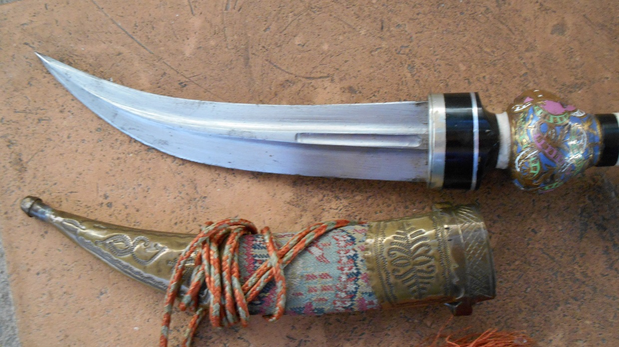

Here is a thread from 10 years ago relating to a straight bladed Syrian? dagger I once owned. http://www.vikingsword.com/vb/showthread.php?t=6959
Thought it worth to throw this one in to the mix again.

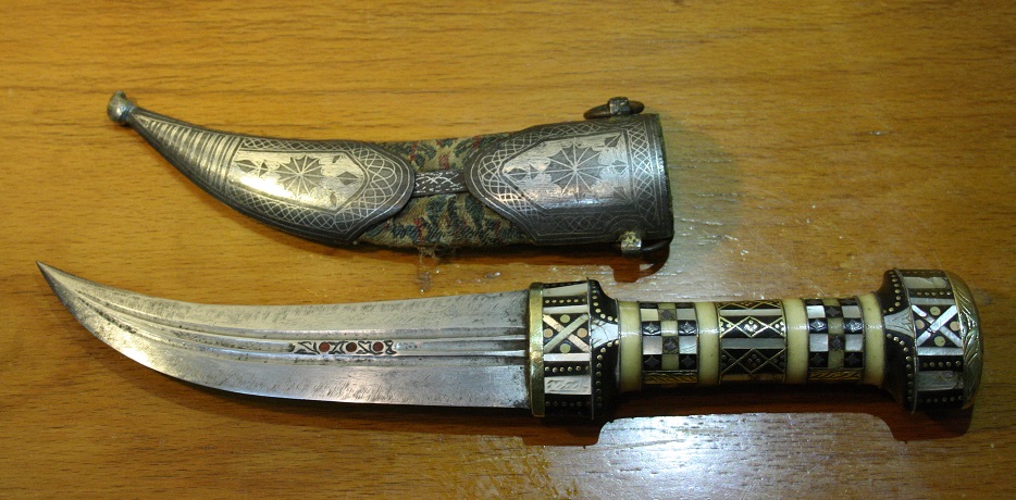

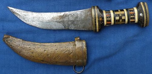

Here is a nice example I had a few years back.
Stu
Hi Stu,
One of the best that i saw on this forum.

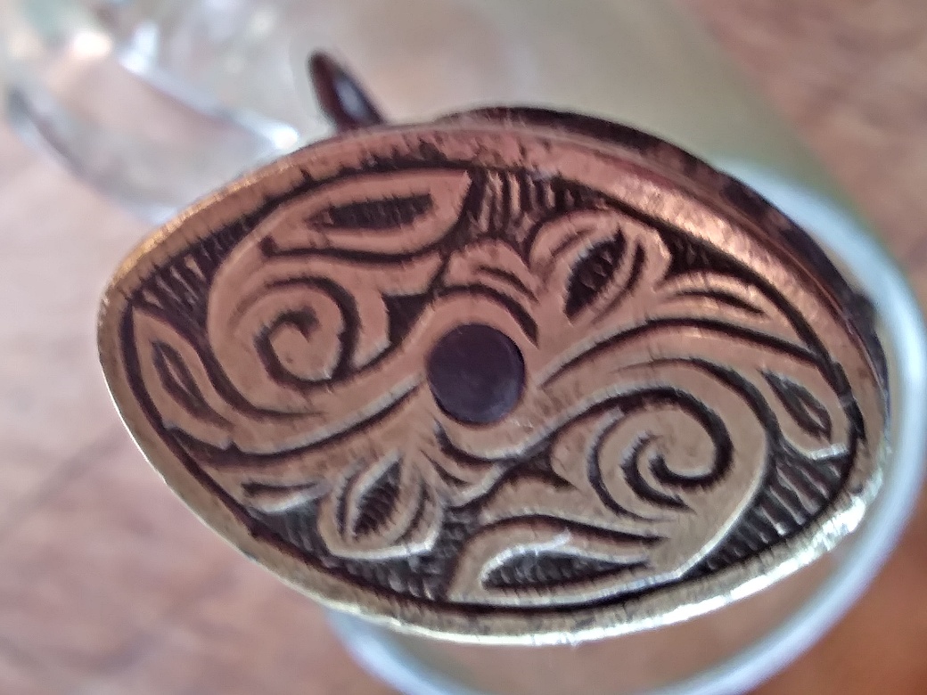

Yes Kubur. I agree with you. It is very possible that production started earlier, I just don't have proof. It is rare to see Majdali type daggers in a book. Can you produce a larger picture? Dates on old Majdalis is quite common, but consistently start at around 1900. See first picture - clearly 1318 Hijri - 1900 Gregorian.
Bob A, this is indeed the very same dagger. Artzi says in his site that they are all from Majdal Shams. What I think is that the ones he sells are indeed all from there, but other production sites do exist. Good ones are becoming rare, so a good purchase.

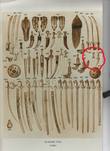

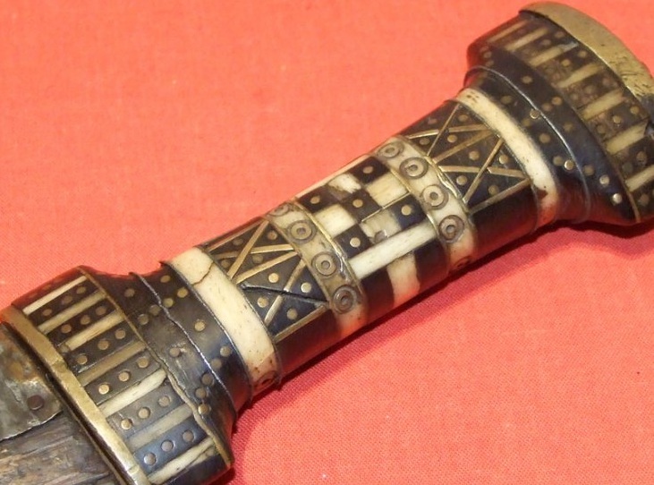

Colin, yours is a good and old example of the heavy blade - oval hilt type, but the decoration style is slightly different from most, with many vertical elements on the hilt. I have seen several and they may be from one workshop. I have no idea what it says about their origin. A similar style in pic 2

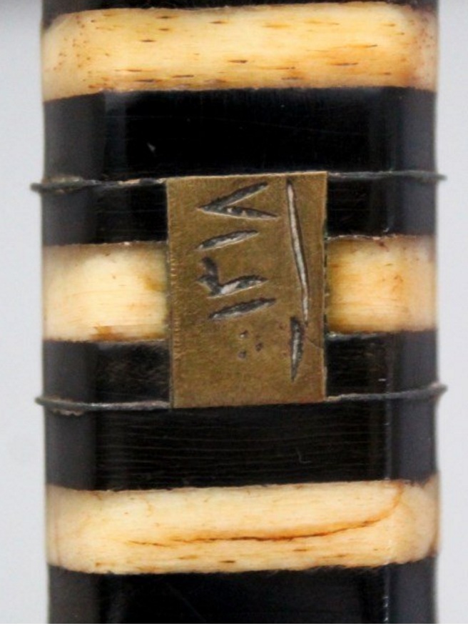

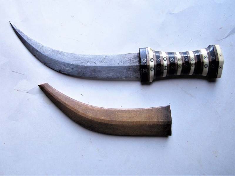

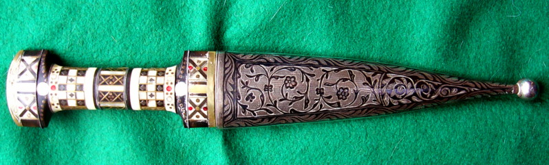

Stuart, yours is indeed a unique example, probably made on special order. Very high quality work and an a-typical but very good scabbard in Ottoman style. Straight blades are known, but rare. I know you don't have it anymore, but do you happen to have a good picture of the back of the hilt? It is signed by the maker and I think I know who he is - Iskander. This workshop made top-notch pieces in the round handle/fullered blade style. I recognize the decorative element in the middle of the hilt. I have seen several signed examples - see pictures

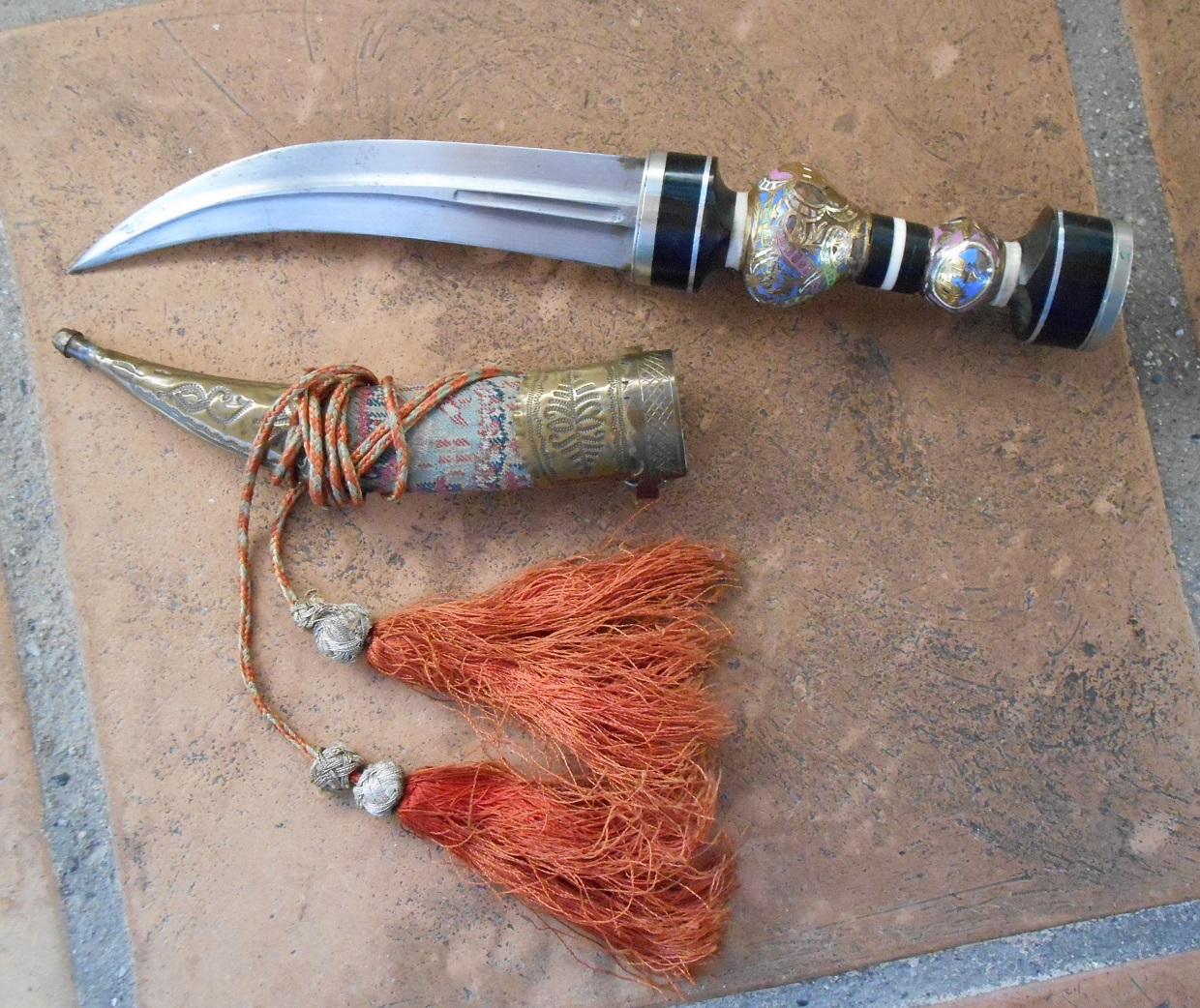

Here is the beast, despite many 19th c. features i think this jambiya majdali is from the 20th c. (1900-1914) maybe from your iskander... same fabric on the scabbard...
with nice Ottoman emboidery, amazing blade,and amazing enameled hilt with pictures of al aqsa and the dome of the rock... Is it possible that your Iskander was from Jerusalem?
Enjoy

Hi Kubur,
Surely a unique find. The hilt with beads is an Ottoman feature known from small daggers, where the the beads are either from stone/amber inlaid with gold, or with emaille decoration. This style has been imitated in Syrian and North African daggers.
As for the dagger itself, I think it is another one made on special order. I tend to think it is bit later than very early 20th c., maybe the 1920's. The use of white metal in the hilt is new to me - always brass in other daggers.
The blade is of excellent quality for this type of daggers, but I think that the fuller is engraved, not forged. The scabbard is in Ottoman style, but the zig-zag decoration is very Syrian/Palestinian.
As for the maker, you may very well be right. The precise and polished finish of the horn and bone parts are typical of Iskander (Skandar) and we know he made special pieces of the rounded hilt style, probably to specific customers. I looked at an earlier thread where Stuart's dagger was introduced and saw his signature on the hilt.
As I mentioned before, Skandar, the Arab version of Alexander, is a name given mostly to Christians. We know that some of the important dagger makers in Majdal Shams were Christians, but they gradually moved to other part of Syria following the great Druze revolt in 1925-1927 and probably kept making daggers elsewhere.
