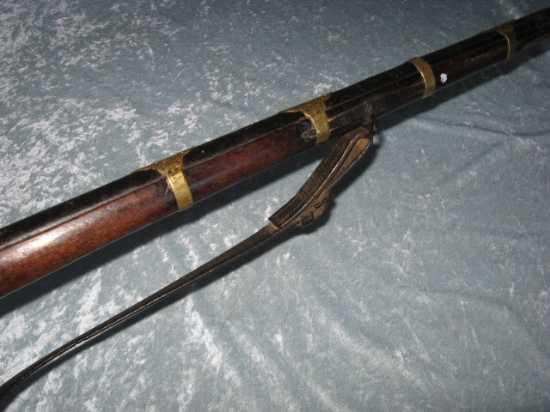

Default Jazail

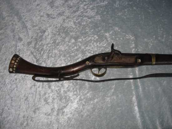

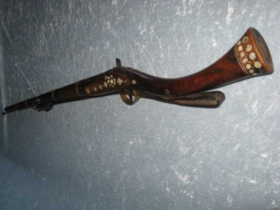

Hello. Well, you have had quite a journey. Things appear to be looking up. Here is my Jazail I purchased from Antique Storehouse in Portsmouh in you area. A friend of mine from Canada will be in the UK in January and will ship it to me here in the USA. Mine has a percussion Enfield lock. I plan on having a barrel liner installed for shooting. Rick.

By 'eck! I saw that one when I went to Portsmouth to collect mine; it's a rather good-looking weapon, very short, almost carbine-sized. It'll be interesting to shoot, I imagine; you must tell us how you find the recoil etc.
All the best!

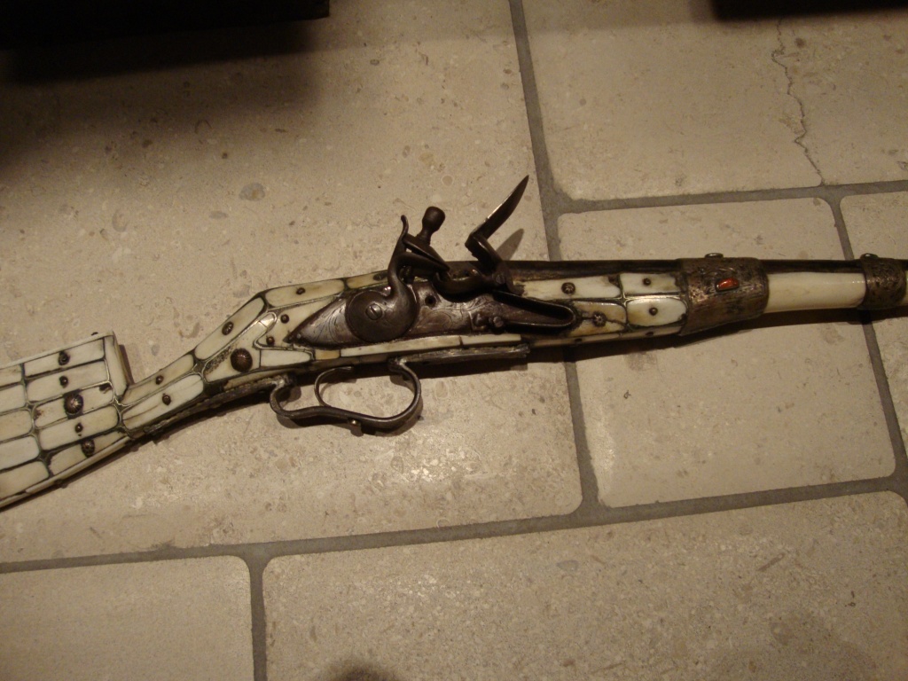

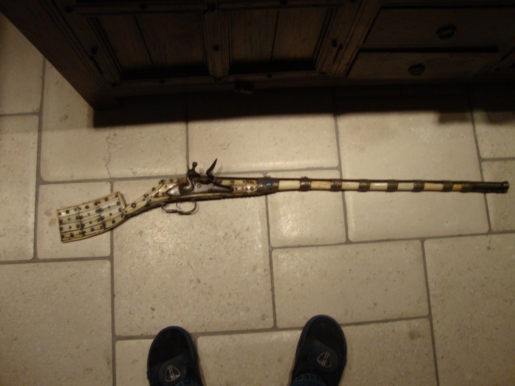

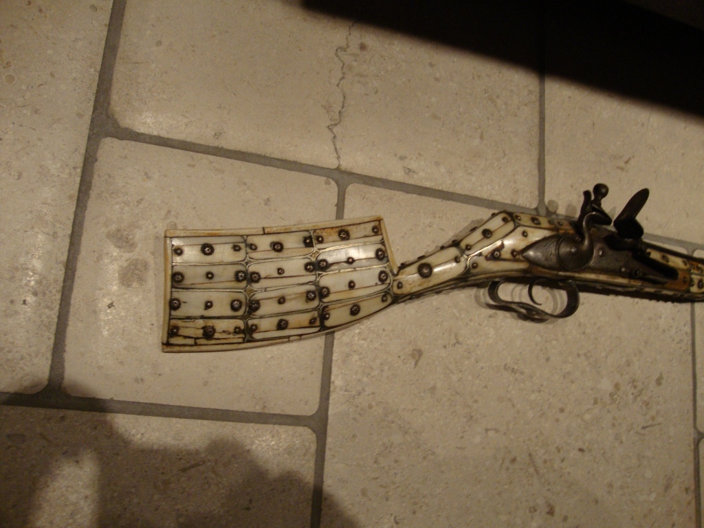

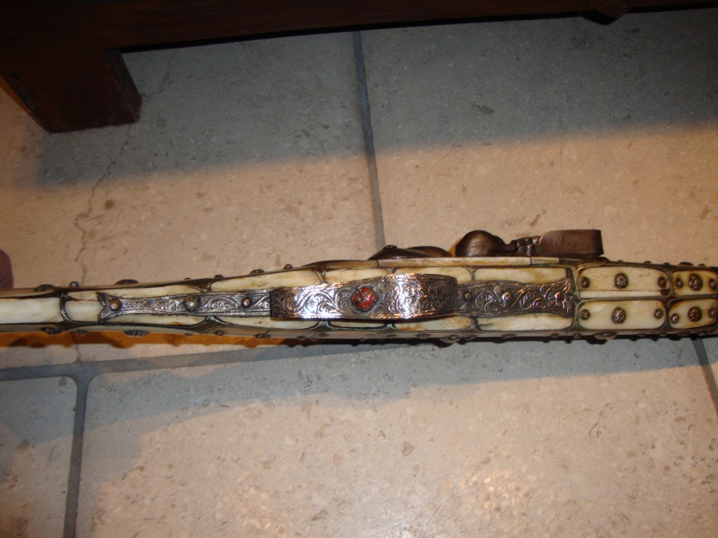

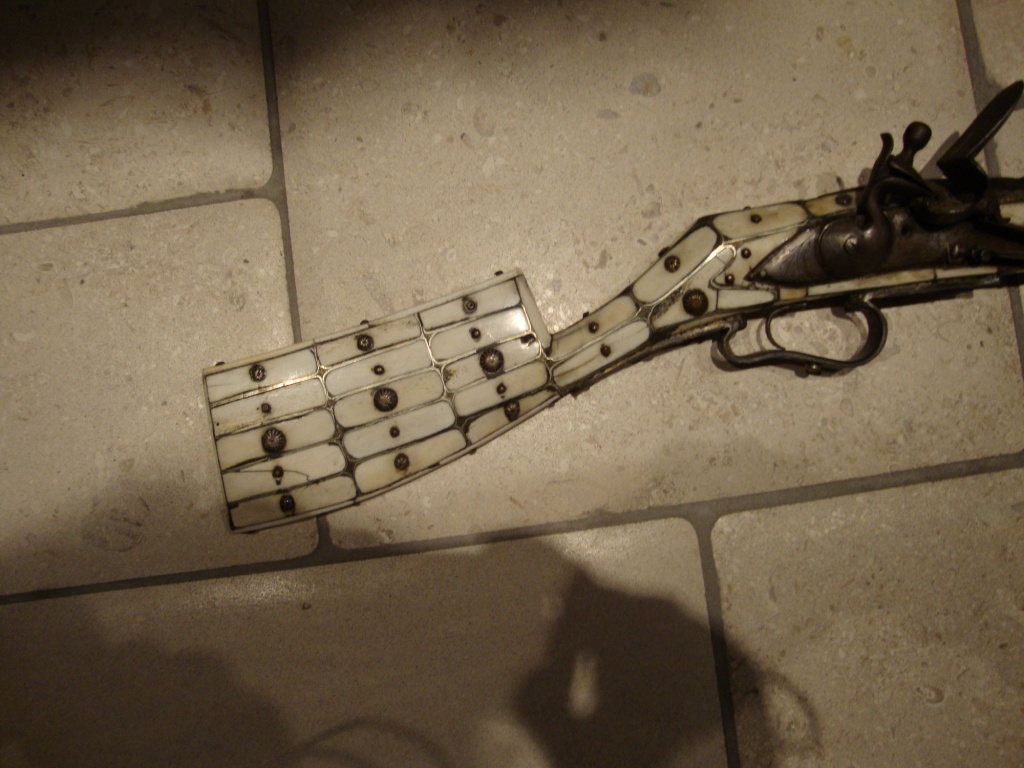

Default Please help me identifying these rifles.
Hello, guys, About a month ago, I bought two rifles from an old guy, from Gent(Belgium).
They have a lot of characteristics of jezail guns, but the stocks are not like the normal stocks for a Jezail or any other rifle from that area.
The locks work, there are a lot of silver decorations, and the inlay is bone,
I think, the coloring is to dark to be ivory(Again I think)
If any of You guys have info on these guns, please let me know.
Greetz,
John.
ikzelf is offline   Reply With Quote
Old 24th January 2011, 09:23 AM   #40
ikzelf
Join Date: Jan 2011
Posts: 5
Hello, here are some pictures of two rifles I bought from an old guy from Gent(Belgium).
They have a lot of charistics of Jezail rifles but the stocks are not like any from that part of the world.
Can anyone help me identifying these rifles?
Greetz,
John.
Old 26th January 2011, 10:25 PM   #41
carlitobrigante
Join Date: Aug 2010
Location: Solihull, UK
Posts: 81
i cant help with the identification, but that looks beautifull and worthy of its own thread on the forum where others who can help will see it easier.
regards
carlitobrigante is offline   Reply With Quote

Old 4th February 2011, 05:05 PM   #45
ward
Join Date: Feb 2006
Posts: 637
The gun with bone inlay is modern work from Morocco, seen them a lot.
