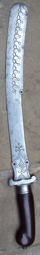

With the many cultures that have 'snake' symbolism including India (Naga) and even Europe, that,so far have not been mentioned. I think tying the engraved blade to a specific time frame/culture will be difficult.
Hopefully, the dimensions/spec. of the blade will be forthcoming soon, this would obviously help to assertain the knife's function ...and perhaps then 'narrow' the possible origin. I do hope the blade is not thin and flexible...would you need the protection of the crossguard whilst 'buttering' your bread
IMHO I still feel that the 'raised' spine is functional and not a symbolic feature to 'mimic' a Benin blade, which usually represents an animal form.

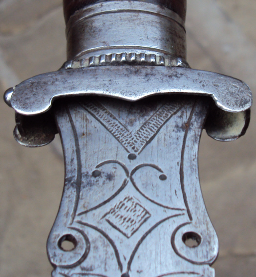

Hi
Thank you to everyone who made the thoughts and reveal their knowledge.
The knife is now in my!
Blade length 33cm
Blade width (rear) 3.1 cm
Blade width (front) 3.6 cm
Thickness (rear) 4mm
Thickness (front) 3mm
the blade is sharp only on the bottom

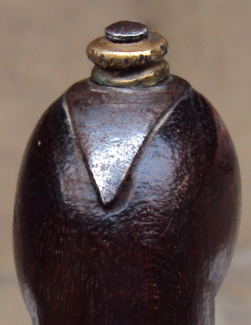

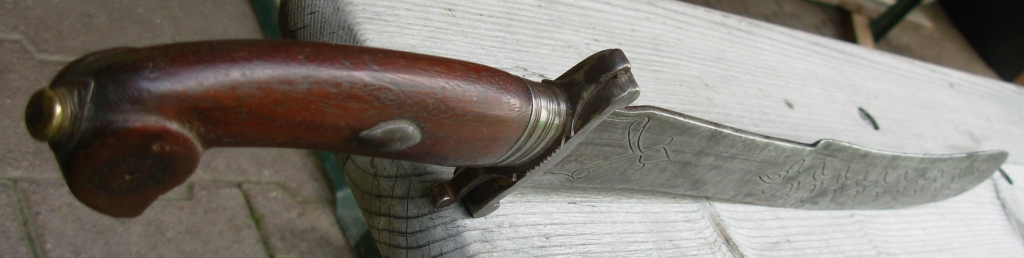

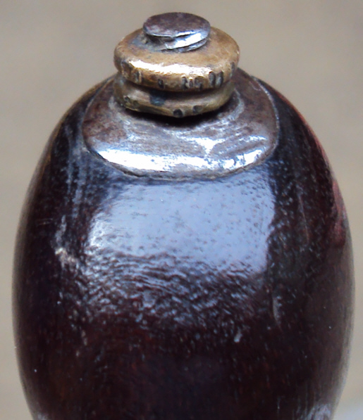

Interesting slim blade. The pointillist engraving catches my eye as does the steel plate under the brass button at the pommel. European hunting knife?

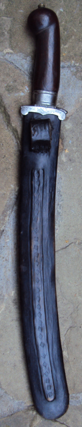

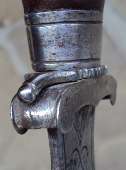

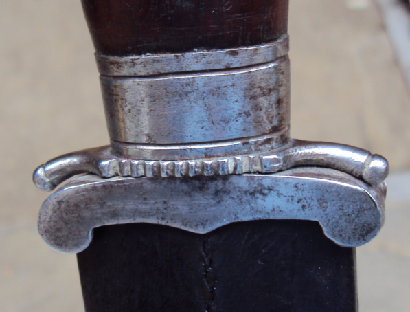

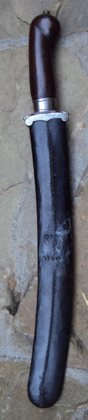

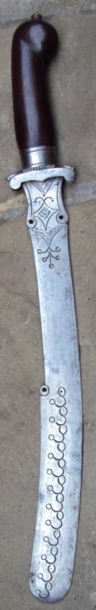

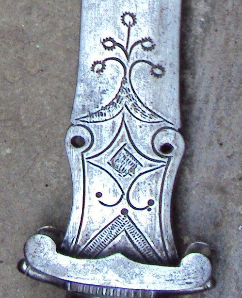

I was in Oxford today visiting the Pitt Rivers museum { lots of pics to show} and came across this piece. In amonst several of the usual Asian knives and daggers, choora and the like. Labeled eastern dagger? Now with the scabbard, I think it is very clearly a prestige African item. I am certain of a West African origin perhaps even as north as Guinea. The scabbard fits snuggly under the guard. It was not got for pennies but kinda groovy?
Total length in scabbard 44cm, naked 43cm, blade 31cm.

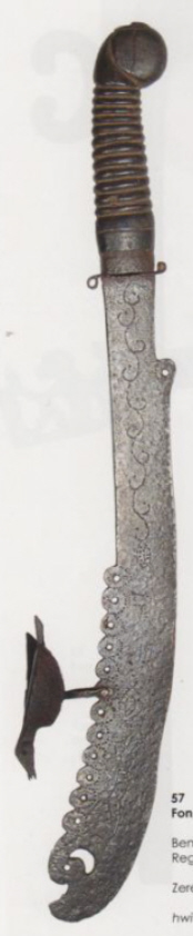

These are rich folks Vodun Ogun cutlasses. The one that started the thread has a bird head, this is Aje a deity. It is complicated as a outsider but as far as I can work out, Aje is or can used as female aspect to Ogun. Also a goddess of wealth. Aje appears to humans as a fowl. So all the bird idea posts were not that far of the mark except Peafowl are Indian.
PS most probably a Guinea fowl.
PS

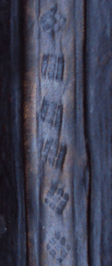

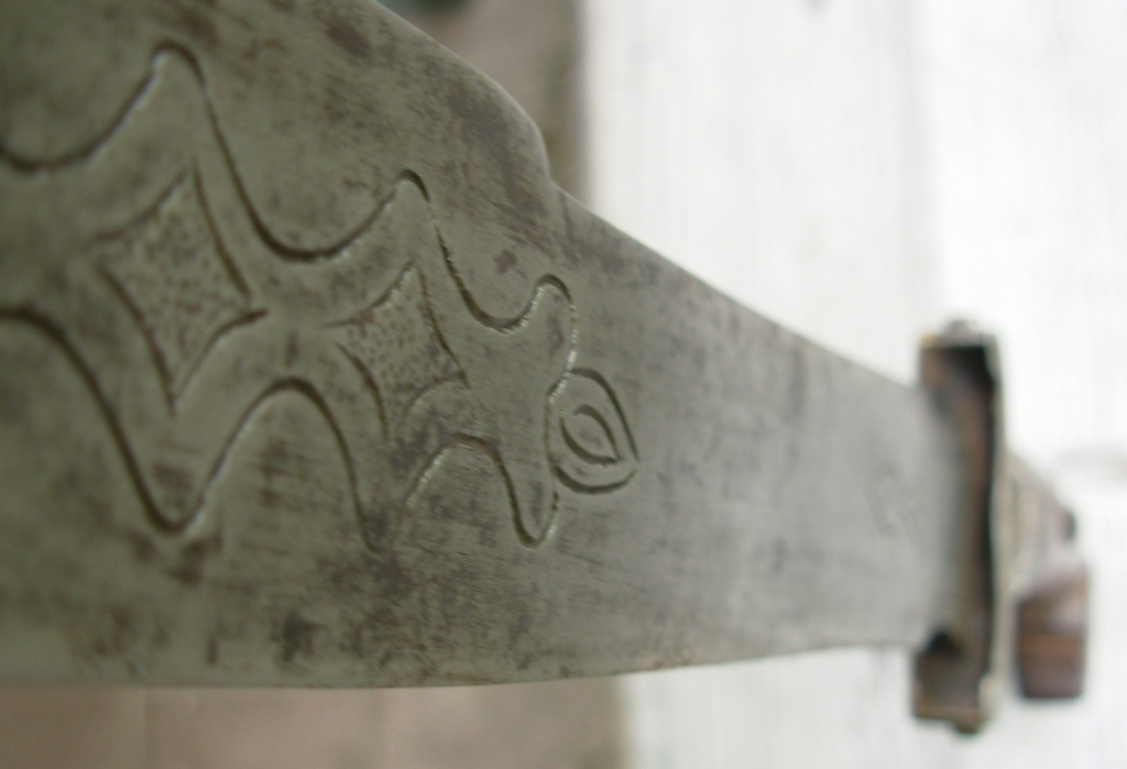

The snake {like} engraving on the first example is also a female aspect and access to Ogun. So I suggest the first example might possibly? have belonged to a wealthy lady? There are restrictions on female acess to Ogun, the bird and snake allow female acess.
When seen together like this it becomes more clear, just one has the double guard scabbard top thing. The other has that bird thang going on.

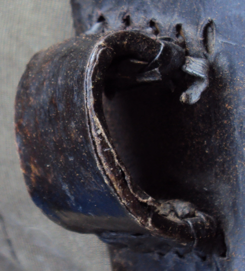

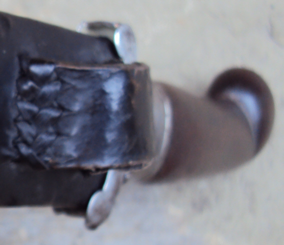

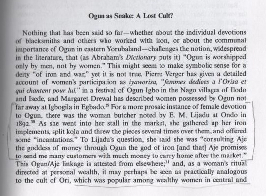

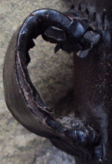

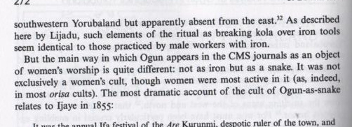

David thanks for the interest and the link. I do not want to drift too far from the knives post here but it is important to understand the motives for there creation. The link shows how Vodun is a living view of life and not bound by a scripture. I am not an expert but feel some of the ideas in the link may have taken form and reflect infuences of late 20th century feminism. I post an extract from {Africas OGUN Old World And New} which I am using as my guide for investigation. I might being adding 2+2 = 5 about a ladies object but you can see how.

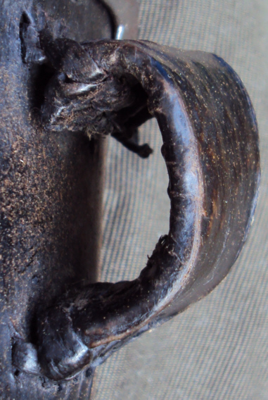

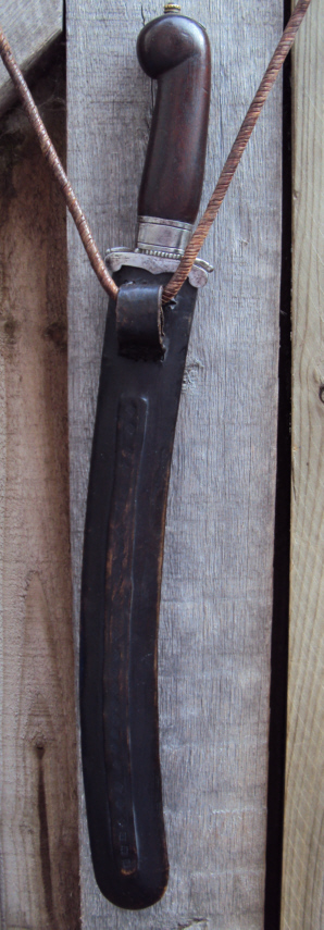

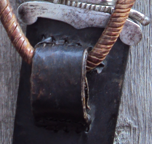

It is certainly possible that the item with the scabbard was a temple object. I took it to be a personel object a badge office or devotion, by the definate signs of carriage/suspension and wear to the scabbard loop. Pictures for examination.
As to the idea of a tradition in form; well the Swiss chap has one the same anymore out there?
PS the first piece of text should follow the second.
