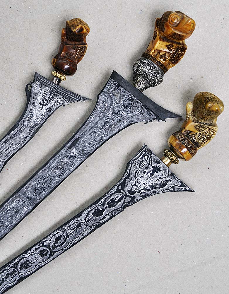

Hello Pak Ganja,
The fixing material, seems to be traditional -- blackish, and rusty laquer. I don't know precisely what it is. Maybe like traditional javanese 'lacquer' (I don't know to describe it too), but more rusty... (picture below)
Probably damar (or more precisely a traditional mix based on damar resin) which is quite commonly found on Sumatran/Malay keris. Could also be shellac but I'd consider this a non-traditional material for attaching a hilt.
The "hard" ivory -- not elephant tusk -- also make the hilt difficult to remove, because of the narrow hole, and the rusty lacquer material.
Yes, looks like a pressure fit enhanced with a thin layer of resin. This can be very tight, especially when rust has developed.
The pesi is shorter than javanese pesi, but still in good condition.
Yes, the pesi looks perfectly fine for a keris Palembang. From the corrosion, the tip doesn't look recently shortened, doesn't it?
I'm less certain about the ganja though: Not only does the metalwork look much more crisp than the blade but also the hole for the pesi seems to have much less corrosion than the pesi...

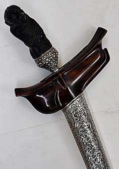

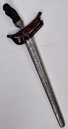

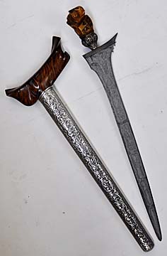

ganjawulung
ganjawulung's Avatar
Join Date: May 2007
Location: J a k a r t a
Posts: 991

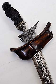

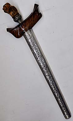

Originally Posted by kai
You have it in your hands - does it really look like a later replacement? From the pics the surface looks much smoother and the scroll-work more crisp; thus, this would be my working hypothesis if hands-on examination doesn't reveal hints to the contrary.

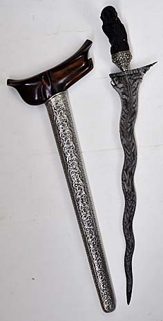

IMHO, Palembang style was much influenced to javanese style. We could still see until now, many old Palembang blades are sometimes quite similar to javanese blades. A ganjawulung fixed to a blade, is quite common in Java. And I think it could be common to Palembang style too.
(Images below, the more complete picture of my Palembang keris, with another silver pendokok...)
GANJAWULUNG

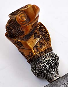

And another close up of the hilt and the silver pendokok...
GANJAWULUNG

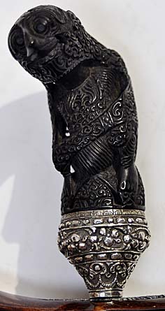

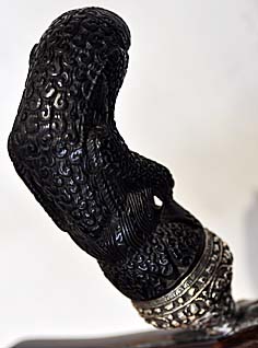

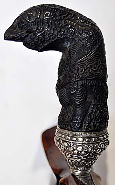

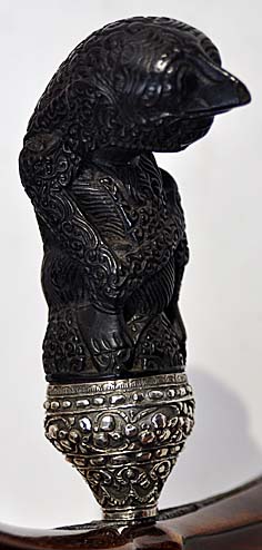

Default Another Palembang Keris

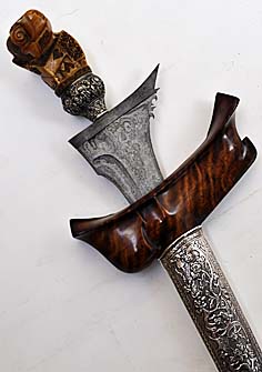

Dear All,
Another images of a Palembang keris, but with Cirebonese "buta" hilt. Is is a match pair, a Cirebon hilt on a Palembang keris?
GANJAWULUNG

Dear Pak Ganjawulung,
IMHO, Cirebonese hilts are the most flexible. It can match any Javanese blade and Wrangka, or Malay blade and sarung..... even Buginese's.

Hello Pak Ganjawulung,
can you show us a closeup view from the hilt?

Default Cirebon Hilt (close up)
Images of my Cirebon hilt, as requested by Detlef...
GANJAWULUNG
Old 3rd June 2010, 04:03 PM   #54
GANJAWULUNG
Thank you, very fine and dilly carved hilt and doesn't disturb the overall impression of the ensemble even it is from Cirebon.

Hi all,
Hoping this thread may find some new activity as it touches on carving styles of the Lampung region. I acquired what I believe to be a late 18th century south Sumatran war canoe prow some time ago and have had some degree of trouble confirming its place of manufacture. After stumbling across this thread and references to hilts of the Lampung region in Gaspard de Narval’s ‘Ukiran’, the stylistic similarities between the prow and the Jawa Demam hilts of Lampung are the closest I have yet identified. To me, the spiral eyes and wing motif are the most similar stylistic traits to that seen on the Lampung hilts, though this may be way off the mark.The shortage of texts on Lampung carving styles/motifs has left me a little frustrated, so I was hoping for any and all suggestions or thoughts on the prow, including suggested reading.
Any thoughts on tribal origin, motif (Garuda?), symbolism, type of timber (Teak?), or age, would be greatly appreciated. Some incised decoration depicting a bull/buffalo, centipede and possibly a scorpion appear on the neck of the prow (unsure of their symbolic meaning).
Many thanks,
Unk

Oh, i see you already saw this thread.
I believe most of these hilts are either Palembang or Cirebon, not Lampung.
As for you attachments, they need to be added directly to this site via our Manage Attachments button. Thanks...

Posts: 991
Default More display
More on Palembang hulu and keris...
Old 6th October 2011, 08:50 PM   #59
Hello Ganjawulung,
very nice handles and blades! Are the pendokos on the left and right old or new ones?
Old 7th October 2011, 02:37 AM   #60
ganjawulung
Join Date: May 2007
Posts: 991
Old ones, dear Detlef. I hope you could see the different yellow of those golds. Not dark yellow, but light yellow... Later I would post the close ups.
Thks
GANJAWULUNG
